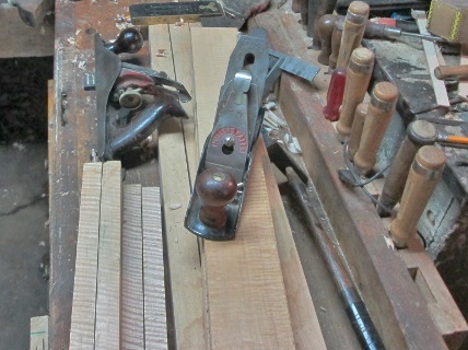

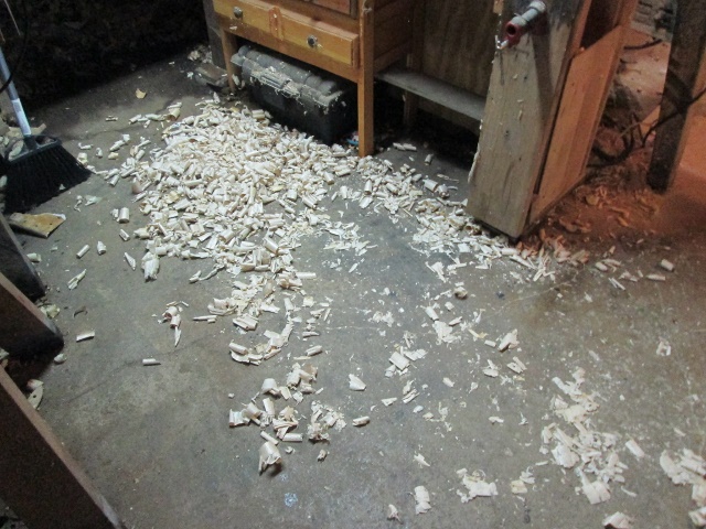

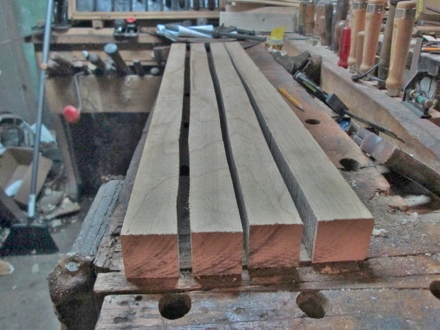

    How about a "Rachel's Stand-up Desk", ala Underhill?   Resaw of four leg blanks from one board...didn't go too well.    We have ways... Three planes here,  A #5-1/2 set coarse
Three planes here,  A #5-1/2 set coarse, a #0-7 set not so coarse, then follow up with the #8 set fine..
Until I get all rough edges smoothed out...
Igor, clean up in aisle #1!

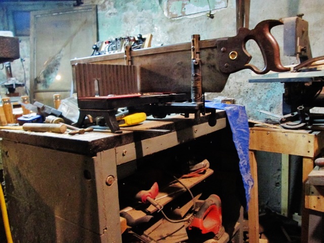

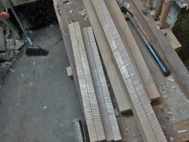

Hauled a rather plain looking board to the shop.....aprons and a couple stretchers.....Bandsaw to resaw to width.   Had to cut a few to length.   Used a  Circular saw to get the main cuts down...used a mitre saw to make the smaller cuts..
Hey, it is a cordless model.   Had a lot of saw marks to get rid of..

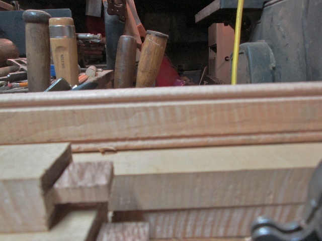

Hmmm...something does not look very "plain" here...

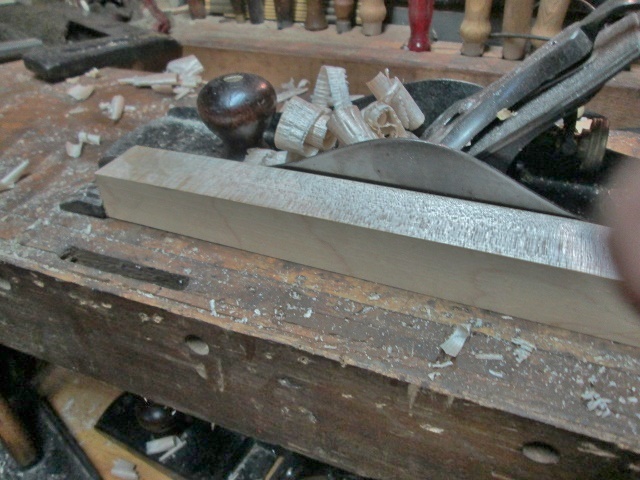

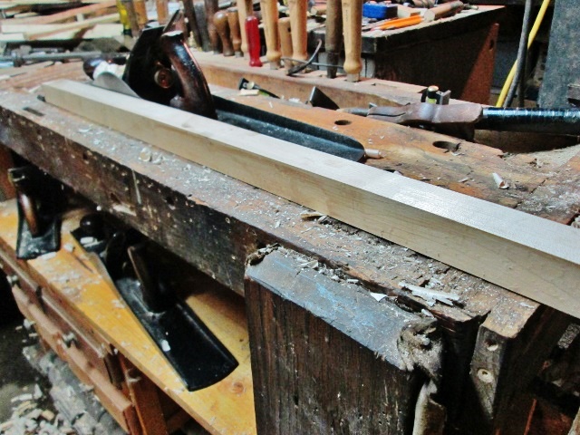

Ran a few planes down the edges..
Didn't need them huge jointer planes, these will do.  Note what showed up?

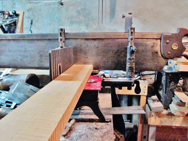

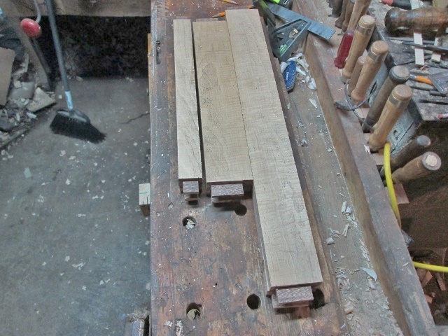

Well, I figured out that the 30" front and back aprons were too long ( better than being too short?) So the mitersaw was used to cut them down to 26"
Laid out for 3/4" long tenons.   Bandsaw didn't like the next part..
Turned thing a brownish colour.

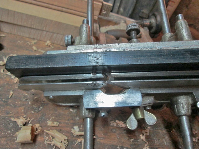

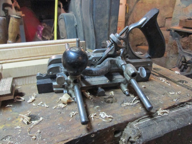

Ok, set up a plane..
With a #23 bead cutter..
Plane is set, but...how to hold them squirrely parts still long enough?    I drilled a hole through each tenon.   Never going to be seen.   The bottom of the legs will get a stretcher, running front to rear.   They get four beads..
The aprons only get one bead, as the rest  wouldn't show...
You can just barely make out the screw through the tenon.   Plane to smooth the face that will show.   Note the single bead?
Will leave the Stanley 45 set up, as the legs will get a corner bead...after a bit of chopping gets done..

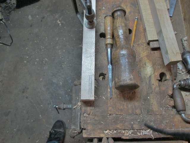

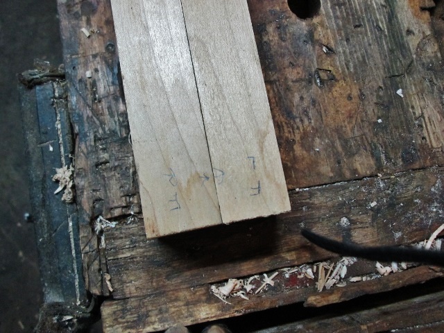

Yes, I do the tenons first, then size the mortise to them.  It also pays to mark which side is which..
F/L and F/R.    Arrows to show where the apron will be.
Might take a while....stay tuned
