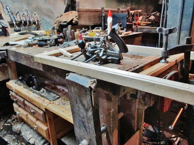

Again, had to trim just a bit off the tenon.  Set up a jig on the bench...we have detail work to do..
Takes a bit of time with the Stanley 45, but...looks ok.

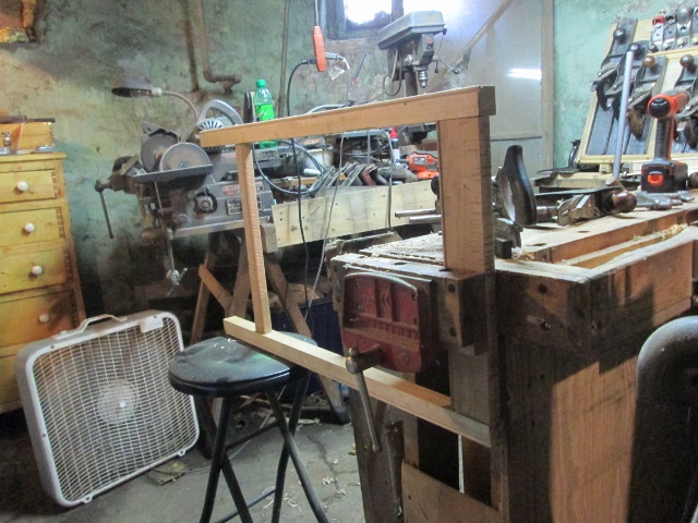

Got tired of a couple pipe clamps being way too long for the shop...tried a pipe cutter...almost through...snap!   Ok, we do have a couple hacksaws just hanging around...takes awhile.

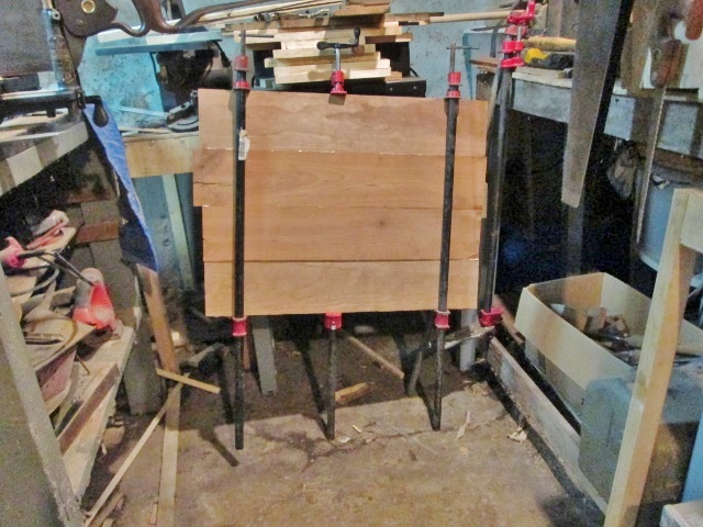

Cut and jointed a few boards, there will be a panel between the base and the desk unit....
Instead of clamps almost 6' long, these are easier to use.   Set up to do more mortise work..

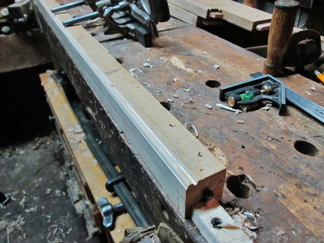

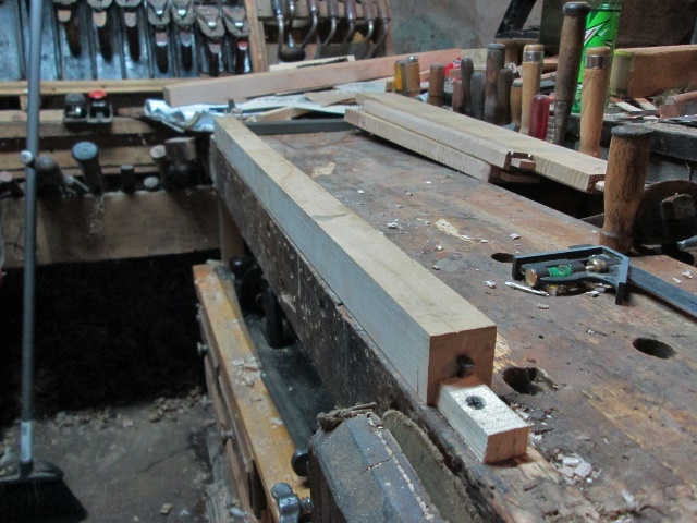

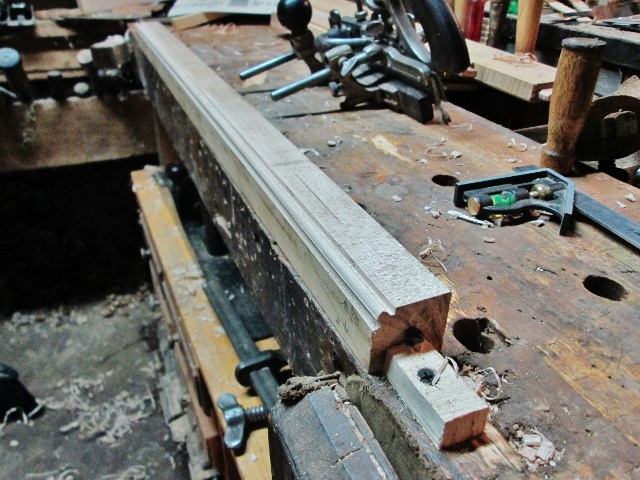

Ok, got one of the back legs mortised and dry fitted,  Then comes the bead work...ah one..
set it into a jig to hold it still..ah two..
Run the beading plane until a decent bead shows up,...ah three...
Rotate the leg until the other outside face is on top, run the beading plane until this shows up.   I waxed the bottom of the plane.....about flew off the bench...

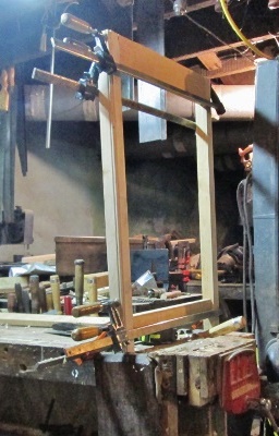

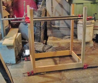

Dry fit four pieces ( cussing starts up)
While it was (Barely) standing this way, I pre-sized a few clamps, and got ready to try a glue up..
Shhh, don't tell the Boss where these were sitting...
Knock the dry fit apart, add some Elmer's and cussed some more.....Finally got it clamped up
Been checked for square about...10 times...Diagonals even match!

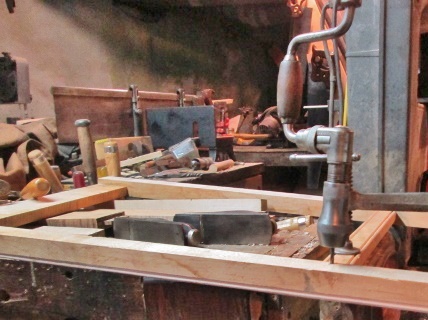

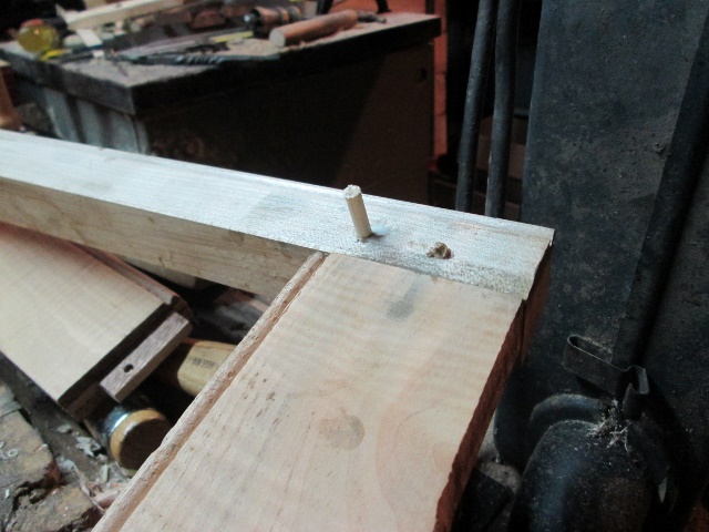

Got the assembly out of the clamps, decided to "pin" the joints..
Drill a few holes
Cut a dowel into a few pins, and drive them into the holes, with a spot of glue..
Trimmed them flush with a coping saw and a block plane to smooth them out..

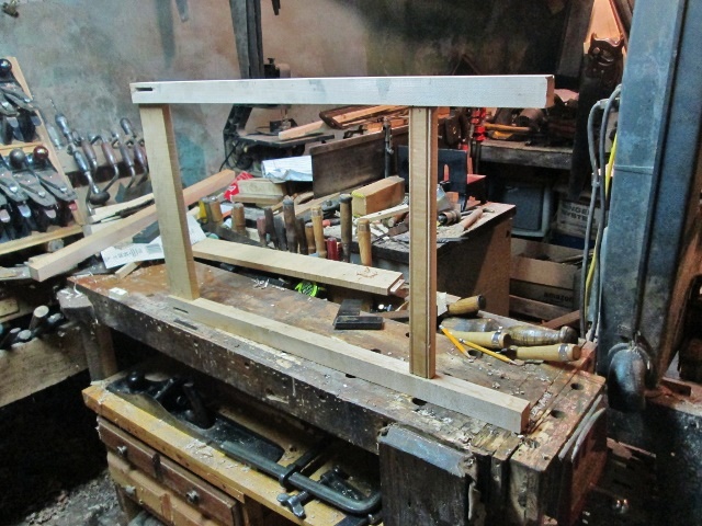

Needed to clear the bench for a bit, set up a dry fit to make sure I had things in the right spots..
Hmm, close enough.  Left this sit for a bit, Jig on the bench, cross stretcher gets a bead on all four corners...

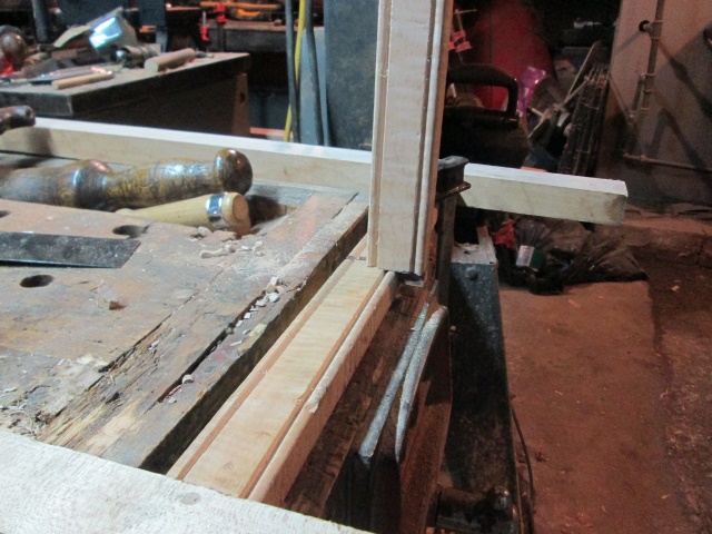

Leg vise as a third hand.   Some dummy forgot something.....the outside corner of the leg needed that fancy beadwork done....oh well, can do that when I cut the dovetail joints.
All clamped up...added a few more clamps, as I needed a measurement made..
Now you can see where the cross stretcher will go....rather where it will be after a dovetail is made..

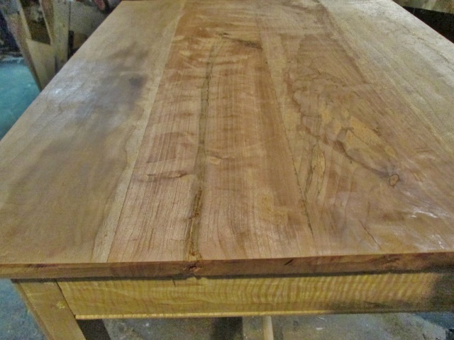

Took the clamps off the false top, to do this dry fit, where do I stash the panel?
Right here, of course.  Need to scrub it flat, trim the ends square, and make corner blocks to set it in place.   Desk unit will have dowels as locators, rather than screws.  May get one or two, anyway, to keep it from tipping over.  maybe some "Olde School Pocket Hole"  stuff?  :ph34r::rolleyes:

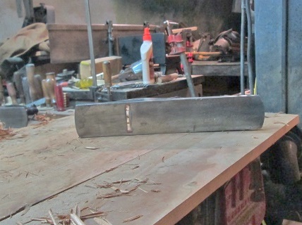

Time to get meaner than concrete....scrub jack to take down the high spots..
This one is a Corsair #C-5 by Great Neck.    Got things close, the the #6c was used...
All of this AFTER squaring the ends.  Check to see IF it still fits..

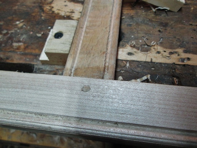

Finding all kinds of uses for the shop stool.   Bead work..
First part of the bead was a bit tricky, though.     Next, I drilled a few holes, and drove a few more pins...pinned.jpg.a89848a8ead2981e8d8e96fc173e2ef0.jpg
Coping saw to cut them done, and a block plane to smooth it out....needed a slightly larger plane to clean things up..

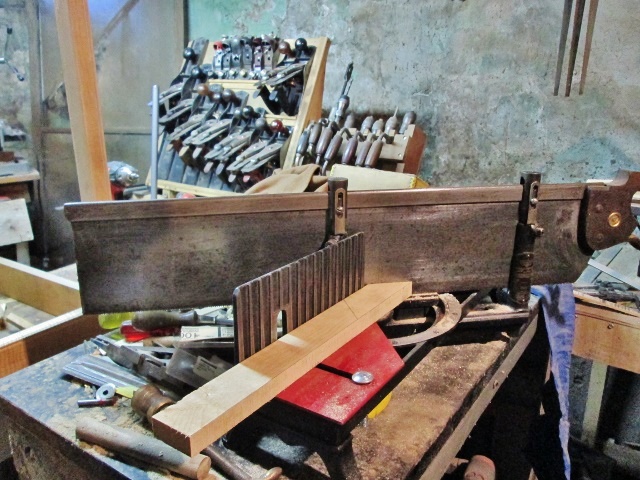

Ok, cordless mitre saw..

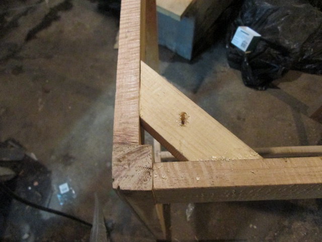

Seems to cut a decent enough miter.   Needed to make four corner blocks.    Drill a couple holes for screws, and then..
Countersink for the screw heads....A bit of Elmer's ( about out, too..) and a couple screws..
Glued and screwed in place..
Installed all four of them.....needed another hole drilled..

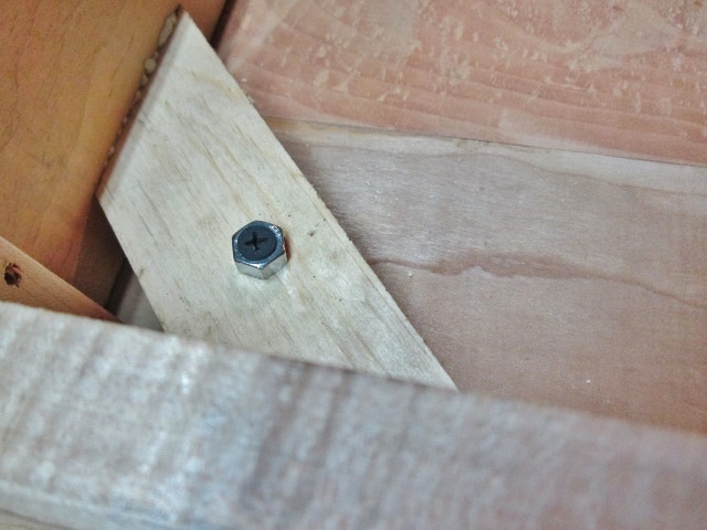

I drill a hole straight down, then rock the drill back and forth to make a slot for wood movement....Time to chose which side of the panel goes down..this one?
Meh...maybe the other side?
Looks a little better.....Place the panel on the bench, this face down.   Set the distances all the way around
Screws were a hair too long, anyway.   Nut allows the screw to tilt a bit as the wood moves. About to call the bottom half of of this desk complete
Will just have to do, for now..
