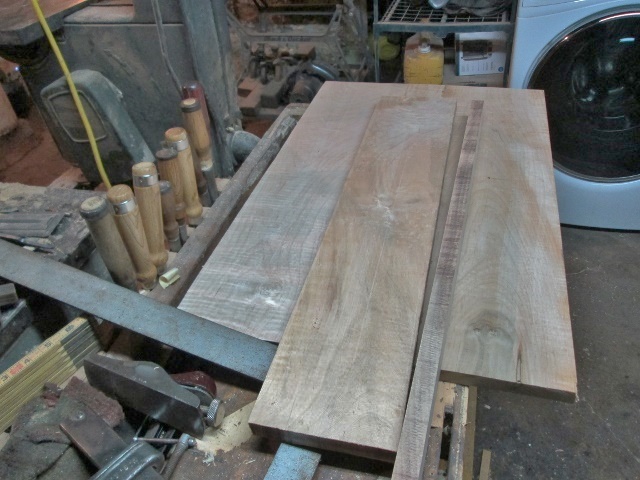

Ok, pictures?
Parts is parts.

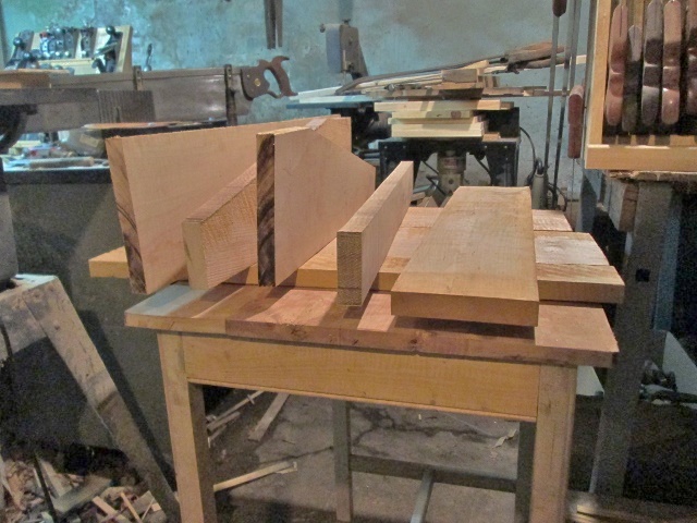

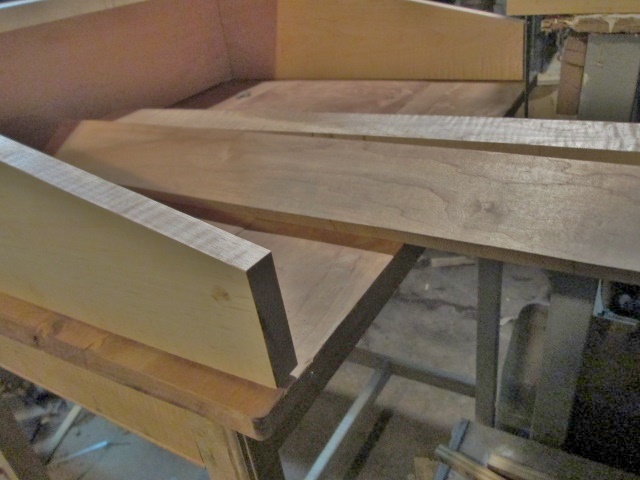

Front, two sides,and the back, sitting on the three piece that get glued up into a lid..
And a top "shelf" for the lid to be hinged into...as for the lid pieces..
I may re-arrange these a bit.....All of these need to be a LOT thinner, but..
This is not the tool for that job.   As for the wood itself...

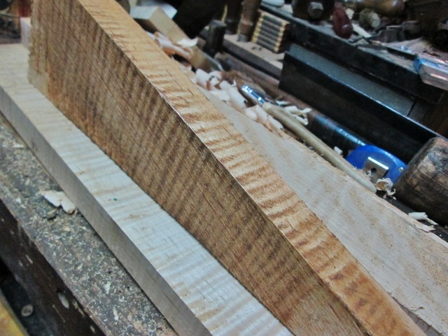

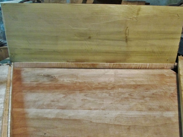

Beginning to think I have a batch of Tiger Striped, or Curly Maple.:o...NOT Cherry...one coat of Wich's Brew.
May have to change the name of this Project?:unsure:

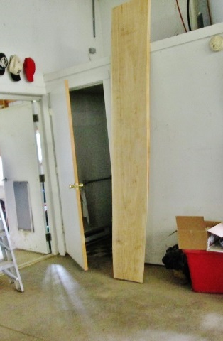

Tomorrow morning, I go and get these boards planed down to 3/4" thick.. right now, they are all over 1" thick.
Hope the van can carry all I want to plane...:rolleyes:

BTW: have been informed that I have both a Curly Maple AND some Flame Cherry in this stash..along with some Poplar...might make finishing a challenge?

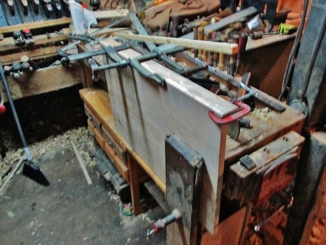

Needed cauls, front and back, this time around.

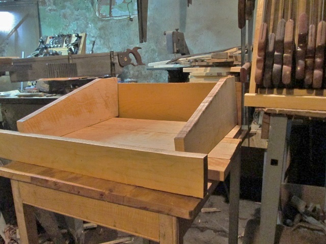

Will let this sit a while....laid out a few other parts..
Both sides, the top shelf, and a back.   High spot in the false top needs trimmed down.
And a front.   Need to get this cut to length ( might use that saw back there?) and do a few dovetails.   Then I can plane the top edge to match the angle of the sides....I hope.

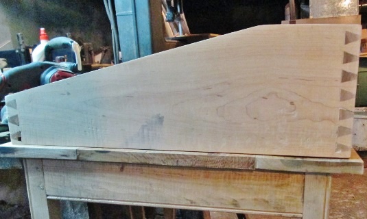

Dovetails are done for two corners ( see the Dovetail thread)  which leaves the other side's to be done..
Left side has the dovetails, need to work on the right side, next...

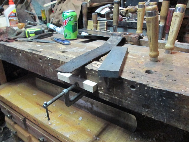

Lunchtime!  Maybe refresh a couple chisels?
Oil stone and strop.   Had one that needed a little extra work done..
Yes, that is MY  Mountain Dew.   Glue bottle is almost empty...need to go "shopping" I guess.
Some of the usual suspects?
Green Cap was applied to the strop.  White thing is a candle, works nicely when rubbed on the saw blade.

ok,try again..Corners are all done...#4 came out nicely, seeings how it was the last corner..
#3 corner...not so nice..

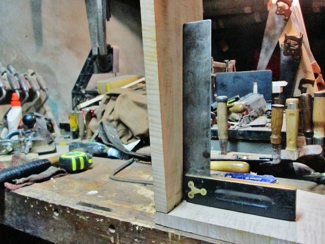

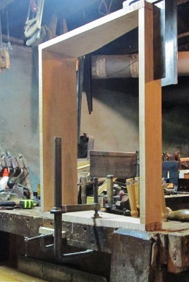

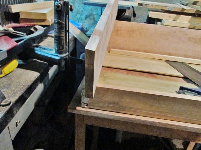

Dry fit to check for square..
One corner, then..

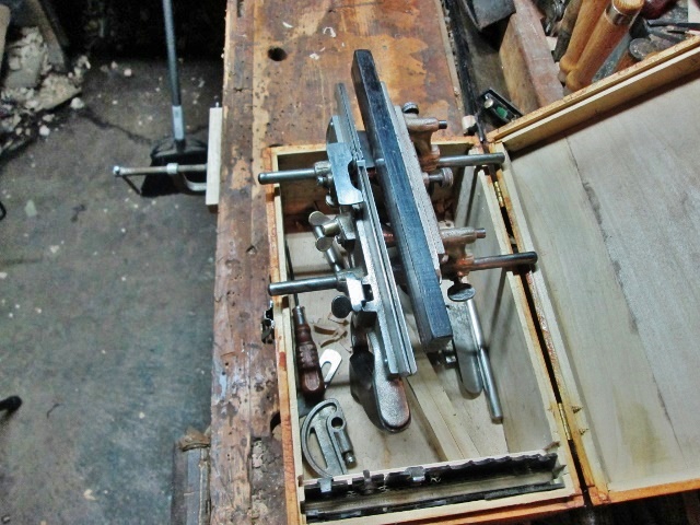

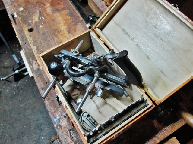

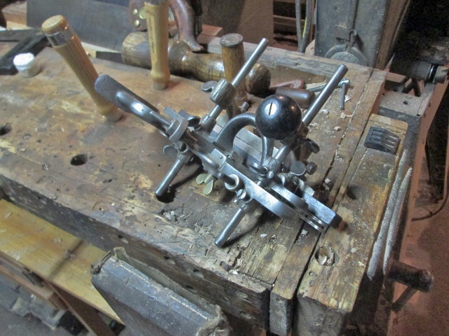

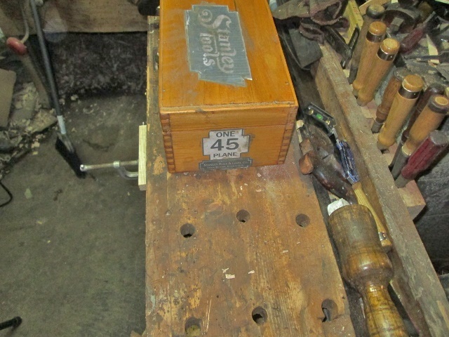

The other.   Looks good from my house...got out an old plane, and the box that goes with it5961a2532b498_Closedup.jpg.020649807ab8359f9e55425a7039cfd0.jpg
Needed to change out cutters..
Needed to remove the #23 Bead cutter, and install a #12 straight cutter..
Meant I also had to reset the sliding skate, and the fence.....1/4" wide groove, 1/4" from the fence...then close the lid ..
And put the box away.    Bench was cleaned off so I can start to groove the parts..later.

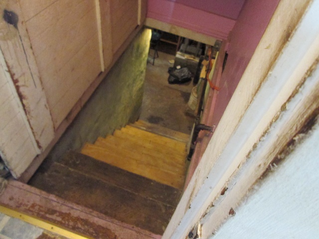

BTW...THIS is what I have to go through, each time I go to the shop...
"Down, down,down...in Dungeon Town"    ( sounds better than Goblin Town?)
Stay tuned...
Looks like the same path I take to my shop!

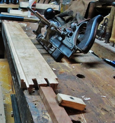

Grooves have been milled...twice.    Was having an issue with the skates on the Stanley #45,,,they weren't closing all the way up....had to change to a slightly wider cutter...
As the skates would get into a bind about halfway down the line....going to be one of THEM kind of days...

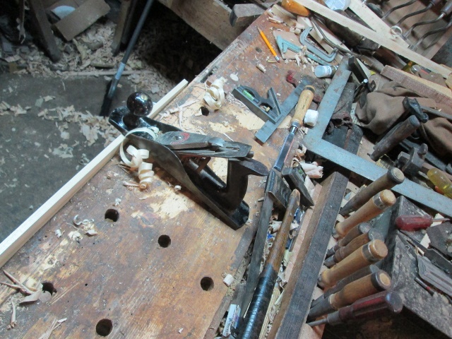

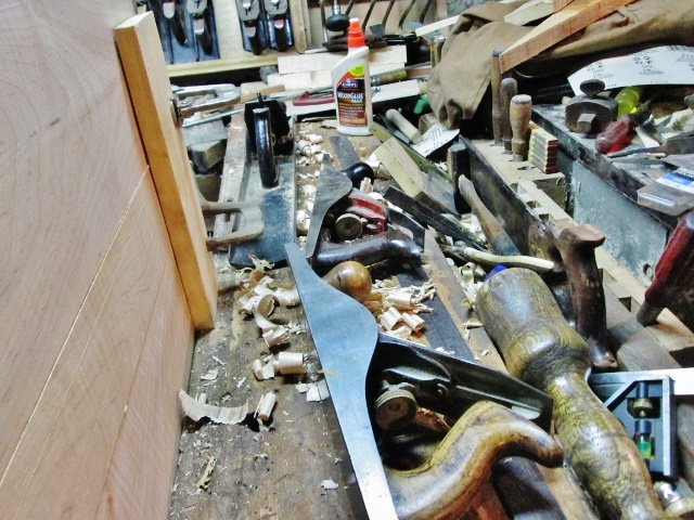

Cut a plank of Poplar to length, twice.   Length was right, just needed to square the ends...among other things..
Boards were also thicker along one edge than the other ( riff sawn?)   So I needed to plane the thick parts down to fit IN the grooves...
There is one problem with thin shavings, when you also have a fan in the shop..
They blow EVERYWHERE.    Speaking of everywhere....I have dried glue on about every finger and thumb...

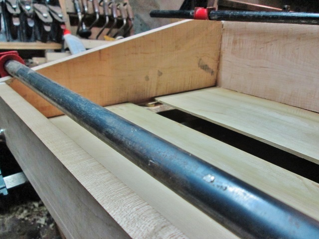

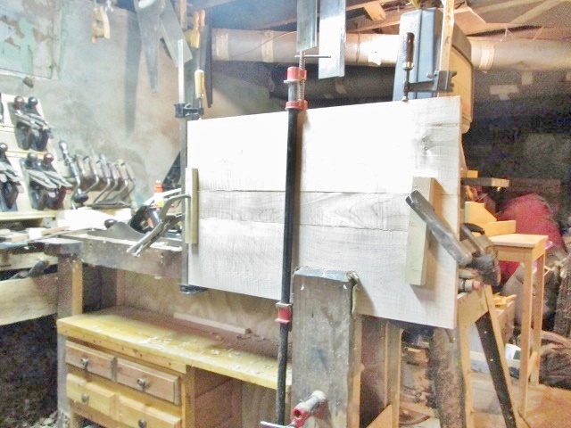

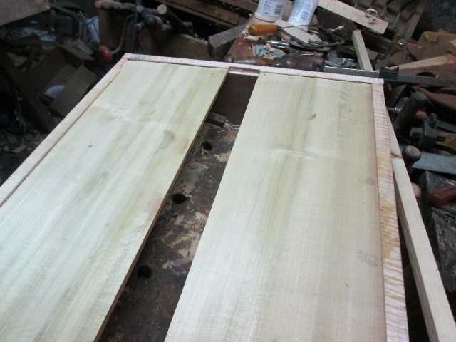

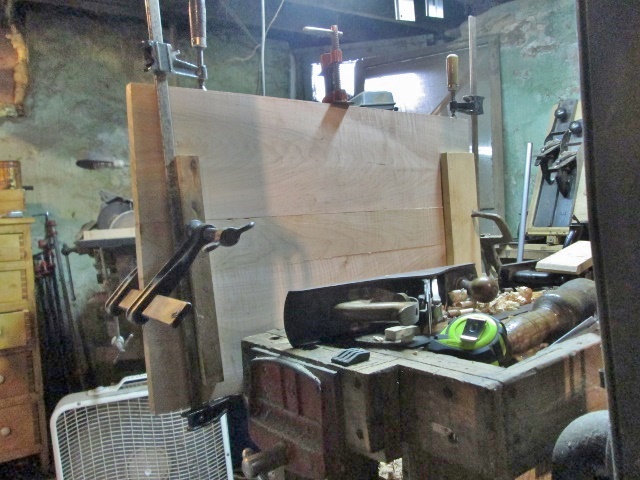

5 pipe clamps, couple of other clamps.  2 visegrips to keep the pipe clamps from getting loose.
Try doing all this with just two hands...
Discovered I needed that fifth pipe clamp right between these two at the back...and a caul/pad...really needed two pads, not enough hands on deck today.

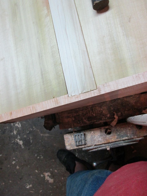

Poplar bottom panels need a filler strip between them
Both to fill the gap, and support the middle.   Long afternoon...time to rest the knee a while..stay tuned
Large pieces are alwayas fun to glue up by yourself

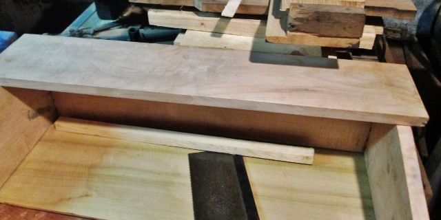

Some dummy snuck back inti the shop, last night.....and started working on the lid..
Tried out a new board for the top shelf, as the other one wasn't a good match to the lid.  The bevel gauge and the two little pieces of wood?   Well, after a visit to Roy Underhill's site,  I figured out how to make the joint between the top and the lid...as this didn't quite get it..
So, I made a full sized template, used the bevel gauge to set the angles, and made a guide...
Ok, that should work.   I needed to trim the ends to length and square....couldn't find my saw fence, oh well. we have ways..
Measure from the cut line to where the outside of the saw's shoe ends, clamp a straightedge.  Maintain pressure against the fence as you push that vintage saw along..
Yes, Vintage Saw.   Now, about those little pieces of pine?
I use them to set the bevel on the saw.    Lay out for the fence, again..
Then, same as before, make the cut..
Will need to plane the edges a bit..saw marks, you know.  Test  fit?

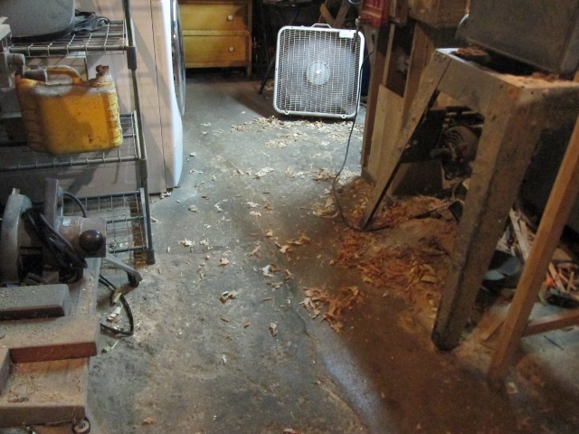

Some dummy was almost done working away, sweat dripping on everything. (in a basement?)  THEN he remembered,,,to turn on the fan..grrrrrr
Ankle deep in  shavings...at least until the fan was turned on....:o
Need to chill out for a little bit, before I get some photos and words posted.....
Fans...got to have them RUNNING...

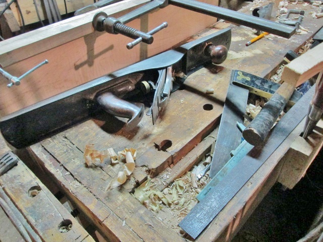

Got out a wider plane...
Now that a bit better.   This is a Stanley, Made in England No.4c, Type 20...

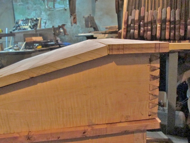

Will just have to do..for now.   Corners were rounded with the beltsander.  I set the lid aside for a bit..Have a gap to fill..
I cut out a spot, to drop in a filler strip.   It is thicker than the other two pieces,  Cut a slice out on the bandsaw, test fit showed it was a tad too wide...we have ways
The Millers Falls No.11, junior Jack.  Once the test fits were good...a spot of glue and a few nails..

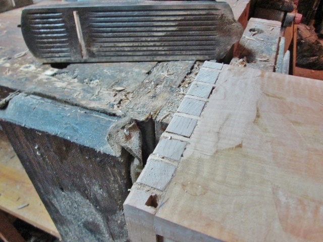

Need to hang this case in the vise...for the next hour or two...
Did this eight times.   Each corner needed a plane to level these..
Same No.4c.   Candle wax all over the sole...helps out, too.  That square hole?  Will cobble some small stock, and glue a stick in there...
Something like this one?  Smaller ends were a bit easier to do..
Once all of these were nice and smoothed out, time for the stand to be worked over...
A bit high in the center?   Stand is clamped into the vise.    Scrub jack to remove most of the high spot, mainly where the case will sit.  Got this end looking level, turn things around..
And check the left side....set the case aside, again, and go to work on the high points again.   Had a knot holding things up....finally was able to install one screw at each end of the filler strip, and set the desk aside..
Set the lid and top shelf in place, for a dry fit.    waiting on Friday to get a few hinges, and something to apply  as a finish...getting close  to the end..
Plain BLO?    Amber Shellac ( Bullseye brand)?   Gloss Poly topcoats....stay tuned
I have a question and I'm not trying to be a wise a$$.
Why did you make the bottom like you did? I mean why did you add the center piece instead of making the bottom a full 3 piece glue-up?
Thought the first two pieces were wide enough....Board was about 1-1/2"  too narrow....
I'd rather not have a solid wood panel for a bottom panel.  The three pieces are not glued to each other.   Damp basement will mean the two large ones will shrink a bit...when they come out to a drier area.   Didn't have any 1/4" plywood big enough, either.
So, the loose panels can move as they want to....and not bust out a back....
