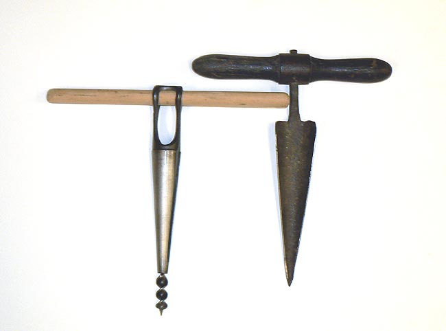

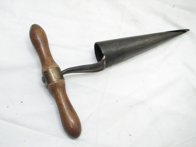

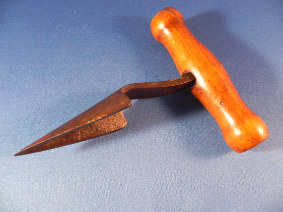

adze... wood prep as in logs to lumber segment..
bung auger.. tapered holes hand drilled used on wooden wheel construction to make the sockets for the spokes to wheel rim (or felloe) and hub connections... also for the for the the dove and king bolts used in wagon/skid/toboggan/carriage manufacture..
for timber frame pegging.. the pegs were tapered w/ a spoke shave which made the pegs slightly irregular which insured a tighter better holding peg..
taper pegs ''draw/tighten'' up the joint....
clean tapered pegs pop/back right out as where the irregular ones put up and argument and often had to be drilled/bored out of their sockets w/ a larger dia bung auger...
and why not use on chair stretchers and major joint pegs.. saw this type of construction touring Dutch and German museums... the Romans used it (Italian Museums)...
sharp rocks... humor but I'm sure flint tools were used prior to bronze and steel tools...
dull stones are the original sandpaper...
bung auger/reamers...
58a8b729328f0_bungauger1.jpg.6f4a7db03c1e44fb2ddd91a2bc671f30.jpg58a8b72a5955c_bungauger2.jpg.213d07612a70adf8324ea8d0a6c765dc.jpg58a8b72b729a4_bungaugerreamer.jpg.d2c8f332c0a0a331b4bfb490bfbef98b.jpg58a8b7280d8d6_bungreamer.jpg.d90745be3a0ef76b669ca447dee94a49.jpg

the hollow bung (cone) reamers w/ the offset handles or pass through handles cut the matching tapers internally...
think pencil sharpeners...

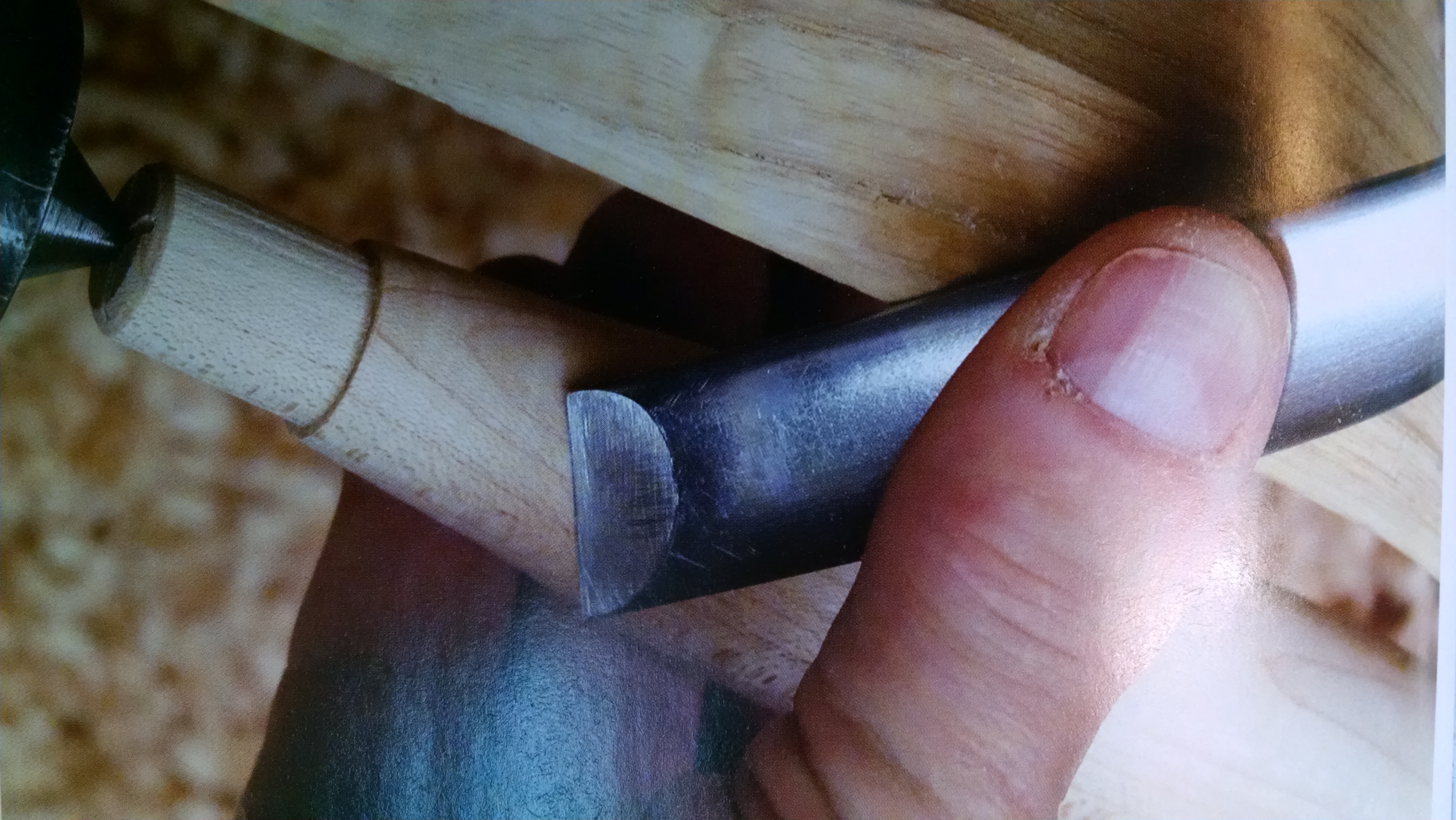

Here is what I am accomplishing at this point on my lathe, the shouldered round tenon.
Source: Unknown, but not my finger or work, but it's exactly what my rungs look like at the lathe. Now you know why the spoke shaves do not work for these type of tenons. While the shaves will work for creating the actual rung.
Nothing tapered. I am getting pretty efficient at this point creating them on the lathe, but with a tenon cutter like the one pictured in my original topic, would cut the tenons more consistently.
What it comes down too it, I just need to turn about 100 more chair rungs and I'll have the tenons down pat. I'll end up making my own as my searches have pulled up nothing either.
