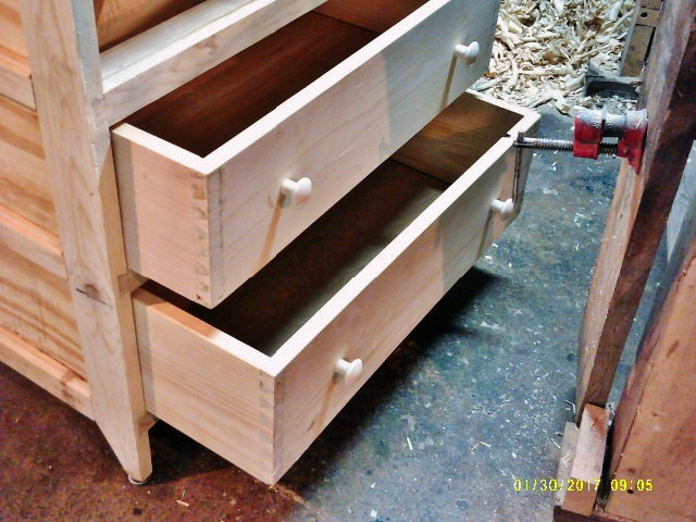

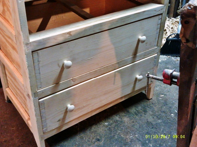

Next three drawers should be a little easier...they are built using a 1x6 plank.    Second drawer is out of the clamps, sanded, and the knobs installed.....not much will happen today, being this is a Monday....:angry:

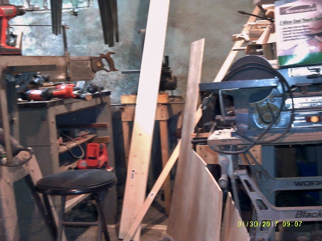

This is basically how the Dungeon Shop rolls nowadays.....no room for the biggie power tools.    Dovetails...I just am practizing..:rolleyes:
At least they do open without any binding..

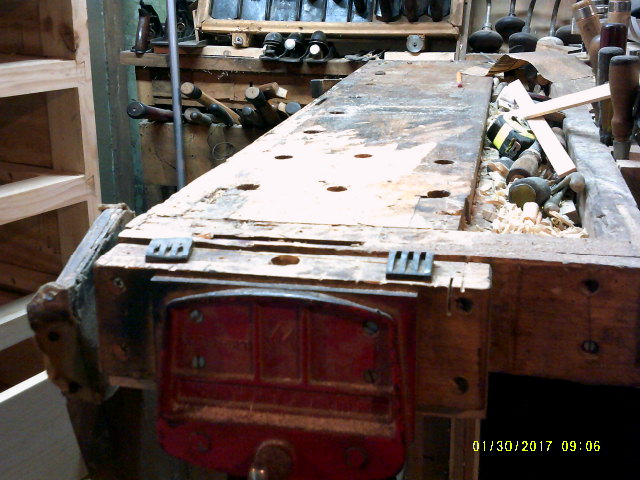

The way the bench looks on a Monday morning

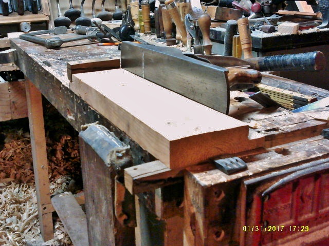

As I don't like to work on Mondays.....so, this 1x6 will just have to wait..

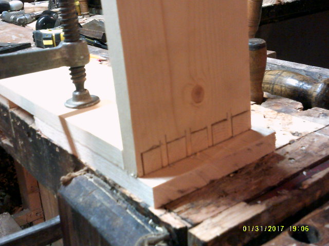

well, the next thing I know, I'm cutting dovetails.....since this is a 1x6, meant there were fewer to cut/chop/cuss... just when I thought I was done...

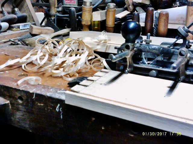

Something with a bunch of Blonde Curls was calling my name......and then a dado was made....then the back board was cut to size....then after the second try, a bottom made of plywood was ready

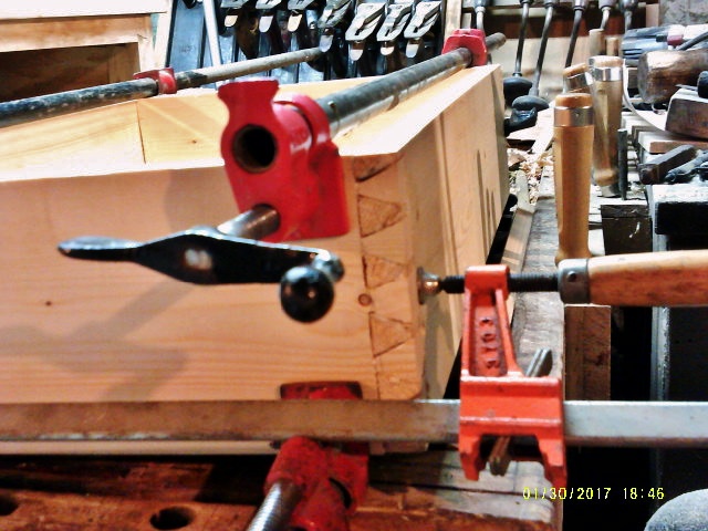

Grabbed the clamps and glue bottle, and put this together.    3 hours and 15 minutes of shop time done.
Helps when there is as many of these to do......Drawer #3 is awaiting the glue to dry .....I think I may need another nap...

I have a learning question.  The width of the pins and the the angle of the dove tails.
Any standards to go by or does it not matter?
The ones pictured look plenty strong.
I am just wondering about spacing and angles and such.
I tend to make pine ones a little bigger.
Spacing is by MK 1 Eyeball, and is tied to the width of the chisels I have.
I have an old 1/2" router bit, that used to do dovetails for me.   Not sure what degree it used.   Might be a 14* one?
Roy Underhill usually uses a 1:6 angle for his.    Set up with a square, where one spot on the bevel gauge hits the 1" mark, and the other hits the 6" mark.
Myself?   I'll lay the old router bit on the end grain of the board, and mark a line along the cutting edge of the bit,  that becomes the angle I set my bevel gauge to.
Another thing on spacing by eyeball....I start towards the center from each direction, and adjust the center one to fit in.

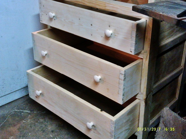

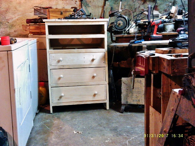

If I take the camera to the shop, to get a picture of the latest drawer.....I might as well stay down there and do #4......Hmmmm, maybe after Chili & Rice for supper?
Took the camera to the shop....
And moved this over out of the way.    A better view of the drawers?
getting there...

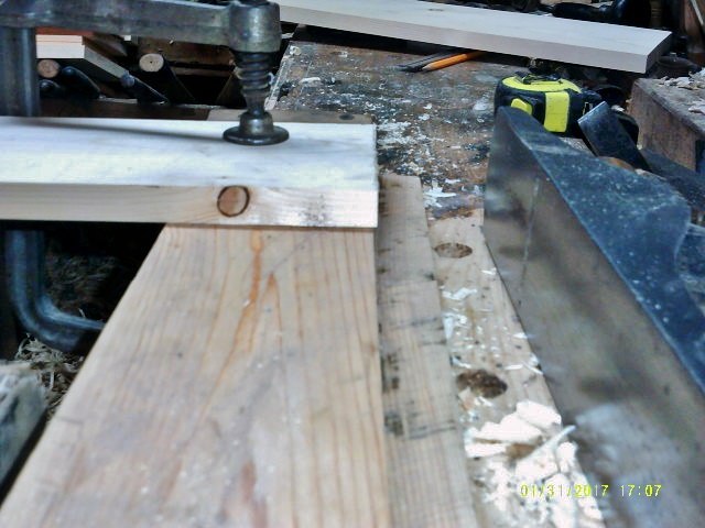

Crosscut the next plank,  sides were jointed together..

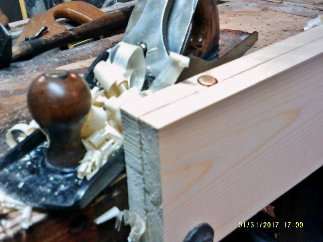

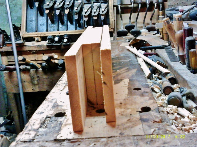

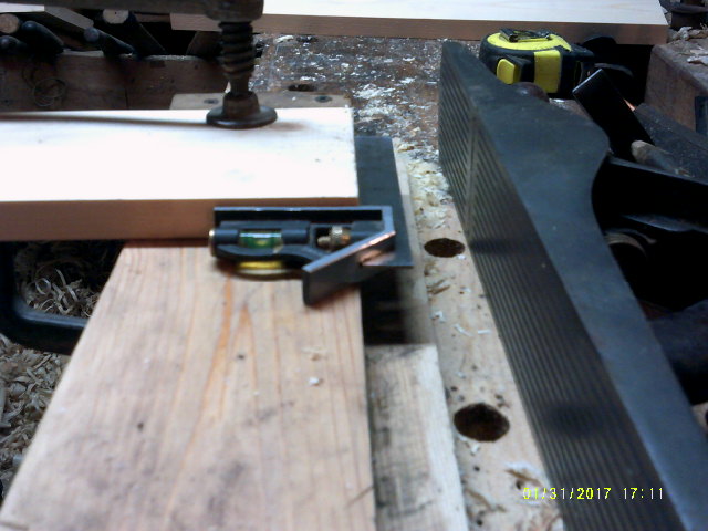

But there was a problem with the ends.   Not only not square, but a little curve in there...got out an older jig..
Nothing real fancy, called a Shooting Board.   I can use either the #5-1/2 or the #6c to square an edge.   First I need to clamp the bad end in place..
Then run the plane by until things are square up..

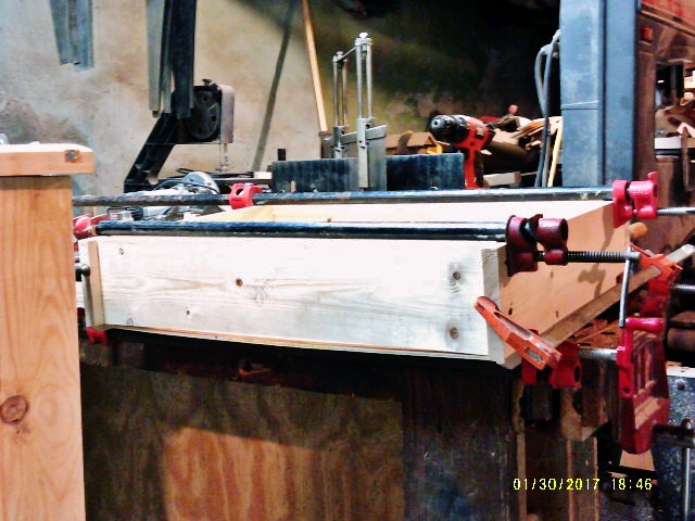

Something like this.    I then did all the usual stuff, after resawing the front and sides to the correct height.    Got the dovetails done..

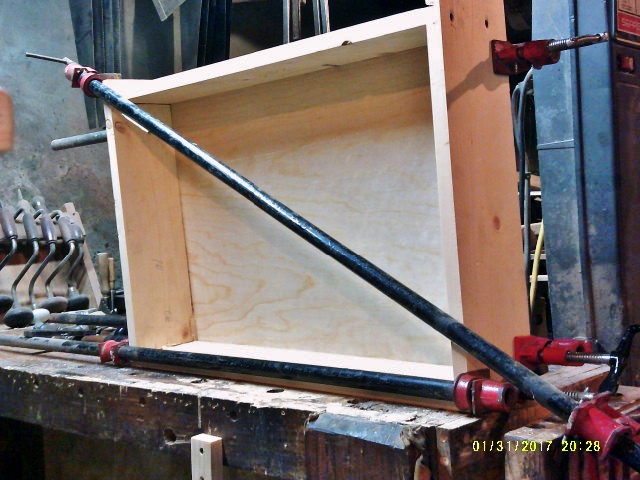

ran the Stanley 45 around for the grooves and dados.    Got the glue bottle out ( a NEW bottle!) and a bunch of clamps..
The diagonal one is to pull the box into square.   Screws were added to hold the back in place better, including a few through the bottom and into the back.
Will let this sit a long time....I am plumb tuckered out.   And...not even a beer in the house....maybe I can get the handles on this one...tomorrow?

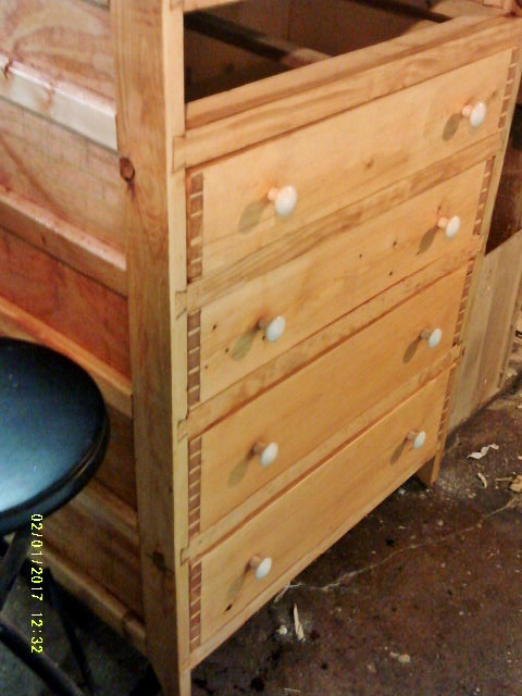

For the assembly of the drawers in the case as they now sit they appear to not be centered in the opening.
Are you going to center them?
Might add a guide strip, here and there.

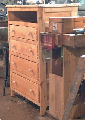

Drawer #4 now has it's knobs installed.    First coat of the Infamous Witch's Brew is on the top, the front, and one side of the project.   Letting the mess dry for the day.  Maybe, I might get back down there tomorrow, and add more of the "finish" as needed.   Even the camera is taking the day off, today.
Did I mention I hate the smell of BLO in the morning?
Edited by steven newman
Into every life a little rain must fall. Or.. you can't make an omelet without breaking the eggs.
Eagerly awaiting the pictures. Wash your hands first, though. Don't know what that witches brew will do to that new camera.;)
This is a test, only a test..
The side by the #45 box hasn't been coated,,,yet.
This side has been coated.   waiting on the stuff to dry...
