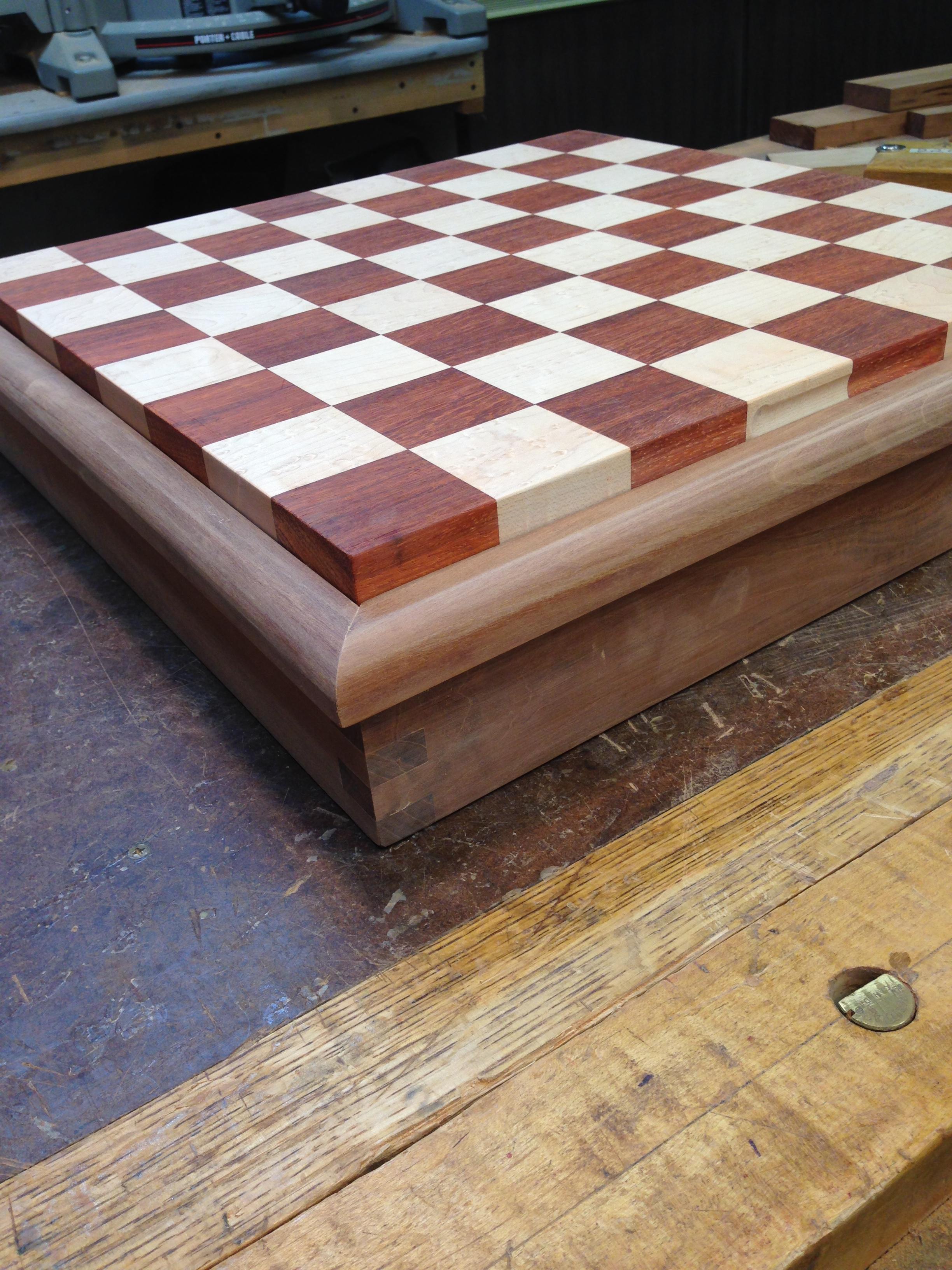

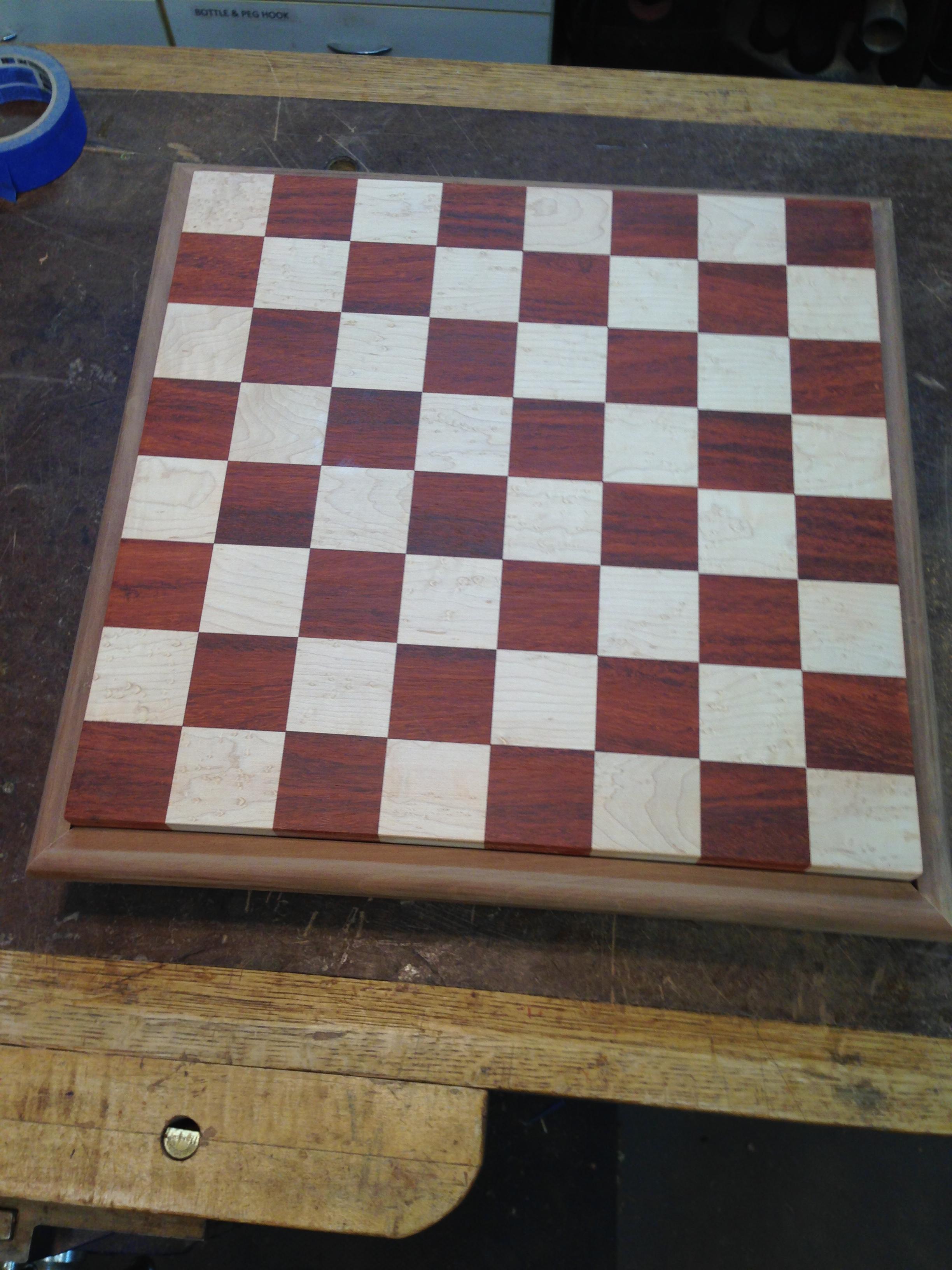

Got the box ready for finish today. As usual with boxes had to adjust the board to fit the recess and cut finger slot to lift board. Tomorrow will make the grid for the box to store playing pieces.
Very nice Gerald.
That is really, really nice!
Looks great Gerald.

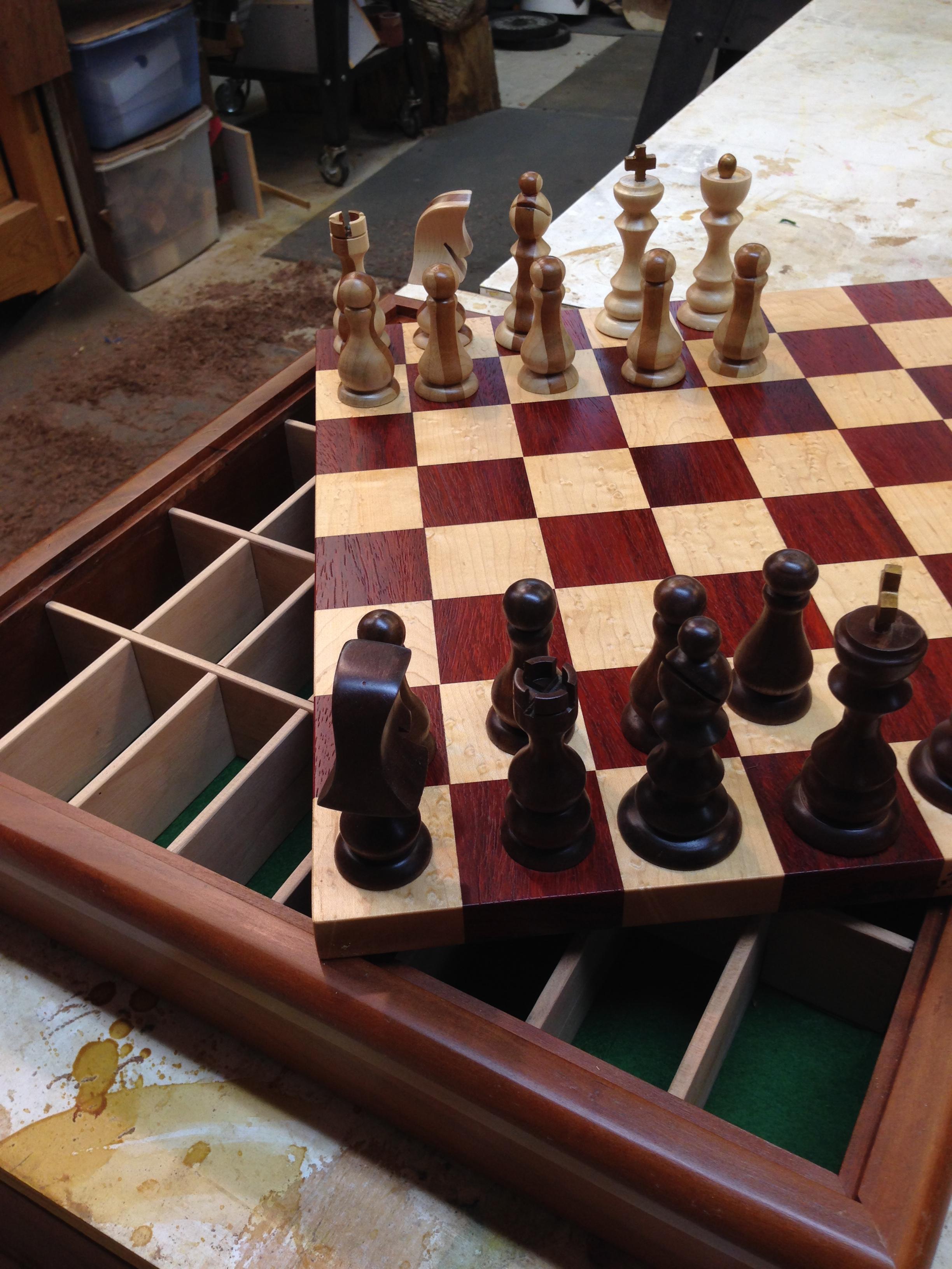

All is done except felt on bottom of the men. Better pics later in gallery.
Outstanding work Gerald. Turning several items to match is not easily done, impressive!
Steve
Very well done.  The turnings, the board, color choices and finish are all beautifully done.  Kudos, that is a lot of work.
Thanks for all the comments. Doing the felt on the bottoms today and will do better pics next week for the gallery.
 Beautiful choices of wood & the case came out great.
