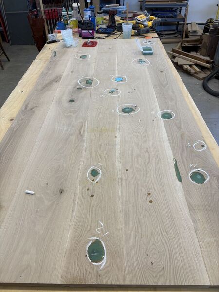

today was epoxy day. mixed up a nice batch of epoxy and turquoise dust (8 oz of each A and B, 2 oz of dust, seemed to be a good ratio). stirred that very well for a few min, and then filled in 13 hole/knots from the underside. top side was taped off with clear packing tape. a few of the holes were very small, 1/4" or so, so i used a syringe to inject some epoxy to make sure they got filled up nicely.
takes at least 24 hours to cure up, i'll give it 48. the excess on the underside can be sanded off, and any leakage on the top side can also be sanded off. gonna look cool. then have to make the apron boards before making the legs, and at some point, stain and poly (golden oak and flat/matte poly).

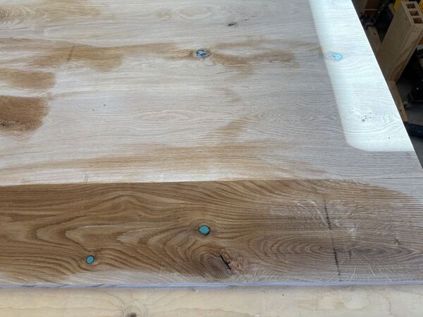

after about 18 hours, i checked the epoxy pour this morning, many had leakage over night, so made up a second batch of epoxy and turquoise dust to fill in the voids, will let that cure until sunday and then check it and reveal things. this is the slow part. routing the edges is the fast part.

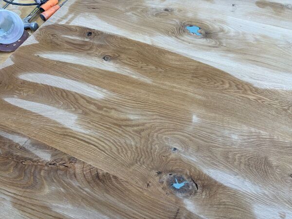

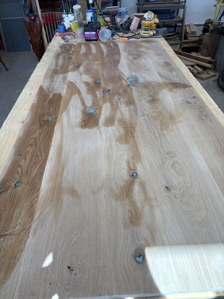

excess epoxy sanded off, wiped down with mineral spirits.

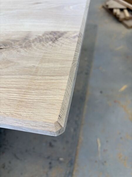

yet more sanding today, and some routing of the edges and corners. had one hiccup near one corner, had to do some aggressive sanding to get rid of a splinter. if you look closely, it doesn't match everything else.....so don't look closely. duh. it's "rustic", give me a little leeway.

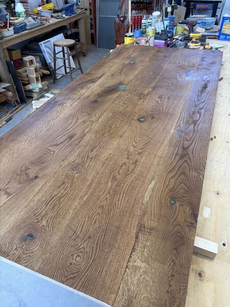

little preview, this is the underside stained (golden oak on white oak).
need to make the aprons and legs next, get them stained and attached, and then flip the mess over and stain the top side (after a little more sanding).
