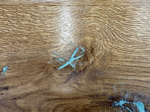

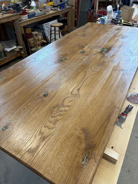

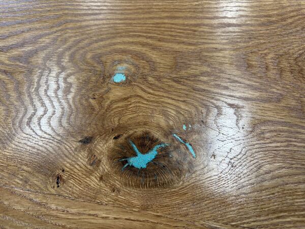

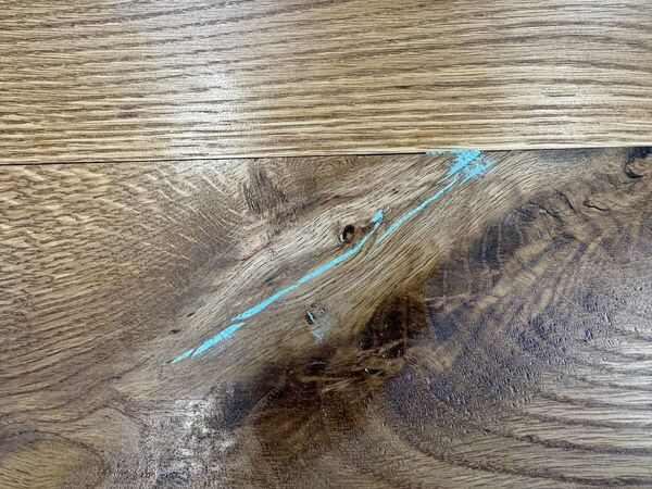

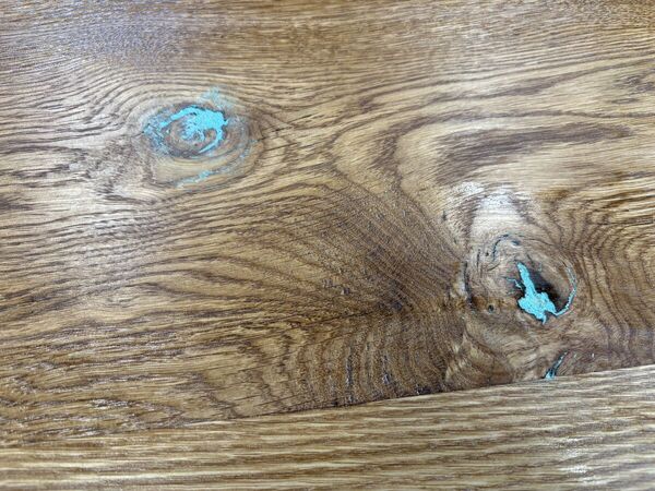

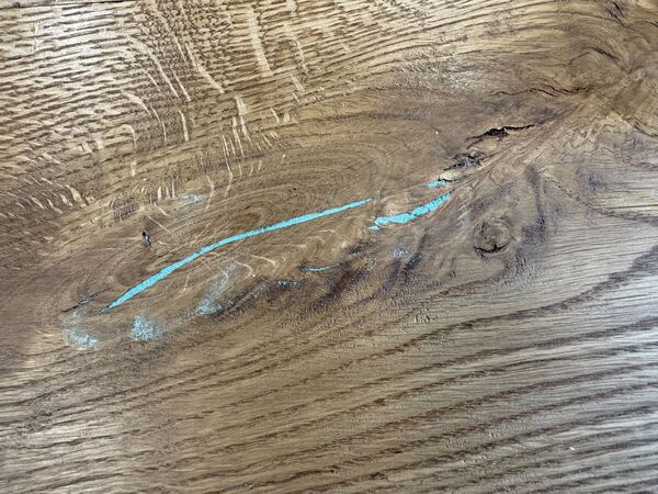

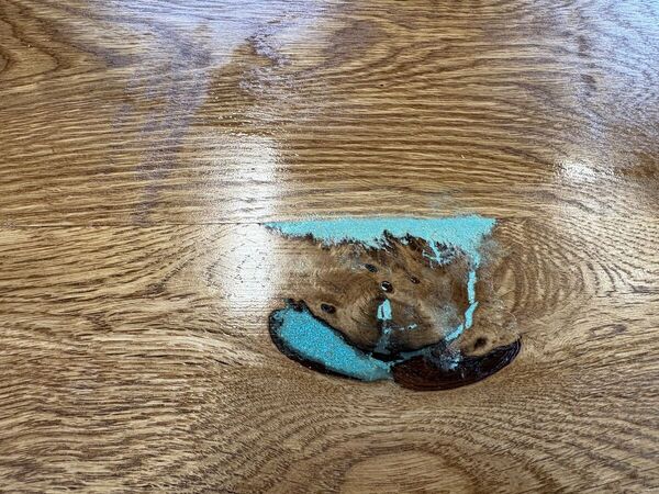

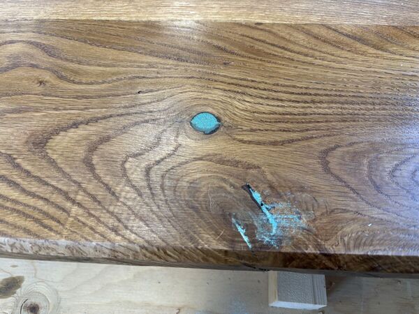

first coat of finish on the top side. added a few more little spots of turquoise yesterday, mixed a paste of dust and poly, then scraped it into small cracks and holes. ended up with 34 total areas with turquoise accents. a sampling:

got the table delivered and assembled yesterday, they love it. next: pair of matching benches. final dimensions, 91-1/2" long, 40" wide, 30" tall.
there is 81-1/2" between legs on the sides, so i'll shoot for making the benches about 77-1/2" long, so you can tuck them under without too much banging of the legs.
