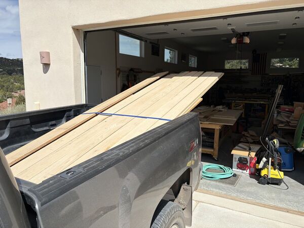

went shopping today, got some red and some white oak.
she likes the "rustic" look, so we bought all their rustic white oak for the table top, everything else will be red oak. plan to fill in the knots/holes with 2 part epoxy and some turquoise dust. it's a thing out this way.

  • she grabbed a pic of me and the lumber all loaded in the back of the truck. told her to send it to hubby and explain "all you have to do now is put it together", just like IKEA....well, maybe some ext

she grabbed a pic of me and the lumber all loaded in the back of the truck. told her to send it to hubby and explain "all you have to do now is put it together", just like IKEA....well, maybe some extra steps involved. more work planned tomorrow, to get a straightening sled made and get the table top pieces straightened on the edges and ready to glue, after a light pass or two thru the planer. need to pick out the exposed sides. 2 part epoxy ordered, with some turquoise dust to mix in. will try a trial piece before attacking the top. she thought that that would be cool. ok.

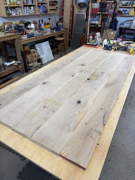

today's progress was getting the table top pieces edges straightened.
lacking a large jointer, plan B was to cut a scrap piece of 3/4 ply to 8 foot long and 12" wide.
then can attach that with some temp screws to the underside of each piece, run the plywood against the fence (set at 12"), and rip one edge straight. then can detach the plywood, flip the work, and run it again thru the TS to final width.
12" was wider than any of the pieces, so i knew i could run the ply against the fence and get a straight cut.
test fit up, looks like it will glue up just fine, will use some biscuits and a caul or two to keep it flat.

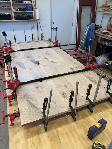

got the table top glued up this morning, will let it cure all night. then much sanding and then fill the knot holes with 2 part epoxy mixed with turquoise dust. it's going to look cool.

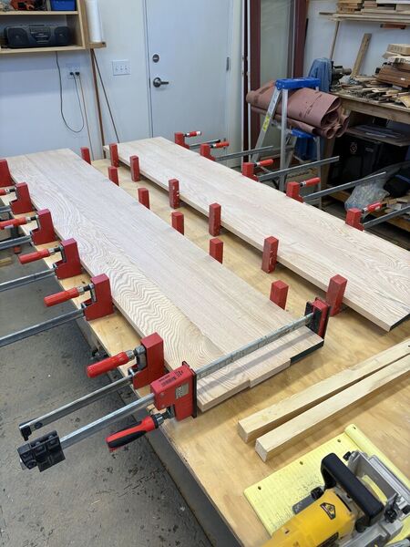

after too many delays, finally got the top out of the clamps. scraped/sanded off the glue squeeze outs, turned it over and gave the underside a good sanding with 36 and 50 grit on the belt sander, chiseled out a few spots of glue. this top is incredibly heavy, almost too much for me to move around. more sanding tomorrow, both sides, then trim the ends off, chamfer the corners and edges, and then fill the holes with epoxy mix. after that, prep and attach the apron/skirt boards. then figure out where to put it while i work on the legs. ugh. this is the under side of the top.

it's about 40x92, so almost the size of a sheet of plywood, but 1" thick of solid white oak. ooooofff.
