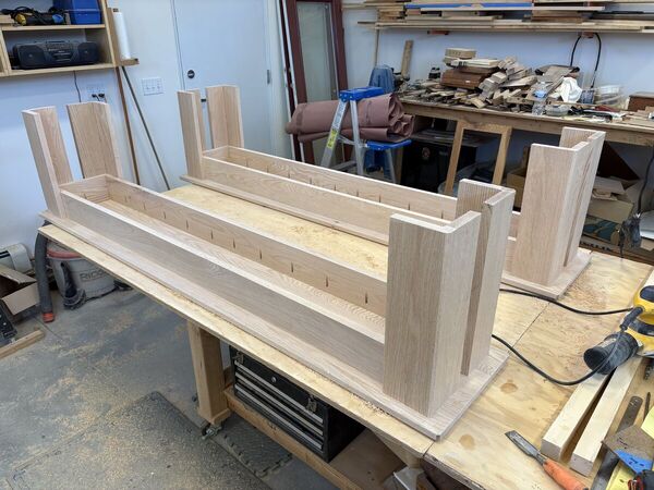

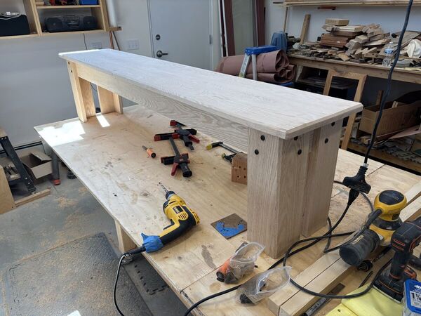

final sanding of tops and aprons done, aprons attached with pocket screws, edges and corners chamfered with a router, legs cut to size and outside corner chamfered, need to drill holes for connecting bolts, do final sanding of legs, and then stain everyone.....time for a break. ooooh...soccer!
legs attached with connector bolts, need to take back off, do final sanding on the legs, then stain everything. another day. i'm pooped and it's hot out (i don't have AC).
and those benches are fairly heavy. built to hold a large load.

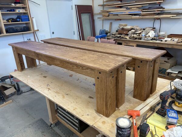

stain day. did i mention i hate staining?
and then it turns out the stain makes my gloves fall apart....sigh.....at least it washes off mostly. little brown finger.
poly tomorrow.

minwax golden oak (jar is between the bench tops in distance). thankfully, only have to do one coat of stain.
got some clean wiping clothes, 4-5 folded together, dipped into the can and wiped on. the dry part of the cloth is good at picking up excess and evening things out. one set for the bench tops, fresh material for the legs. it's even, i'm happy.

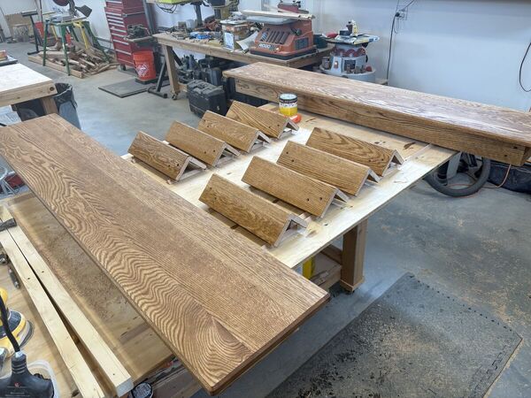

got the first coat of poly on this morning, it's a flat finish, so with the dry air and the fan on, it dried up pretty quickly, the wet sheen you see when you put it on disappears pretty quickly, but i know i covered all the surfaces. second coat in a bit when the soccer match is over. 3 coats planned for the seating surfaces, just 2 everywhere else should suffice.

second coat of poly on this morning, 3rd, and final coat on the top of the benches only tomorrow. then deliver monday or later, depending when they have time.

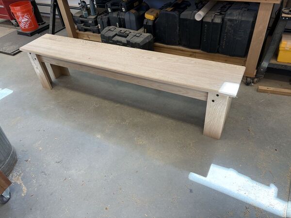

benches are done, deliver later today.
Those turned out great DAB, family heirloom for sure.

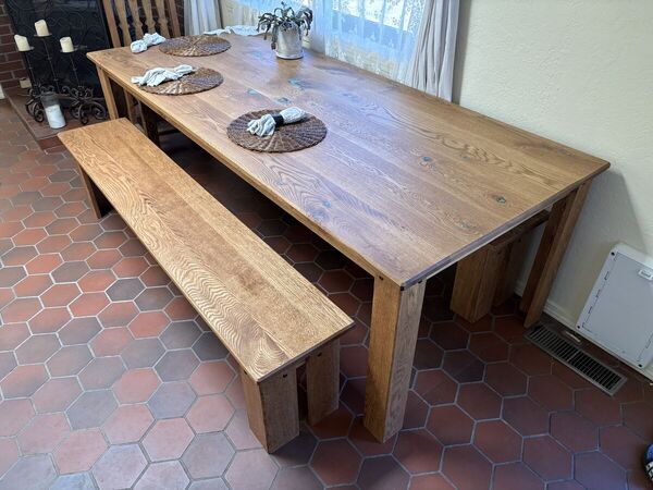

and delivered.
Really looks good with the table. Bet you are glad you don't have to lift those anymore.
Don't know how I missed this, Doug, Beautiful work!!
Looks like it will be part of those triplets life as the grow up.
