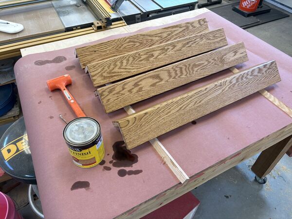

got the apron drilled for pocket screws and stained. attach tomorrow.
then start making legs.....

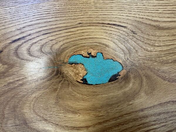

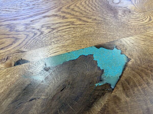

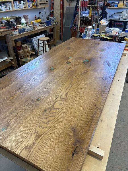

got the apron attached (sorry, no pic), got it flipped over and got the top stained. overall shot and some close ups of some of the epoxy/turquoise dust infills. total of 13. i think it's looking awesome....
it's going to take 2 strong men to move this around.....ugh.....what dummy designed such a heavy table??!!

IMG_7886.jpegthe gremlins didn't let me post the overall shot. maybe later.....grrrr....
Edited by DAB
Those inlays look awesome! Definitely a family heirloom.

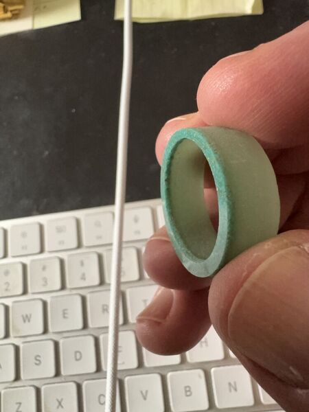

to my pleasant surprise, the turquoise dust has some gold colored flecks. by pouring from the backside, the heavier, larger pieces, including these gold flecks, sink to the bottom, which then makes them very visible when everything is turned over. the "pretty" layer is only about 1/16" thick (as i know from pouring excess into a mold). so useful info to know later.
when it is time to put on poly, i'm going to try putting a little of the dust into some small cracks with the poly.
here's a shot of a ring i made from some of the excess, you can see how the larger stuff separates.

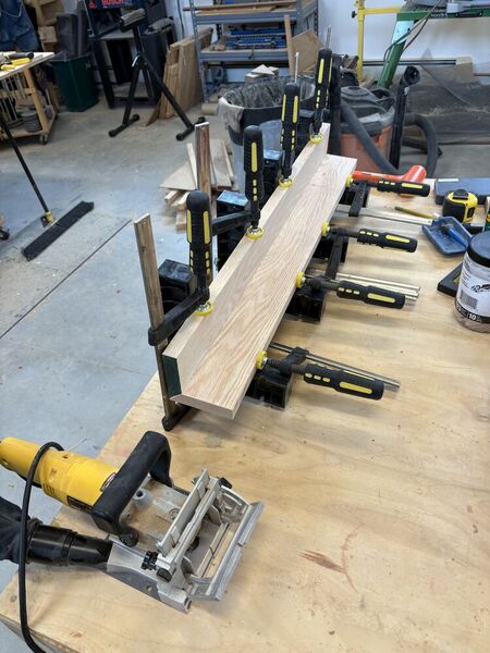

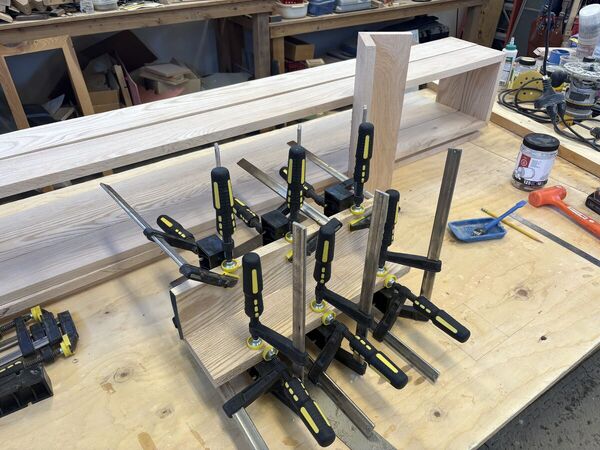

little branding today, and started making the legs. not enough Ls to glue up all 4 at once, so apply 13 clamps to one leg and do more later/tomorrow.
made them a little longer than needed, so i can trim the ends square and true and to proper length. four #10 biscuits per assembly. the outside corner will be chamfered later.
The more clamps the better!
Project is really progressing.
arrgh, it's a pirate table, only has one leg!!
need to sand, cut to proper length, and stain and drill bolt holes, but you get the idea.
#2 gluing up, should get them all glued up today, one every 2 hours.
and by leg #3, i figured out a better way to draw the joint nice and tight. use the clamps to draw it into the clamping square. duh....

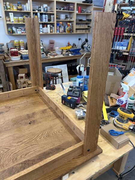

we've got legs!
four in fact. cut to length, sanded, and stained.
poly tomorrow or friday for everything. bolts i got were too short, longer ones should be here sunday. oh well.

the bolts arrived, 2 sizes, as i wasn't entirely sure which size was correct. the smaller one was it. 35mm long. now i have 142 bolt sets extra (50 too small, 42 just right-only used 8, and 50 too long). sigh. at least they are cheap.
got the legs fitted up, a 3/8" hole was a little snug, so up one size.
took them back off and flipped to start finishing the topside.
