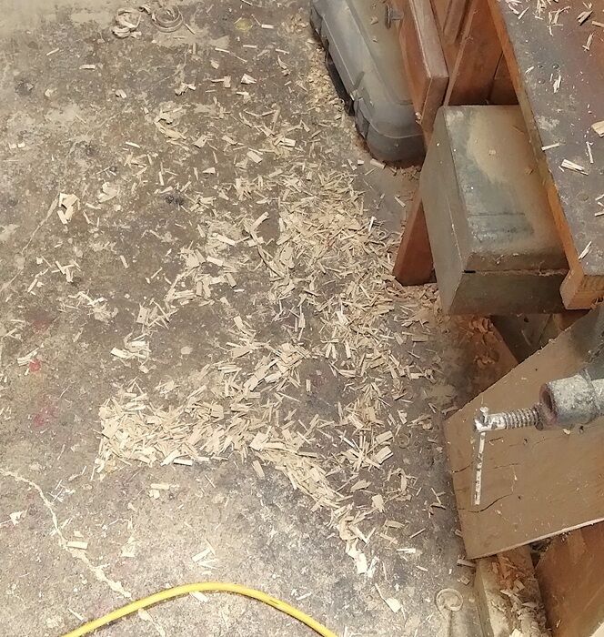

Tends to make a mess of the shop floor, too

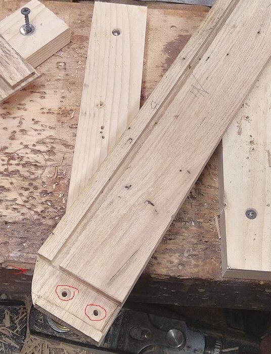

Have dado for 3 drawers done...

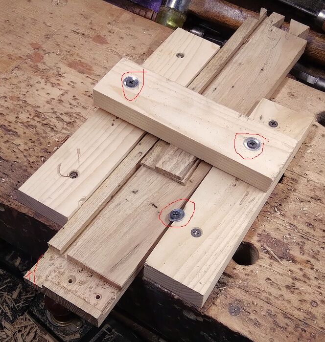

Had to add a few washers...not too worried about that blown out corner..
Called a Starter bevel..makes it easier to slide a full drawer into a case...pilot holes were drilled...counter sunk on the outside face...

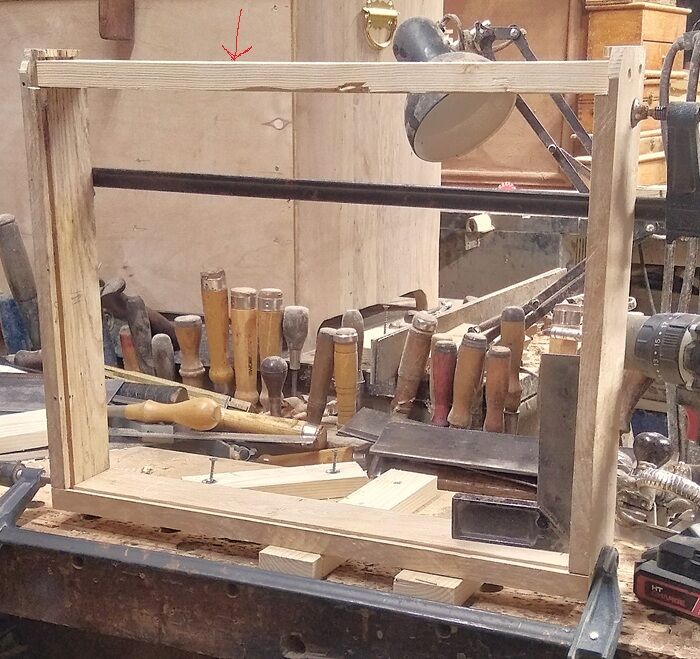

Have cut enough Pine to make 4 out of 5 drawer backs...test fitted one...
To make sure it was the correct length...

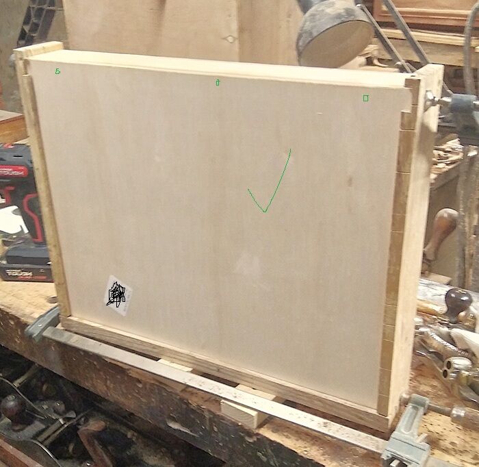

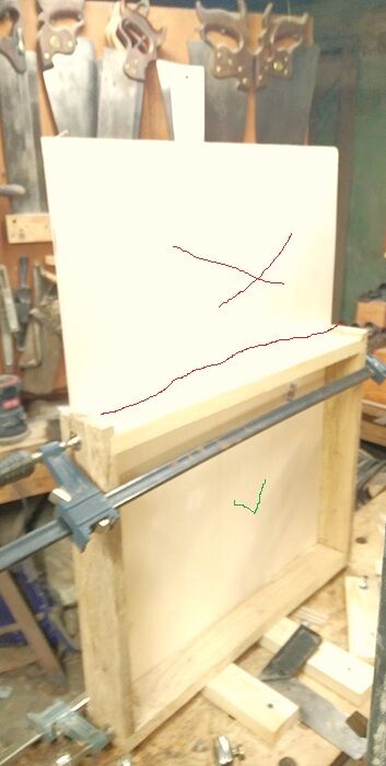

Plywood panels are cut..enough for 3 drawers..so...
Ah wun...
and ah two...

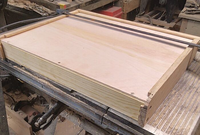

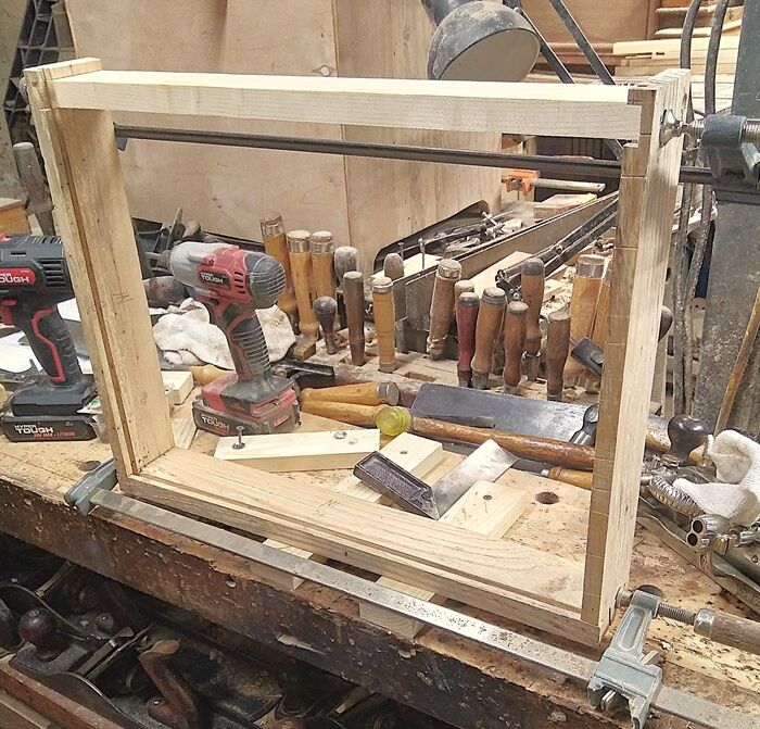

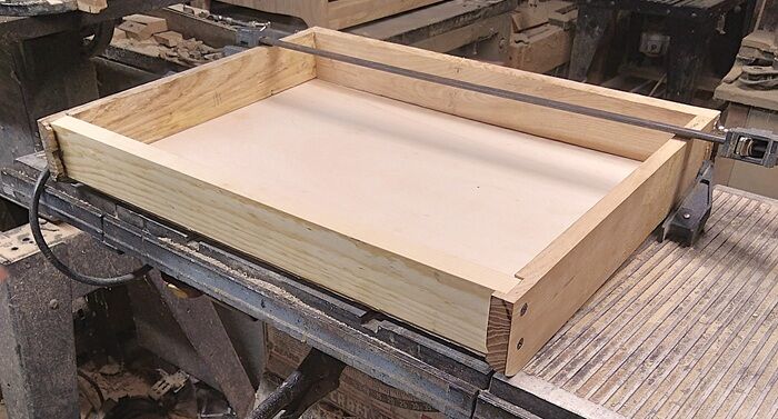

Sept_Proj.Drawermakingunderside.jpg.175c0e903a619a000226c0dae28fd087.jpg3 screws and a bead of glue to fix the panel in place..drawers do have a bit of toe-in towards the back...glue  and screws to join the sides to the back..clamps at the front ...
and ah three..

Sept_Proj.Buildadrawerdryfit.jpg.9f0732da72c1262e00ed6e04aa66e0e1.jpgStill have 2 drawers to get assembled...so...

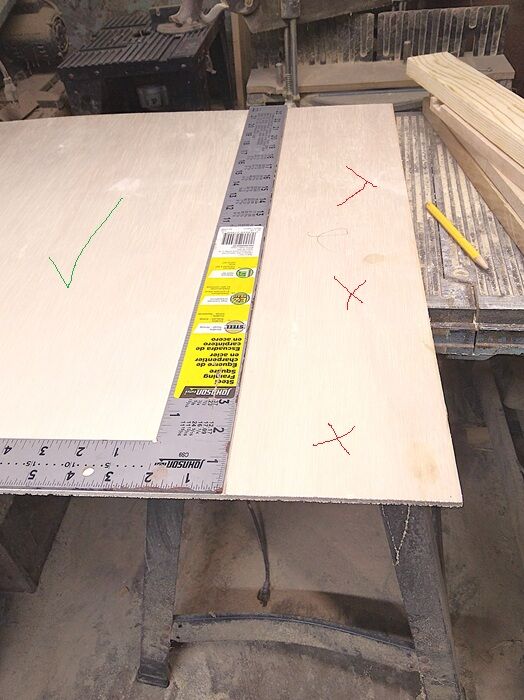

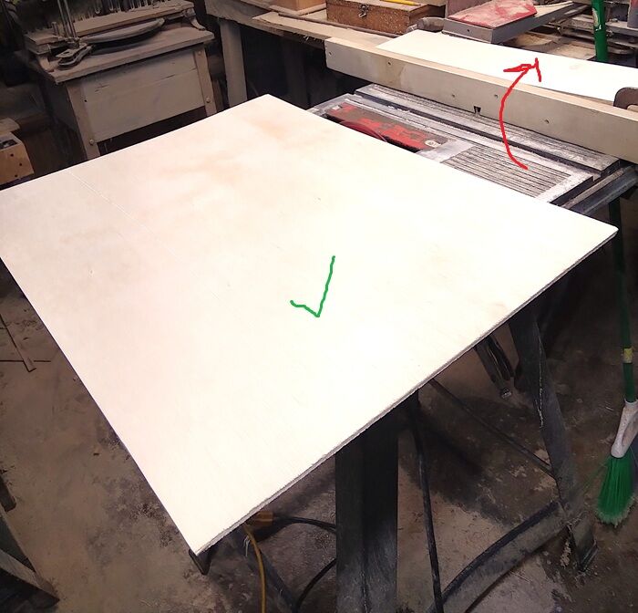

Marking a panel for width...
Square the mark across the panel..helps align the rip fence...
Ran both panels through...save the cut-offs for another Project?

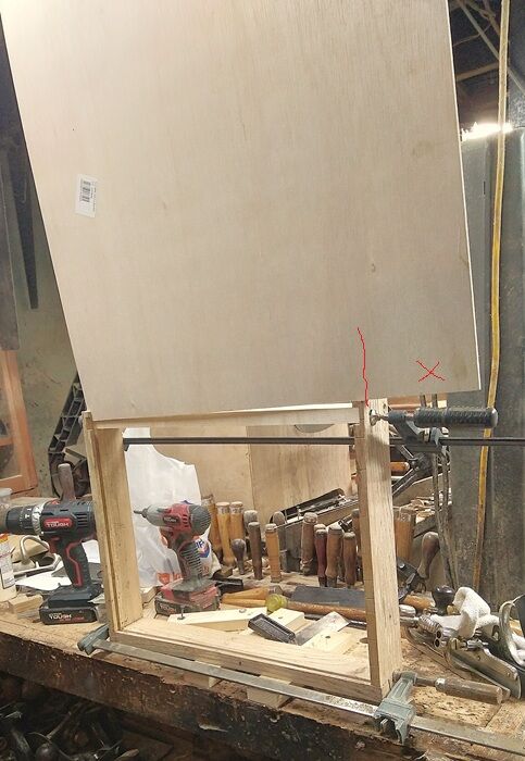

Slid a panel into place..
Make sure it is fully into the groove in the front of the drawer...mark how much to rip off..again. set the fence, run both panels through...test fit one of them..

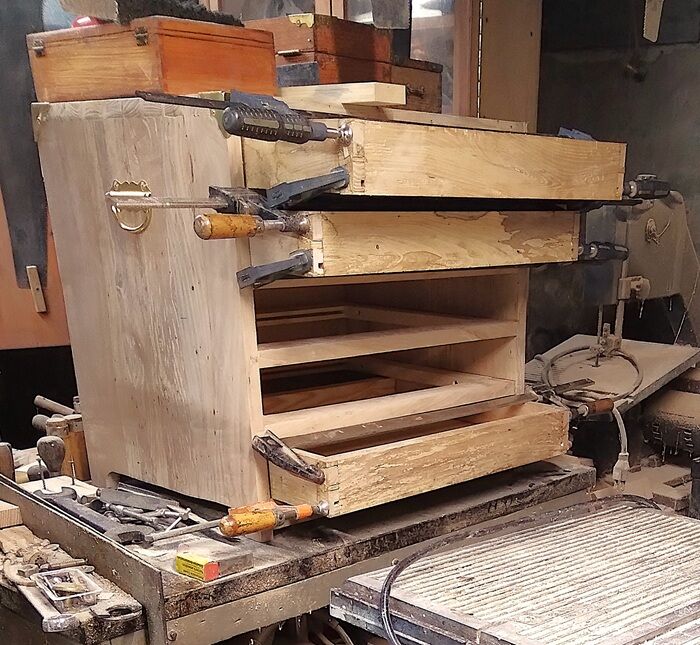

I think that will just have to do....Tomorrow, I can knock this apart, glue and screw it back together, and let both drawers sit a spell....will have to use a couple 24" clamps from the first 3 drawers...no biggie...I can start to clean those up, and fit them into the case...

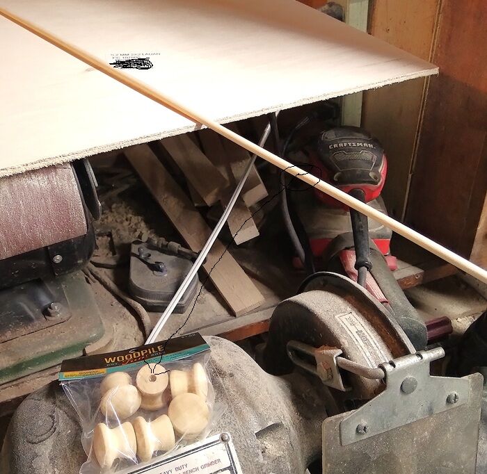

5 drawers, = 10 knobs....means I needed to buy 2 packs of these..and that dowel rod...you glue a short bit of dowel into the back of a knob...then drill a hole into the drawer front, and glue a knob in place...
I do have a bag of glue brushes ready to go...
harbor Freight's finest....

Moved the tablesaw out of the way...Grabbed Drawer #1 and hauled it to the vise..
Glue joints got leveled, filled and generally cleaned up...cut 2 dowel rods to fit 2 knobs..glued them together....drill 2 holes and installed the 2 knobs with glue and a c clamp..

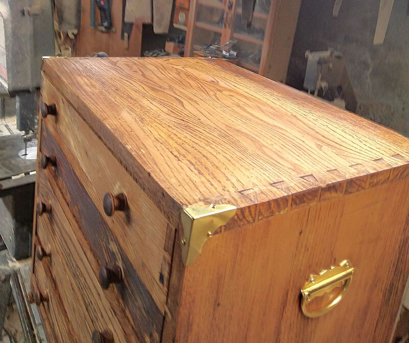

Back corner view...
Front corner view...
Open the drawers a bit..
Sept_Proj.WitchsBrewdovetailsshowingoff.jpg.6e5f6b30fa1b1c90fc355d25aed6b1f3.jpgShowing off the dovetails that some people like...
Other front corner...close up the drawers,  for now..

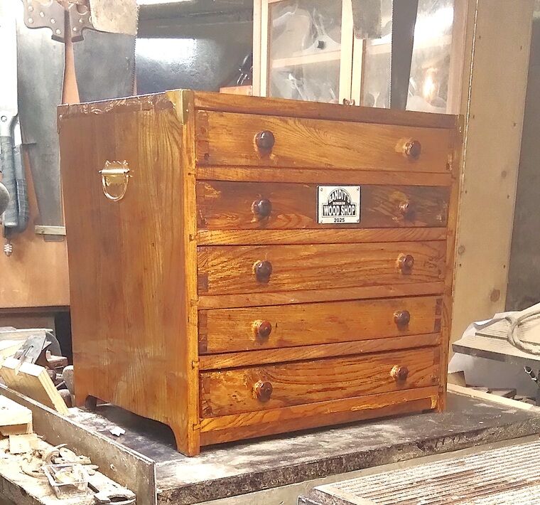

Label attached, has been moved to it's new home base...has been rubbed down with 0000 steel wool....stuff has already found a drawer to hide in..
Even have a start on hanging items on the back of the case..
which was the reason why the extra piece of 1/4" plywood was added...intend to add a bar of some sort to the area..might be a magnetic one?  Ready-to-use-Rack?  Milllers Falls No. 5 hand drill ( proper name is not Eggbeater) that I used to drill 4 holes into the metal label...
For scale: drill bit is a 1/16" bit...pilot hole drill for the 4 brass screws that attached the label to the #2 Drawer front..
I think that will do for the Build-along part of this project...
Thanks for looking in..
