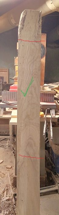

Had a stash of Ash planks I was going through, cutting out the bad areas....I sorted through the stacks...found enough to lay out...

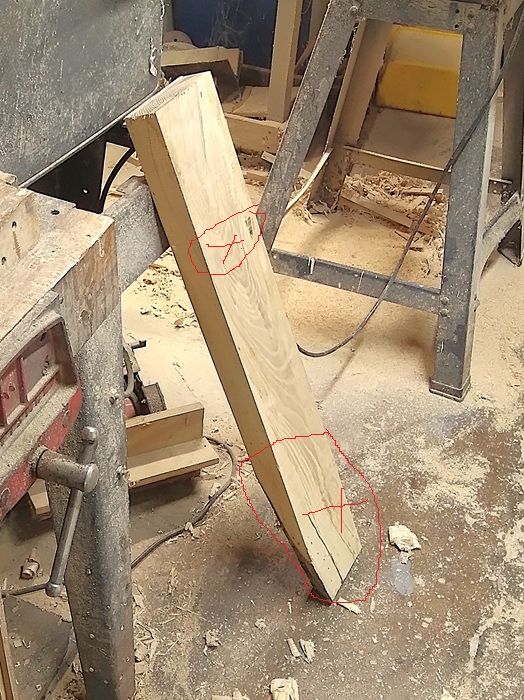

Ripped that extra off, along with the defects along the outside edge...rearrange a few boards...some needed to be jointed..

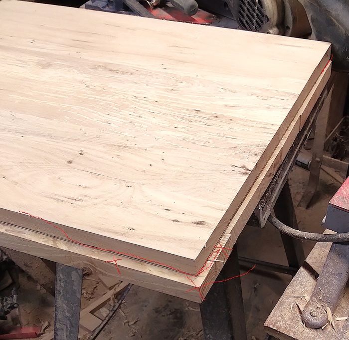

Spread a bead of glue along one edge, rub that edge against the next edge..repeat as needed...1 clamp on top, 2 clamps underneath..let this heavy mess sit a spell...

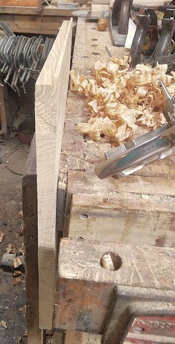

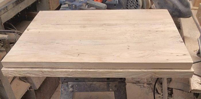

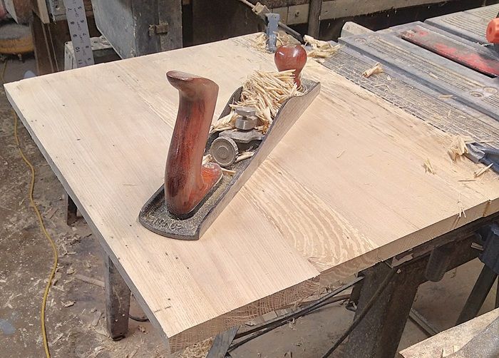

Last of the 3 panels was worked on, today...
One face was flattened, then flip the panel over, and..
Flatten the other face...
Then, lay the other Side Panel down on top of this side panel, and see IF they match..
Not quite...they do need to amtch each other, as that makes the drawers work a bit better...

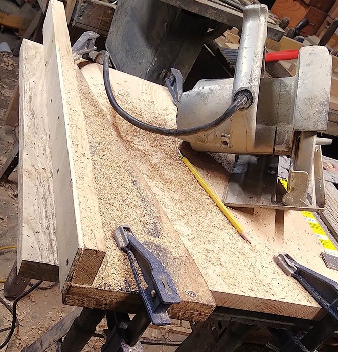

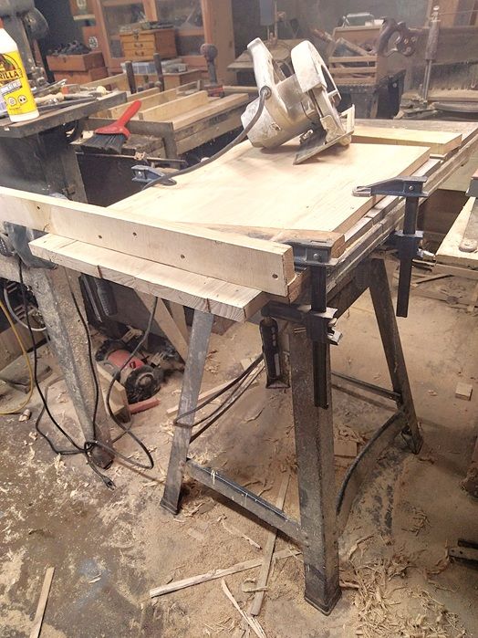

Ends needed trimmed and cut square..
This end just needed buzzed off square...we have ways..
High-Tech Saw Guide?

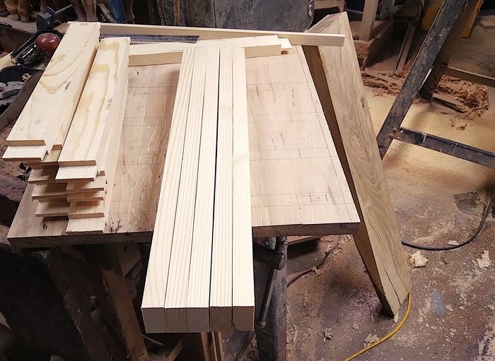

Some ripping and cross cutting last night..got bored...needed to find 5 blanks that will be drawer fronts...and cut the one end of each square, and the other 4 ends to match the shortest of the 5...
Tried to find enough lumber for 5 drawer dividers...came up 1 short.
And 10 drawer runners out of Pine...

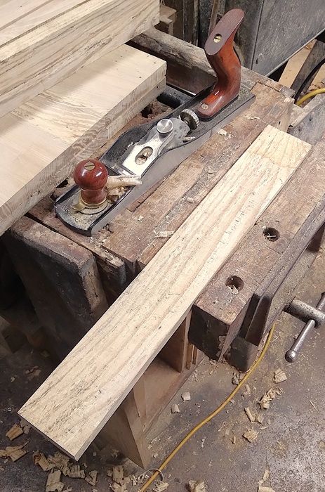

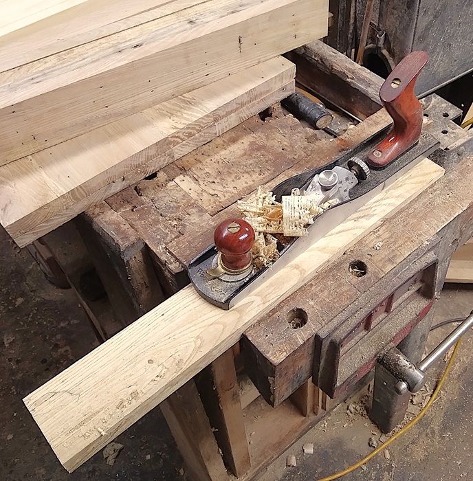

Gave this plane a bit of work...
No longer rough as John Wayne paper...almost glass smooth...will work on the other 4 later, today..

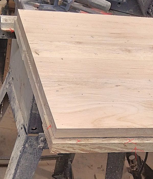

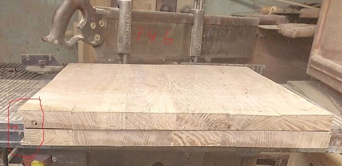

BTW: both side panels were trimmed and flattened..
face #1, and..
Face #2, test for a match between the 2 sides..
Bottom one needed a trim...finally..
All trimmed up
Stay tuned..

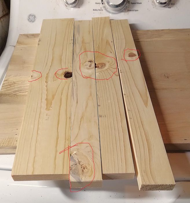

This end had too many issues going on.   I also ripped a couple 1 x 4 x 6' planks to get the 5 rails for the back of the webframes...
With the usual suspects being rejected..
Knotty....

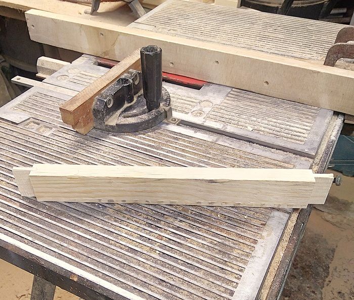

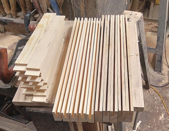

Once I figured out how long to make the drawer runners, I could trim them for overall length and then for the tenons..
One done, 9 to go...lots of nibbles going on..then reset to mill the groove that the tenons will get glued into..
10 grooves, at 2 passes per groove...these are 3/4" deep

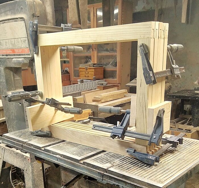

Had to add a backer board..

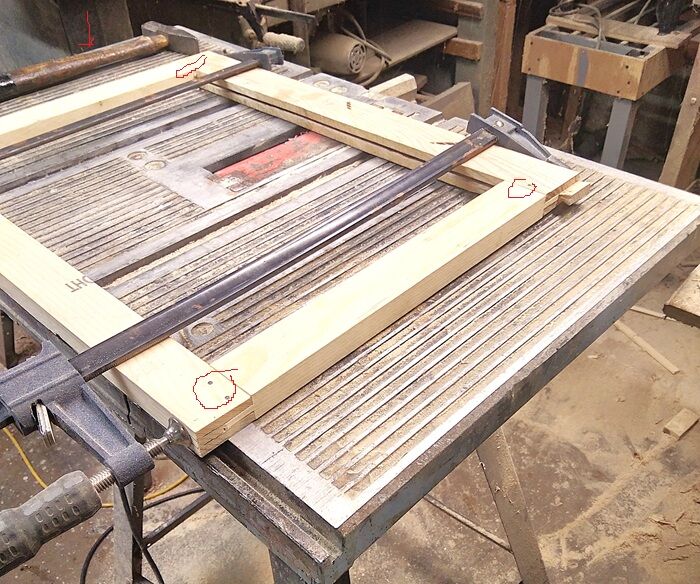

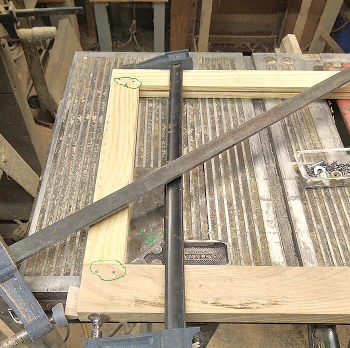

As for webframes..this was a dry fit...
After I had trimmed the back rail a bit..

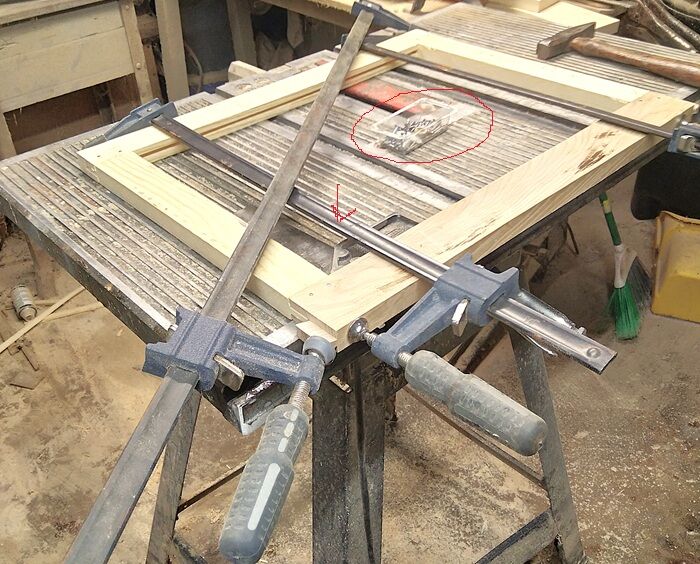

Once all the dovetail "Tails" were done...moved things around and set up an assembly table...glue clamps and brads...
Sept_Proj.Webframescheckedforsquarenailedoff.jpg.a4eea4babb2a1517b456c7d85de32136.jpg
Checking for square,, 2 brads per glue joint..diagonal clamp was for one frame that NEEDED pulled into square...
Got all 5 webframes done...couple wanted to warp, so..
I clamped them all up into a book...let these sit a day or 2...

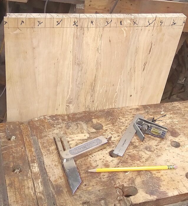

Panels are sitting front to front....inside surface facing up.   Framer Square to carry lines across to panel #2
This is where dovetail sockets will be going...out on the back edges will be a rebate..

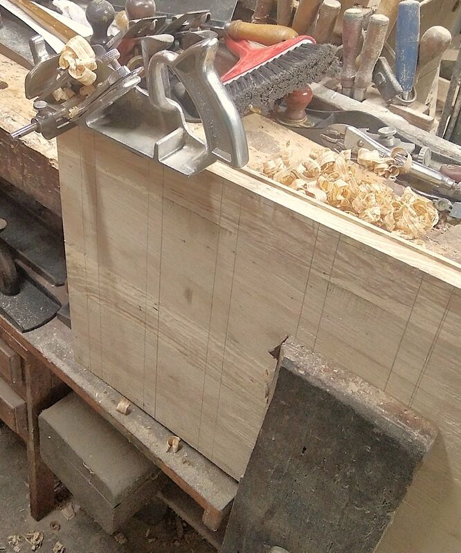

Rebates( Rabbets)..means I need to dig out the case that plane was in...and get out the fence and install it...
Craftsman No. 3720 ( Sargent & Co. No. 79, type 2)
Set one side panel into the leg vise..
Panel is also sitting on the bench's shelf. with a c clamp on the far end
1st panel, did not need the clamp..I also place a scrap under the panels to level them up a bit...
That pile is about half of what came from one rebate (other half was already on the floor)
Took a while....second panel turned out that I was going against the grain...sharp iron, and a rub with a candle helped out...

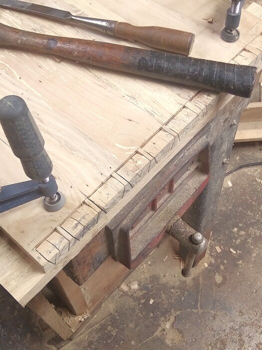

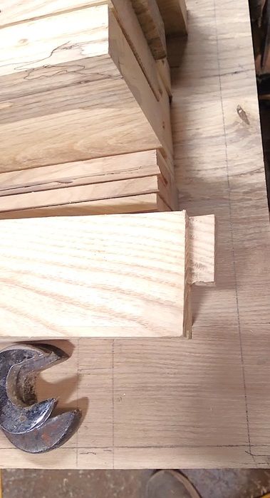

I had these bass-ackwards....so...I reset the entire line, worked around the NOW bad saw cuts...even cut a template out of pine to make sure I had this set the correct direction..the set up a place to chop the correct waste...
This being the outside/show face...
Chop half way down, at the baseline...leave a tab out on the edge for support..flip this over..
Chop from the inside face out..pins are now done.  correctly

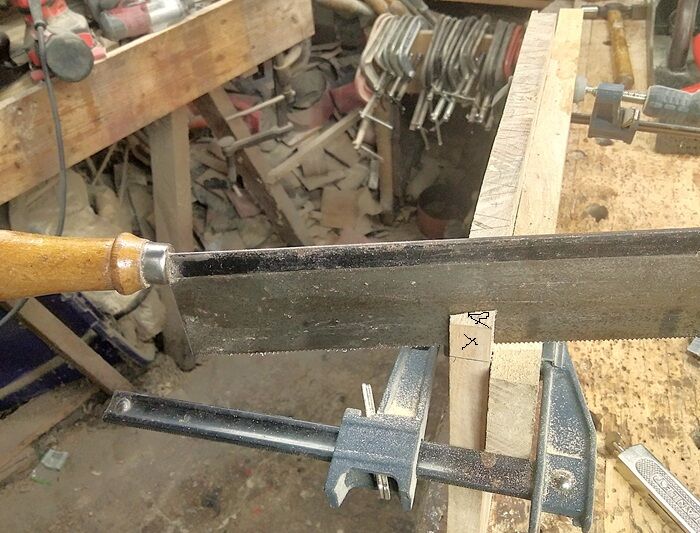

The Chisel?
A 1/2" wide Witherby....
Seemed to hold up quite well..

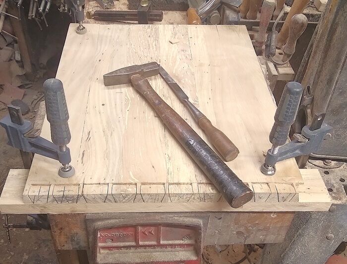

I needed to put 2 sides and 2 webframes together...then set the Top panel against the bottom edge of the 2 sides...and mark how much I'll need to trim off the Top Panel..
About that much.   Once trimmed, I can start cutting the "Tail Board" into the ends of the Top panel...
Trying to fight those 4 parts AND clamp them so that they will stay put...with just 2 hands and clamps a bit of a stretch to get to...Cussing was indeed involved...
