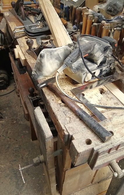

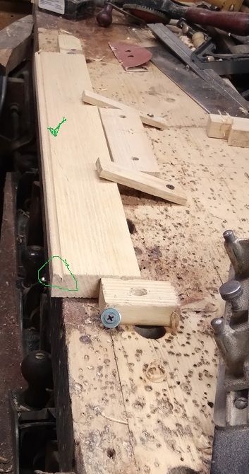

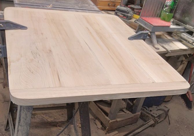

Popular Post steven newman Posted March 5 Author Popular Post Report Posted March 5 Lets see IF I can load more than 4 photos tonight...last time, had a bit of trouble.... So, clamps came off today..glue joints needed cleaned off.. Stanley No. 3, Type 15... Hi-Tech Tool...needed to mark a radius on each corner. so... Tried the Sabre Saw to make this cut...blade was too dull from the last time ( I need to go and buy new ones, anyway) so...I did it the way Norm Abram did.. Got the top at this end done... Then flipped it over..to both clean up the underside's glue joints, and cut the other 2 corners.. Needed the underside, anyway...as I needed to lay out where the legs will be going... And, where the tenons will be going...marked out 3 out of the four corners this way...so I could find out how long to make the 2 pairs of aprons...2 longs ,and 2 shorts... So I could cross cut a couple slabs... And, rip them for width...one end was a bit tapered...reset to THAT smaller end, and run all these through, again Needed to clear off the bench, next... Needed this space for a jig...first step, was to joint the edge of a long apron,,was a wee bit rough, we have ways.. WW2 Stanley No.6c...then set up a jig..with the part overhanging the edge of the bench by about a 1/4" or so... That way, the #45's fence won't be rubbing along the side of the bench..and throwing things off a bit ( finally found that wax candle..) Then repeat for the other long apron.. Short ones are about 6" shorter, had to reset that jig a bit.. Right about here...toes went to "Cramp up" Mode...area between the shoulder blades was getting there, as well...decided to place the load of Laundry over into the Dryer, sweep things up a bit, and head back upstairs....I guess 75 minutes of shoptime was a bit much, today? Photo #6...took 2 tries to get it to post (Error code 200????) Maybe tomorrow, I can bead the other 2 aprons, then mill a 3/4" long tenon on each end. Then start the lay outs for the mortises into the legs? Stay tuned.. Bubba, 4DThinker, Gerald and 5 others 7 1 Quote

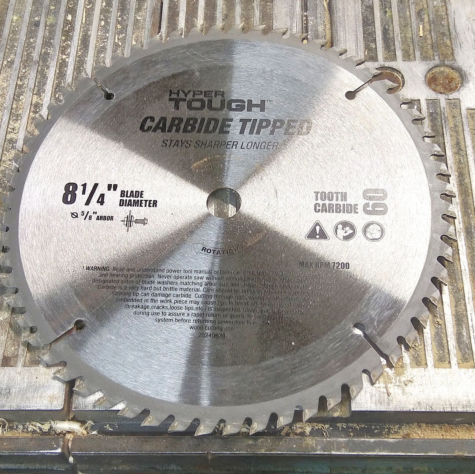

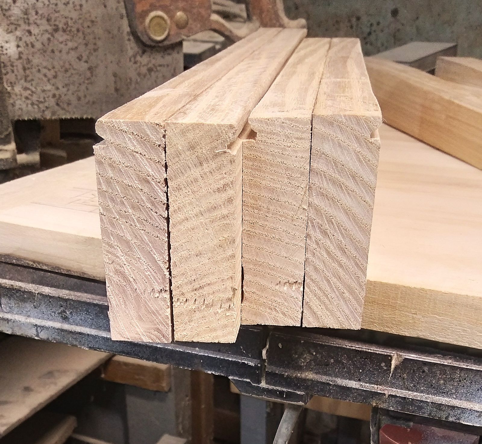

Popular Post steven newman Posted March 6 Author Popular Post Report Posted March 6 Beads are done did.. Needed to change out tablesaw blades, from this.. Tis a bit too rough as a cross cut blade...to.. A 60 tooth version...Had to remove the throat plate.. because there is not a whole lot of room...for my fat hands to work in.. And, you need two wrenches... Just to get these 2 parts and the blade out Then get the new blade in place add the cleaned up washer and nut.. One little tip: Run the blade up to full height. And when done, take a square and check that the blade is now 90 degrees to the table's top...then set the blade height for.. As I have 8 tenons to mill...also need the rip fence and the miter gauge.. And do a bit of "Nibbles" with the last nibble when the end of the board hits the fence...so.. Set to match the width of the chisel.... Stay tuned,,, Larry Buskirk, lew, Grandpadave52 and 3 others 6 Quote
