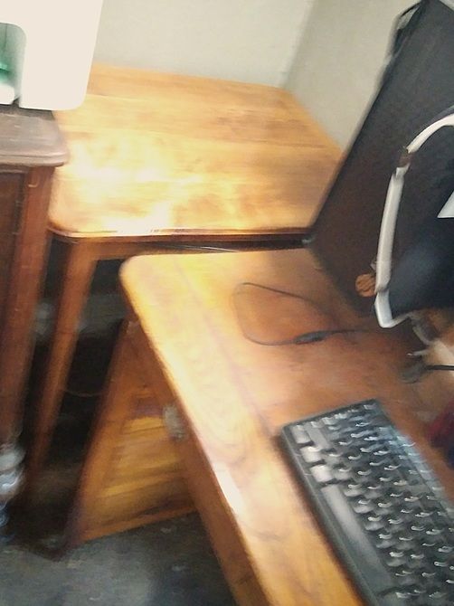

DVD Cabinet needs an extension add to the door, as it is too shallow to close up nicely.    Old Pine Table is too small, and too short...and the Cats have been using a leg as a Scratching post.. :ArguingSmileys:
And that corner needs a good cleaning out, and block any Access to Cats Entry....:PullingHair:
Top needs to be 26 x 22, and the height needs to be just under 32":OldManSmiley:

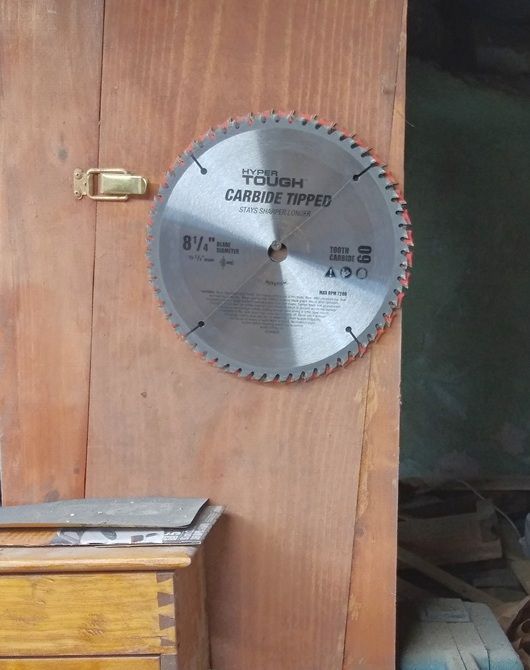

It can sit here, while I work on the 4 legs...tomorrow. :Tapping:   Way too tired right now to go to the shop.:GoodNight:...I did hang a few saw blades up...:OldManSmiley:
That way I can find them, again...:ChinScratch:
