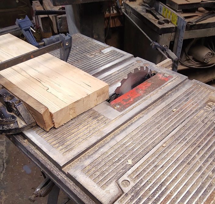

    Lumber Supply for today. . 2 out of 3...and the 3rd one? These 3 were too long to cut on the Tablesaw safely, so...Mark a cut line at around 26" from an end.. Grab a sa

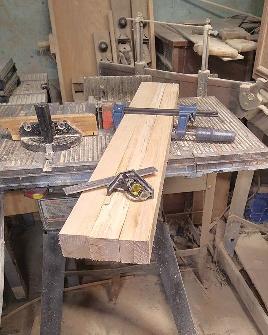

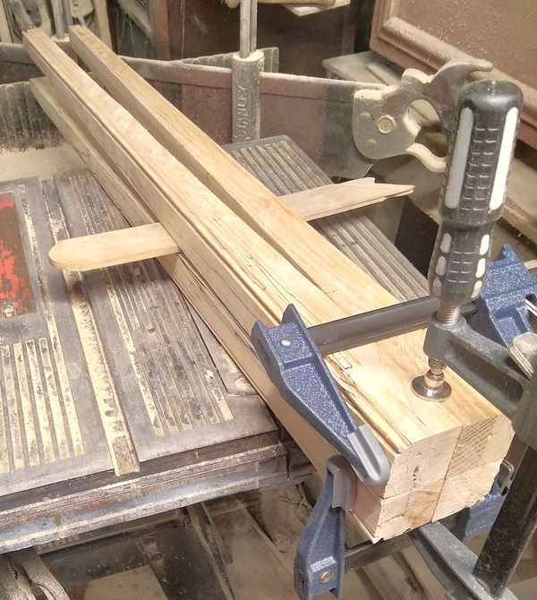

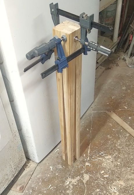

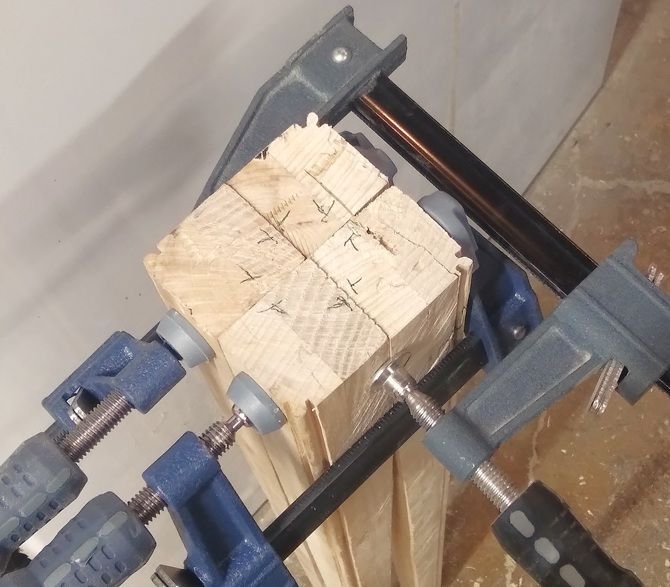

    Lets see IF I can load more than 4 photos tonight...last time, had a bit of trouble.... So, clamps came off today..glue joints needed cleaned off.. Stanley No. 3, Type 15... Hi-Te

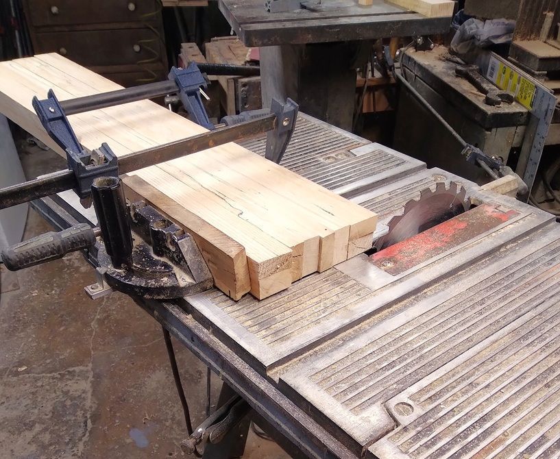

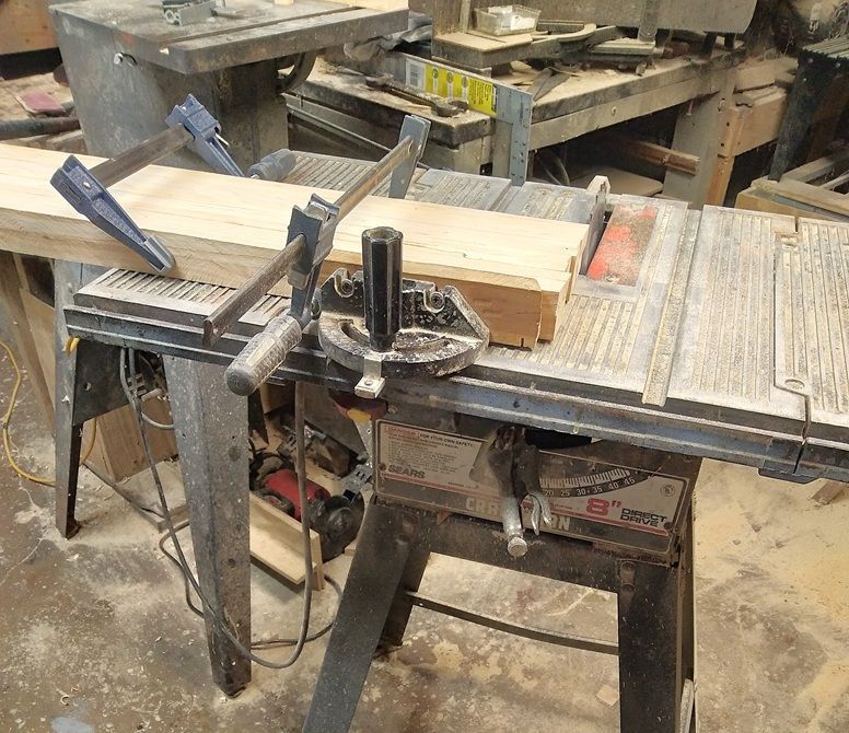

It does get better, though...as far as trimming the ends of the leg blanks..:WonderScratch:
Needed a helping hand...a clamp to hold the mess to the Miter Gauge...not taking any more than I have to, off of this end...:ChinScratch:
After the cut, rotate around and clamp it back up, with the "cut line" at 30-7/8" away from the first cut...:OldManSmiley:
And run it through again....then set these aside for a day.   :TwoThumbsUp:

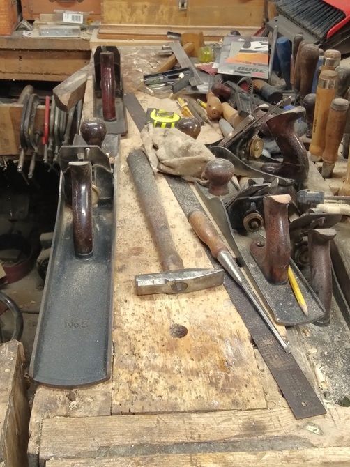

I also needed to figure out which jack plane to keep on the bench...:WonderScratch:
The Ohio N0. 0-5, or..the Millers Falls No. 14....:ChinScratch:

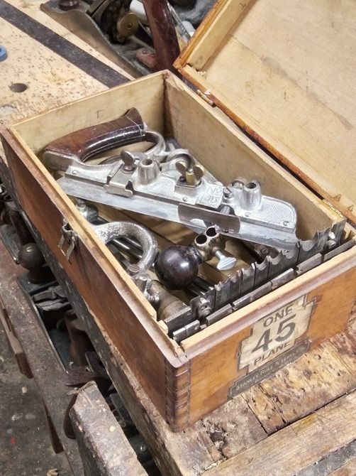

Inside that heavy box?:WonderScratch:

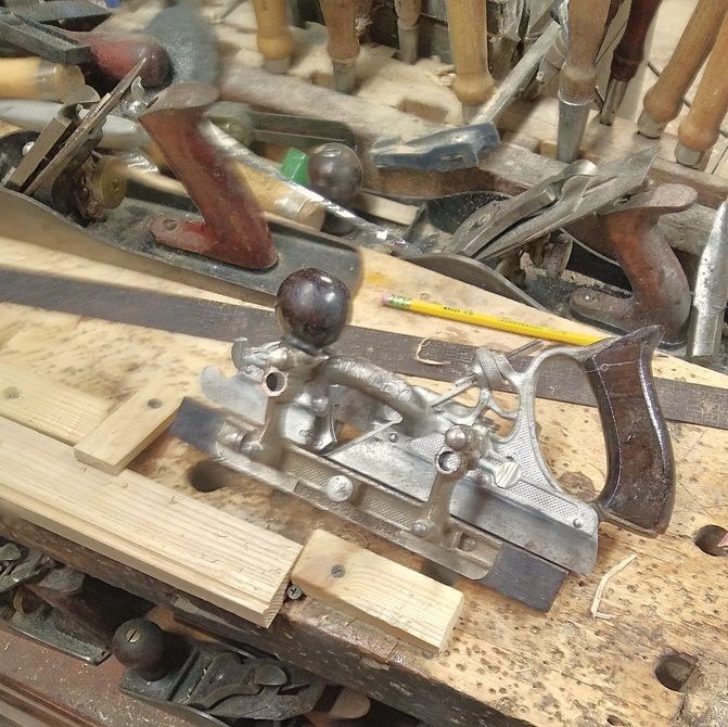

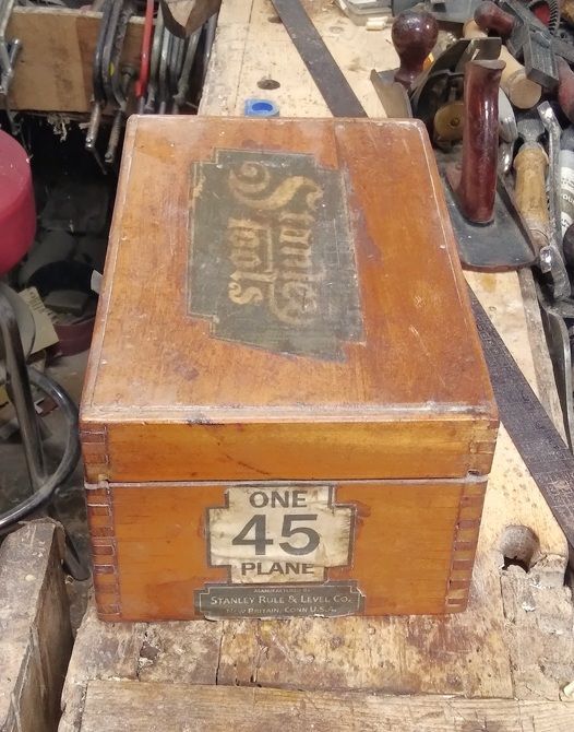

"Some assembly required" so...:OldManSmiley:

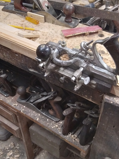

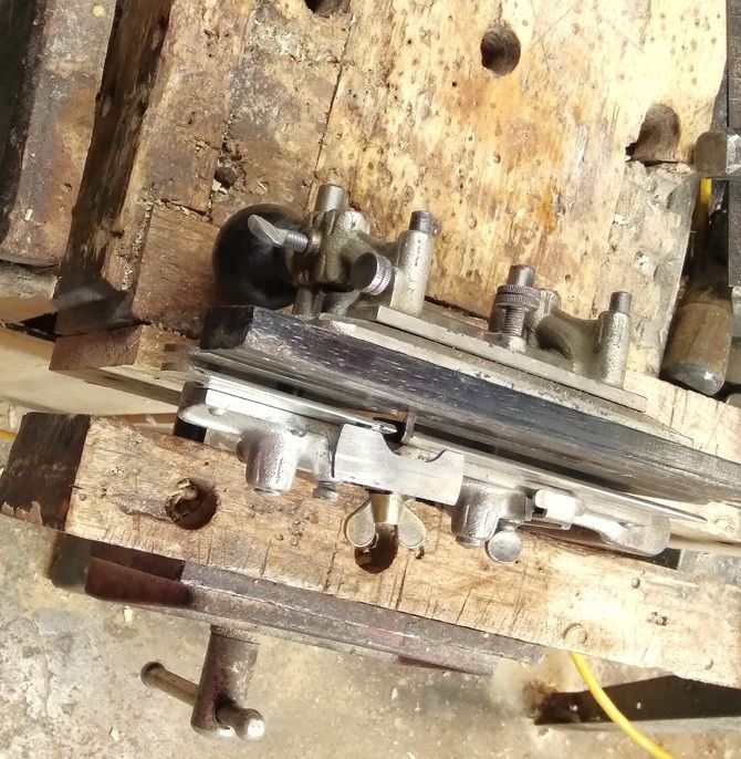

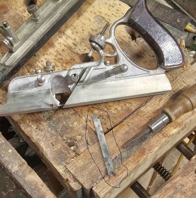

Main Stock..and a pair of "Short Rods"  and that #23 bead cutter....which needed a sharpening...before it could be installed..:SaluteandRun:
Needs a few more parts, doesn't it?  :ChinScratch:

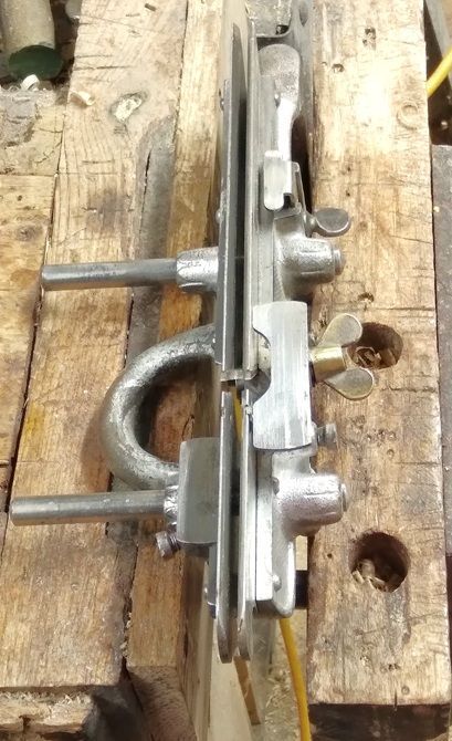

The Sliding Stock goes here...Direct support for the quirk cutting edge....even though that one will not be doing any cutting, today, I still need to support that edge of the cutter..Next..:WonderScratch:
The fence goes on, and covers that left side of the cutter...:OldManSmiley:
Rods go into the top holes, and things get locked down...Needed a test track..:SaluteandRun:
That should do the trick...give it a try...:Cheer:
Seems to finish up a tad low..adjust the depth stop a tad...should be ready to go...:TwoThumbsUp:

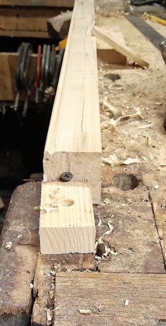

Hmmm..one leg appears to be missing?:Tapping:
Supposed to be 4 blanks here...:WonderScratch:

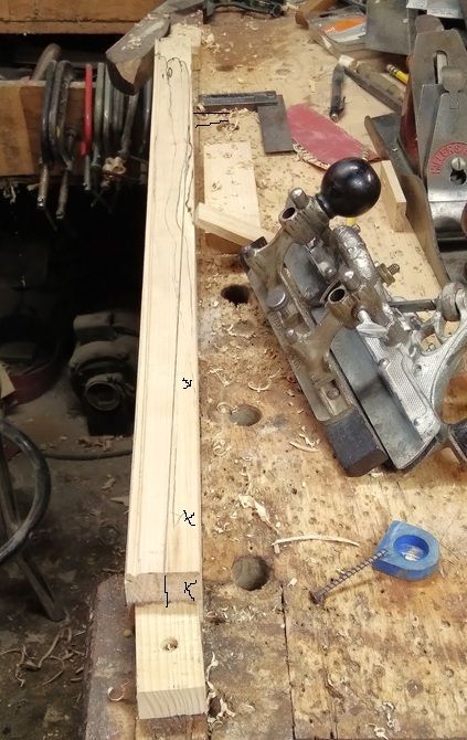

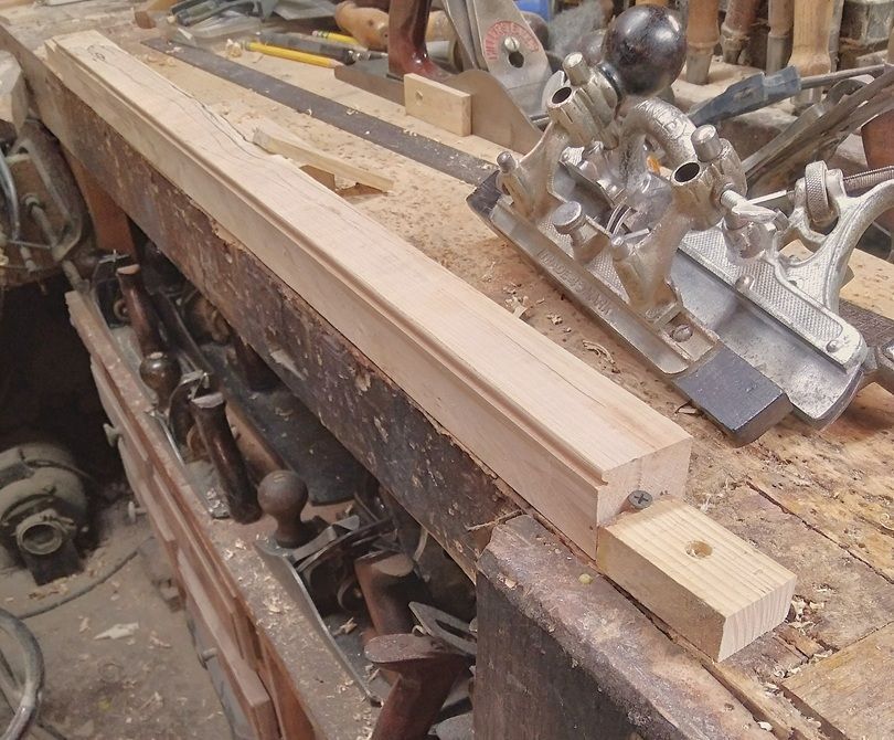

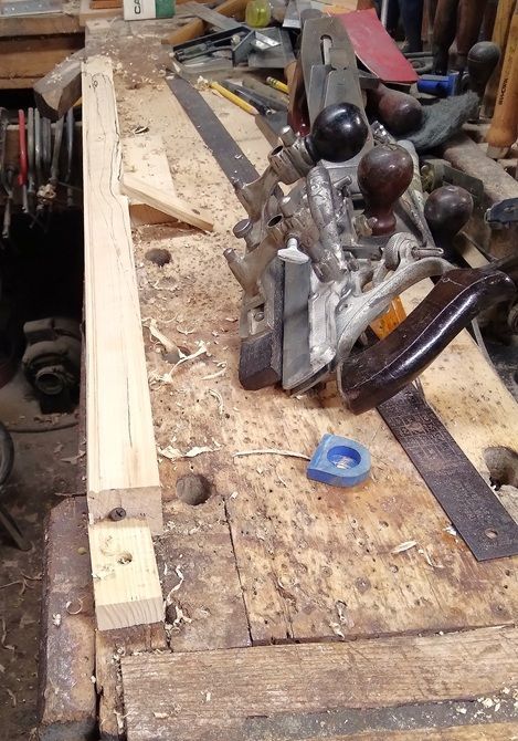

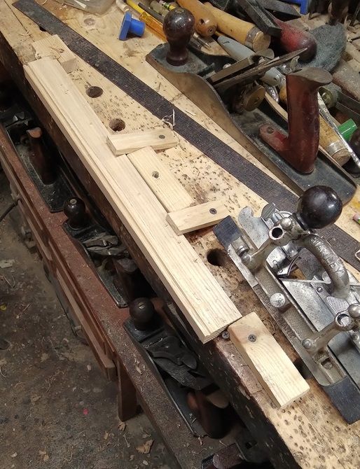

Needed to reset a jig...and before any bead work gets done did..:SaluteandRun:

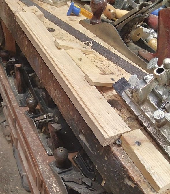

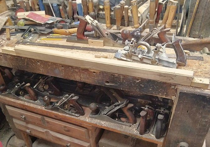

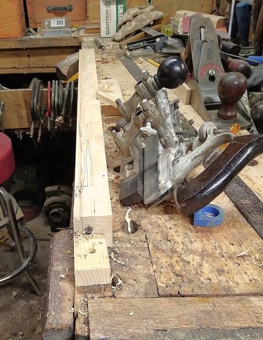

I wanted a nice, smooth surface to run the #45 on...Millers Falls No.8...:OldManSmiley:
Then the hold down can be locked in place...And the first half of the bead can be run....then rotate...:Cheer:
And run the #45 again...stopping every now and then to clear out the shavings...:OldManSmiley:
That yellow handled screwdriver can do that....:MachineGun:
Details?:WonderScratch:
Then...repeat for the other 3 legs...:TwoThumbsUp:

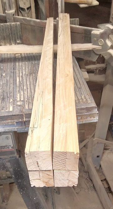

Handsome, ain't they.....this end will be under the top of the table...out of sight.:ph34r:

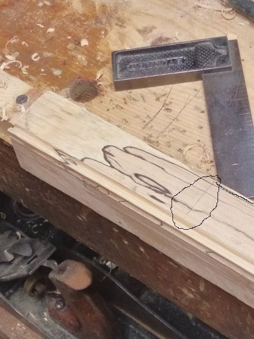

Come down 5", mark a "stop" line...go to the other end..:SaluteandRun:
Mark a start line...connect the 2 points..:TwoThumbsUp:
With a steel Yard Stick/Straightedge....Bandsaw to remove MOST of the waste..:OldManSmiley:
Rotate to the right, mark the next cut line, using the cut-off...and make the second slice..:ChinScratch:
Hmm..only 3 more legs to go....Intend to plane the saw marks smooth when I can get to that point,,,,:TwoThumbsUp:

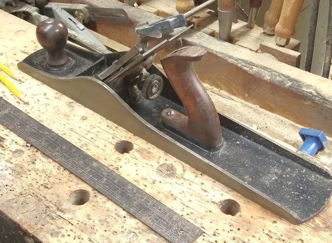

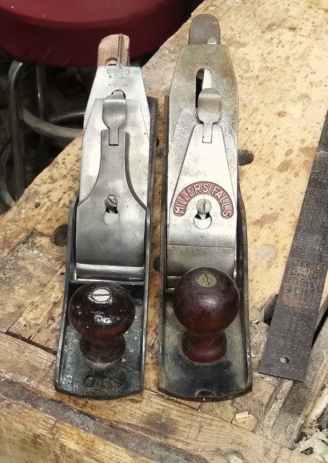

Wasn't going to happen, today....Stanley No. 6c...WW2 era..:SaluteandRun:

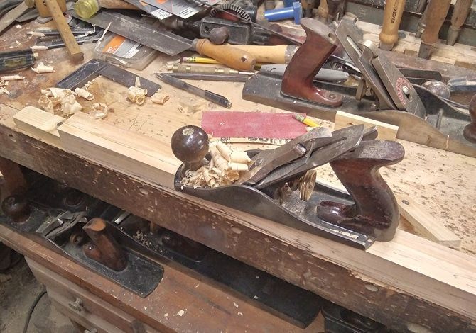

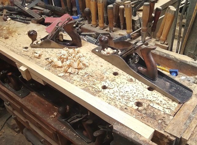

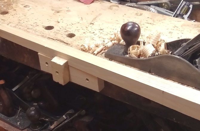

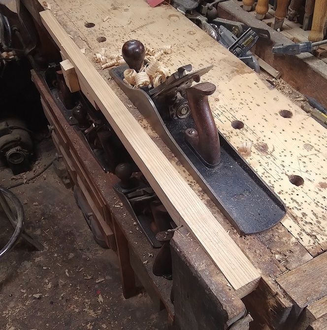

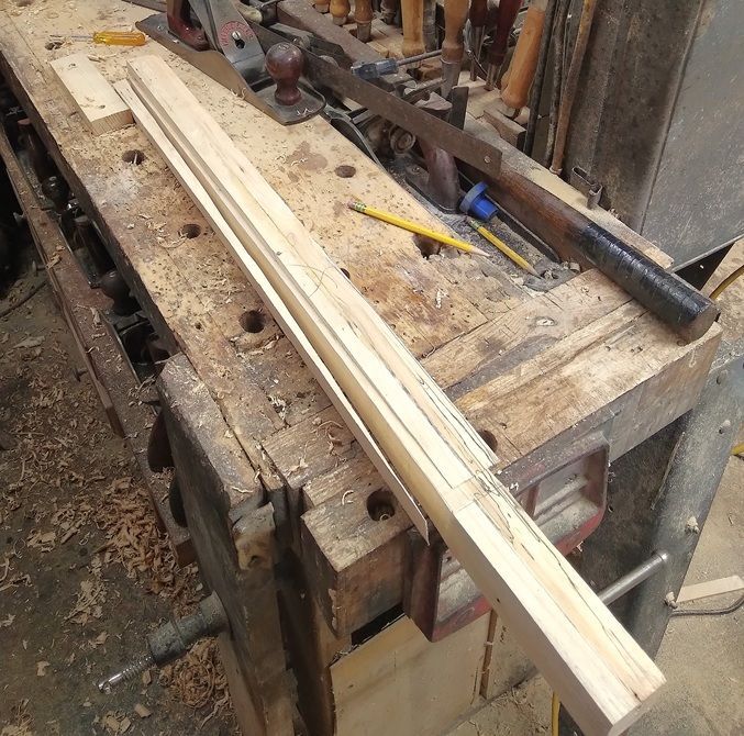

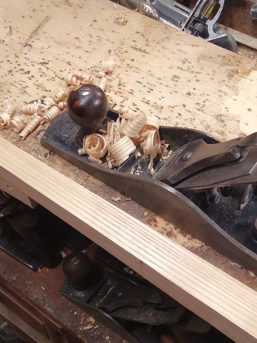

Tapers, all 8 of them, needed planed smooth,,,so.:Cheer:

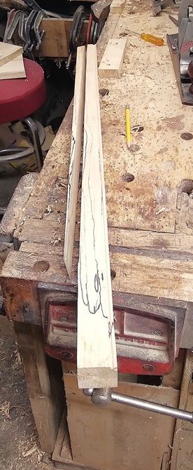

Leg Vise at one end..and..:ChinScratch:
A Keeper to hold things steady..:OldManSmiley:
That old Stanley No.6c is lighter than the No. 8c...but not much...I used the Millers Falls No. 8 to work on smaller areas..still..:JawDrop:
When I say "Plane Work"....that is exactly what this is...work.:ChinScratch:
At the halfway point...:Tapping:
Stopped for a Mountain Dew Zero Break...4 done, 4 to go:Cheer:
Making a lot of Moxxon TP, too...:JawDrop:

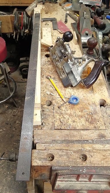

Got all 8 tapers done planed....have just enough "Left in the tank" to move this to the bench...:TwoThumbsUp:NextTableProjectplaneworkNexttask.jpg.8fcd63047fa9dd04ed118425436f6063.jpg
This will need planed flat, ends trimmed square..and to length needed to add the Bread Board Ends..:OldManSmiley:

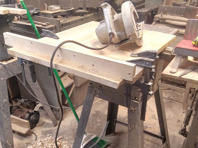

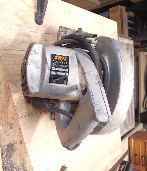

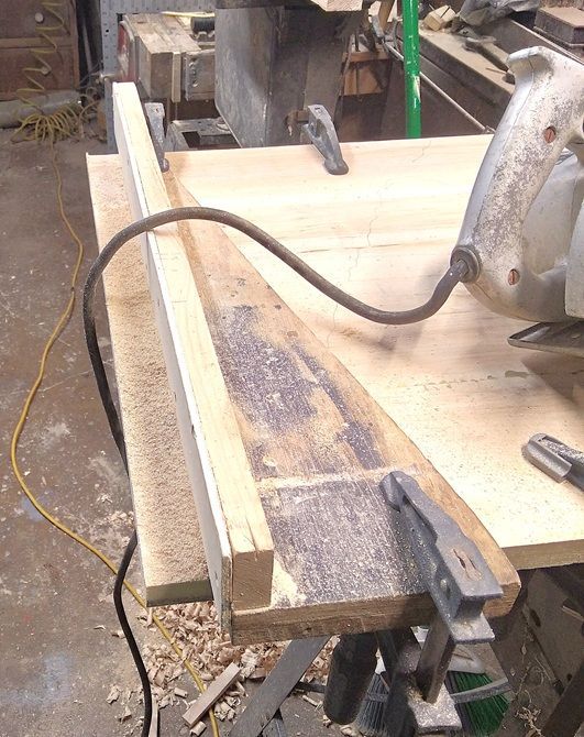

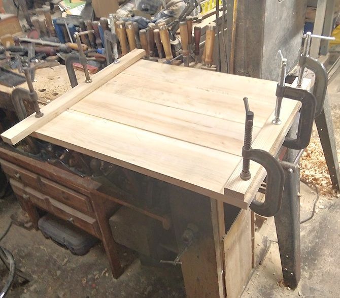

Squaring both ends of the top...along with measuring for the Bread Board ends'  1/2" tenons...to wind up with 26" length when done...
Fancy little saw...
Guide is the same that I use as the Tablesaw's Rip Fence....later, it with be guiding a router....

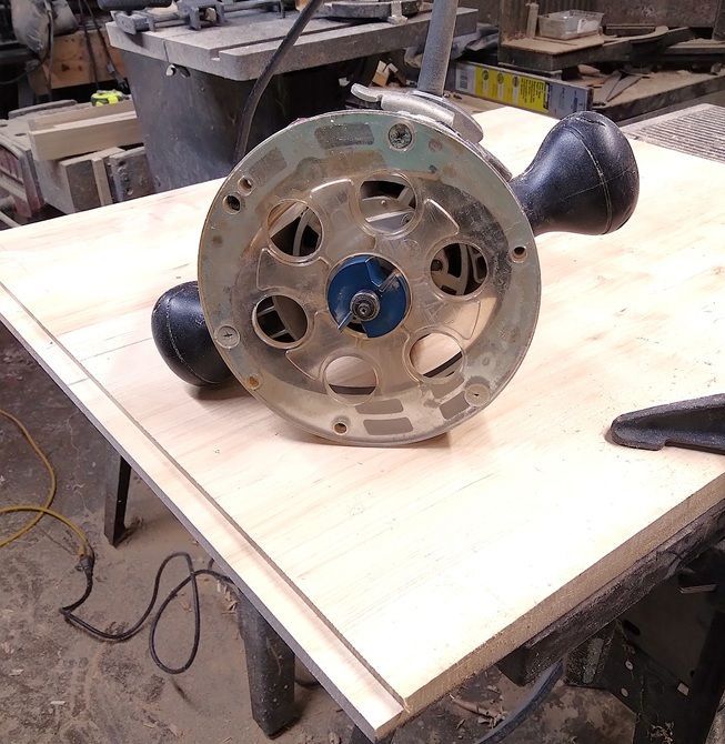

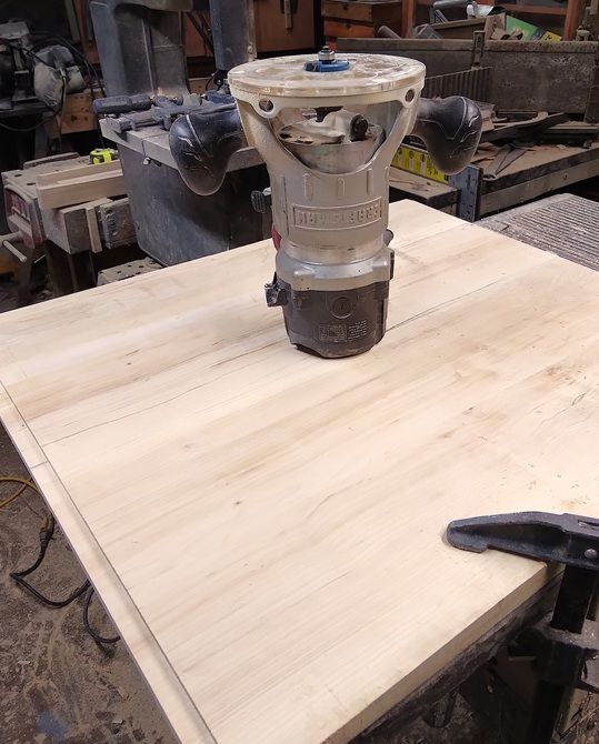

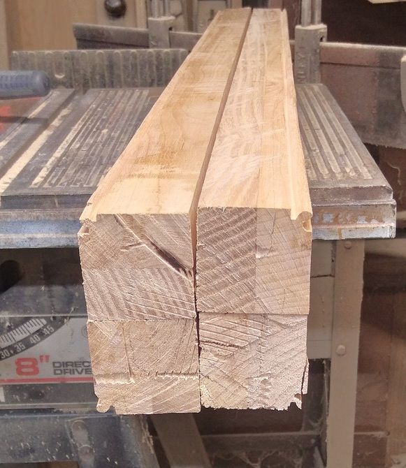

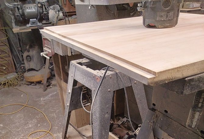

Did not need a guide, when the router bit provides it's own..
Older Craftsman 2hp Router, with a 1/2" Harbor Freight rebate bit

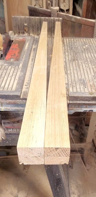

one pass per face of each tongue...mill, flip, mill, rotate, mill, flip, mill, done...

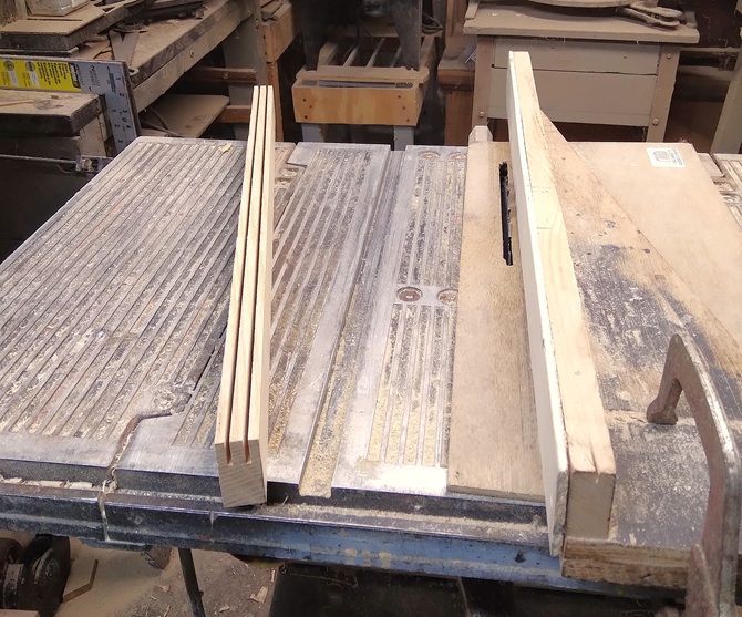

that 4th photo?

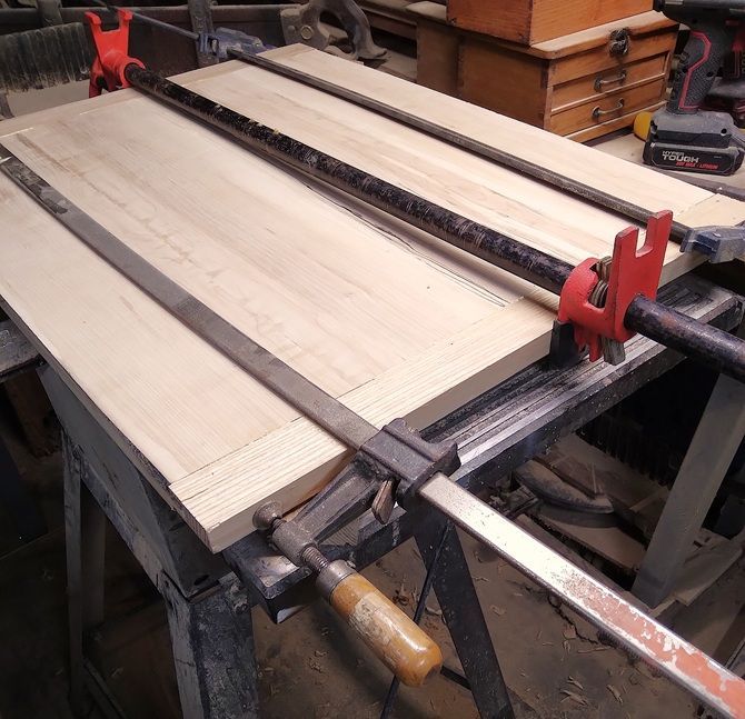

needed to reset the fence to clean out that center strip, then..
Bread boards have been glued in place...
