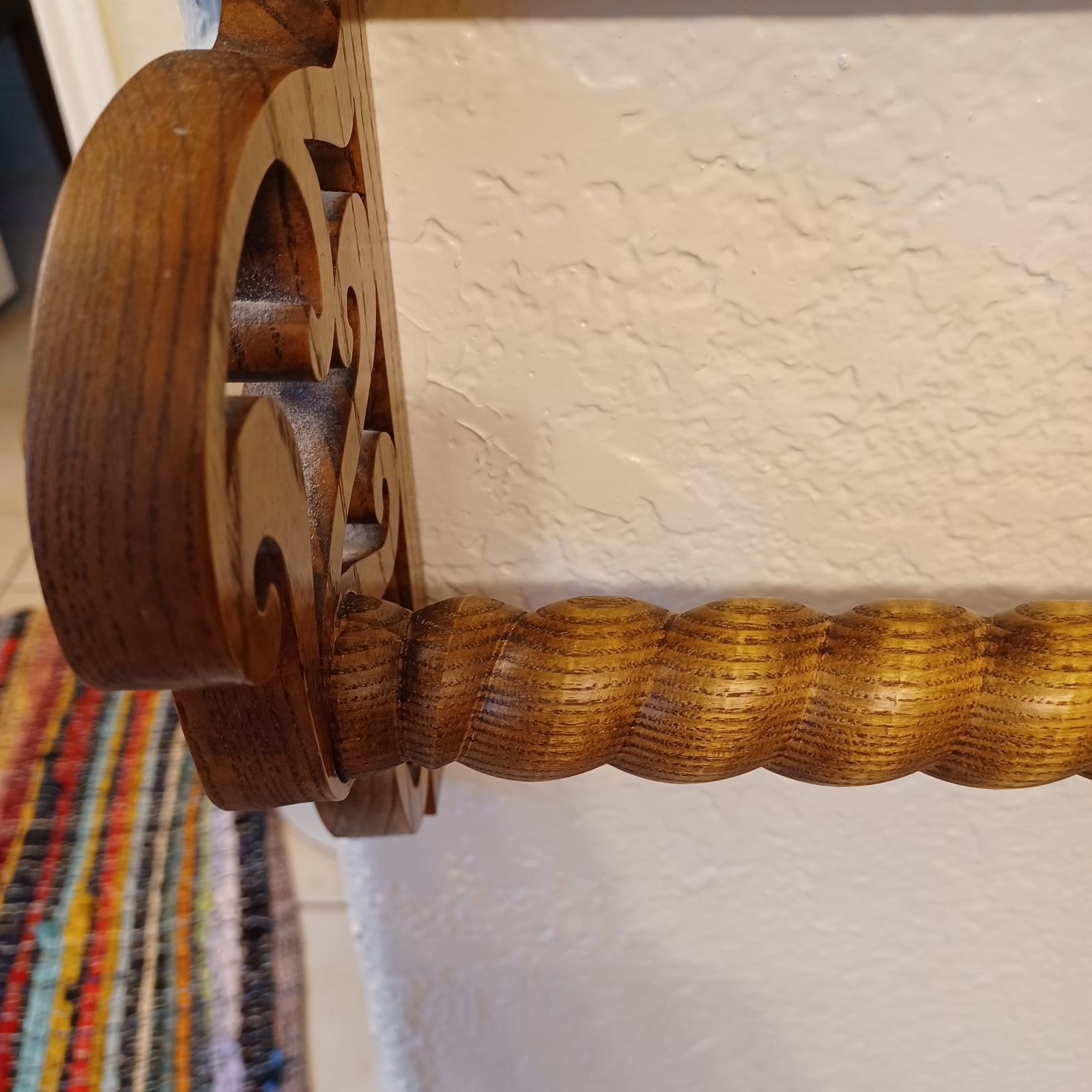

Judy I think you got some great info on how you and the guy you hire to do some work for you should be handled..  Like I suggested using 100 % tung oil will make any wood stand out more than anything I have ever used and it so easy to use but there is a big learning one has to go through before they get into using it. And especially if anyone has not had good results when tried then they will and should not do it for a customer for they have completely different ways of doing things so they don't want to chance something different and this is the best thing to do to wood if they are going to put the things outside.
     For inside use anything on the market will work. Some not worth a flip but some are too easy to use and this is why suggestions will be made on certain things.
  If you hire someone to make something out of wood you need to give them an exact sample of what you want including the wood needed for the color to turn out right. Don't just say dark oak or medium color walnut. This will screw up anyone's idea of what you are wanting exactly for there are a million shades one can make on wood.
  If you are going to apply a finish yourself I can explain the very best way for 100% tung oil to be applied and all it takes is a few rags. But you have to accept what color the end results will be for the actual stained wood will be the what you get.  On your chair why not leave the color it is now but sand everything lightly with 320 grit or somewhere close .
  If the chair will be used to sit in a be a part of your furniture then it needs to be glued up first. 20240613_112353towelrack.jpg.a4dc6f05ed5525922fe7d377de0078e3.jpg
This is a towel rack in the bathroom as booth pieces of wood was stained with the same oil base stain then three coats of 100% tung oil was used on the rod the wet towels hang on and a clear finish was sprayed on the other piece.
This picture is the best way to show what using 100% tung oil will give you.  Both pieces of wood are the same Ash wood. And there is a way to achieve this look which is really easy but it takes three or four weeks of sitting and waiting.
  Oh, and I was just getting fancy as I was remodeling a bathroom so I wanted to add my personal touch most bathrooms don't have..... But I learned the hard way the elderly folks sheds lots of old skin and it ends up in the crooks and crevasses that are hard to keep clean.
One thing I forgot to say about the towel rack........The light area of the wood is made with 320 sand paper after the stain is dry then apply the tung oil. I like a finish top look good and maybe new but still make it look like it was cleaned for a few years and thus removed some of the color that was added in to the wood which was the original Ash to start with. Giving it a little character or something like that!
 These two pictures shows the top parts of the pieces are much lighter than around to bottom areas for I sanded off most of the color I had just put on.  Just things I do to my projects and in my mind makes it looks like I care about how things I can control turns out IMG_8394.JPG.8a3deb379cd37967bca3af118624eada.JPG20230917_084445.jpg.e0b2c05cd522c3608d947015bdcdcbb1.jpg

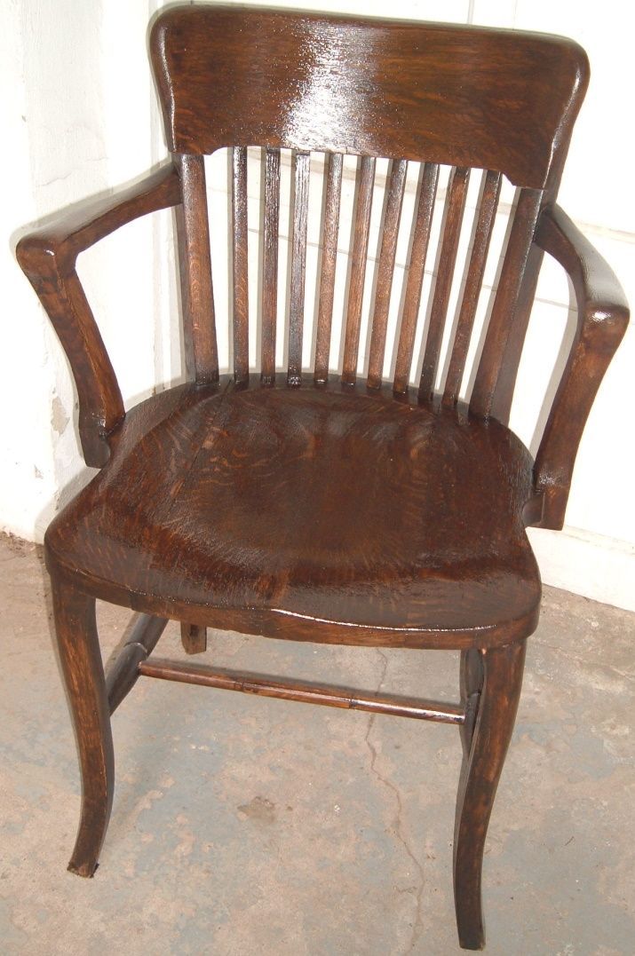

OK well so here's my update (but i might not have time to respond for quite awhile, due to endless things to attend to in the house)
...i got the chair back and yes, i had my wind knocked out of my sails as much as you may be. Because when he picked it up, he'd mentioned on his own that it would make sense to go along with the "patina" (which had made me feel relieved. I then also specifically specified Matte to which he agreed). But now, as you see, when he returned it, he said he decided to use Rust-oleum Laquer because it wasn't in good shape so he felt that only the Laquer would preserve it well. I emphasized that i'm wondering if my BIL will like it this way. (My BIL didn't see it yet, rather was just told about it.) What can i say, by now its a done deal, and that's that. Any comments?
He said he wants to put pads underneath the legs. What sorta pads would be best? Felt?
My BIL thought maybe wheels, then he decided to think about it.
Edited by JudySmith

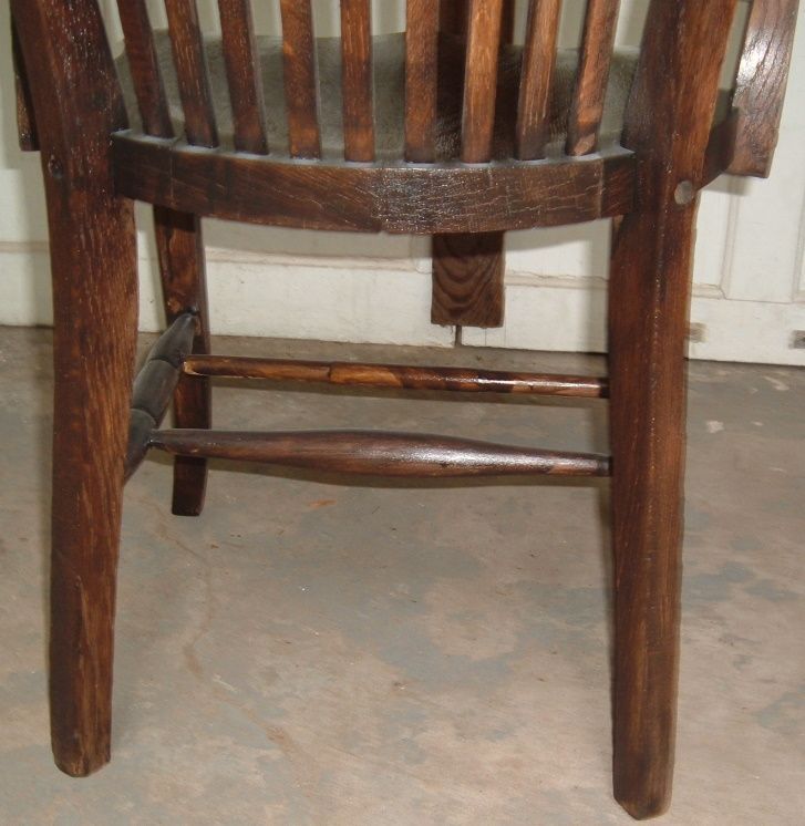

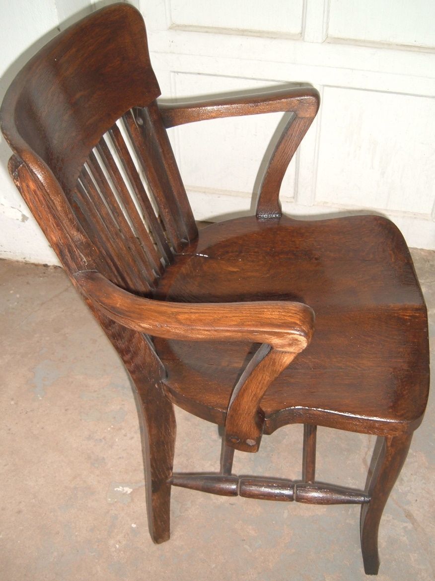

I know the camera flash sometimes makes things look worse than they are, but his work doesn't look all that professional to my eyes. There's seems to be a lot of uneveness that resembles orange peel in the finish he applied. It almost looks like he decided to take the easy way out and do nothing except apply a finish. But then maybe it doesn't look that bad in natural light. In any case, I personally wouldn't put wheels on it, they will not only raise the height unless you shorten the legs, they'll put a lot of stress on those legs as the chair is moved around. The choice of what pads is usually dictated by the floor it will sit on. Hardwood floors usually have felt pads.
Clearly, no wheels but felt pads.  I will agree with Fred that it doesn’t appear that the chair was stripped by looking at the bottom.
@Ron Dudelston, Judy didn't want it stripped, she wanted to keep the original patina and blemishes, but I agree, it does appear that not much effort was put into it. It looks like this is the first coat only to me, it should be sanded down to level out the imperfections for a second coat and possibly a third.
He didn't even get the bottom of the rungs, they look dry and unfinished. He could of gone with a matt finish.
The finish should be satiny smooth, no orange peel.
I'm sorry Judy, the gent did not serve you well. If you don't mind me asking, how much did you pay?
A well finished piece of woodwork should be able hold up against any flash of the camera in any lighting. That's how us woodworkers detect blemishes in our finish, with brutally honest lighting.
Also, he did away with grandpas old repair blocks, and added his own attempt. That completely defeated the purpose of what you were trying to accomplish, did  you communicate with him that you wanted to keep those old repairs on the bottom as is?
As far as pads, I find the felt ones usually slide off after a while.  I've used the ones that have a hard felt inside a nylon cup that has a sharpened edge cylinder.  Pound in it and it's good for quite a while.
