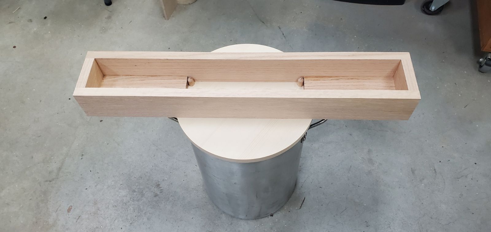

I managed to get the adapter finished for the steam box. I still have to seal it with something... thinking of using fiberglass resin.
The adapter sits on top of my turkey cooker and that will be the source of steam.
Working on the actual steam box now and that will sit on top of the adapter.
JT

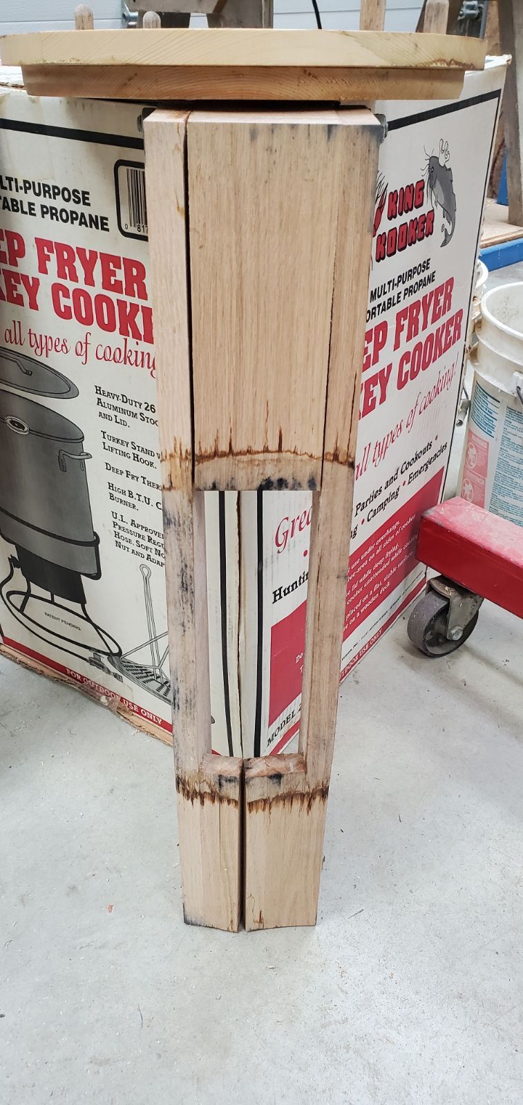

Got a bit more done on the steam box, just need a lid and some water proofing and I'm ready to test it out.
JT
Great looking set up there JT, never thought of that design. I am sure ya know, but not to sealed, the steam needs to escape. :)
Do you need a thermometer? I did, I had to wait for the temp to rise to a point before I inserted my pieces into the box. I remember it had to be at least 180degrees but I think around 220 was more preferable, again, you know all this already since you been building yours, just thought I'd throw it out there though.
Yep.  Without a vent you've got a pressure cooker. I have a vague memory though about a couple of chair makers I met in Iowa who found that putting the parts under steam pressure made them much more flexible/twistable.  They used them to make chair arms that twisted up to make the back rail of the chairs.  One continuous piece.
