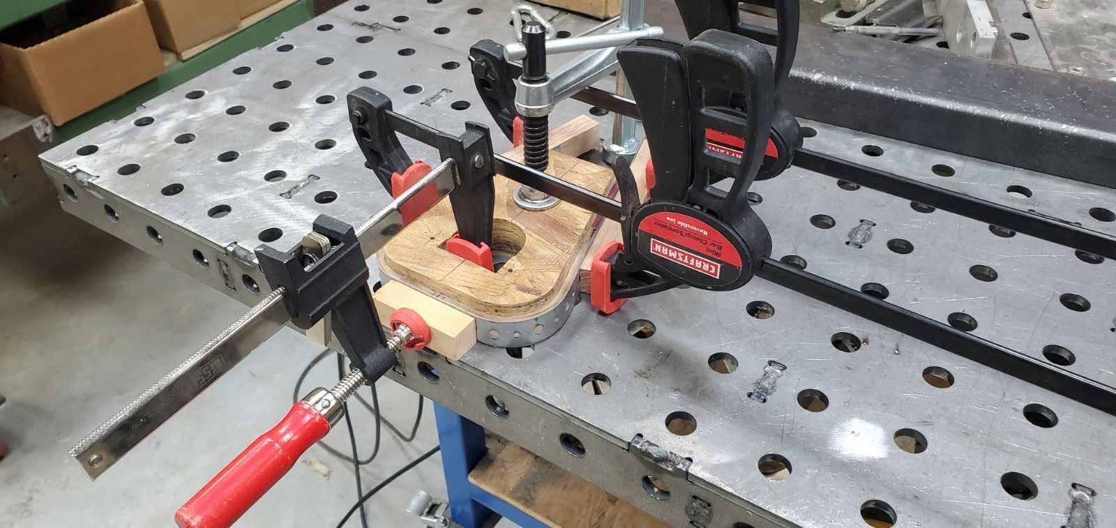

Did a test of the steam box today and it worked well. I just kept flipping the piece of plywood over as it took up.
The first bending test without any strap ended like I expected and split out. The 1 3/16" radius is real small for steam bending wood so I used some 1/8" test strips.

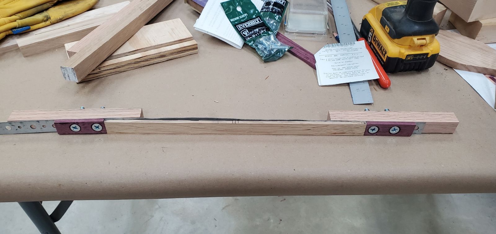

The second attempt almost worked with a bit of plumbers strap and two 1/4-20 hex bolts as stops. One side did pop out and I somewhat expected that to be an issue without any handles on the strap. You can see the left side popped out from the bolt head.
My next test is to make some handles for the plumbers strap that overlap the ends of the piece to bend so it can't pop out as easy.

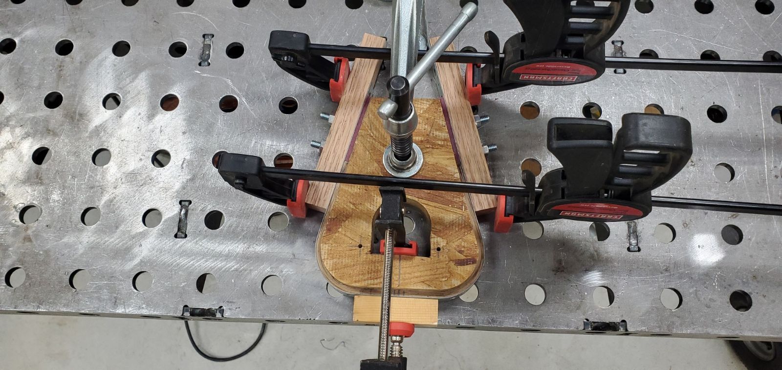

I took some scrap purpleheart and made the material stops and used scrap red oak to make the handles. The plumbers strap allows me to change the length within reason.

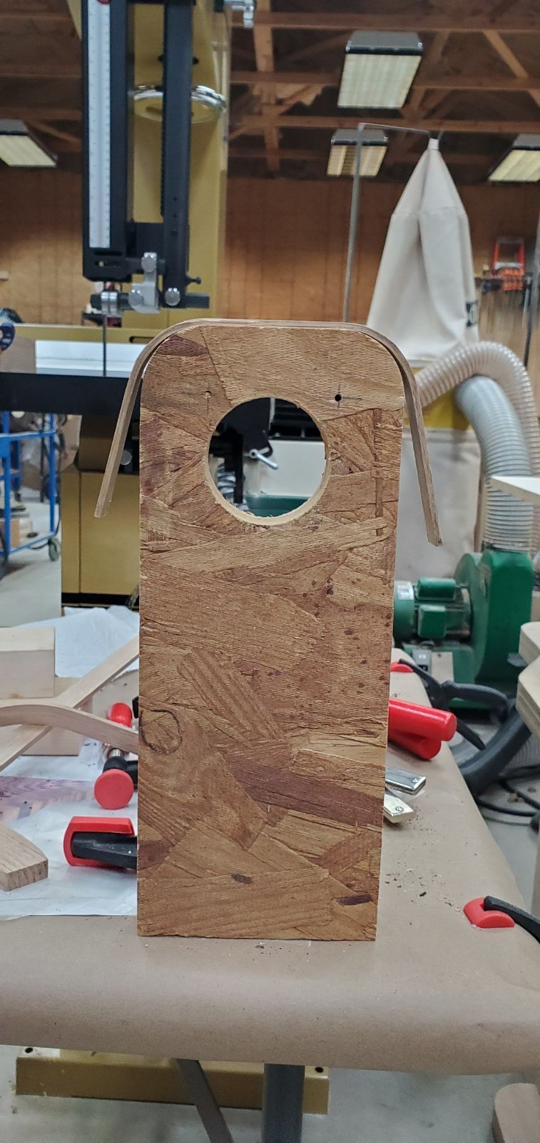

I did figure out the spring back is approximately 15° so I'm making a new form to test that out as well.

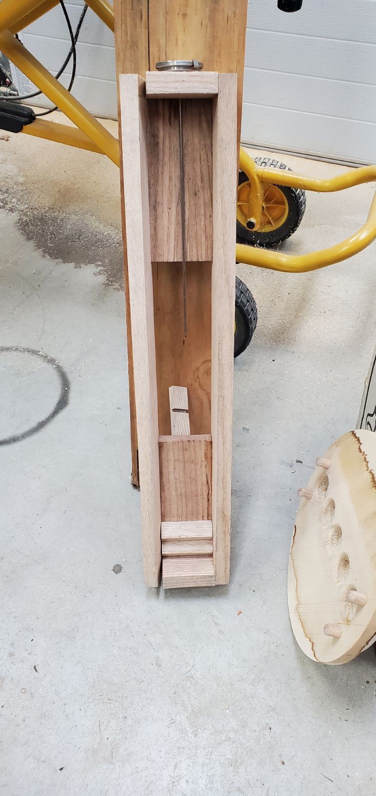

I had a bit of a failure on my steam box just as I finished steaming the last piece... looks like the inside must be sealed to stop the wood from taking up and expanding. That was Titebond III glue that I used...
JT
Mine did the same thing JT. I just screwed the heck out of it back together.

Here is another test piece this time 3/16" thick... I was amazed how much more pressure was needed to bend 3/16" compared to 1/8".
JT
