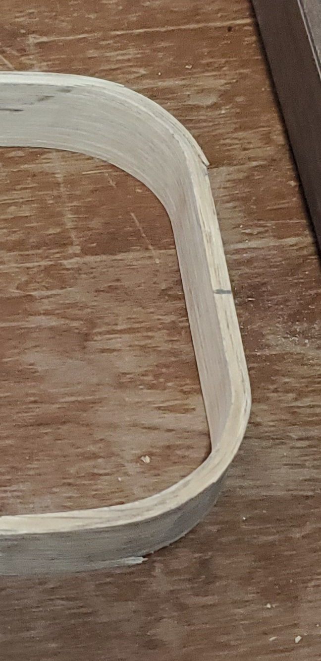

I bent a piece of white oak 3/23" x 1" x 24" and the plumbers tape is only 3/4" wide so there was some splitting at the edge. This tells me the wood need 100% support when bending such a tight radius.
After I put a radius on the edges the splits were gone.

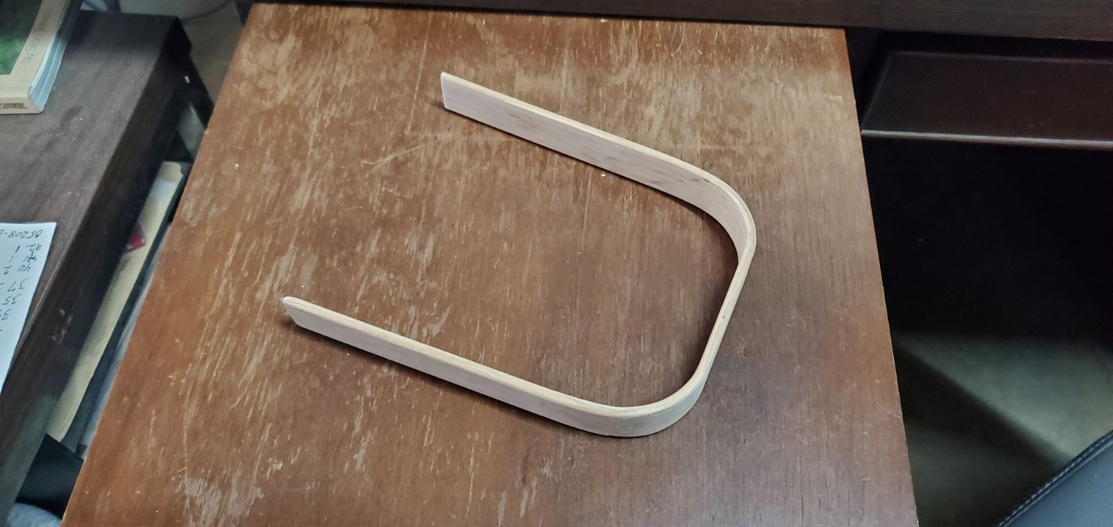

Well the 0.007" strap is too thin it broke on the second bend. Gotta find or make a strap with thicker material.
JT

Plastic will not work because it will stretch and if it stretches any at all the wood will splinter. I used 3/4" metal plumbing hanger for the first few tries.
I may try to double up the 0.007" shim stock but that seems to be a bit of a challenge to get the holes perfect in both strips...
JT
That just might be the ticket it's 1 3/8" wide and 0.040" thick and has holes in it!

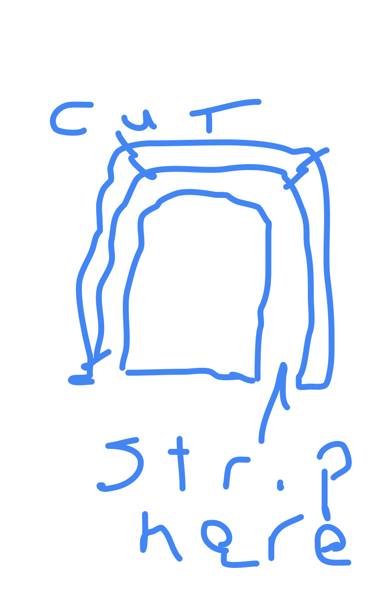

Kinda late on this , but why not use solid wood as an outside loop and just drive the outside loop into the inner.
Second idea still in solids . Cut the outer loop into thirds at the curve. Then clamp in two directions to close the corners. Yeah lousy drawing but maybe better explanation of idea.
I "think" I know what you're suggesting... but maybe not.
The wood would just split out at the corners if you allow it to expand in length on the outside of the bend. The strap and blocks keep the wood part from expanding in length so all the fibers must compress as they bend.
JT

one thing that jumps out at me JT while testing, it appears you are bending flat sawn wood, it will separate and split far more than quarter sawn. Quarter sawn is much better to work with, you don't have those flat sawn flakes coming off the outside curve.
Just in case you were not aware, if you are aware, then disregard what I just blabbed on about!

Actually I just grabbed a bit of white oak and didn't pay much attention to the grain direction. I'll have a look and see what I used.
