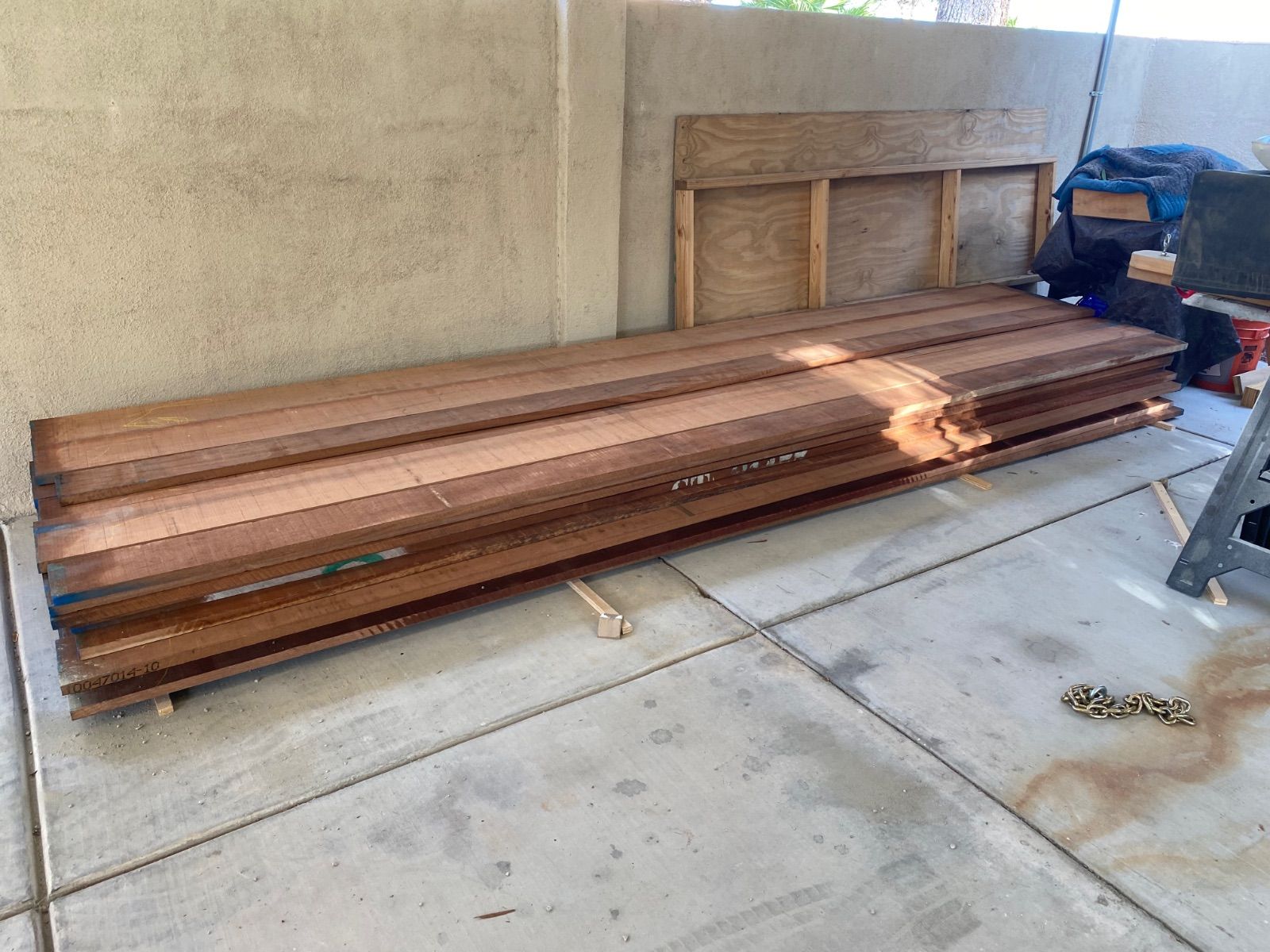

Popular Post Masonsailor Posted June 1, 2023 Author Popular Post Report Posted June 1, 2023 You were close to right on the money Fred. The trailer was just about maxed out. And it’s made to haul a Bobcat. I included a picture. That is minus 100 bd ft for my neighbor, so that is 600 bd ft in the picture. Paul Cal, Gerald, Fred W. Hargis Jr and 2 others 5 Quote
Masonsailor Posted June 1, 2023 Author Report Posted June 1, 2023 And another 100 bd ft of that belongs to Static LV. Now the fun begins. Paul Grandpadave52, Fred W. Hargis Jr, Cal and 1 other 4 Quote
Fred W. Hargis Jr Posted June 1, 2023 Report Posted June 1, 2023 12' boards? Nice! Cal, Grandpadave52 and lew 3 Quote
Masonsailor Posted June 1, 2023 Author Report Posted June 1, 2023 14 footers. lew, Cal, Al B and 1 other 4 Quote
Gene Howe Posted June 2, 2023 Report Posted June 2, 2023 Paul, if your doors will be standard 6' 8", 14 footers will just work. I'll bet you figured that, already. lew, Cal and Grandpadave52 2 1 Quote

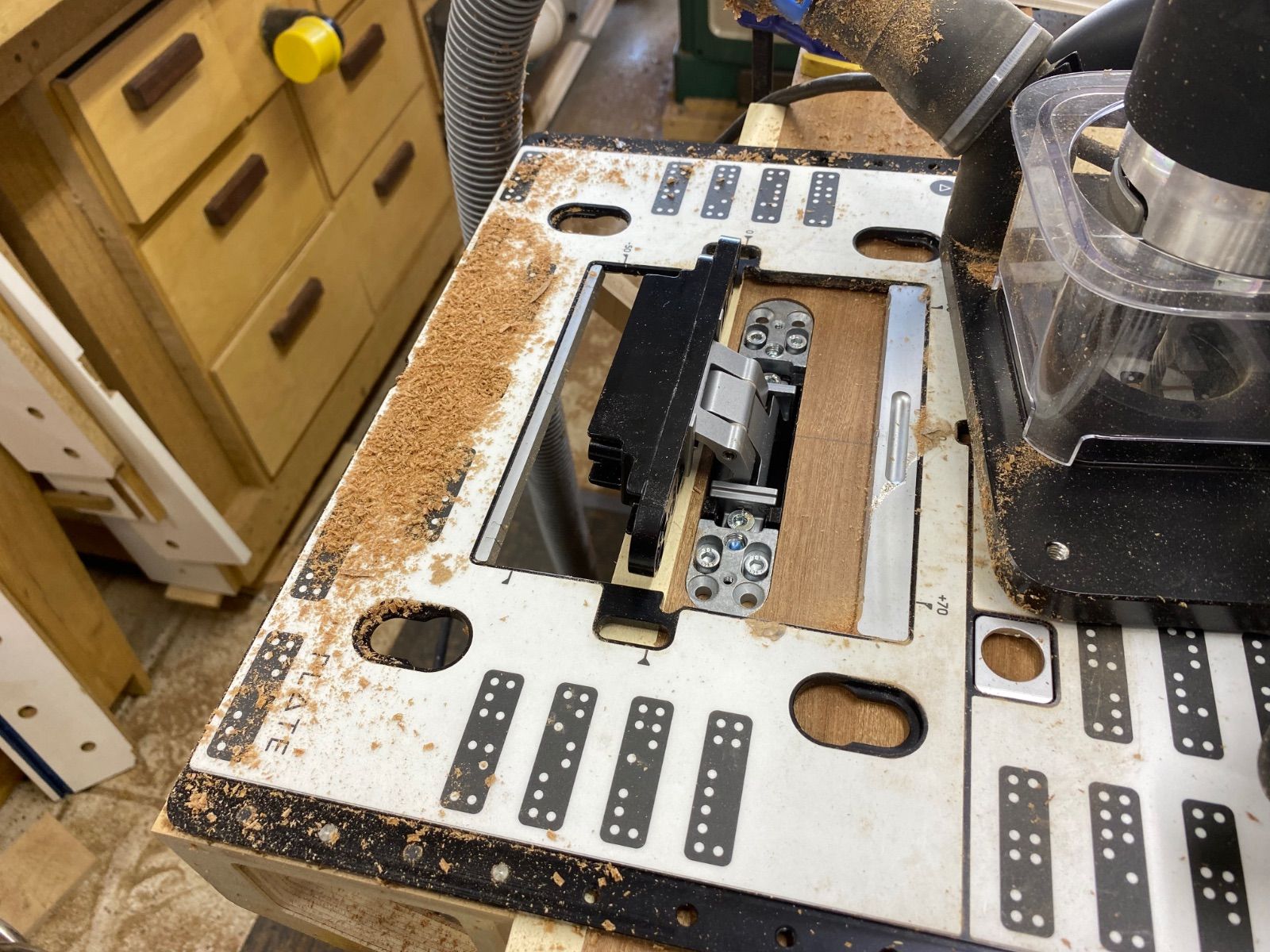

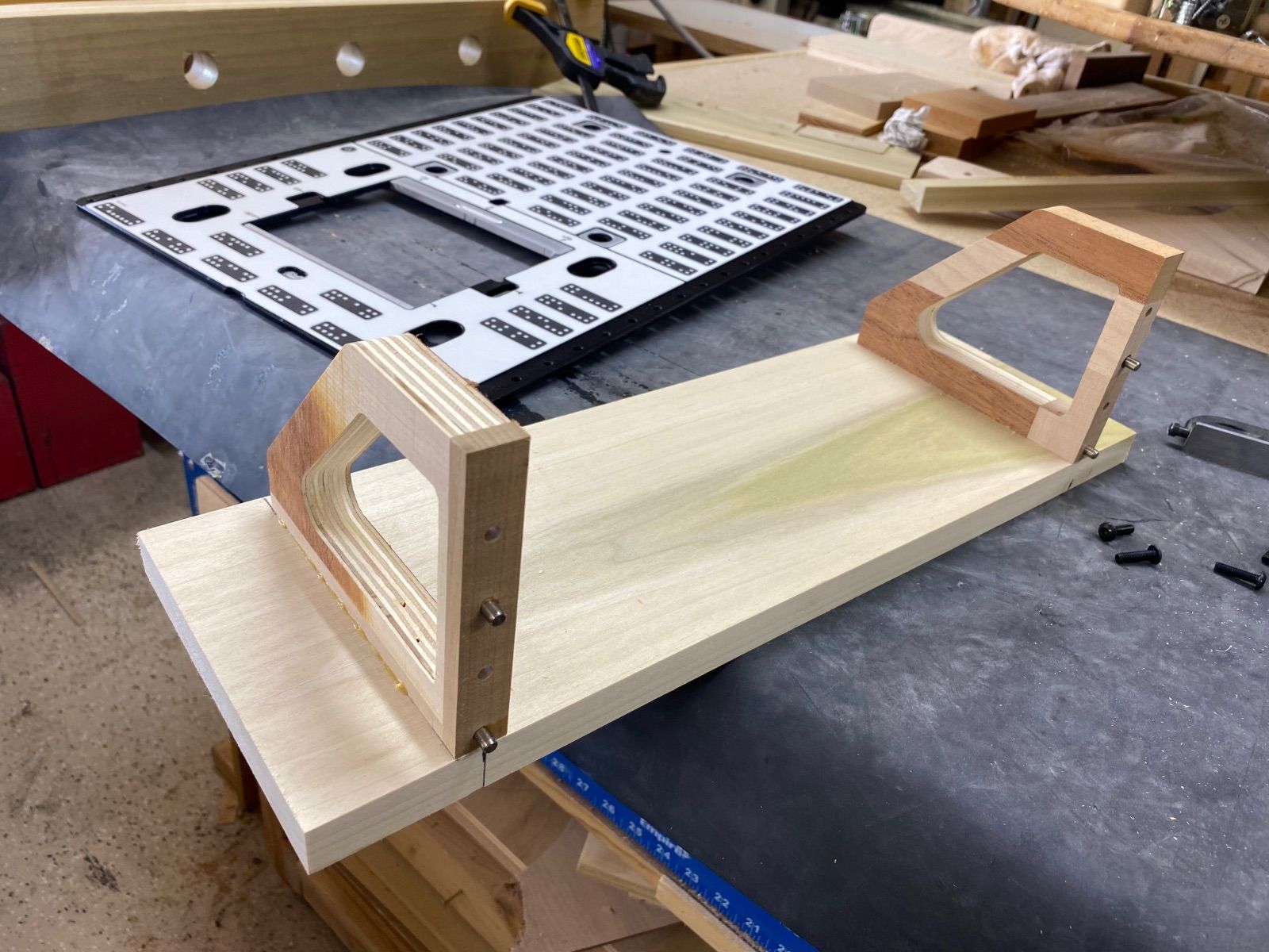

Popular Post Masonsailor Posted June 4, 2023 Author Popular Post Report Posted June 4, 2023 Today was playing with the Shaper Origin and the Tectus hinges. It was quite a bit simpler than I was anticipating. The cut files were available on the SO site for the hinges so it was really just a matter of sizing it to the thickness of the doors which is 1 1/2”. I had to make a jig to support the SO but the cut files for that were also on the site. Tomorrow it’s time to start gluing up. Paul Grandpadave52, lew, KevTN and 2 others 5 Quote

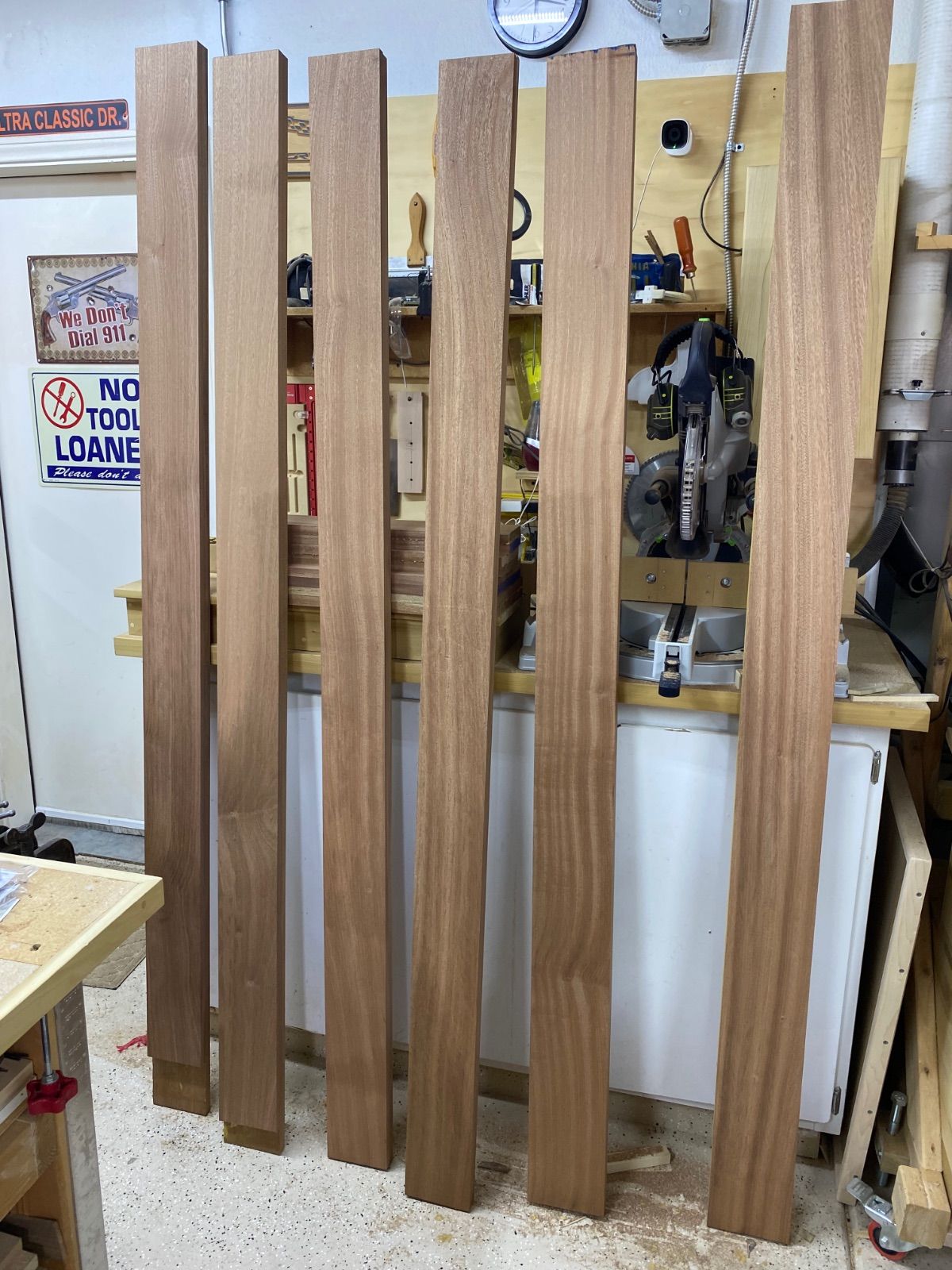

Popular Post Masonsailor Posted June 6, 2023 Author Popular Post Report Posted June 6, 2023 We have spent the day milling and gluing. The first two doors are glued up. Now I will let them cure for a few days and then mill them to size and make the two doors. She made a change to the “Zagarat” design on the top rail but I think we arrived at a good compromise. While the glue is curing I will do a test run on the inlay and see how it goes. Paul StaticLV2, Cal, Gerald and 4 others 7 Quote

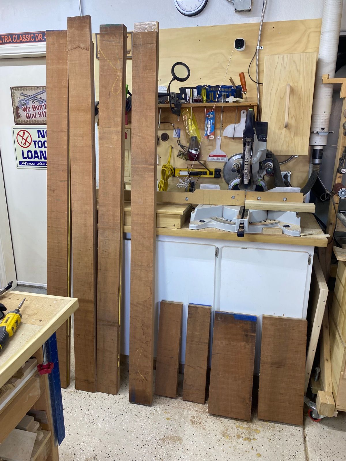

Popular Post Masonsailor Posted June 16, 2023 Author Popular Post Report Posted June 16, 2023 Back in the shop today. Got all the laminated pieces milled to thickness and some of the drywall removal in prep for installing the jamb. Paul DuckSoup, lew, KevTN and 2 others 5 Quote

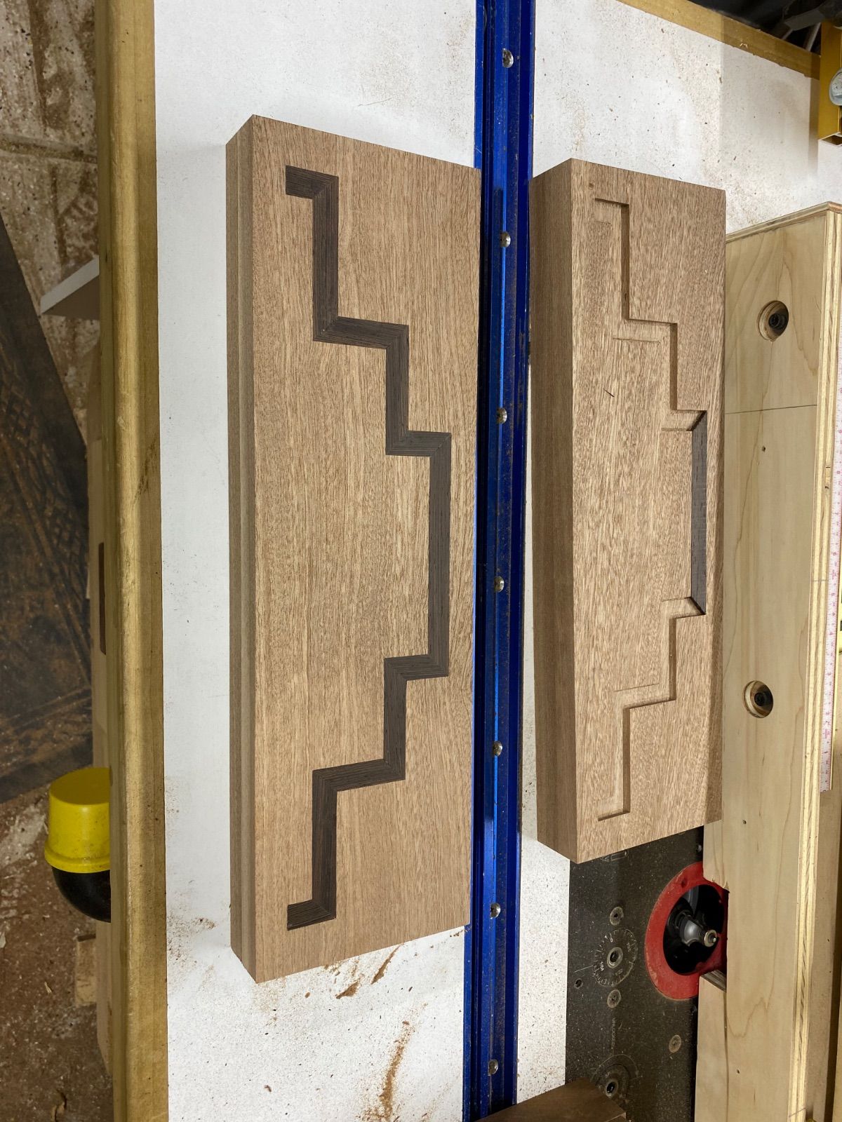

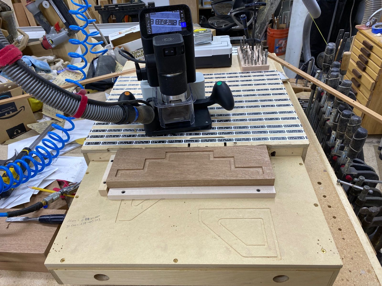

Popular Post Masonsailor Posted June 19, 2023 Author Popular Post Report Posted June 19, 2023 Spent today getting all the jigs and SO stuff in place. It was mostly cutting stock to length and prepping the inlay for the Wenge. I had to develop my own SVG files for the SO as the ones they supply had a flaw. Next is inlaying the Wenge. We also prepped the jambs. Paul DuckSoup, Grandpadave52, KevTN and 2 others 5 Quote

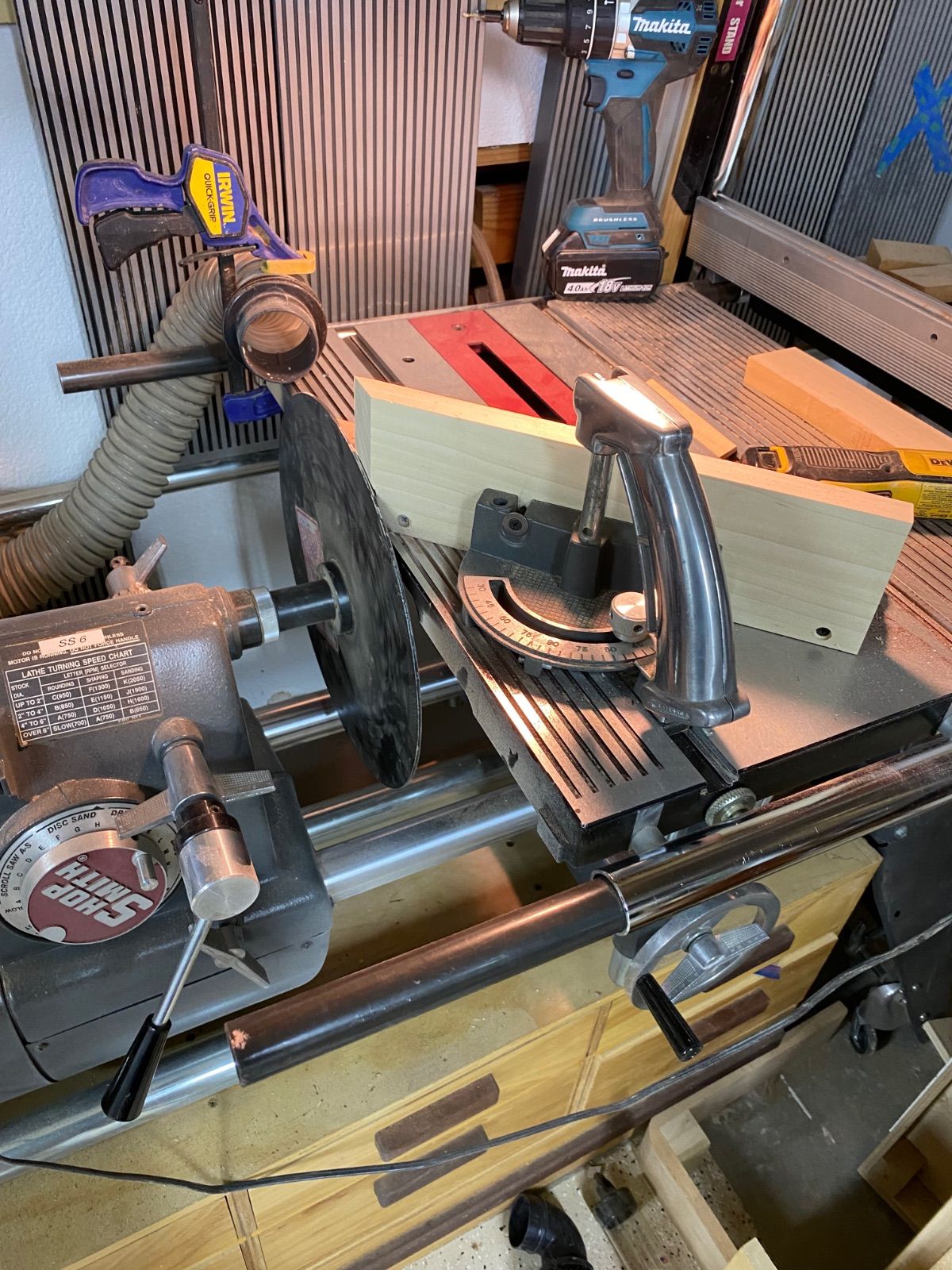

Popular Post Masonsailor Posted June 20, 2023 Author Popular Post Report Posted June 20, 2023 The Wenge inlay was more about making the jig to size the pieces. It turns out cutting small pieces of Wenge with a miter saw does not work at all. They just explode. So it all boiled down to using abrasives and the Shopsmith. The pieces get pretty small. Any way it worked well and fairly quickly. Paul lew, Gerald, KevTN and 4 others 7 Quote
