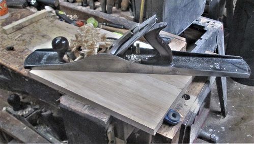

    We'll see...Hauled 2 planks to the shop... Each are 59"~ long...Bad when it makes a Stanley No. 8c look tiny.. Plane is 24" long.  Maple flavoured shavings, anyone? Go

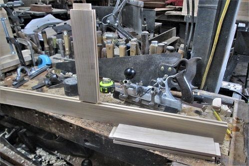

A Stanley 45 can be a bit "finicky" to set up, at times..:ArguingSmileys:
Stiles for the end frames need a tongue milled...to make a corner glue joint.  :OldManSmiley:
All of this was AFTER I got the last 4 of the 1/4" x 1/4" grooves done:Cheer:

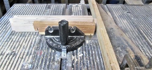

Laundry Detail also meant I had time to set up for some tenons...finding just the right blade height was the problem.  :ArguingSmileys:
First try..was a tad too skinny..:BangingHead:
So, lower the blade a hair..try again..
And see how this fits..

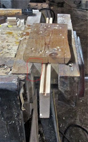

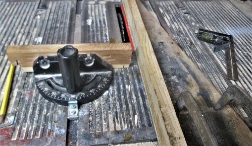

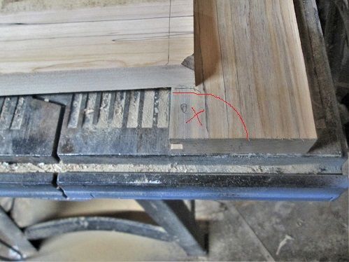

Used a bit of scrap to make this "pattern"   Tenons will be "Haunched"  ( a notch)  that fills in the groove , and then fills in a 1/4" deep mortise.  Not about to do all of the tenons by hand...so..:ChinScratch:
We have ways.:DevilLaughing:  Fence is more of a Stop Block, than a guide.

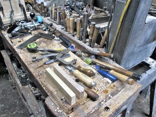

I also set out a few parts...:OldManSmiley:
To check how the panels will fit ( they were about 1/4" too long)  and to see about a foot...:ChinScratch:

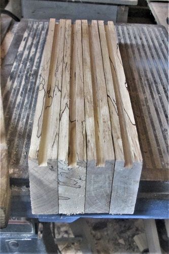

Those last four rails....were ripped for width, cut for 11-1/2" length...jointed and grooved.:ChinScratch:

Some real "purty" spalting in some of those pieces.
Coming along quite nicely.

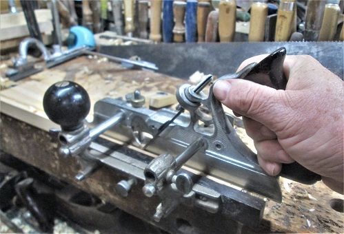

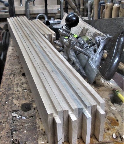

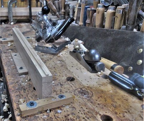

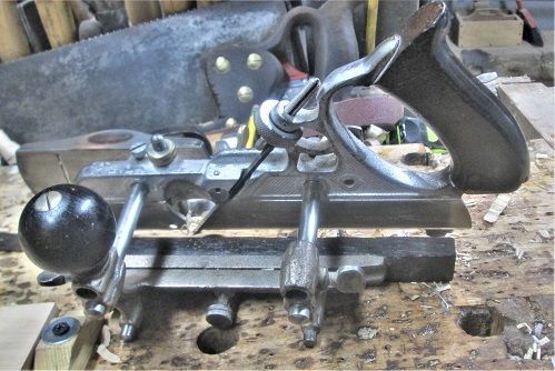

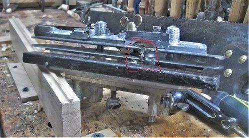

Got the last of these things done.   Cutter was centered, issue was the wood was a hair wider than the cutter was designed for...block plane to remove the extra along the edges.:ArguingSmileys:.Time to change the Stanley 45 a bit...sliding stock was removed, reset the fence..and the depth stop was set up..:OldManSmiley:
Not going all that deep, either..only needed 15 strokes....(left hand was operating the camera, BTW)
This groove is for the inside face of the front/back stiles...:OldManSmiley:
Once I figured out which face that was...test fit?:ChinScratch:

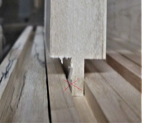

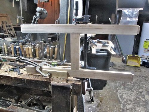

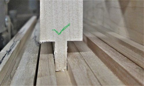

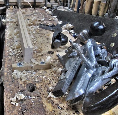

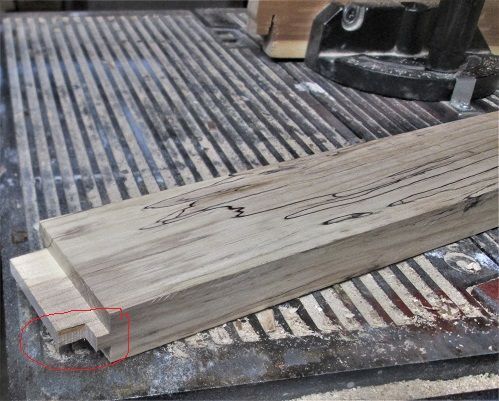

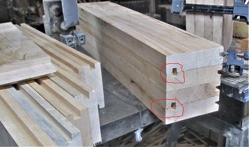

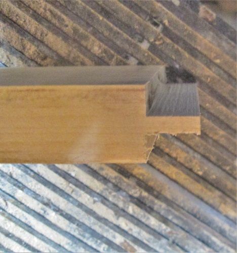

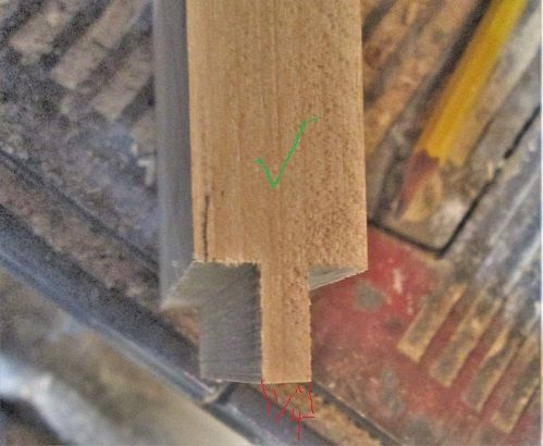

Time to "Up Date!"  :Cheer:Already had the dividers milled with tenons..
But, the rails need a little different set up....while I can do most of the tenon like this..B).

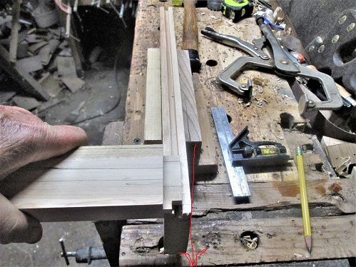

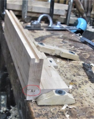

On the edge with a groove...it is the edge without a groove that needs a little different set up..:ChinScratch:
All the rails will be standing up, with the groove showing...same blade height....just the fence gets moved a bit..:OldManSmiley:
Called a Haunched Tenon.   The longer section goes into the mortise, that little tab fills the groove..:OldManSmiley:
(had some crumbs down in the mortise:ArguingSmileys:)  Only needed 16 such tenons..:ChinScratch:

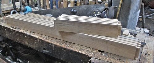

Stand a rail upright, one pass through the blade, bring the part back to top of blade...and slide to the left..rotate, do the other end, and stack up, up of the way...:Cheer:

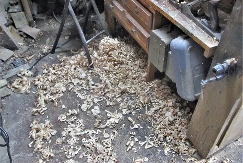

Made a nice pile of sawdust, last night...floor WAS clean, BTW:BangingHead:

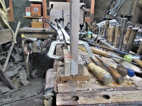

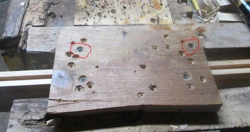

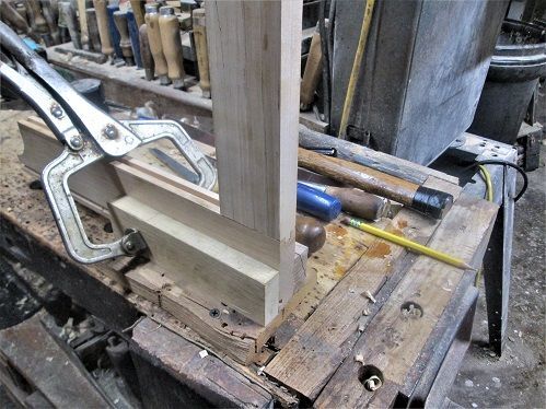

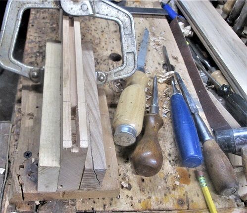

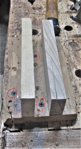

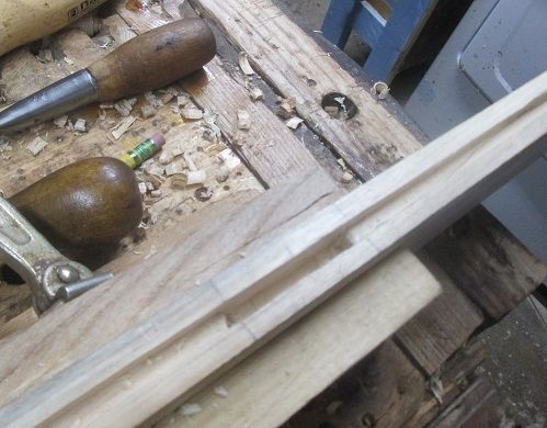

So...I now need 20 mortises chopped...checked the Mortise Jig...still set up to do 1-3/4" legs...one jaw was broken...time to replace that jaw, and reset the jig...:TwoThumbsUp:

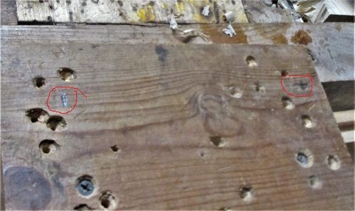

New jaw, stile, and old jaw...needed new holes..
As none of the old ones line up..of course..Pilot hole drill/countersink bit ( still split out)and 2 new screws..
Flip the jig over, and install right over the top of the bench's leg..

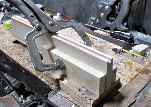

Test things out..
Jig does have a clamp, BTWB)

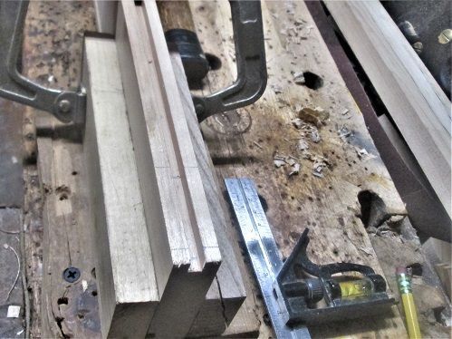

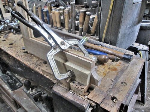

Slide the stile out a bit, and do a quick layout..:ChinScratch:
Then slide back in, and clamp up..:OldManSmiley:

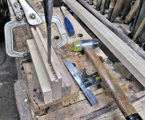

Goal is to chop down about a 1/4":Cheer:

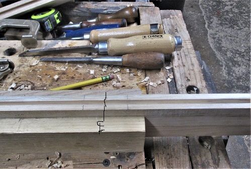

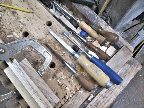

And remove the waste...1st pass with a chisel...:WonderScratch:
Then a couple more, trying to find just the right chisel, to get to the bottom of this...:Cheer:

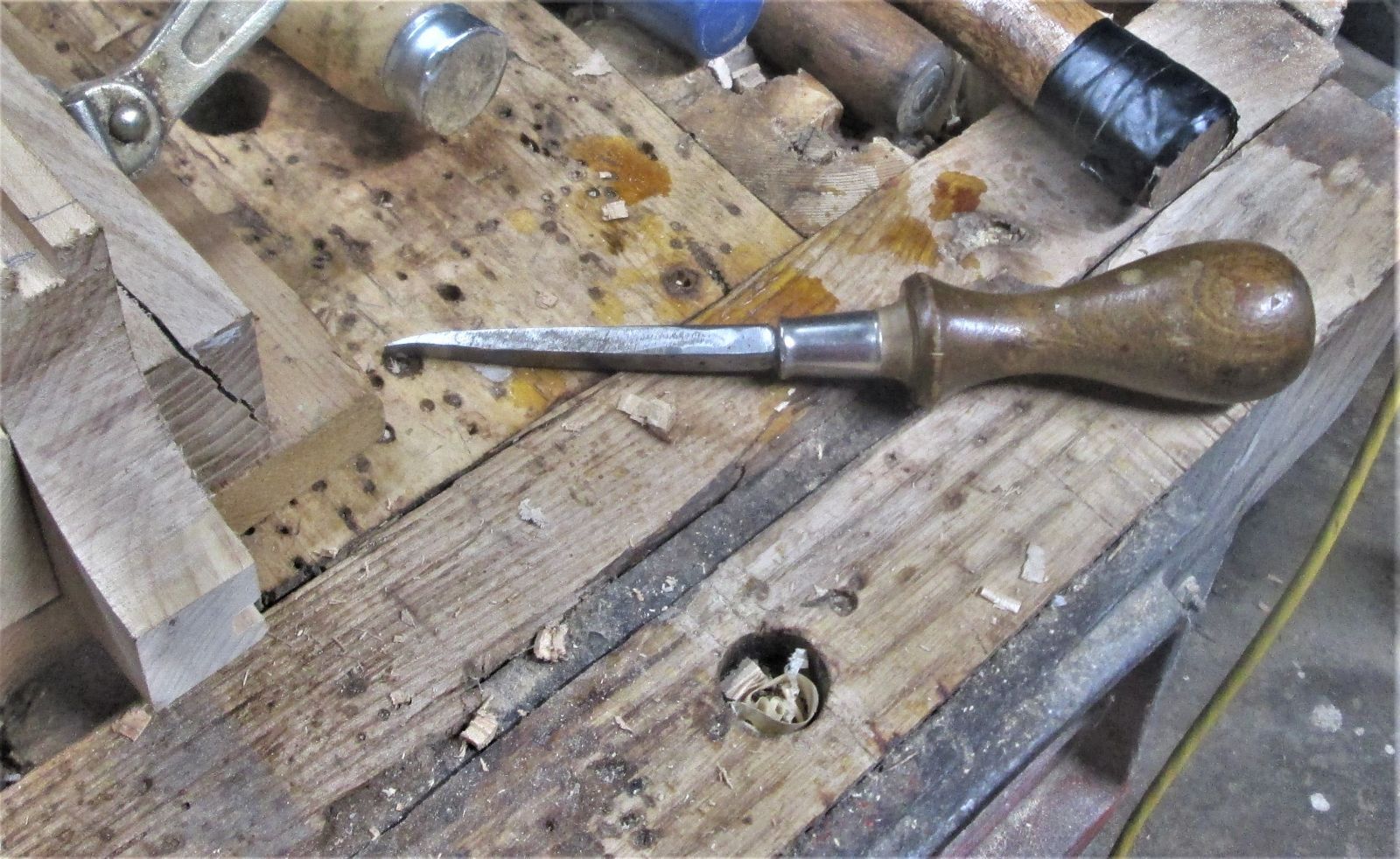

Fancy handle is a Chip Cleaner..:ChinScratch:
Almost like a hook, pops the chips right out, saves the regular chisel from doing any prying..B)
Test the fit..:ChinScratch:
Close..had a couple crumbs holding things up...then simply rotate around..:OldManSmiley:
And repeat....19 more times...:JawDrop:

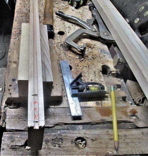

Mortise count:   need 20...:OldManSmiley:
4 are now done.:TwoThumbsUp:..I'm keeping the end stiles with their front or back stiles...:OldManSmiley:

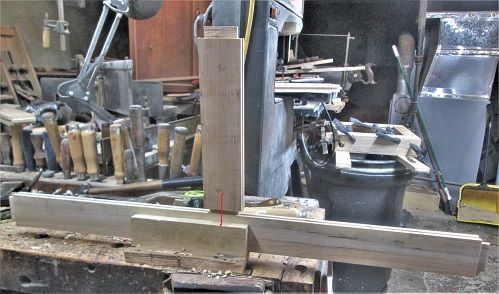

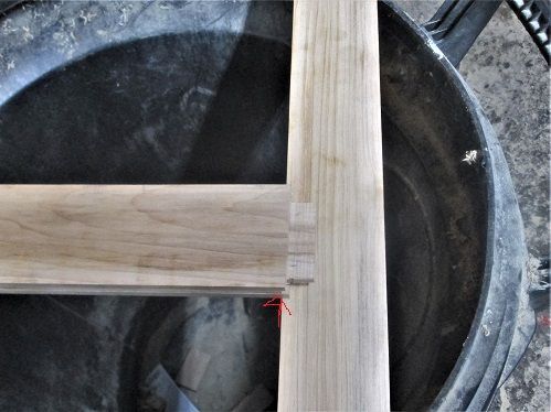

Tried the center divider for fit..one side was placed where it should be..:ChinScratch:
once it's mortise is done..:TwoThumbsUp:.however, at the other end...:DevilLaughing:
Hmm.:ArguingSmileys:.seems I'll need to trim a half blade width off each end..Rails are straight, BTW....:OldManSmiley:

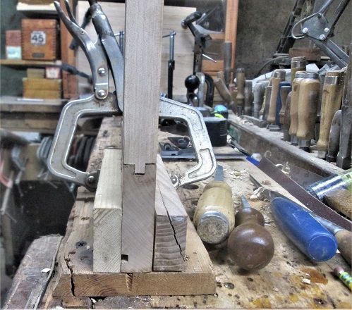

Needed to chop a few more mortises...had to sharpen a few chisels, first.:OldManSmiley:

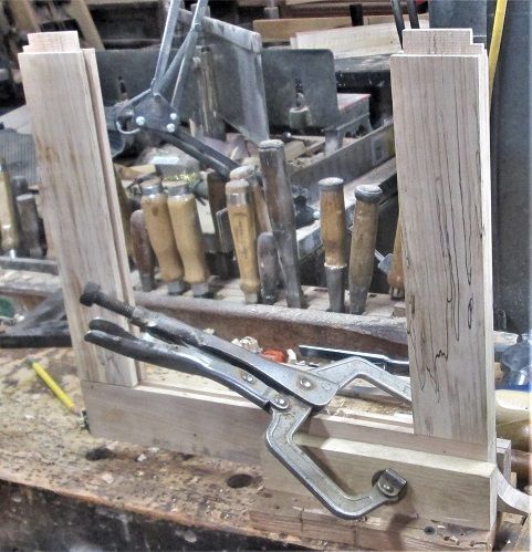

The goal for today..was to get the 2 ends "connected":ChinScratch:

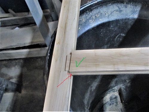

Some of the tenons needed a bit of a trim to get the shoulders squared up..:ChinScratch:

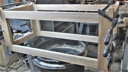

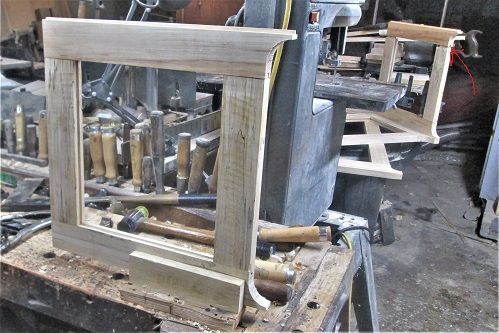

One end frame dry fitted up, need to get that other one done..:SaluteandRun:

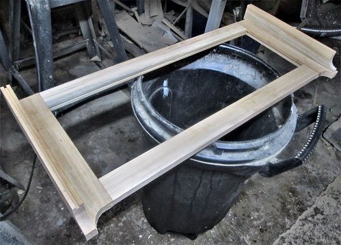

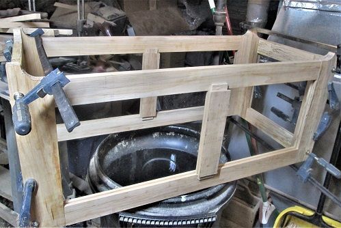

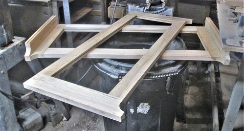

Almost a FULL dry fit..:TwoThumbsUp:

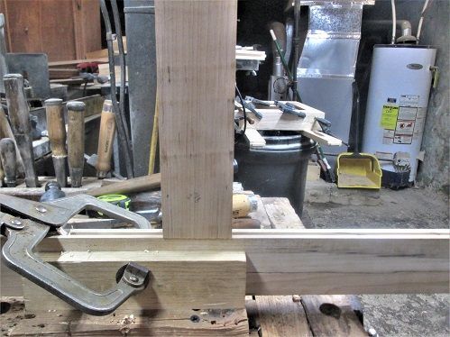

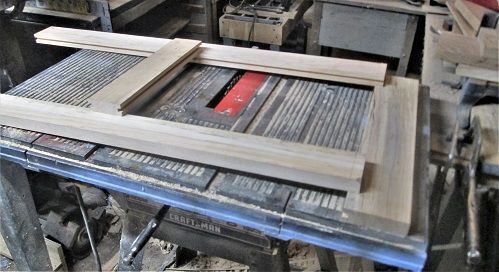

Front view.   Move this out of the way, run the tablesaw a bit..:SaluteandRun:

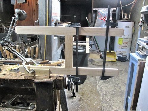

Until the 2 dividers just slipped into place.  Next, Find the center of things..:OldManSmiley:
Lay out for the mortise..:ChinScratch:
Chop said Mortise...bruises and all..:JawDrop:
Test the fit...:ChinScratch:
Rinse and repeat..:SaluteandRun:

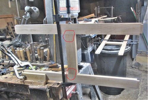

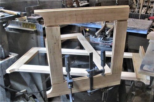

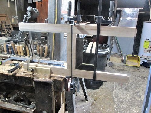

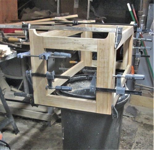

Test the clamp set up...then spread some glue on the tenons..:Cheer:
2 in the middle, and the 3rd to equalize things...checked for square, too...set aside..:ChinScratch:
This time, I did mark the center lines...something still looked "odd"....:WonderScratch:
Turned out, this end was 1" wider than the other end...pulled things into alignment...and set this aside, too...:TwoThumbsUp:

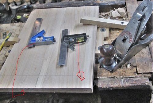

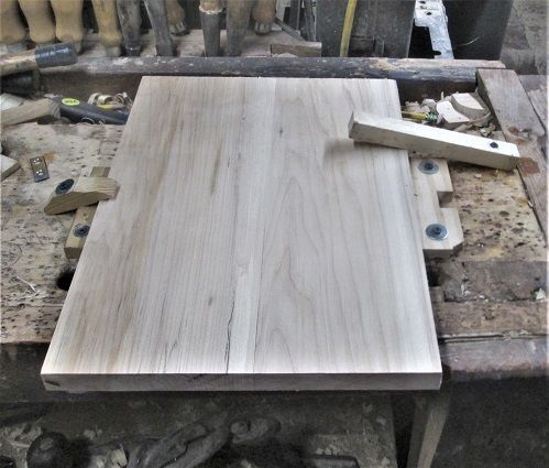

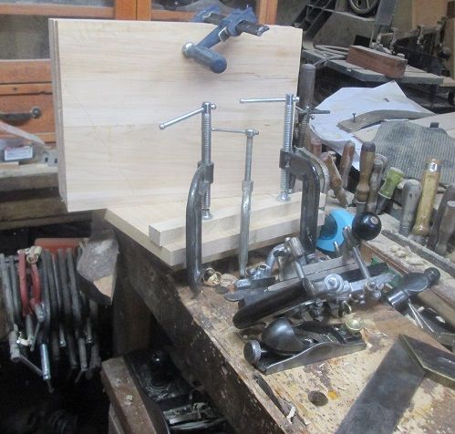

These panels....which need flattened, of course..:BangingHead:
Then a jig set up..:SaluteandRun:
And a few tools to lay out and plane a bevel...:OldManSmiley:
One line for the top of the bevel to stop at, one for the bottom edge of the bevel to stop at...square for each.   Millers Falls No. 9 to mill the bevel on each edge...to make a raised Panel.....next time I go to the shop..:DevilLaughing:
