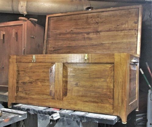

Red lines are how much room I'll have.  Need a chest of some sort to place all of this "stuff" in...and maybe dress up the area?:ChinScratch:
Wondering IF 22 bdft will be enough..:WonderScratch::WonderScratch::WonderScratch:
Thinking about taking the 4 longer planks (5' long) and gluing up 2 panels....to make a front and back , and 2 ends....then the rest for the frames...will have to work around a couple live edges, too.  :ChinScratch: Intend to build the "box" first, then build a lid to fit...may need a couple more planks?:WonderScratch:
A Hobbit sized Tool Chest?  At least enough to hold all that "stuff" on the floor...:MachineGun:
Area I have to work with...Length can be around 32"....height is 17"...with lid.   front to back works out to be around 16":OldManSmiley:
Frame & Panel.....Flat faced panels, or...Raised Panels..hmmm...we'll see..:ChinScratch:

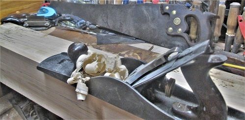

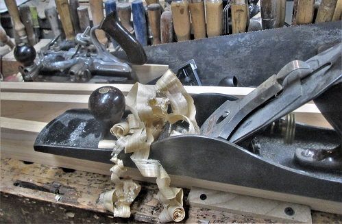

    We'll see...Hauled 2 planks to the shop... Each are 59"~ long...Bad when it makes a Stanley No. 8c look tiny.. Plane is 24" long.  Maple flavoured shavings, anyone? Go

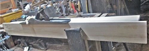

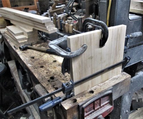

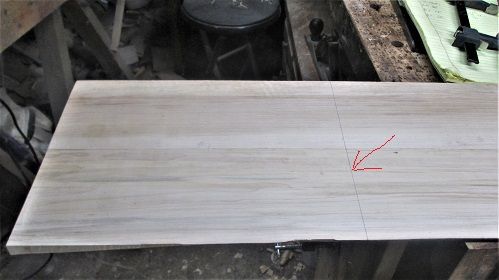

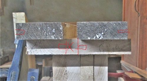

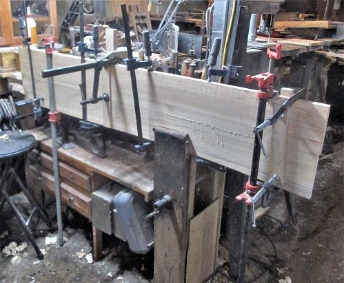

Got 2 edges to match up, jointed them, spread some glue..
Yep, that one pipe clamp is sitting on the floor.   Cauls where needed..clamp the center, then work towards each end...:OldManSmiley:
Let this sit a day, or two...:ChinScratch:
Might see how this lines up...and see about the other 2 long planks...might be able to use two of the shorter planks?:WonderScratch:  Might get both the front and back out of this first panel?   Might just cut one plank....to make the blank for the 2 ends?:ChinScratch:

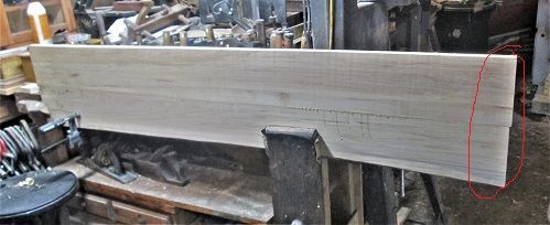

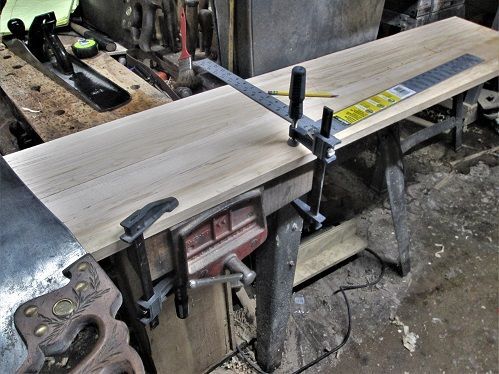

Hmmm...well, clamps came off, today...and I worked for about 1 hour...1530 hrs to 1630hrs....:KooKooClock:
Wanted one edge trued up, to make lay outs easier...so..:OldManSmiley:
Ran the Cordless jointer a bit, until one strip was seen...the full length.  Then needed the ends squared up, too..:TwoThumbsUp:

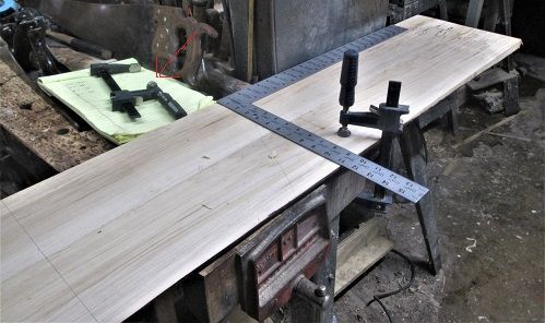

Then lay out for 4 panels.....59" divided  by 4 =?   14-3/4"?:WonderScratch:
Used a large square against that trued edge..:ChinScratch:

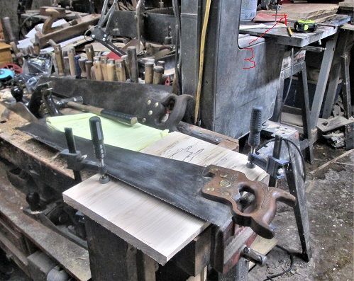

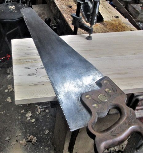

And turned the end of my bench into a "Saw Bench":OldManSmiley:
Made a few cuts...:ChinScratch:
Other saw has a bit less set, straightened out one cut that wanted to bind up ( always one, it seems:ArguingSmileys:)

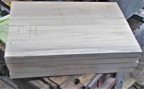

Then set up the rip fence to 10-3/4" width...and buzz the live edges off...as the boards were all tapered..now they are all the same width...:TwoThumbsUp:611467041_JuneProjectalittleclean-up.JPG.21a8f62609c38b589bda24511ee763aa.JPG

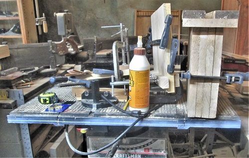

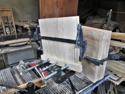

End panels are in the clamps, for now..B)
And...

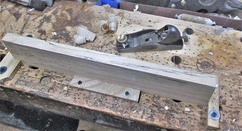

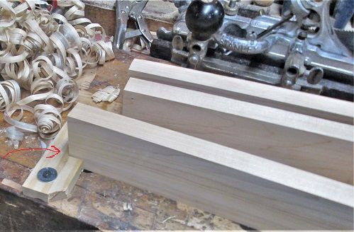

This one is now sitting on the tablesaw, for now....Set up a jig...notched end..:OldManSmiley:

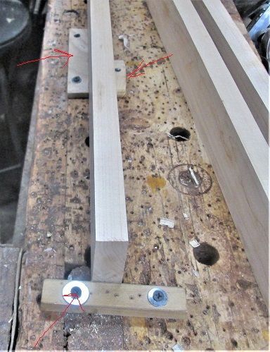

To hold a rail steady, and on edge....locked down by others..

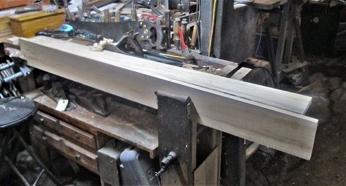

The one on the end pivots to tighten down the jig.  :OldManSmiley: Long rails..need a jointed edge...

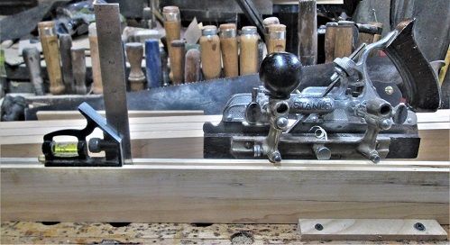

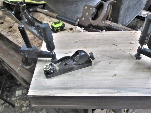

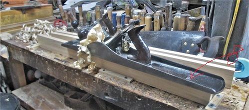

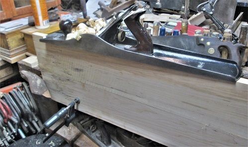

Stanley No. 8c...as there was a bit of rough sawn to this edge...:MachineGun:

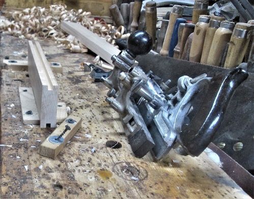

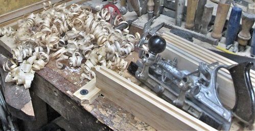

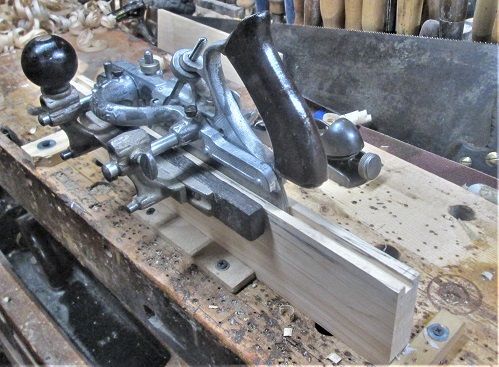

Not any more...then set up the Stanley No. 45...to plough a 1/4" by 1/4" groove, centered in the edge:TwoThumbsUp:

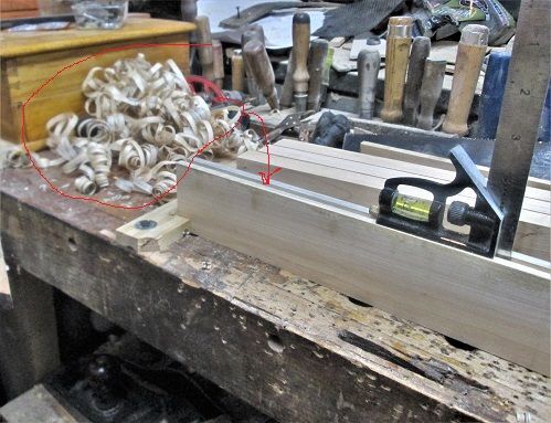

And, set up a combo square..:ChinScratch:
To make sure it IS 1/4" deep.    Groove is to house the raised panels.:OldManSmiley:
How many passes to get 1/4" deep?:WonderScratch:
Oh....about that many.   Maple Flavoured Noodles, anyone?:TwoThumbsUp:

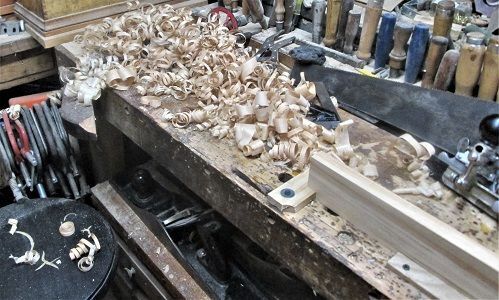

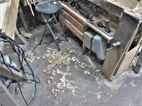

Long rails are now grooved...too many shavings..:WonderScratch:
Even more on the floor...:JawDrop:

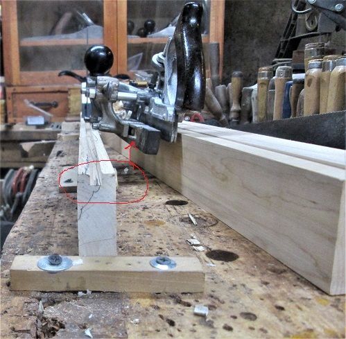

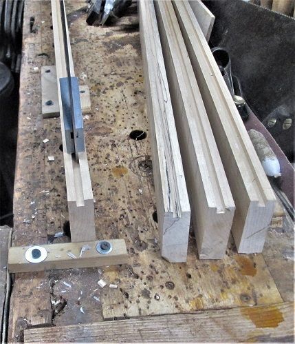

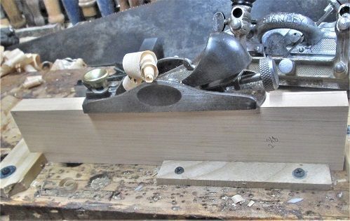

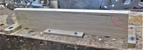

Then reset the jig to hold a Stile..:OldManSmiley:
At 16" long, they are a bit too short for the #8c jointer..so..:ChinScratch:
We have ways..:ph34r:...then, mill a groove...:TwoThumbsUp:
About here, I called it a day.:KooKooClock:..always try again, tomorrow...:ChinScratch:
Spent one hour IN the sweat-box/shop..:ArguingSmileys:.even with the fan set on high, and blowing right on me...:BangingHead:

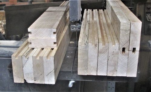

The 4 long rails were already done...stiles for the front and back are grooved...stiles for the ends are grooved...and the 2 dividers, with their 2 grooves...
Takes almost 30 passes to get a groove milled ( Cardio is done, for today) plus jointing the edges before the groove gets done...:ph34r:
Yes, I do size the plane to the size of the work...reset the jig a few times...:ChinScratch:
About every 10 passes, or so, I have to add a spot of candle wax in the groove....makes the plane slide better..:OldManSmiley:

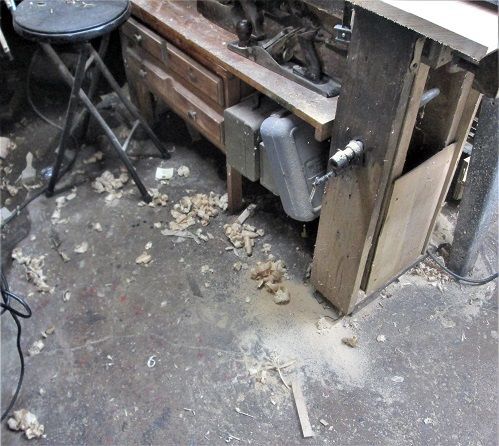

Been making quite a mess, lately...:ChinScratch:
Almost as much ON the floor....softer to walk on than concrete?  With a bit of "CRUNCH" going on..:rolleyes:
Once the last 4 rails are milled and grooved...I can change the Stanley 45 into both a Tongue and a Groove "Match Plane"   except it will use a 3/16" wide T&G  cutters....instead of the 1/4" cutter..:OldManSmiley:
