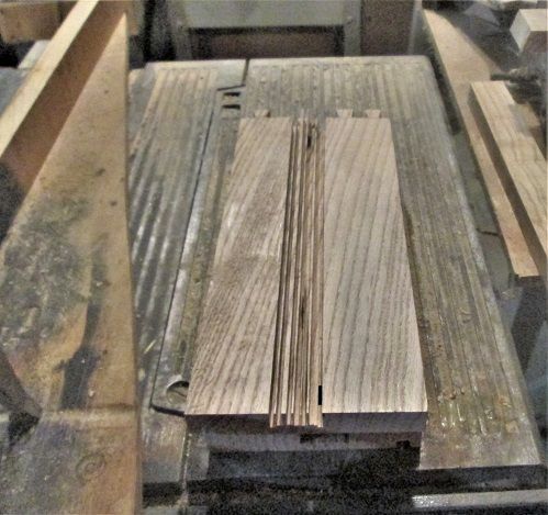

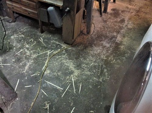

late night follies..got bored again...youtuba acting up.:BangingHead:..might as well go and do something...MESSY :rolleyes:
About 2" deep in the center...:JawDrop:
Ah, that's why...I don't have a dado blade for this saw, doubt if one would fit, anyway...:WhoMe:
Follow the trail...:ph34r:

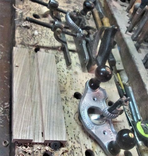

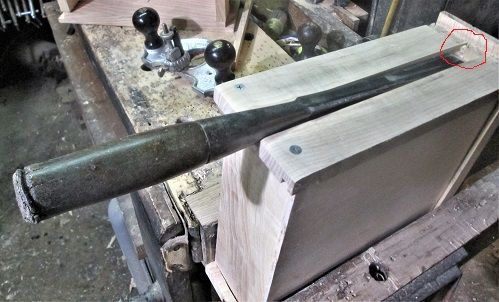

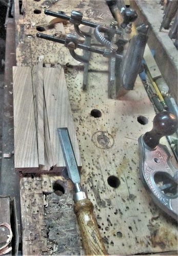

Depending on the direction of the grain.   Final pass with the Stanley 45, Type 4...then a test fit...:ChinScratch:
The runner get attached to the stand, and the drawer will (in theory :OldManSmiley:) slide in and out on the runners, using that groove..

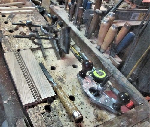

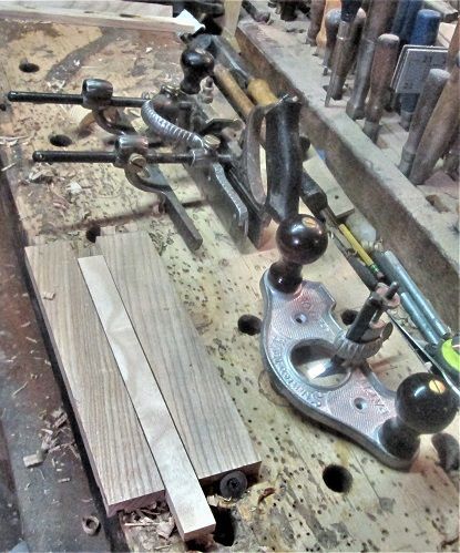

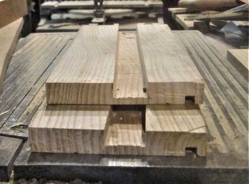

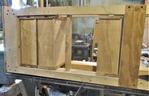

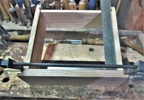

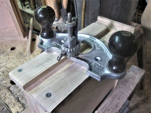

Today was all about those runners....they needed to fit in the groove... and be either flush with the outside of the drawer side, or just a hair thinner...Stanley No. #3, again.    Got all 10 done...thought I was done for today...errand to run...Plywood bought, and a new bulb for the bandsaw...$14 and change.:JawDrop:

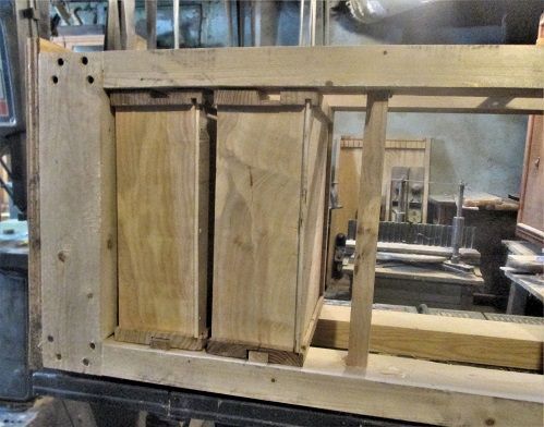

Later, wanted to take a couple pictures....wound up doing a couple dry fits, with the four parts of the drawer...:ChinScratch:
No glue, yet....still need to cut bottom panels.  :ChinScratch:

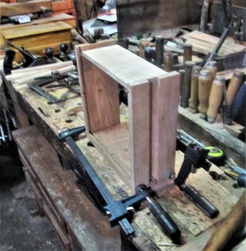

Shows a slight toe-in ?   Better than being toe-out.   Got 2 done like this...however..Drawer #4 had issues..:BangingHead:

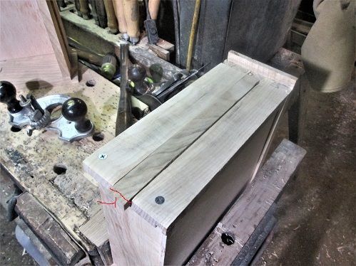

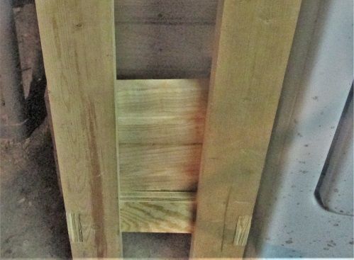

This is BOTH sides of the drawer...see anything wrong?   These are supposed to be mirror images of each other...will need to fixed this one...the other 4 drawers do not have this issue...Ooops:ArguingSmileys:
So...maybe tomorrow, I can fix  No. 4...and cut 5 bottom panels....then see about spreading some glue?   Hope I have enough clamps...:WonderScratch:
The real fun will start when I go to hang these drawers on those runners...:ArguingSmileys:

Correct me if i am wrong, but if you flip one end for end would it not then bea mirror image?
I thought so too until I noticed the dovetails on the far end

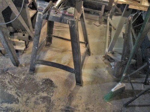

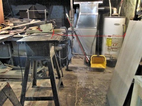

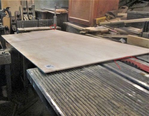

Time came today, for that sheet of plywood to get cut up...had to move a few things around..( welcome to my world..)
Plywood was laying like that, to keep it dry...:ChinScratch:

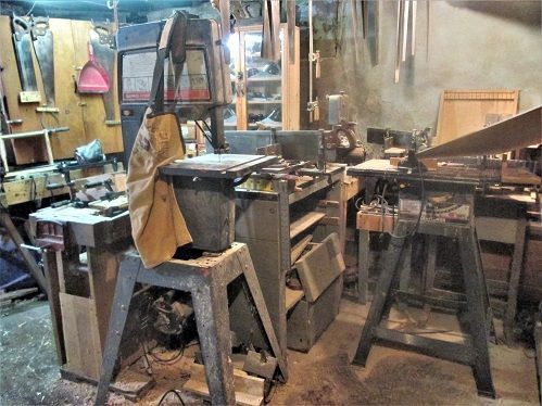

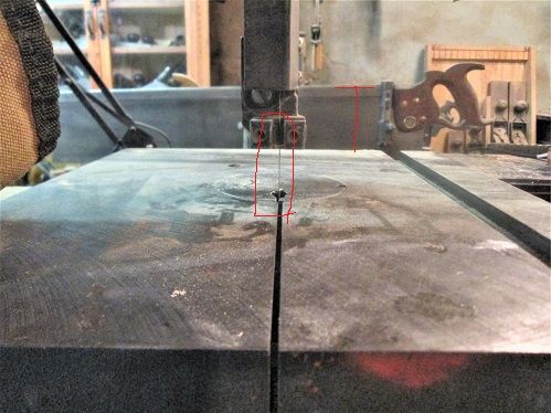

A suggestion was to use that bandsaw...fine....except for the sight line...:MachineGun:
1469551544_TheDungeonWoodworkingshoplineofsight.JPG.57a3a0ee55d7b30f44470c6e9f169973.JPG
Is blocked by that thing, aka , Langdon No. 75 Mitre Box and saw..it's fence lines up almost exactly with the bandsaw blade...:BangingHead:
Had to pull the tablesaw out quite a bit, to make sure I would get past the blade..:OldManSmiley:
633210424_TheDungeonWoodworkingShopjustenoughroom.JPG.d8bcda1ac5fdf2b2fc594e9e0b532fb6.JPG
And stop BEFORE I hit that Stanley No. 346 Mitre Box...about an inch to spare..barely enough room out in front of the saw..:JawDrop:

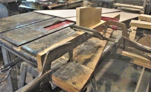

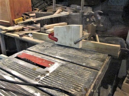

To get my fat body in there..:ROFL:.and shove that panel through....needed to jig a hold down..:ChinScratch:
Attached to the High Tech Rip Fence..:ph34r:
1410423209_TheDungeonWoodworkingShopJiggeddetails.JPG.170f701fa11101280f432138c510c411.JPG

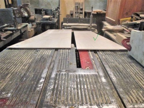

Not too bad.   Time to power up the saw and make the cut ( have heard that line, somewhere before?:WonderScratch:)1864024344_TheDungeonWoodworkingShopdone.JPG.9fbb96d45f0623c52101f7770ea7388b.JPG
Needed 10" in width, had the fence set a little wider, just in case.:rolleyes:..then I can adjust for final size.  :Cheer:
Cross cut: didn't need the fence.  5 parts at 9-3/8"...do a dry fit, mark the excess from the 10" side, reset the fence and run all 5 panels through..then a dry fit again..:ChinScratch:

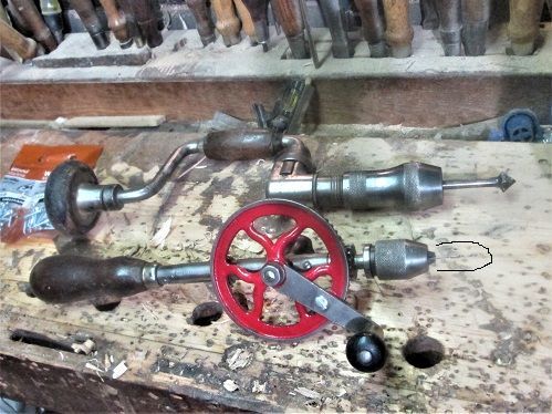

Looks good.  Got out a couple drills..:OldManSmiley:
Little one for pilot holes, the other for counter sinks....and away we go...:SaluteandRun:

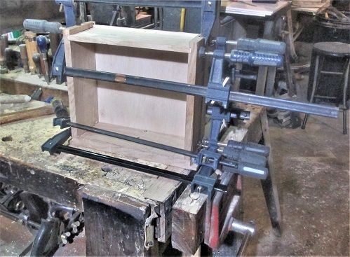

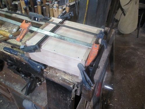

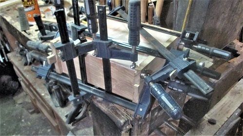

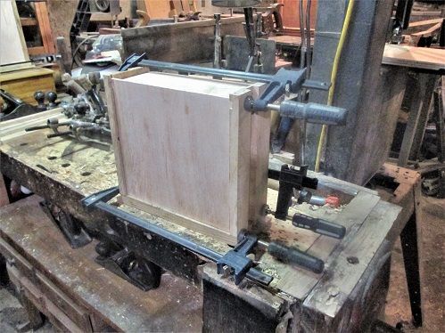

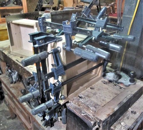

Taking a few more clamps than I thought..needed to drive 6 screws..snapped 3 off...letting the glue work to hold the back to the sides...set this mess aside...:Tapping:
Back home after an errand to run GrandBRAT home...tried one more glue up..:TwoThumbsUp:
Running LOW on clamps...set this aside..:ChinScratch:
And wait  on the glue to dry....:Tapping:   Although..I did one more dry fit...and might do a fourth one later...:WonderScratch:

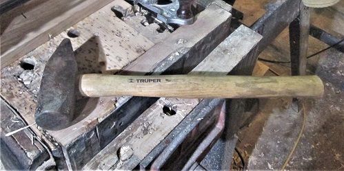

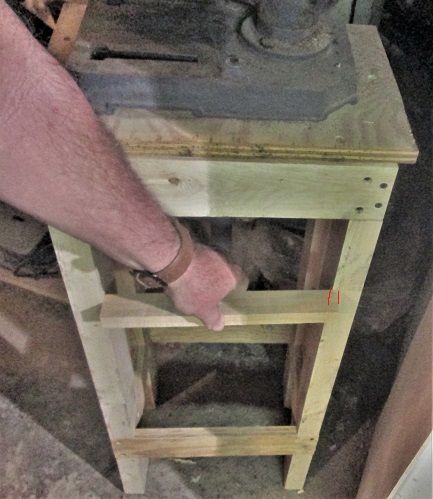

Seems the 2x4 sin the back have bowed inwards...will have to fix, BEFORE any runners can be installed....will add a spreader, then screw a back in place to KEEP the legs that way....more cussing..:PullingHair:..and a BIGGER hammer..will be needed...:ArguingSmileys:
Stay tuned...going to get pretty LOUD later..:JawDrop:

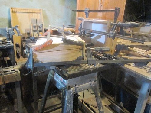

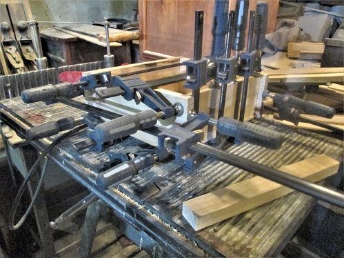

Ok..glue-up #3..:ChinScratch:
Needs the clamps removed, and it needs to get off of my tablesaw.:SaluteandRun:..cut a stick, that exactly matched the front opening for these drawers...held it around in back..:BugEyeSmiley:
Yep..bowed in THAT much..needed The Adjuster...:SaluteandRun:

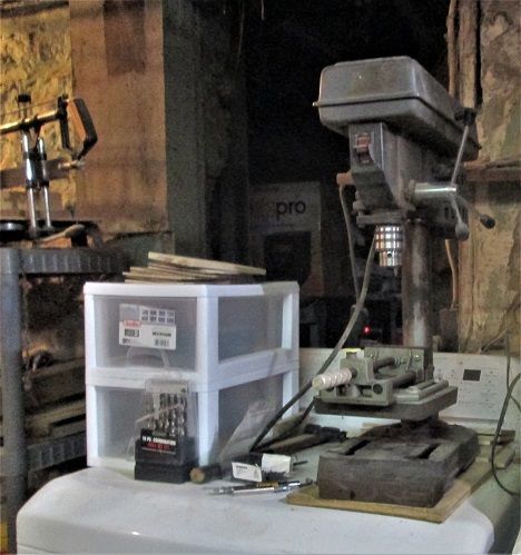

Was having trouble getting a "good" swing..:ArguingSmileys:..un-bolted the drill press..:OldManSmiley:

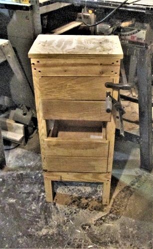

Set it aside, for now ( sitting on a piece of plywood, of coarse)  plopped the stand on top of the tablesaw, and clamped it there...finally got the spacer vertical..let it sit there for a bit...had 3 drawers to clean up, and a 4th to glue up...:OldManSmiley:

A few high spots...router can't quite go all the way to the end, as is..but, we have ways...:DevilLaughing:
And check again..:TwoThumbsUp:
Will trim for length, later..:ChinScratch:.

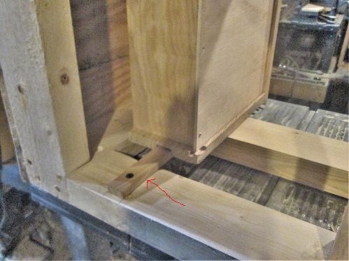

Back to the other drawers...used one to keep checking for sticking points...sander to remove...Thought I could install a few runners, once the drawers worked..:ChinScratch:
Squared across,,2 screws..turned out this was a hair too low...had to move it up about an 1/8"..:BangingHead:
When I installed the second runner...too much gappiness going on...That dang spacer bar is right where the next runner would be...moved to the bottom drawer...it was even Drawer #5!   :TwoThumbsUp:

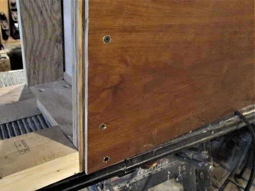

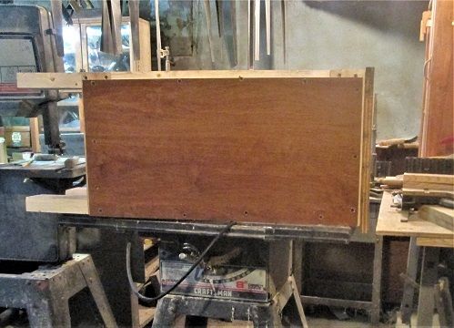

Laundry detail, last night...other side's runners are installed...found a use for a panel from IKEA..
Might be a Metric 1/4" thick?

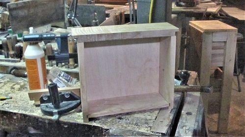

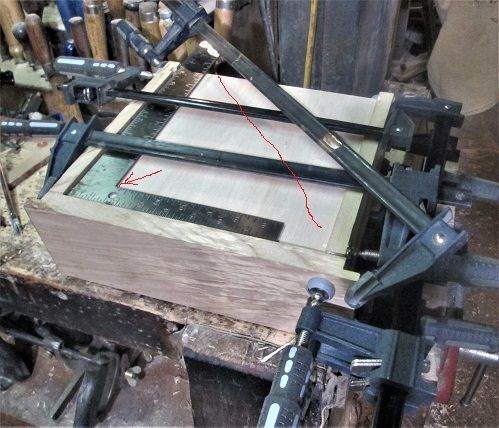

Test fitted Drawer #1...did not go well..
Being pulled into square, now...because I missed one step during it's glue up..
To check for square....if'n it ain't, pull until it is....

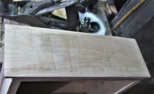

Lumber is supposed to be Ash...Hmmm, seems to be a bit ...curly...
And..the last drawer is in the clamps...
used two runners, as cauls to clamp in the centers of the sides.  Yes, I checked for square..and had to pull this one..
With the back screwed in place on the stand...I could knock that spacer bar out.   Just need to install the runners for the last 2 drawers, sometime.
