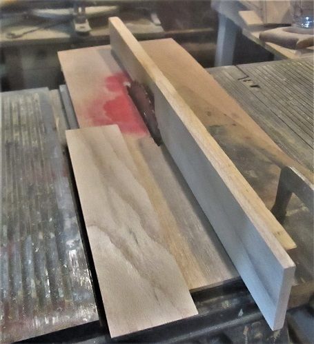

    First off, needed a divider.   3/8" thick.    Still had a bit of Red Oak left.. Cut a chunk off....board is 1/2"....and way too wide...ripped for width....once I figured HOW wide...then abo
  • I was probably 25 years old before I figgered out what that bent part was for.
Great progress Steven.
3 hrs IN the shop, today..all tasks from Episode #2 are now done...Film at 2300 hrs...:Tapping:

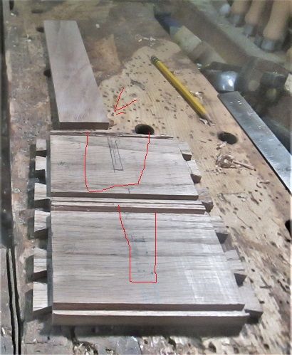

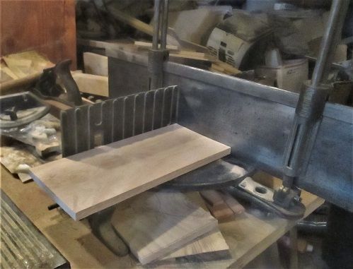

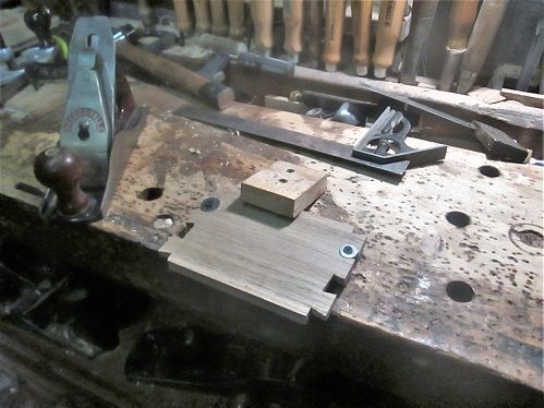

First off, needed a divider.   3/8" thick.    Still had a bit of Red Oak left..B)
Cut a chunk off....board is 1/2"....and way too wide...ripped for width....once I figured HOW wide...then about resawing to 3/8"?:WonderScratch:

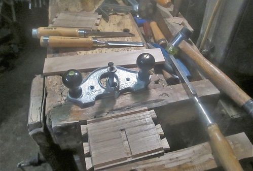

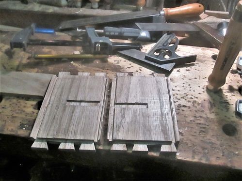

2 passes.  Then go and layout where this will go...:TwoThumbsUp:
A shallow stopped dado.  :OldManSmiley:

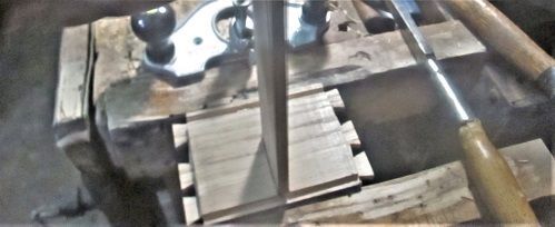

Chisels, mallet, Router plane..test the fit..B)
Repeat for the other end...:ChinScratch:
That task is done...next...jig things up..:SaluteandRun:

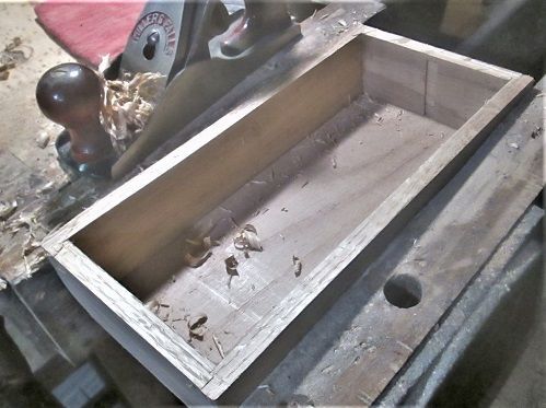

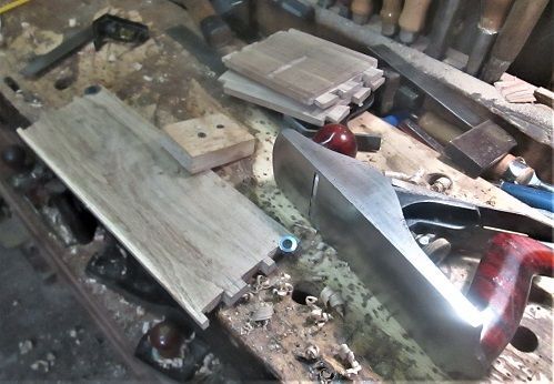

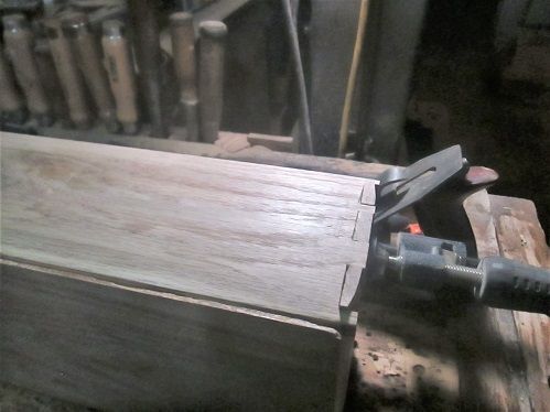

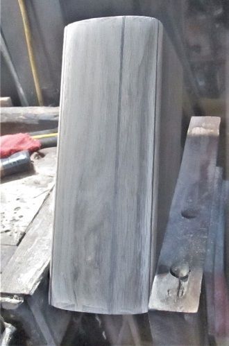

That Millers Falls No. 9 is next....plane a slight curve until it reaches a stop line..:OldManSmiley:
Somewhere about there....feeling for any flat spots...want a nice smooth curve...one edge done, flip around and repeat, until the ends are all curvy..1508539876_TheSellersBox2curvyends.JPG.38d08a26a8d14df63825ae62d71fd77c.JPG
Then repeat for the 2 long sides..:Cheer:

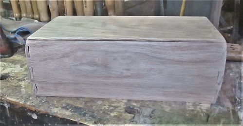

Had to also bring out the WR 62....seems there was a knot to plane over...Dry fit...lid needed a fine tuning.....1237769366_TheSellersBox2dryfitting.JPG.eaf7260ea432ef8f2483a77bd1bd2c1d.JPG
Gaps will close up when clamped...

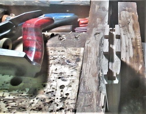

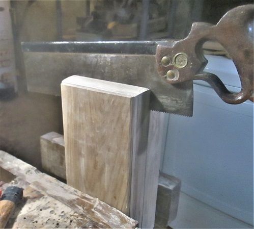

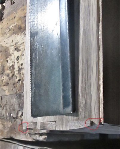

Where the pins/tails stood proud, they were sawn flush....then th whole mess was sanded smooth..
Have to trim these back....then just let this sit on the bench, for now....:ChinScratch:
Doesn't have the bottom in yet....hard to knock this apart to get ready for a glue up....:OldManSmiley:

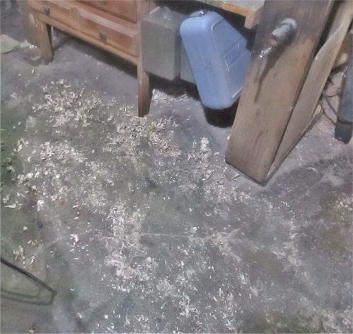

Made a mess, again....par for the course:ph34r:

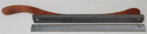

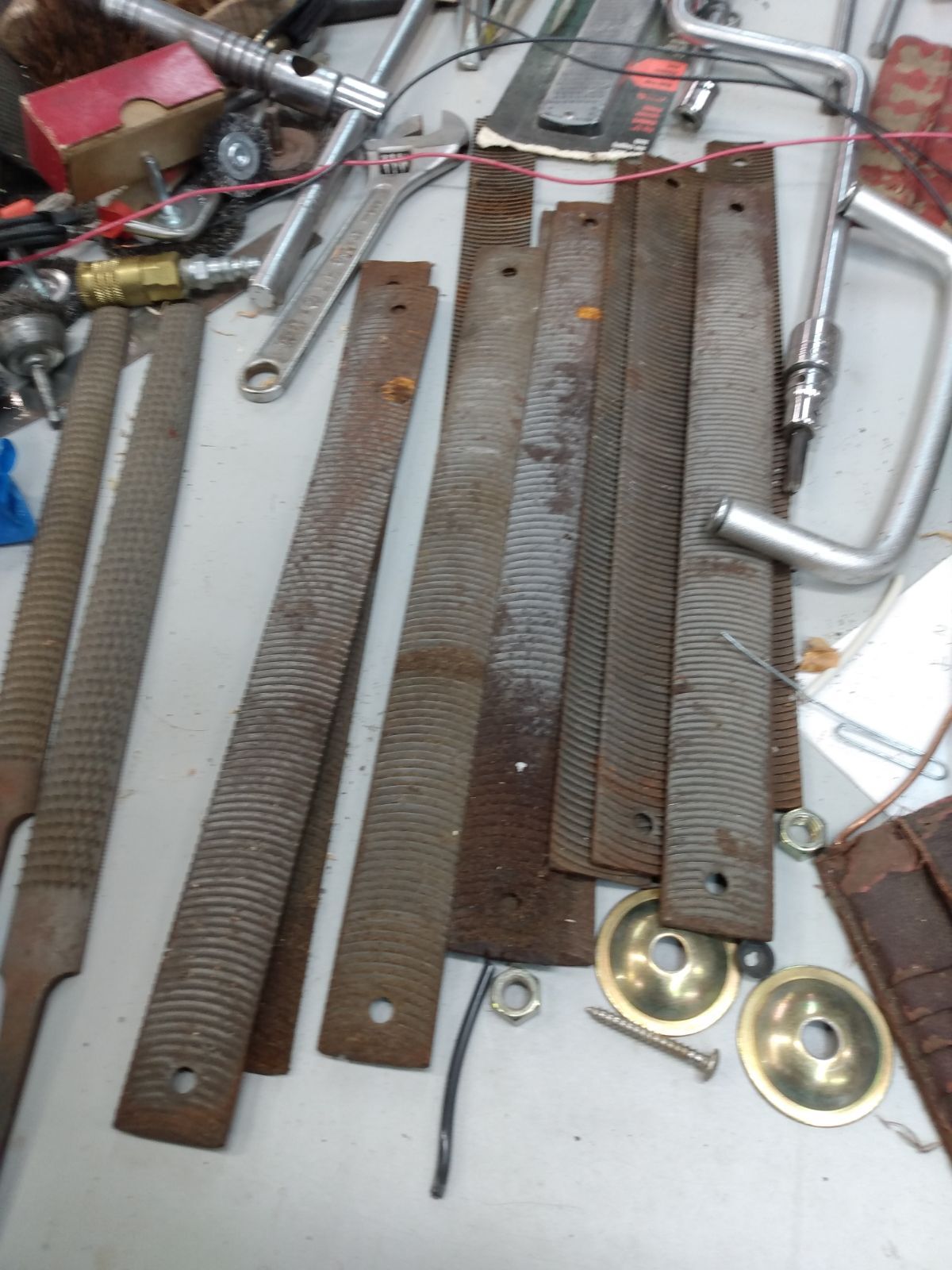

Good, I need the break.  While you're goofing off tell me what these might be. And if I am missing a handle for them.
The pile on the right are "body" files/rasps for chugging down bondo (or in the really old days, lead) filler. Yes they are missing the handle...it'll take me a minute to find a pic, but Snap-on, Mac, Matco and others all sold those.
EDIT add:
Missing handles on the left too, but appear to be wood rasps. Ferrier rasps usually would not be 1/2 round.

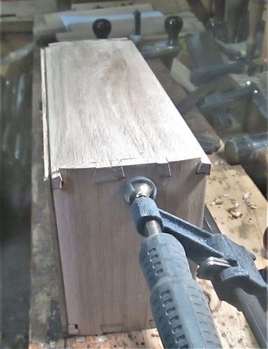

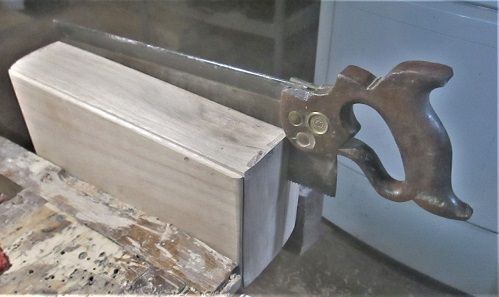

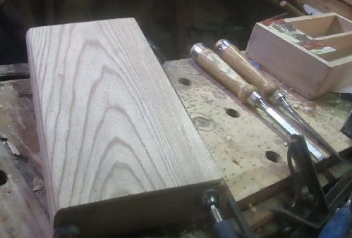

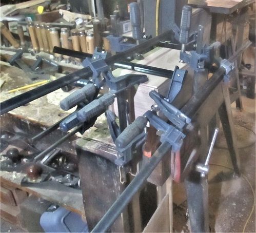

Was sitting here, resting up......dialed up Sellers' Episode #3  ( mistake #1)  to see what tasks he had in store....Figured I could try the roundovers...(mistake #2) and then he did the glue up.....hmmm...have to let the glue sit overnight, anyway...so, out came the glue, a brush and a forest of clamps.
Sellers used just 4 clamps.....I had a forest  of clamps...we'll let this mess sit overnight...and maybe see about the other 2 tasks in that video....
Knee did NOT like the stairs, in either direction...back to sitting around.   One of these days, I am gonna learn....
Ok...pictures or it didn't happen...so..glue up happened last night, did it?:ChinScratch:
Box is in there..somewhere...I think..:WonderScratch:

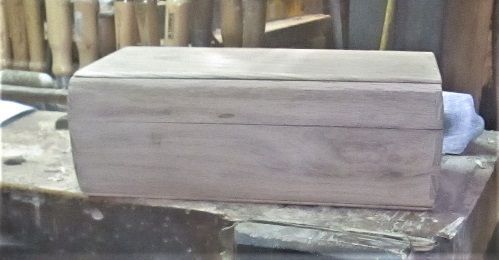

So, just after Lunch, the forest of clamps was sent away, leaving..

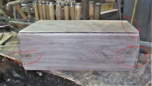

Has a few spots to clean up....planes, sanders...which took a while.:Tapping:
Still had a corner to work on...holes to fill, things like that..:rolleyes:
Next task?  A case of connect the dots..:OldManSmiley:
That is 2 lines, and they go all the way around the box...then the real "Fun" can begin...:OldManSmiley:
All 4 corners first...then connect at the ends of the box.   Then..:ChinScratch:
Connect the end cuts...which leaves this...:TwoThumbsUp:
Then a Millers Falls No. 9 smooth plane can do a bit more work..:SaluteandRun:
Leveling the sides, taking out any high spots...and, checking as I went along:ChinScratch:
Just a small spot at the left corner....Grain is supposed to line up.B)

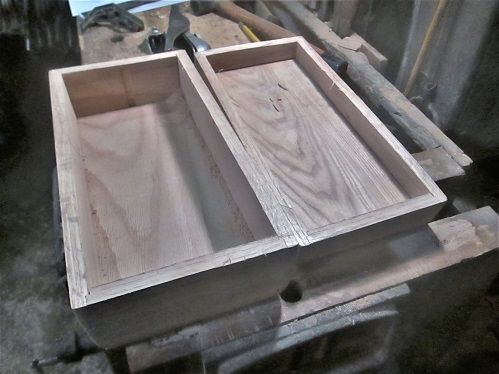

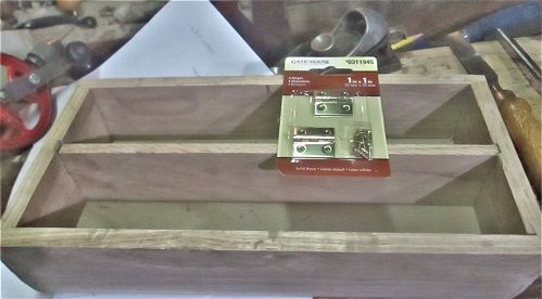

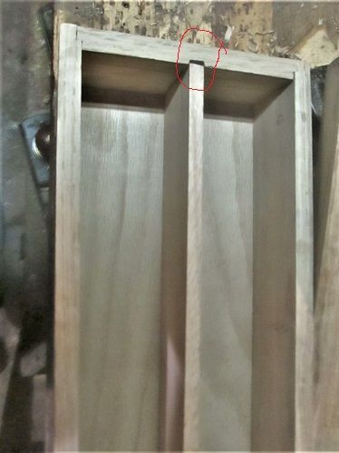

Divider installed after the stopped dados are opened up..already done..
Hinges installed....have to go and buy some hinges, this morning...
Feet made and installed...and
Carve a Finger Lift notch in the front of the box....we'll see.
And there he stopped....was waiting on the glued up/on feet to dry....
Waiting for the Fliver to warm up...it being just 1 above zero outside.   Might get to the shop after Lunch?  Too bloody COLD outside for me nose, 6 weeks til Spring?   Can hardly wait....

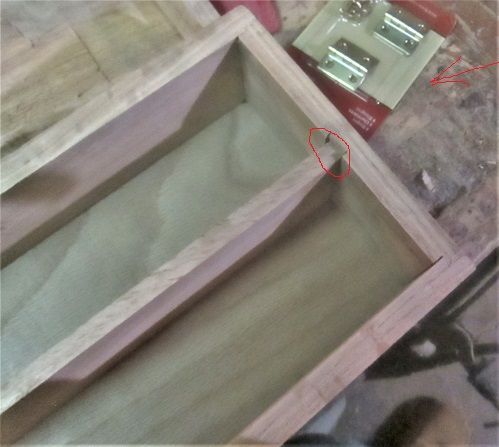

Ok..Dado has already been cleaned out...
Yes, a little loose, by design, as the divider is meant to be removable..:OldManSmiley:

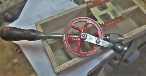

And, discovered I did not have the right hinges in my spares box...so..:SaluteandRun:
I came home with these, from Lowes.   Along with a can..:rolleyes:
As I am going to give this a try.  :ChinScratch:

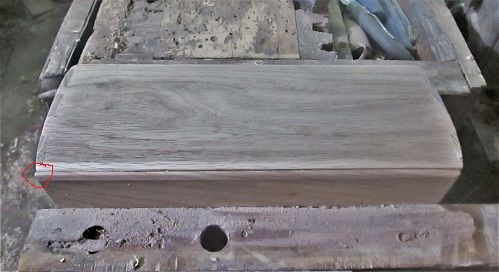

Had some high spots to level out..before the hinges can go on....had one last spot to plane..lid flipped over, and onto the floor..with predictable results.:ArguingSmileys:
More glue, couple of clamps with an assist from the bench vise...even had to square it back up...:ArguingSmileys:

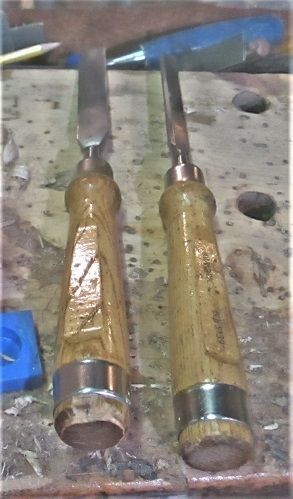

So, now it sits on the bench, waiting on the glue to dry...took out my frustrations on those two chisels..:MachineGun:
They are now very sharp....ready to make some hinge mortises,,,,when the lid is ready...I also dug out the Cordless Pilot Hole Drill...:OldManSmiley:
