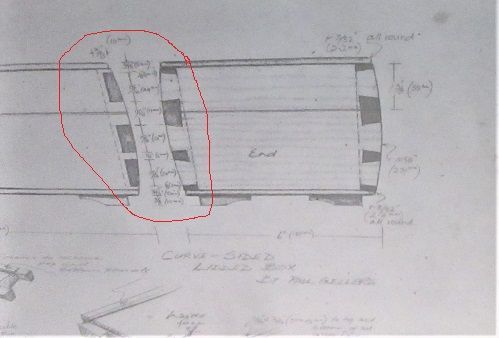

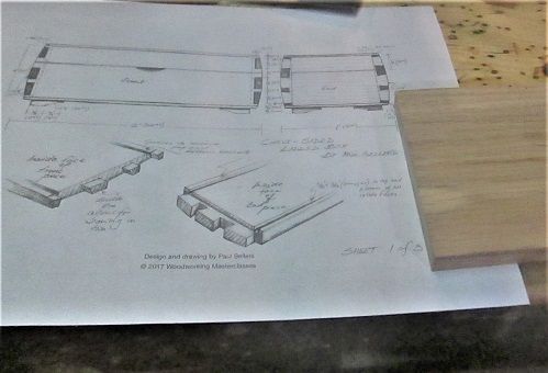

Downloaded the plan for a Keepsake Box with curved sidesB)
So, I'll give him the credit for the design. :OldManSmiley:  I'll have a few small details that will be a bit different.  Cutting list as provided..:ChinScratch:

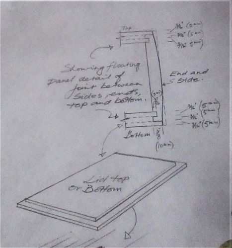

Applied feet (to make)Lid gets sawn free of the box, note the cut line.   Bottom and the panel for the lid are to look like they are floating, but..:ChinScratch:
They sit in a narrow groove..3/16" at that...we'll see how that works in 1/2" thick stock....he uses a plough plane even on the end grain.  :OldManSmiley:
He also cuts a stopped dado for that divider to sit in.   There is a carved, curved finger grip for me to gouge out(up):ROFL:

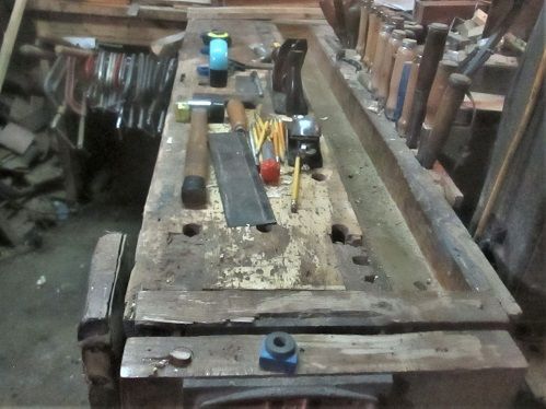

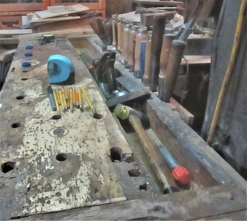

Had to clear off the messy bench, first...:OldManSmiley:
Put half of this mess away, which left...
The Tool Tray to scrub out..:JawDrop:
Not a whole lot of space, is there?:BugEyeSmiley:
Put the 2 longest pencils and that black Sharpie in the well....sharpener  and the rest of the pencils headed to a toolbox drawer. Had to make a landing zone clear...:SaluteandRun:

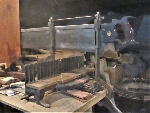

To cut a few parts to length....

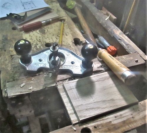

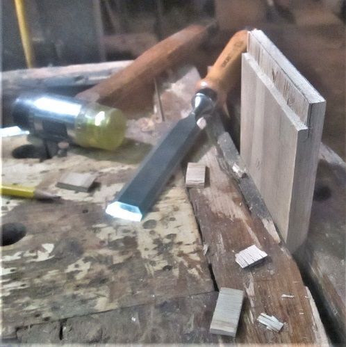

A sharp, wide chisel, and a rap or two...pops the waste rip off....tried to stay away from the lines..we have other ways..:OldManSmiley:
Called a router plane.  Set the depth of cut to 3/16" deep, and peel away the waste..working from both edges in.  Repeat 3 times....:Cheer:

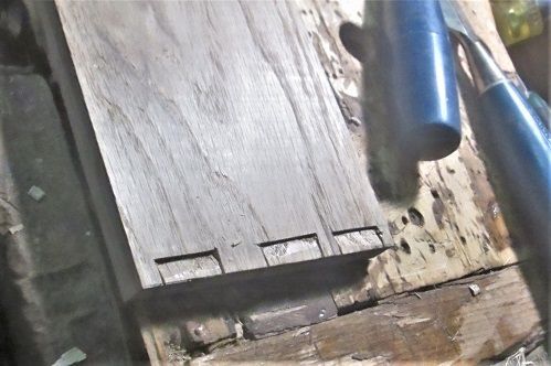

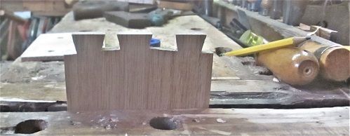

Then tick off the measurements for the spacing of the tails.   Yep, gonna try Tails first...:JawDrop:
Laid out the saw cuts. Saw the lines.  Base lines are at an angle, so the middle saw cuts are stopped at that line...then just chisel out the waste
Hand saw to remove the little corner scrap..:OldManSmiley:
Then repeat 3 times..:ChinScratch:

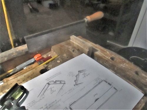

I kept the plan page right where I could follow it, and check each step

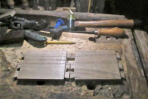

Seemed easy enough, just hold the tails on the end of a side, and trace around them...in theory.:WonderScratch:
Note the center 2 pins?   This should take a bit longer to do:JawDrop:

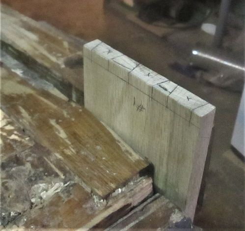

Need to learn to leave them lines.  Oh, BTW, mark all the boards as to inside,top and bottom...and as each corner gets done, number them..:OldManSmiley:

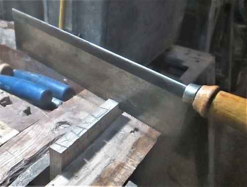

Hold the saw as vertically as you can...and leave the lines...you want to cut on the waste side..then get a chisel ready..:Cheer:
This is made by Witherby...Torrington area.  Chop a bit on the show side..:OldManSmiley:
then flip over and get rid of the rest.   Now, about those 2 center pins....stand the board up in the vise, and pare away the waste..then a dry fit..:ChinScratch:
Got a bit too much line...repeat for corner #2:TwoThumbsUp:
Getting better at this...#3?:ChinScratch:

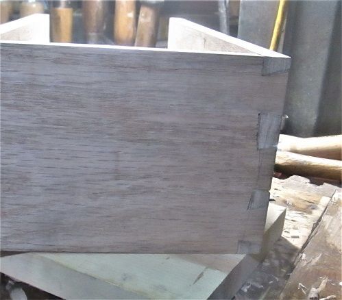

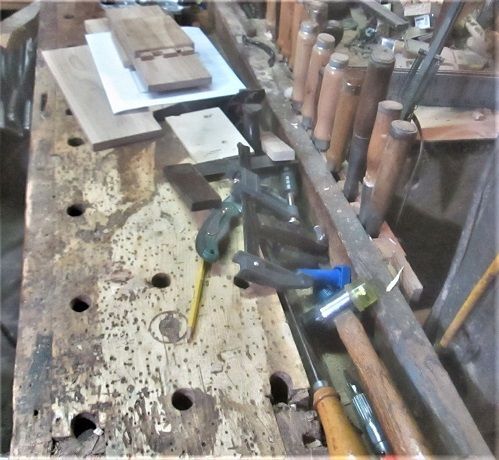

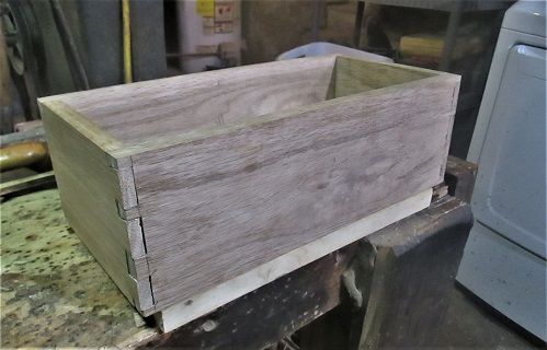

finally was able to dry fit all 4 corners..:TwoThumbsUp:
Corner #1 kind of stands out, don't it...might be a tab hiding in there.   Box was even square!:BugEyeSmiley:

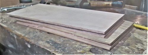

Plan calls for 5/8" thick panels for the lid, and the bottom...Found one board I could use for the lid,,,it was 7/8" thick :BangingHead:
Means I have to resaw it down to 5/8" thick...give or take a hair...:ph34r:
Underside IS a bit rough.  Did not have any more thick lumber...:BangingHead:

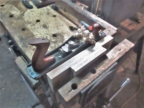

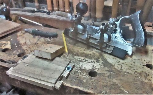

But..I do have a bit of 1/2" thick stuff I can use for the bottom panel...just have to adjust the Stanley 45 a bit. :ChinScratch:
While trying to get a quilt dry...messed around a bit, and set up the Stanley 45 with a 3/16" wide cutter.   Can't use the sliding stock.   set the fence and the depth stop....will try it Tuesday....sure there will be some :ArguingSmileys: going on.

Panels need grooves
Sides of the box need grooves.

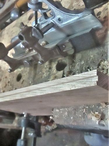

Ok...First task was to groove both panels...
WAS supposed to use the Plough plane....
No. 11 cutter, too skinny for both skates..had to use just the main skate and the fence.  Worked fine for the long grain edges...was having trouble doing the end grain....so...we have ways...
Meet the groove adjuster....cut a lot of grooves with this.  Had to also adjust a few spots, later...

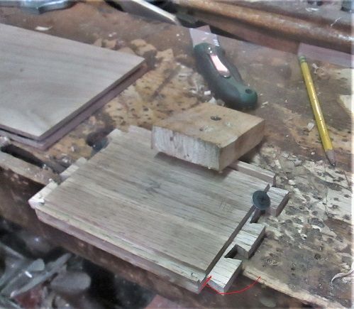

Ok, next task..groove the 4 sides of the box to house these panels.   Because the panels are NOT the same thickness, had to first do the lid's 4 grooves, then come back, reset a few things, and then do the grooves to house the bottom panel...so..
Ends first...like that jig?  Then the long sides..
1645858039_TheSellersBoxlongsidesgroovethang.JPG.3b559e10ecbcc3d4b9daebd9ba2853c8.JPG
Each time, I test fitted the panel to the grooves..had to adjust things a bit,,

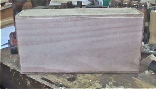

Ok..we can do that..got things to the point that a dry fit of the lid was made..
