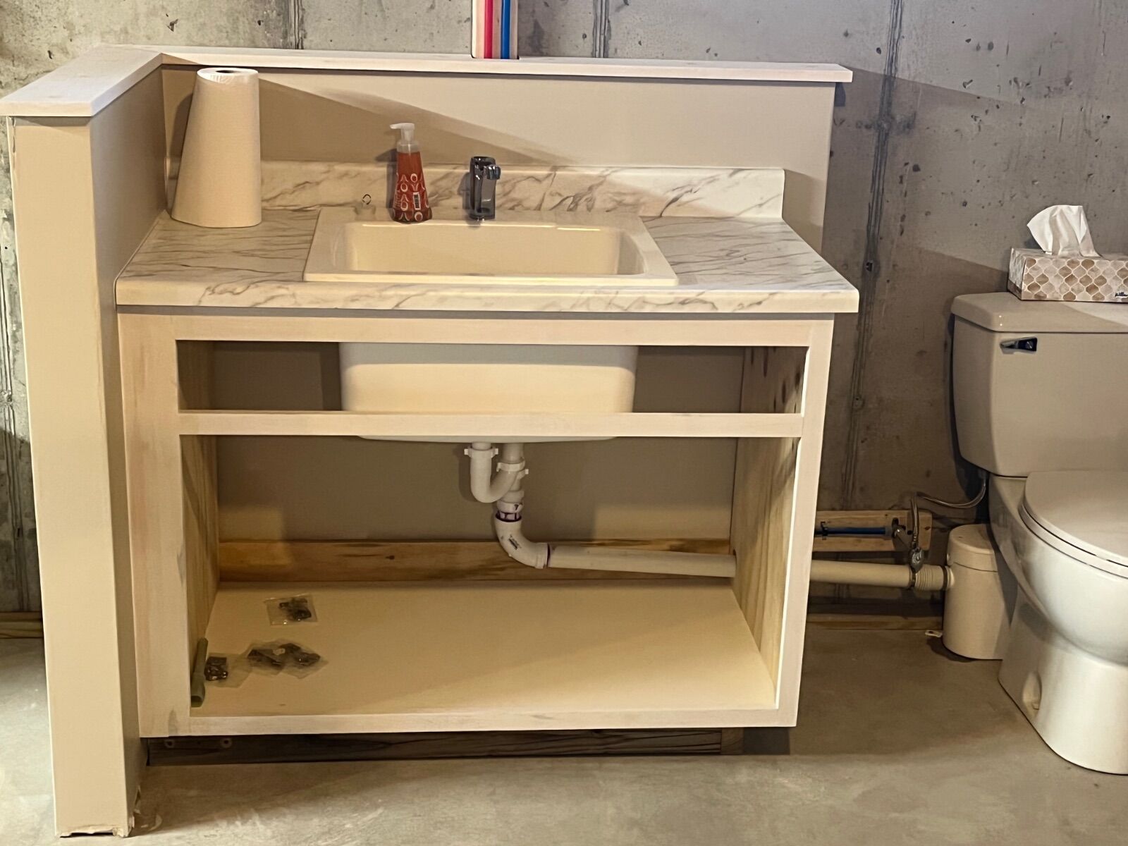

Working on a vanity and sink next to the up flush toilet. Cabinet done, sink installed and plumbed. Doors and false front next, but I may squeeze in small drawers on each side of the sink.

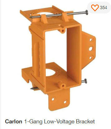

Havea 12 volt question.  If running inside the wall when I transit out what type of electrical box do I use?  Same as with 110 volt?  I currently have a portion of the wall open to run another receptacle for a light.  Since I am here figured I might as well run the 12 volt wire for the spot light as well.  I have just enough space to squeeze a 3 gang box in the wall.  One for tool receptacle, one for light receptacle and possibly if needed one for a 12 volt port.
Any ideas??

Gunny, I'm no electrician, nor plumber, but I believe the low voltage wires are usually routed to/through a "orange box" which does not have much for a back.
Danl
@Gunny...I agree with Dan. I think it might be a code violation to run low voltage with 110/220v in the same box??? Maybe @Artie& @DuckSoup can provide clarification/guidance expertise.
Didn't take that chance.  Ran 110 as normal with one receptacle for tools as I had it, and added one for lights which is switched.  I did run a wire with 3 strands inside from that area through inside of wall to just above where my 12 volt power source is located.  So wire is in place, all I lack is application for a box of some sort.

Pretty much for the low voltage you can use any enclosure. The LV ones are easy to install and cheap, but iff’n you already own regular (?/line voltage) boxes, nothing wrong with putting low voltage in them, either.
