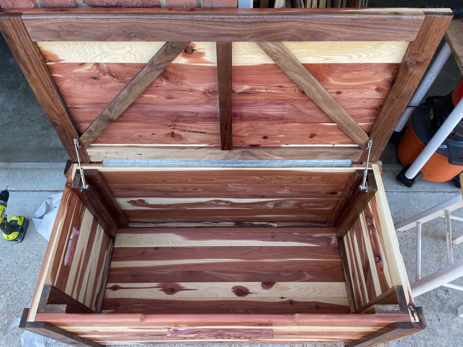

  • The bottom structure will have a lot more potential load.  Feet at each corner and a couple in the middle will distribute the stress.  Runners would do the same.  For the lid, a couple of reinforcing
  • Inner dimensions are 22x44. When the build began I was wanting it to do 15x30 but the wife said that’s to small. One thing lead to another and she said go with 22x44. Last night she said, “that box is

That's a super job Kevin.  What are the overall dimensions of it?
Thank you everyone. Weather was nice lower 50s and little wind. Made it easier to work outside. But I can’t wait for cold weather.
have a good day everyone.
Inner dimensions are 22x44. When the build began I was wanting it to do 15x30 but the wife said that’s to small. One thing lead to another and she said go with 22x44. Last night she said, “that box is huge!” I told her, “ well it can not be taken apart now” 🤷‍♂️

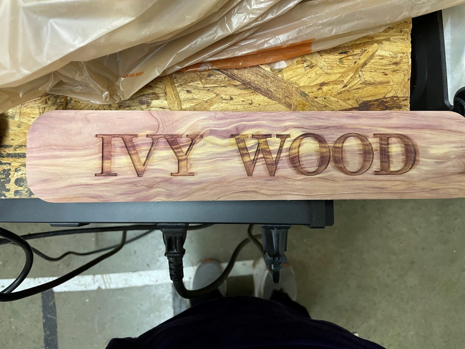

On 12/8/2021 at 5:11 AM, Gene Howe said:
Spray it with the sealer of your choice, Shellac or poly. Let it dry, then paint your color(s) on. Rattle can would be fastest but, if you want the letters different colors, you could hand paint them.
Next, sand off the over spray...the reason for the seal coat. Blow it off and hit it with the final coat(s) of finish.
Thanks Gene this tip worked great!!! I put some poly on it my wife stained the letters. A quick sanding and all done!

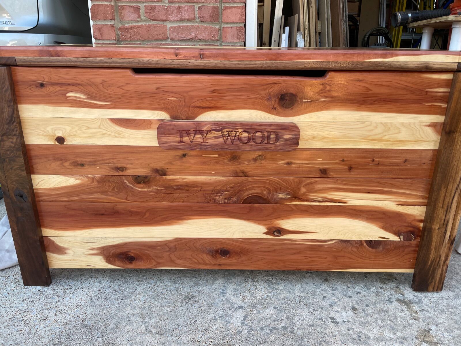

Final pictures…finished up today.
Thanks for all encouragement. I appreciate y’all
