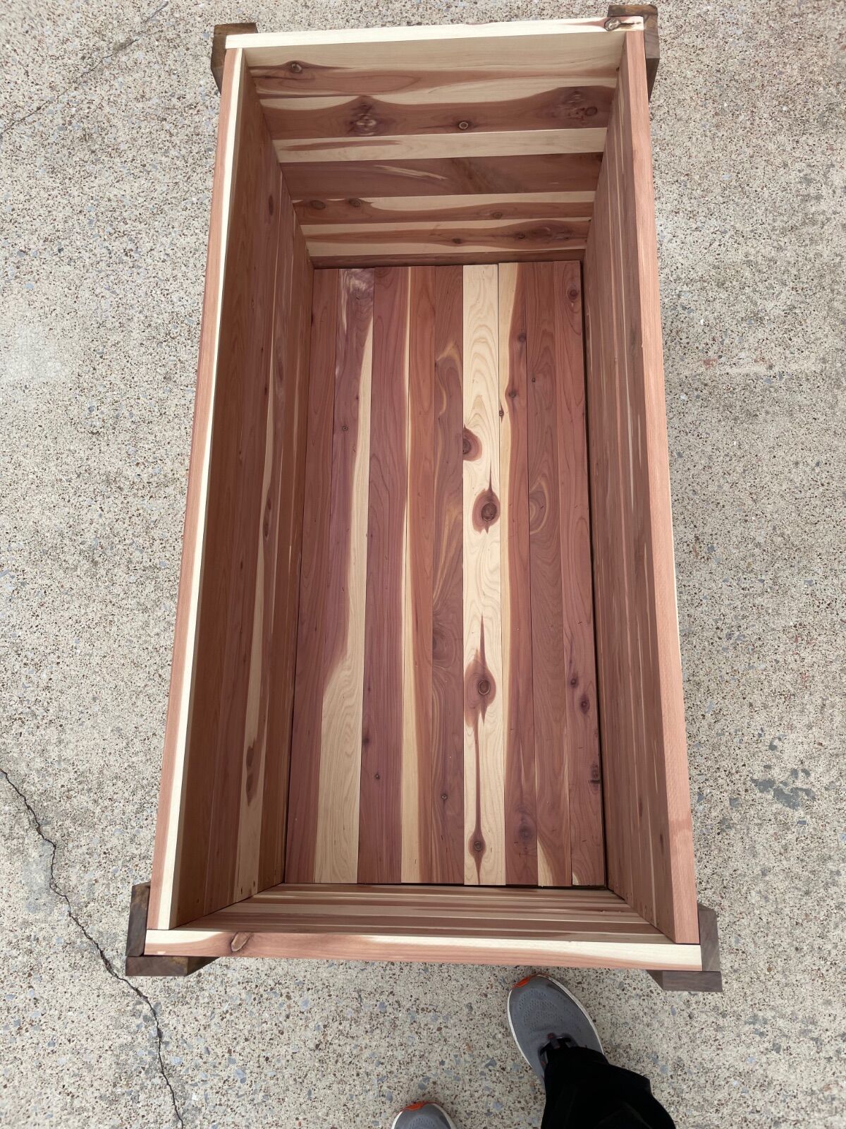

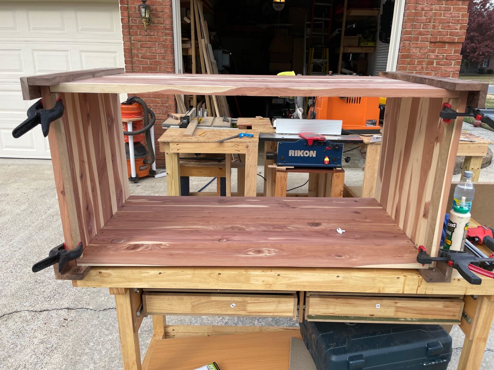

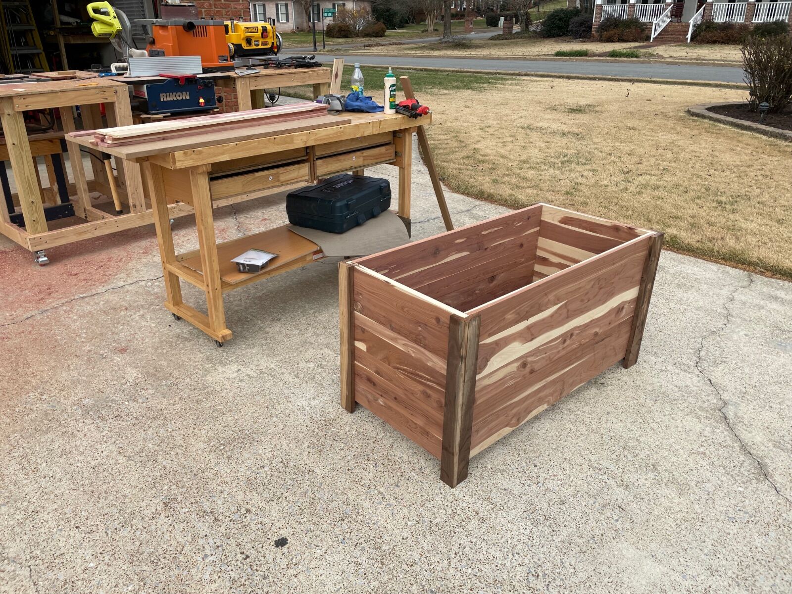

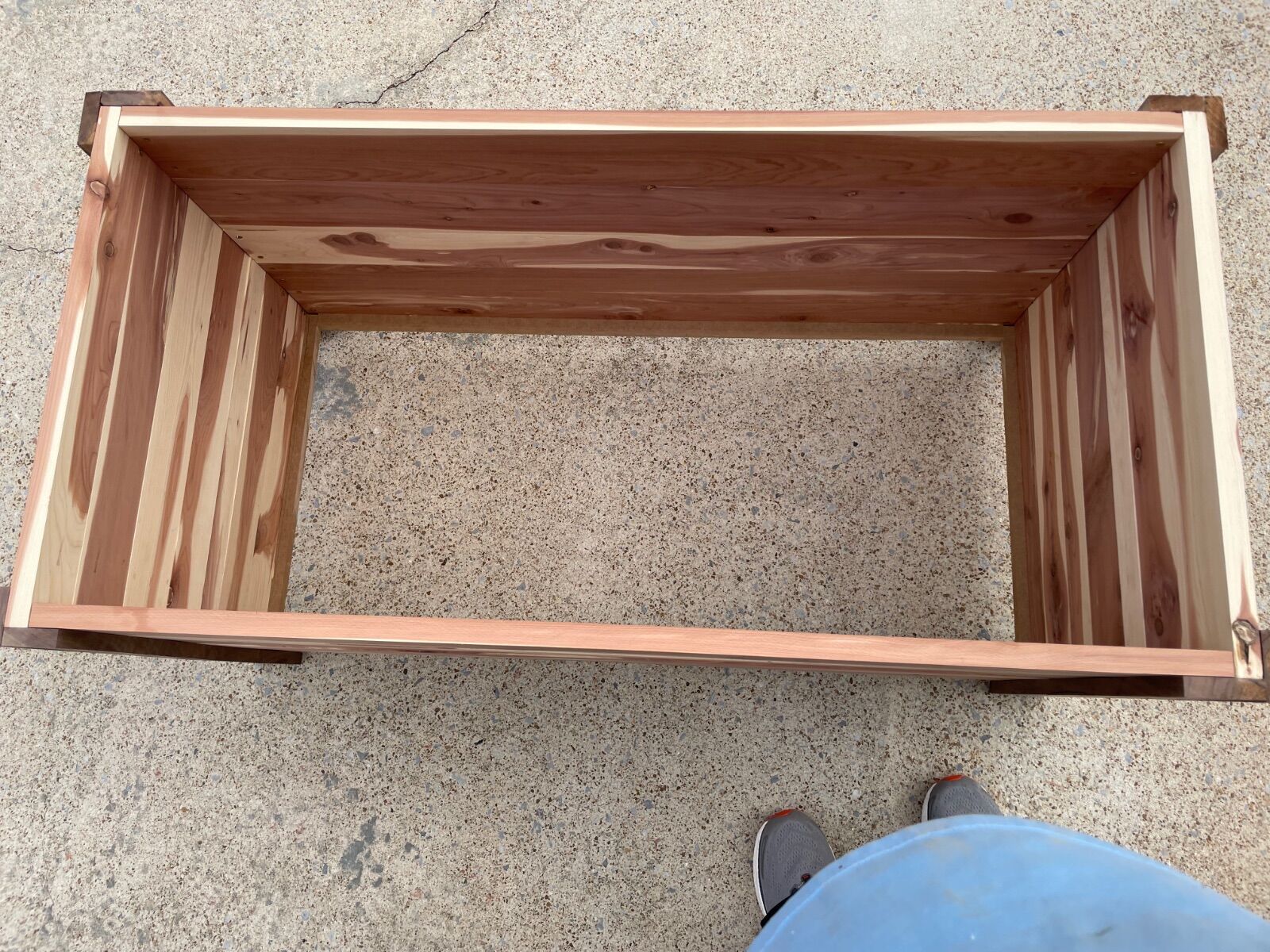

I hope everyone had a great and Blessed Thanksgiving. Here are some pictures of todays beginning of constructing a toy box for my grandson for Christmas. Not the best pics.
my question(s) are for the floor of it I am going to run Cedar from front to back. What would be the best way to re-enforce it to withstand the weight of the toys? Same thing for the lid because I am sure he will want to sit on it.  Thank you!

  • The bottom structure will have a lot more potential load.  Feet at each corner and a couple in the middle will distribute the stress.  Runners would do the same.  For the lid, a couple of reinforcing
  • Inner dimensions are 22x44. When the build began I was wanting it to do 15x30 but the wife said that’s to small. One thing lead to another and she said go with 22x44. Last night she said, “that box is

If you have the tools, maybe tongue and groove might be the way to go.
That's a great job!  I really like cedar.  I made a similar chest for my kids when they were little.  I used 3/4 ply in dado's for the bottom and then lined it with T/G cedar closet liner.  Matched the rest of the wood, but much stronger.

Can I still cut a groove with it assembled?
36 minutes ago, KevTN said:
Thanks Lew and Forty Caliber!
If it’s already assembled, you could add a cleat around the inside at the bottom and set a plywood piece on it. Then add the cedar on that
Thank you Lew
X2 @lew's suggestion

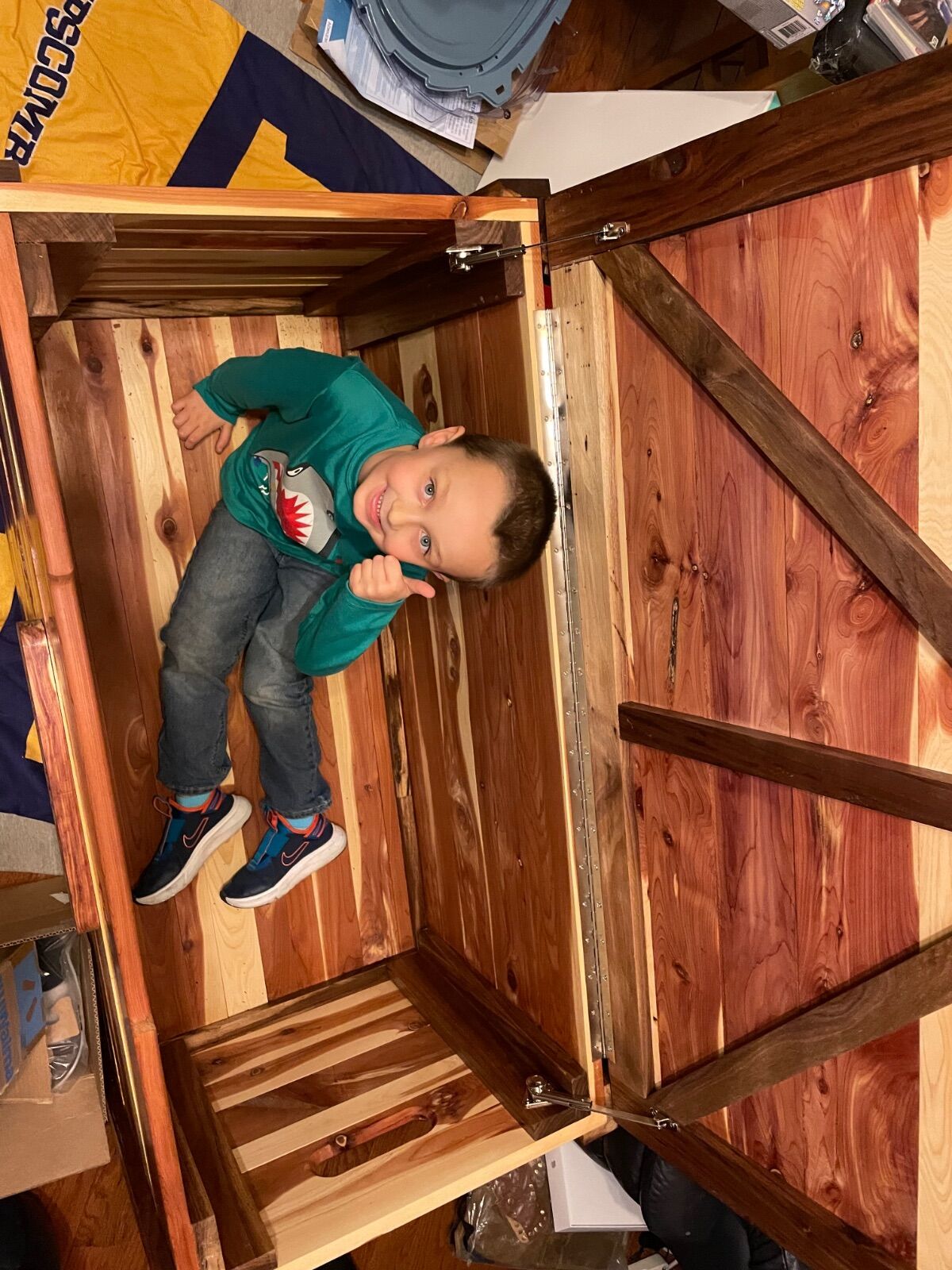

The bottom structure will have a lot more potential load.  Feet at each corner and a couple in the middle will distribute the stress.  Runners would do the same.  For the lid, a couple of reinforcing strips under the planks would also do.  Toys are not the critical design weight:  younger brothers being stuffed into the box usually represent maximum stress.
 Soft close toy box hinges keep little fingers safe.
Well no little siblings lol Thanks for the advice.

I have two boys and I guarantee you will have children inside the toy box  so prepare. I used the soft close hinges from Rockler, very strong.

Thanks Cal…I used mahogany. I will re-enforcing the inside and trimming it out with it too.

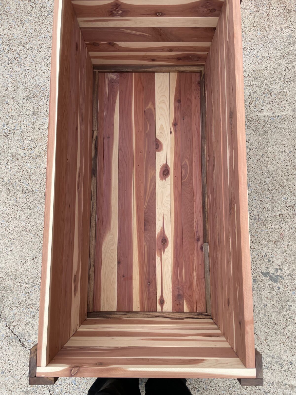

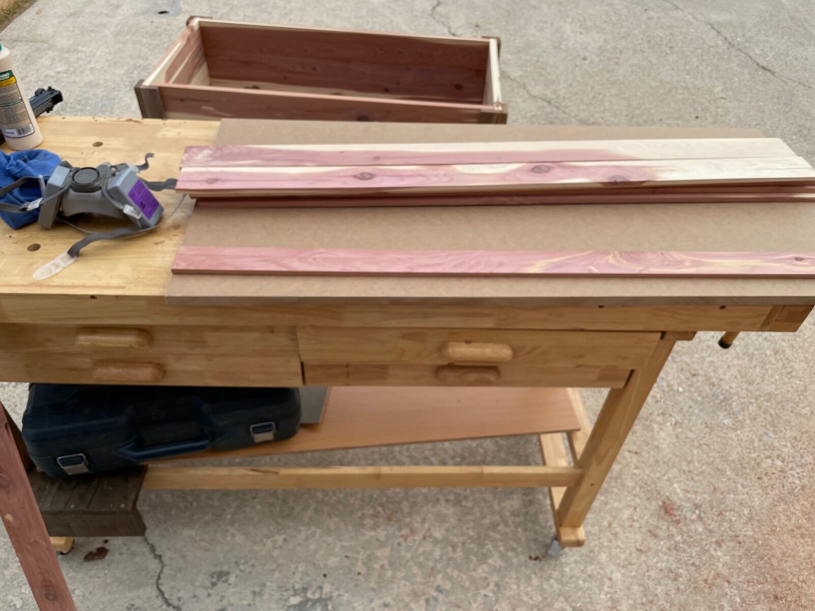

Got the bottom completed. Tomorrow if the rain holds off I will re-enforce the corners on the inside. Bottom I did 3/4 mdf cut to size. I resawed some cedar glued and brad nail them. Trimmed out with some walnut.

Looks great Kev!  With 3/4" MDF & cedar on the bottom you may have to beef up the floor wherever it ends up! :D
