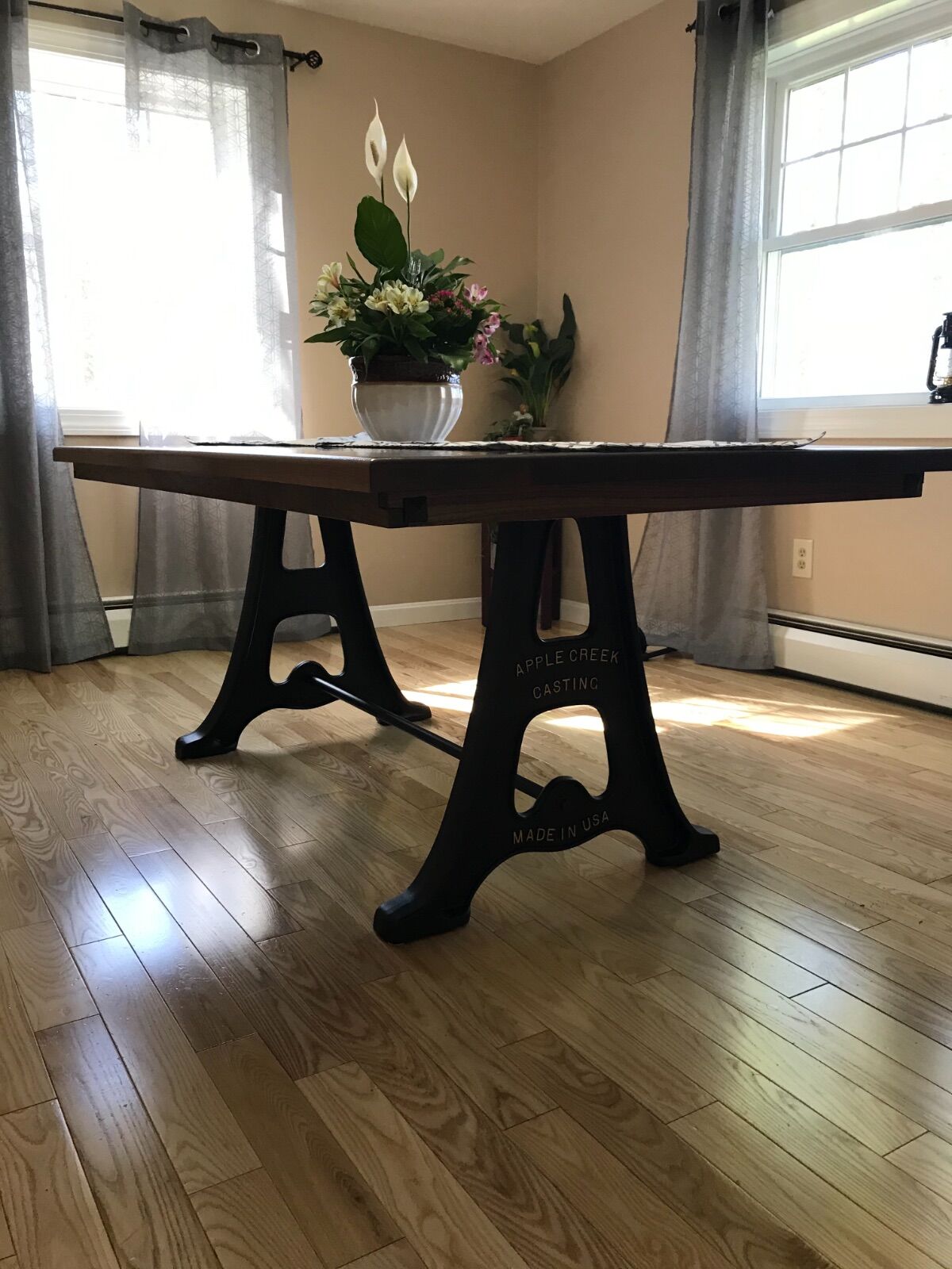

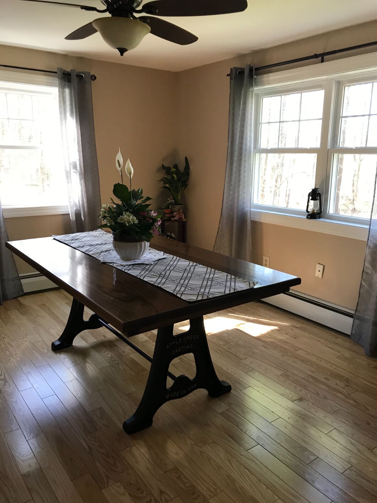

It’s finally finished.  First, thank you all for you comments and advise on putting the skirt on the table.  I did put on on and it makes a world of difference.  The table is 1 1/4 inch thick walnut.  It measures 42wide and 72 long.  It has 9 coats of General Finishes. Ar-R-Seal. (that stuff is beyond awesome!). The legs came from Bear Hollow Supply.  They make the legs right there.  My wife is beyond thrilled with this….happy wife, happy life, as they say.  Anyhow here is the finished product.
I should mention, this is my very first large table.
That is a beautiful table.
That's gorgeous.
Thank you, Gunny.
19 minutes ago, HandyDan said:
That's gorgeous.
Thanks HandyDan
Great job!  I'm glad you added the aprons.  It would have looked naked without them!
.40
.40
I’m very happy that I added the apron.  It made a huge difference.  Thank you.

 Gorgeous table, gorgeous finish! I'm impressed!!
47 minutes ago, lew said:
Awesome! It's just perfect!
Thanks Lew.  We are very happy with the way it came out.
Thank you very much.
Tres magnifique!
3 hours ago, Artie said:
Tres magnifique!
You speak French! Once again, I'm impressed!
