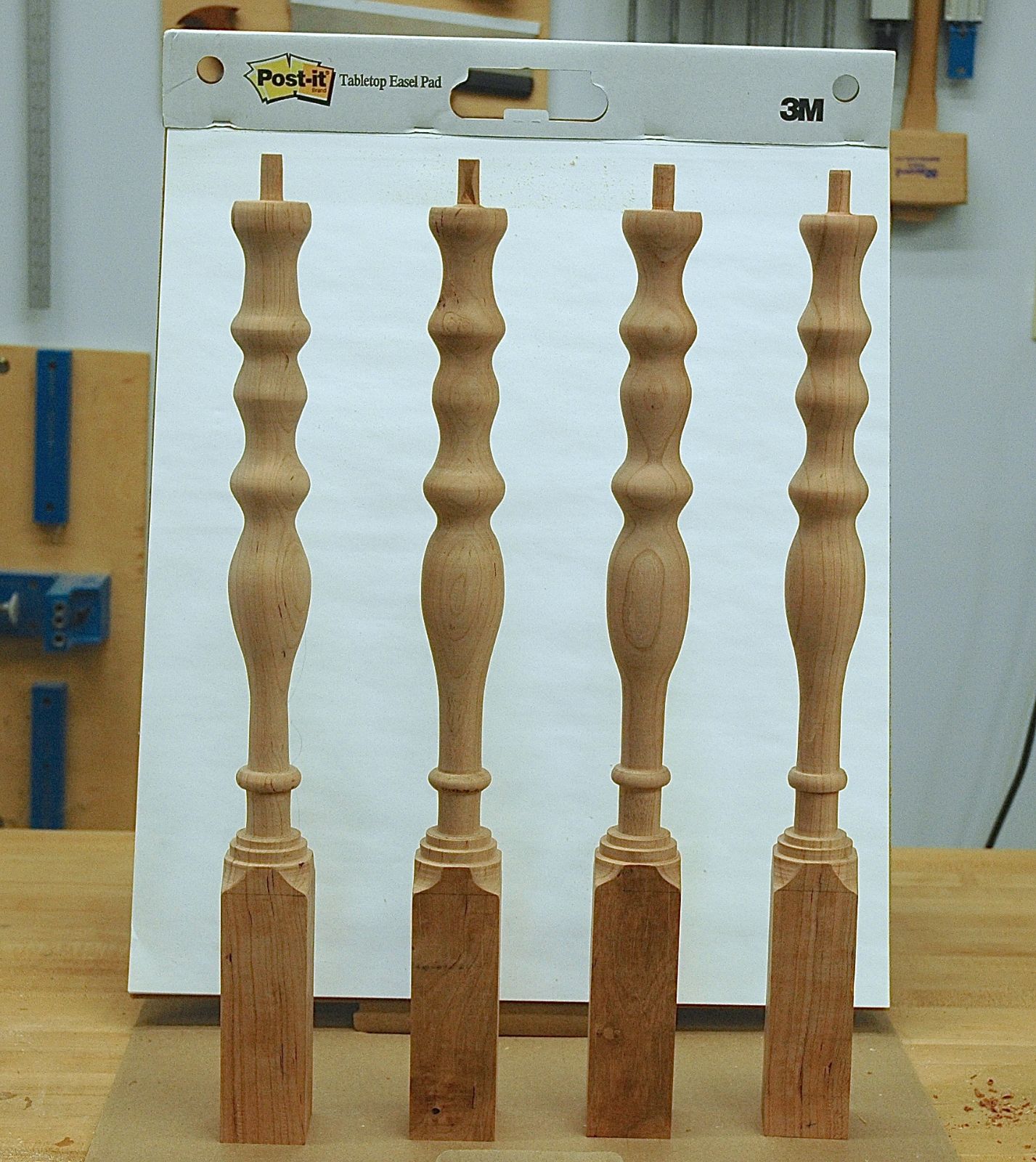

Popular Post Fred W. Hargis Jr Posted February 20, 2021 Popular Post Report Posted February 20, 2021 (edited) You folks know I'm not turner. I used to be a "wannabe turner", and anymore I'm not even sure I'm that. Anyway, I have a lathe and the basic tools which I bought to help with my flatwork projects. But after 7 years or so, I haven't even done that. So I decided it's time. I'm trying to turn legs for a William and Mary table I saw somewhere, but the article was one of those that asks you to dig out an issue from 3 years ago to get the details on turning the legs. I don't have that issue so decided to tackle it on my own. I made a drawing (actual size) and made 2 blanks out of poplar to tune my technique. At the risk of being laughed off the forum, I present the first one below; judging from my results I should have made 7-8 practice blanks. Of course there's the little matter of my measurements (on the leg) being off quite a bit...but my technique for turning a round spot on the leg most definitely needs, well, refining. Here's the leg laying on my drawing....go ahead, laugh your arse off. With my DC down I can't do much of anything else. Edited February 20, 2021 by Fred W. Hargis Jr lew, DuckSoup, Cal and 5 others 8 Quote
HandyDan Posted February 20, 2021 Report Posted February 20, 2021 Not bad Fred, that looks fine. The last one is always the best one in my experience. Work at keeping the lineal measurements close and the shapes seem to blend in with each other and can be off some. No one will look that close or has the trained eye to tell the difference. FlGatorwood, lew, DuckSoup and 1 other 4 Quote
Popular Post Gerald Posted February 20, 2021 Popular Post Report Posted February 20, 2021 Looks like your measurements at transitions are good . You need to work on that egg shaped area and bringing it higher with more fullness. Cut to the maximum diameter and mark center with a line. Do not cut that line out just round down from both sides. lew, Cal, HandyDan and 3 others 6 Quote
Popular Post Gerald Posted February 20, 2021 Popular Post Report Posted February 20, 2021 Watch this video . Sam will give you some good instructions. You can practice spindle turning with 2 x 4. lew, HandyDan, steamshovel and 4 others 7 Quote
Popular Post Steve Krumanaker Posted February 20, 2021 Popular Post Report Posted February 20, 2021 Every turner starts exactly the same way. Good advice from Dan and Gerald already. I always use a pair of calipers to set diameters and then turn to those landmarks. Sometimes it works well and sometimes not. The lathe is all about technique and your technique will only improve with practice. DuckSoup, lew, Gunny and 3 others 6 Quote
Popular Post Gunny Posted February 20, 2021 Popular Post Report Posted February 20, 2021 Fred that ain't bad. Sure maybe not super smooth and all detailed but for years without doing much pretty good. +1 on some practice on a 2x4. My son tried his first attempts this way. Then got pretty good and bought some mahogany to play with. DuckSoup, lew, HandyDan and 3 others 6 Quote
Popular Post lew Posted February 21, 2021 Popular Post Report Posted February 21, 2021 Well, I think you done good. Along with a full sized drawing, a story stick can be helpful in locating the transition points HandyDan, FlGatorwood, Cal and 3 others 6 Quote
Popular Post Masonsailor Posted February 21, 2021 Popular Post Report Posted February 21, 2021 I use the full size template and calipers method. Once you have the first one just pick the critical points and use a parting tool to set the diameters using the template as a guide and then turn between those points. That’s a really good first try Fred. Cal, Larry Buskirk, HandyDan and 2 others 5 Quote
Popular Post Fred W. Hargis Jr Posted February 21, 2021 Author Popular Post Report Posted February 21, 2021 Yep, before I try the next one I'll have a story stick and I picked up a couple of tips from Gerald's video to try as well. I need to get my DC back on line sinc3e it looks like I'll be making some more poplar practice legs ( maybe I'll try some made of SYP). Gunny, FlGatorwood, lew and 3 others 6 Quote
Popular Post AndrewB Posted February 21, 2021 Popular Post Report Posted February 21, 2021 It doesn't look exactly like this specification drawing but I like the shape of it. I think if and when it comes time to turn my first stool I may try something similar. Cal, Larry Buskirk, HandyDan and 2 others 5 Quote
Popular Post Fred W. Hargis Jr Posted February 24, 2021 Author Popular Post Report Posted February 24, 2021 It took me a while to get back to this, but I've completed my second try. I used a story stick and a couple of tips from the link Gerald provided and think I got a lot better result, but I've got a long way to go. I'm making 4 more billets to keep trying...maybe I'll get it, maybe not. Anyway, I also refined the design slightly to make thing a little easier and the top leg is my second attempt. At least this times the measurements are correct on the spacing of the details. The top one is the latest, bottom one the first attempt. Artie, DuckSoup, HandyDan and 8 others 11 Quote

Popular Post lew Posted February 24, 2021 Popular Post Report Posted February 24, 2021 WOW! You done good on that one!. One of the nice things about legs and such are that they are usually not very close together, when in use. Slight differences between them aren't really noticeable when they are installed. I've made several of these over the years and am proud to say that absolutely none of the spindles are identical! p_toad, Gerald, FlGatorwood and 6 others 9 Quote

Popular Post Gunny Posted February 24, 2021 Popular Post Report Posted February 24, 2021 Most people just see the entire build for what it is, handcrafted. Of course we are our own worst critics. Cal, lew, Artie and 4 others 7 Quote
