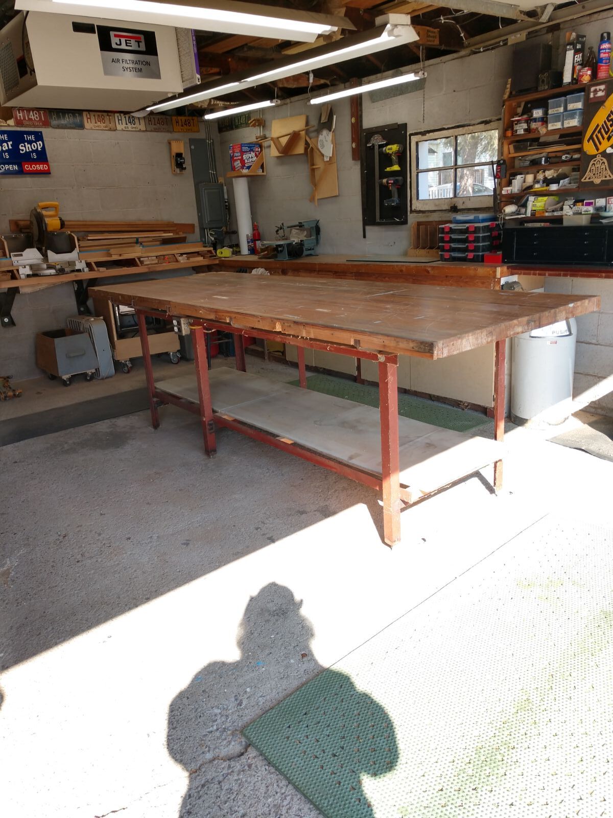

 I have spent some time this year reworking my shop arrangement. Started with a 60 amp service & this allowed me to move the compressor into an attached shed then hard piped it into the shop. Install a small dust system in the shed and connected my miter saw, belt/spindle sander & a port for my ROS. I passed on things to other people that could use them & got rid of things I haven't or won't need. Consolidated everything to the 3 walls in the shop.
 I realized during the process that walking around my work bench to get to the other side of the shop just wasn't working anymore, time to downsize & go mobile.xz4.jpg.1243c4d499eefb5d3aa3e3b0c3b05187.jpg

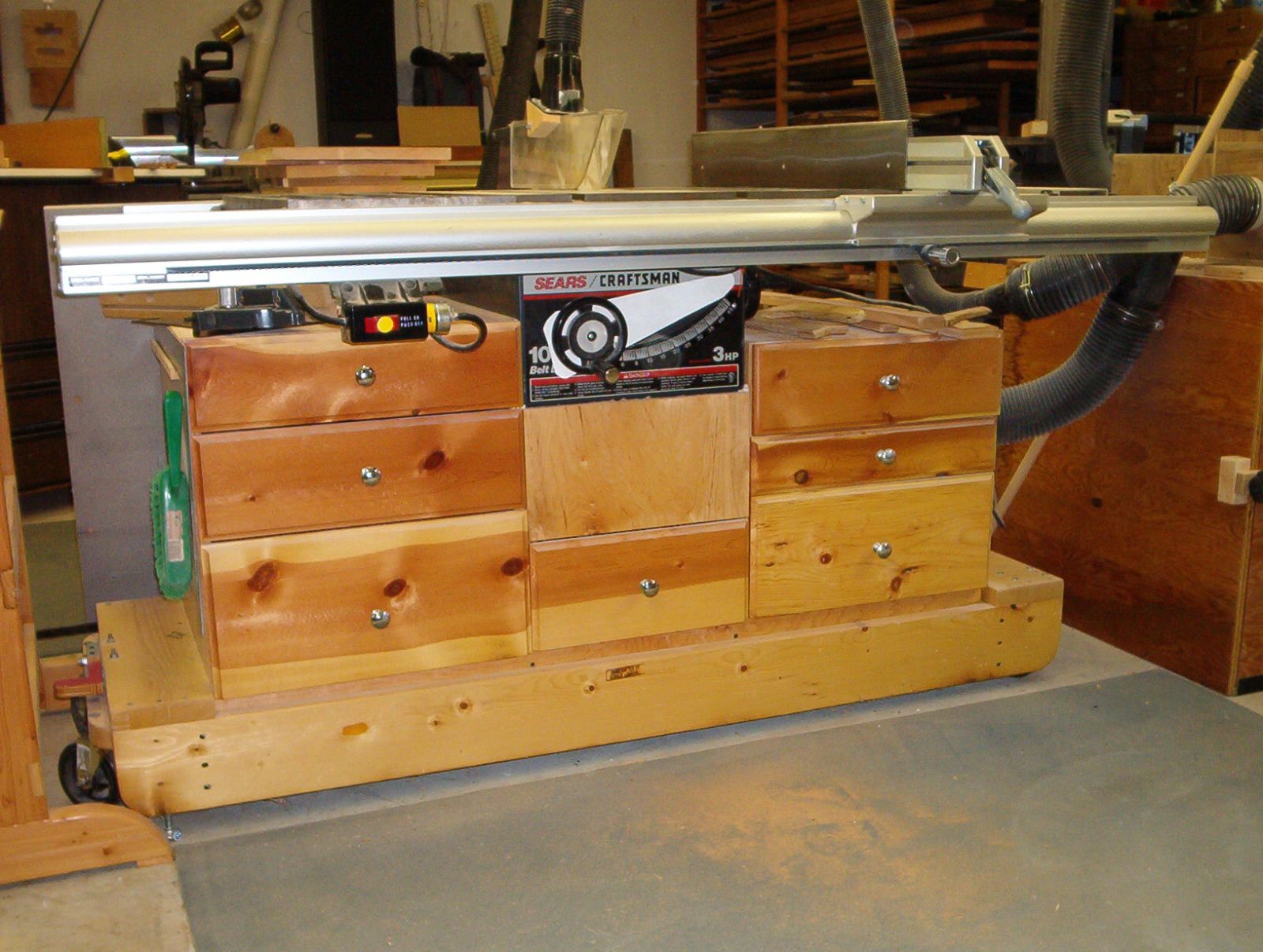

I used 2x6 for my mobile TS stand . That way the cabinet fits lower into the stand and made it lighter. For my sanding and planer station I used angle as the connector between ends.191274238_craftsmants.jpg.cccbac2b9ba58f2f64e364458d7554d4.jpg1614827974_sandingctr(medium).jpg.075108a6139593a5bf4dfc17303845d0.jpg
 @Gerald what brand of fence do you have on the table saw?
That is one made by Craftsman. All aluminum and was difficult to get set perfect but was smooth operating.

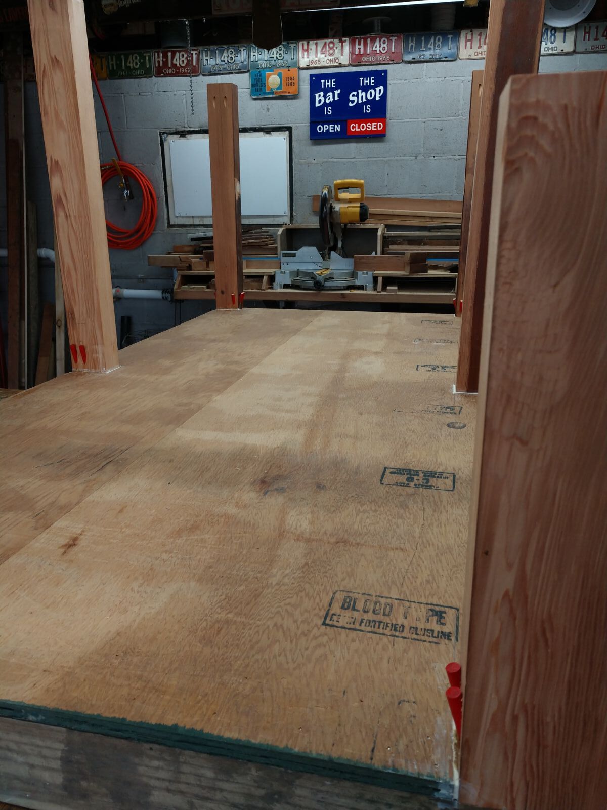

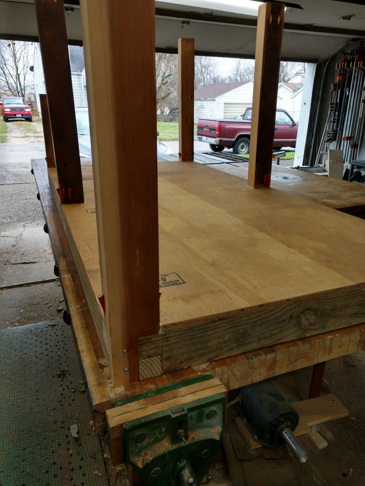

 Have the uprights in place & the bottom glued and nailed.
w8.jpg.512fafb26d39f726a85f77a81a276663.jpg   w11.jpg.66bb25e0bf38efcb0a54e787e7a335c0.jpg
Added supports to hold the plywood base for the table saw. I still need to add supports in the middle that will allow me to bolt the saw in place.
The right side of the saw will be parallel with the center post & the top horizontal board is the back of the table. The space below the saw will hold a dust
bin & storage. The area to the right of the center post I will use as a router table as well as storage.

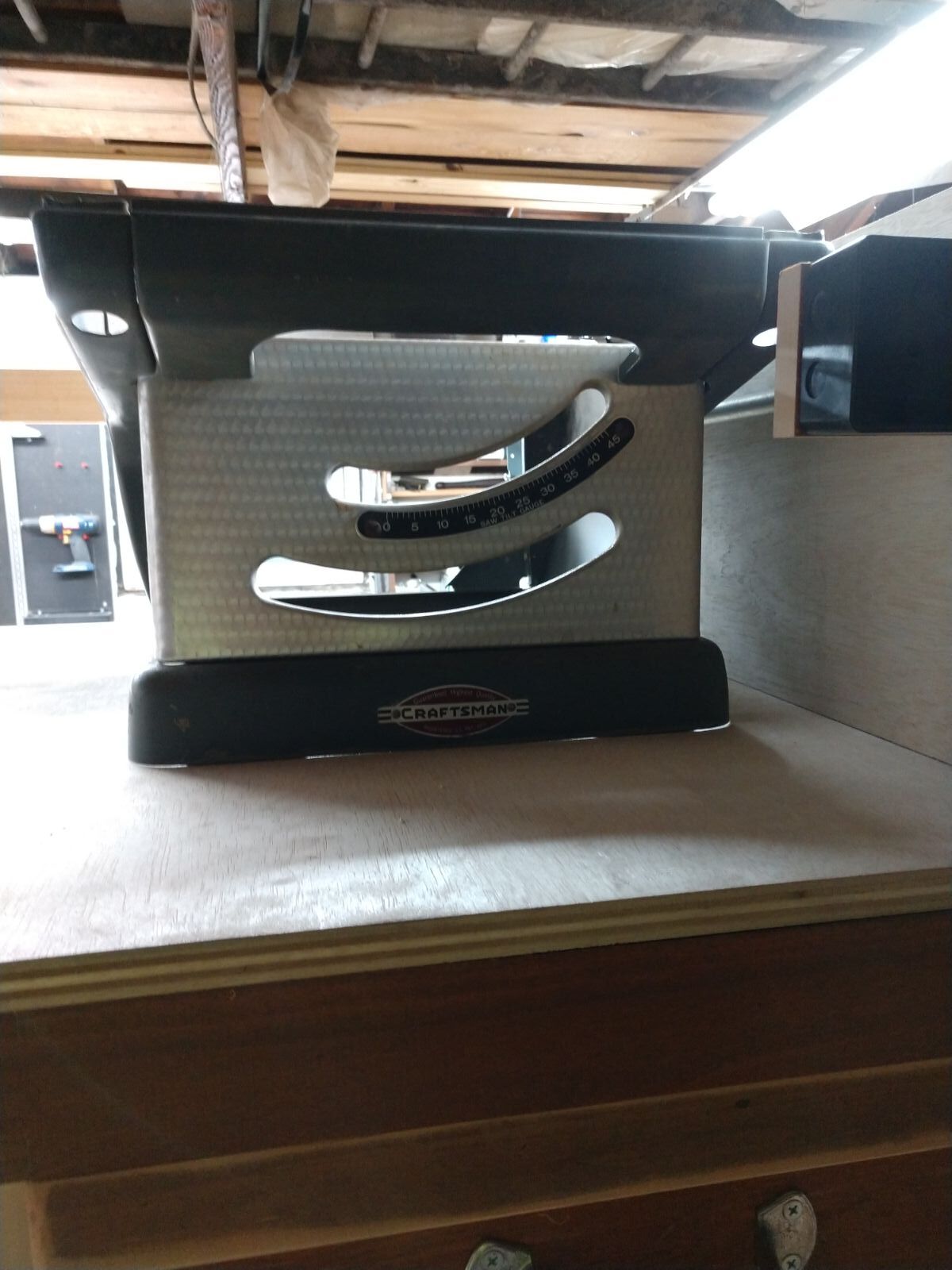

 Not a lot done but I have tops in place, switch for the table saw & dust bin in place. I plan on putting some drawers to the left of the dust bin to hold spare blades and such. I am going to relocate the 3 drawer pink cabinet to the right of the dust bin and still use it for push sticks & feather boards. I have line on a piece of counter top for the router table, maybe next week. Time to remove the table saw from its present home and break it down and give it a good cleaning & a new motor. I'll need to set the saw in place and mark mounting holes & cut out the area that will feed the dust bin.
  x3.jpg.299db2bb97ececc8cca592816bb39046.jpg    x1.jpg.2b96313f5f5880965da3683d730c3064.jpg
 Moved my table saw onto the workbench, heavy bugger, and started to break it down. Took the body off and marked & cut my hole for dust.
 x2.jpg.bdbfa877fc465b390da8eb583ccf032b.jpg    x3.jpg.491d5067d25835f56de5f2fe444e2b0e.jpg

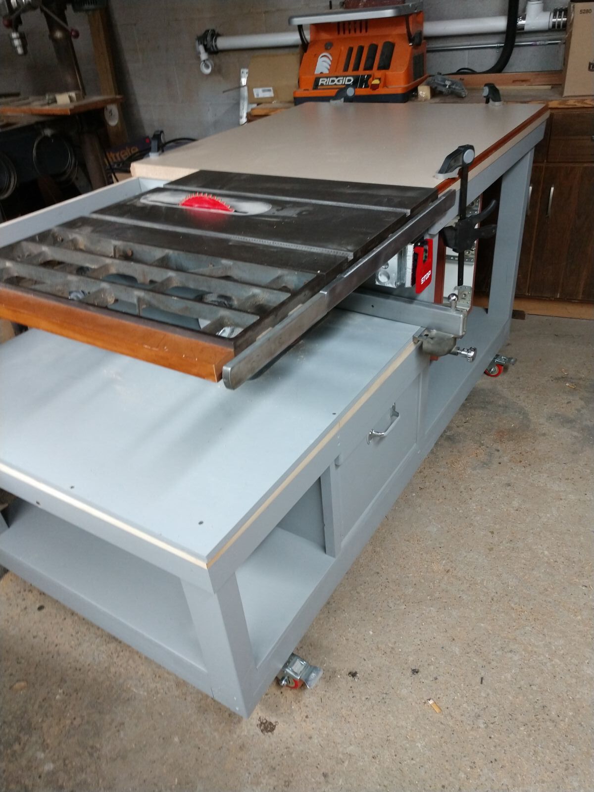

 Well with the holidays done and in between parental obligations I've spent some time on the bench.
I was able to secure an island countertop that was the perfect width and I cut the length to size. I set it in place and realized my original plan was for 3/4" top and this was 1-1/2" which is taller than I wanted to finish. Instead of raising the bridge I lowered the river. I added a 7/8" strip on the frame under the saw which brought it flush with the top. Replaced the 5" wheels with 4" and that got me where I wanted to be on height.

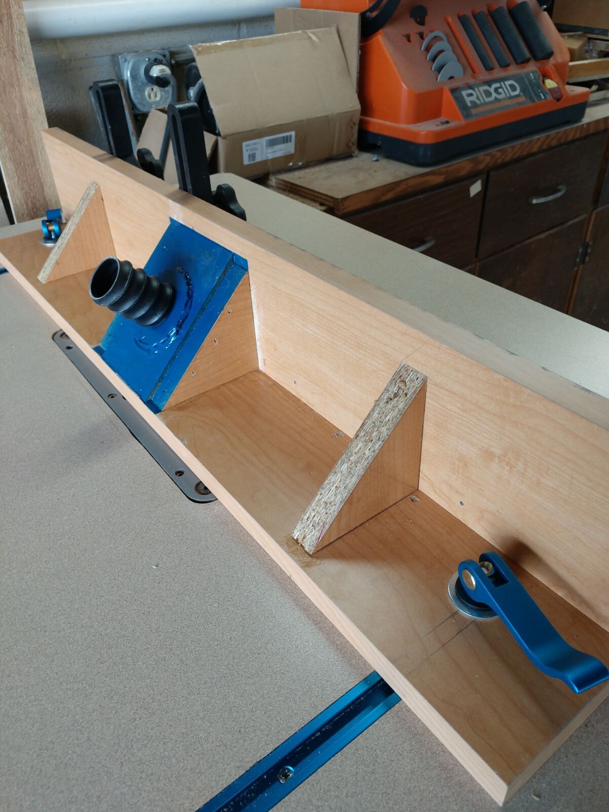

 Wire up the table to feed the saw and router, made a dust bin & bolted the saw in place. Decided to stick with the original fence. I'm installing t-track in the router top for a fence and I'll make them long enough towards the saw so I can build an auxiliary fence for the saw. This will allow me to cut over 19" which is the max. to the left now. Need to fill the gap on the outfeed side of the table. Top is set in place waiting for the router.
z10.jpg.a557daa6c0ad22a60f9cd804b9cb5d35.jpg       z11.jpg.539743594ce8b498f83e34898650cb19.jpg
