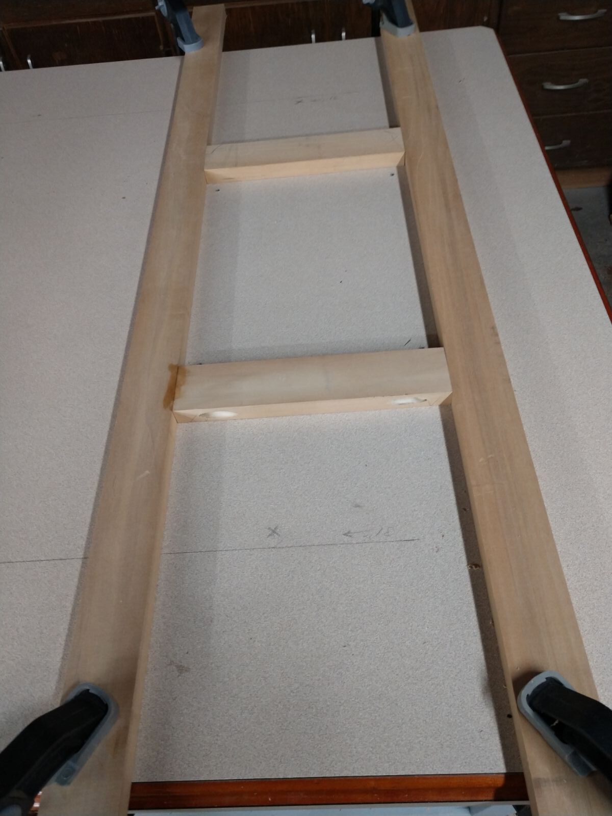

  • I used 2x6 for my mobile TS stand . That way the cabinet fits lower into the stand and made it lighter. For my sanding and planer station I used angle as the connector between ends.
  • Have the uprights in place & the bottom glued and nailed.       Added supports to hold the plywood base for the table saw. I still need to add supports in the middle that will allow

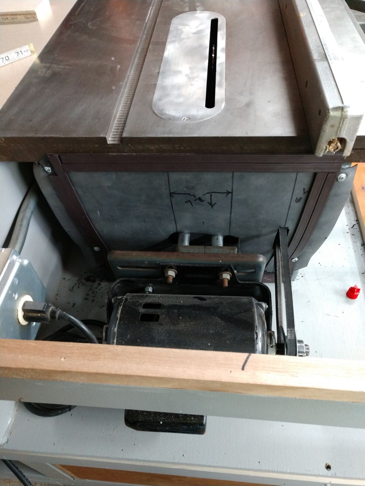

Glued some strip magnets to some rubber roofing material I had on hand & installed it on the backside of the table saw. Dust would always blow out and onto the motor. Couple of screws to help avoid anything catastrophic.

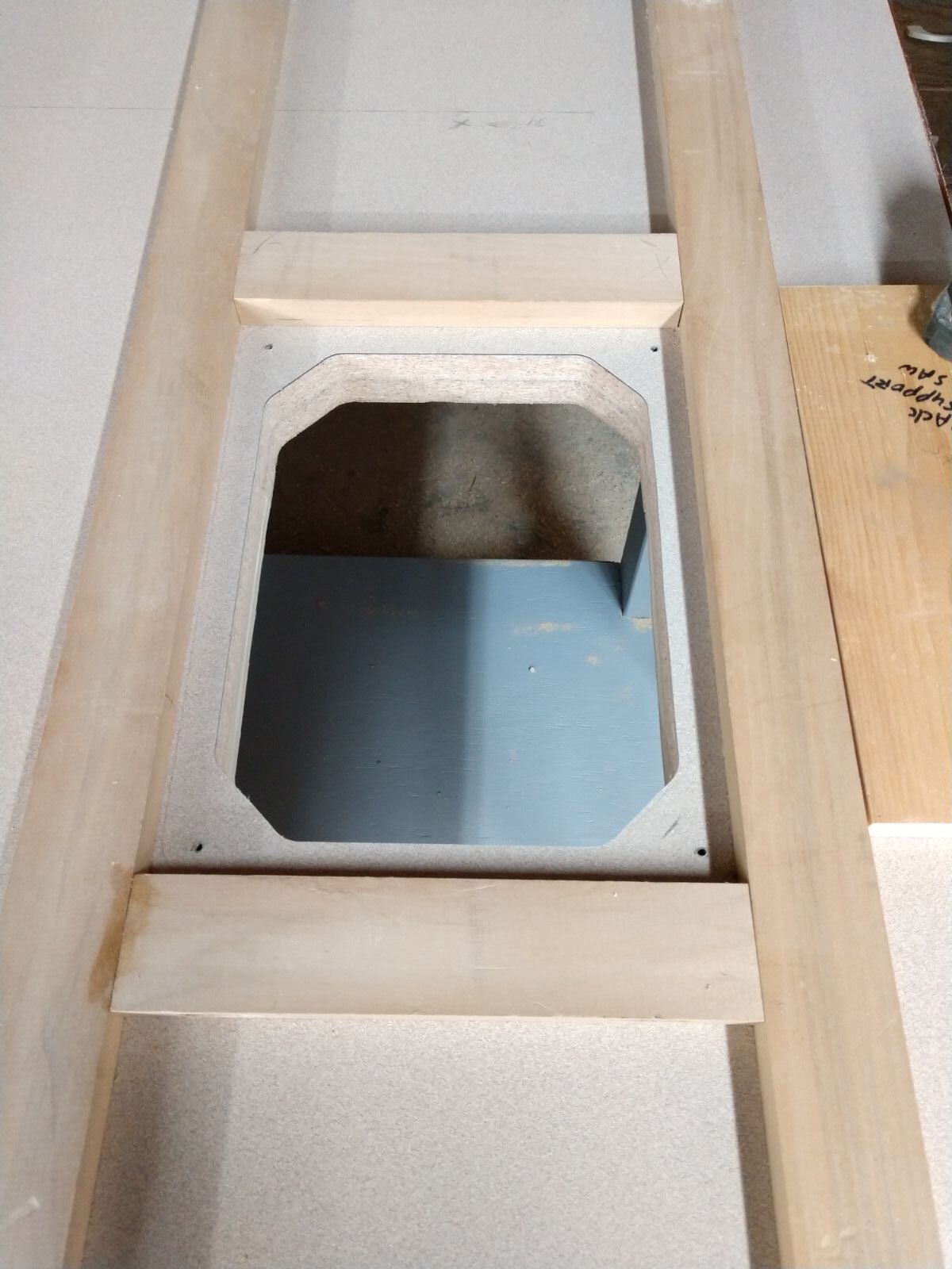

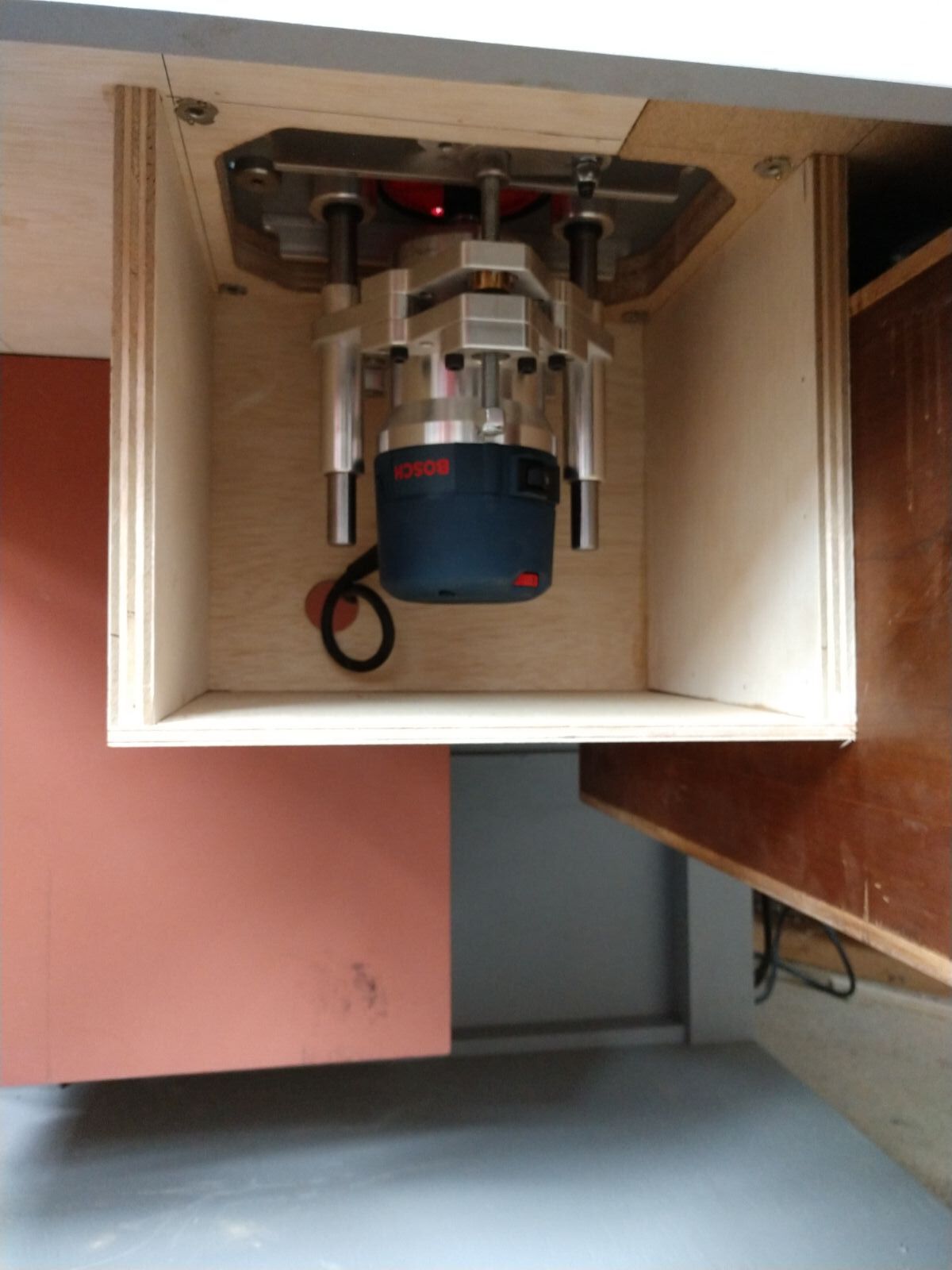

Flipped my router lift upside down and screwed it to the table, I'll drill these holes later for 1/4-20 mounting bolts. Used the base as a guide and built a frame around it to size the hole for the lift.

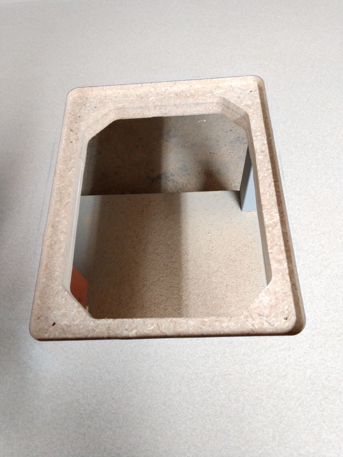

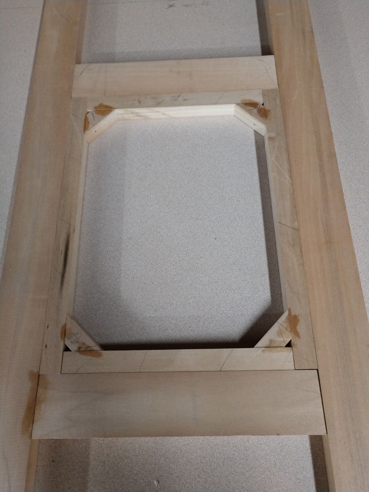

Clamped the frame in place and removed the lift. I then built an insert with 3/4" material and this would leave me with a 3/4" lip for the lift to mount to. I put 45 degree angles to leave myself more room for the mounting bolts. This also gives me the opening size in the top.

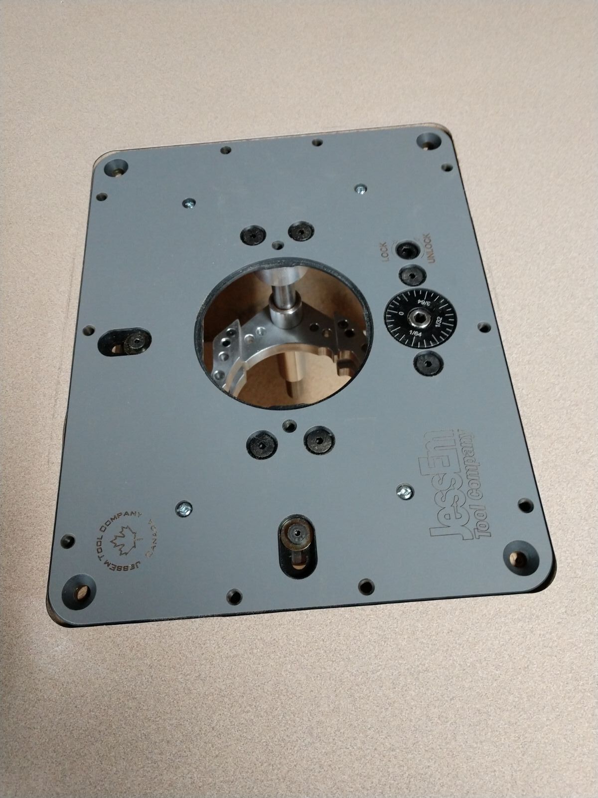

I drilled some holes and removed most of the material with a sawzall. Used a pattern bit and followed the insert. I removed the insert and with the same bit worked my way down to the thickness of the lift.
Rubbed some paste wax on the particle board and drop in the lift. I still need to rout a couple of grooves for t-track for the fence. I'll put some t-nuts under the table for mounting. It's getting there.

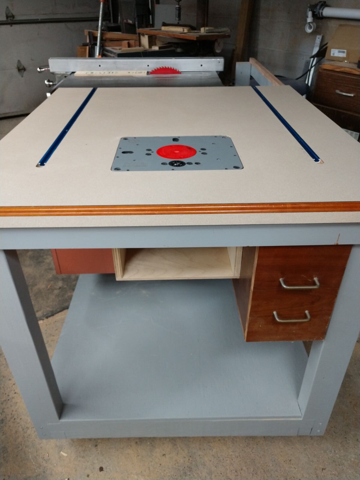

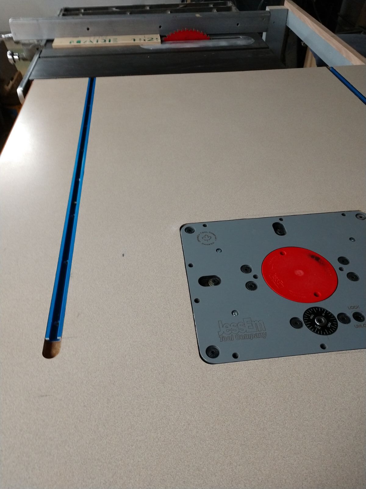

 Yesterday cut some slots for t-rail, these are 31" and I can use them for both the router & saw with aux. fences I plan to make down the road. Mounted the top flush with the front of the saw, maybe a Biesemeyer fence in the future, but I can cut to the right of the blade 38" with this set up. I have the router lift bolted in place with the router, I just need to adjust the leveling screws. Relocate the router bit drawers from the stationary table. Start/stop switch is around the corner to the right, I can just reach over the right edge to hit that.

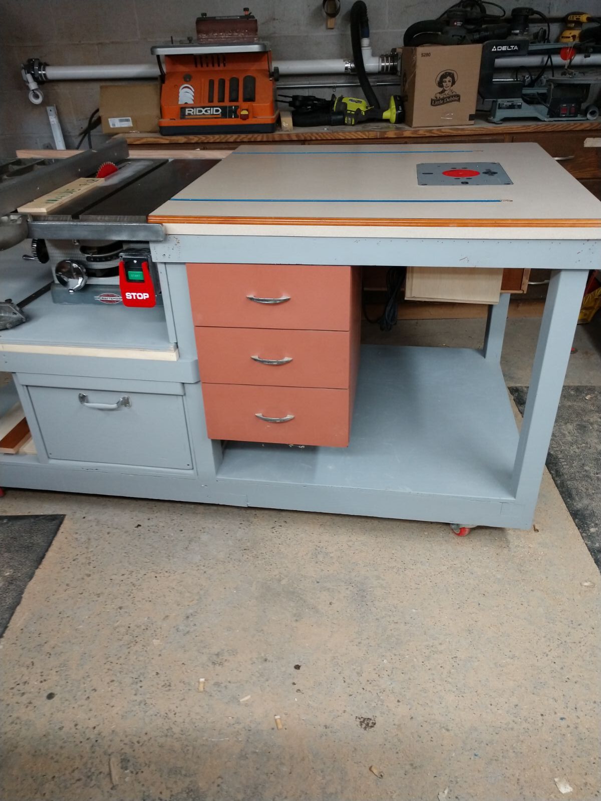

Relocated the saw cabinet from its old location. The empty space to the right I plan to use for saw blade storage, I'll build a cabinet to fit there. Need to finish the outfeed for the saw and then I should be good to go. It was a good day.

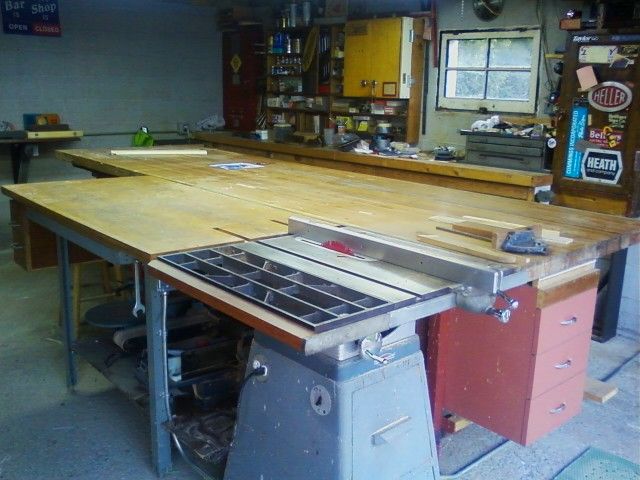

 Broke down the the workbench, cleaned off the catch all and gained some room. Waiting on a trailer & 6 guys.
