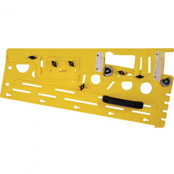

@kmealy, Thanks for the reply. I'll be using the Microjig Mico dial thingie. Not the miter gauge. It can be adjusted to within 1/2 of a degree.
Here's a picture.
The tables won't leave Tucson anytime soon. Plus, they'll be in a climate controlled environment. And, the tops will be finished on both sides with oil based poly....or, sealed up with Total Boat's penetrating epoxy. TBD.
