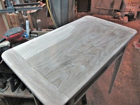

    About an hour and a half tonight....clamps came off the top, and the legs.... Worked on these, first...rather than use one of my "good" planes to remove the dried glue...I used the tablesaw

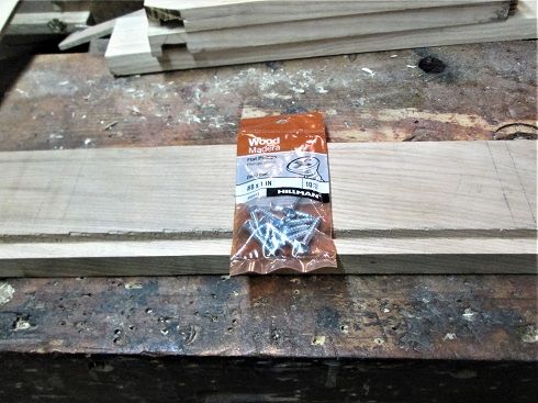

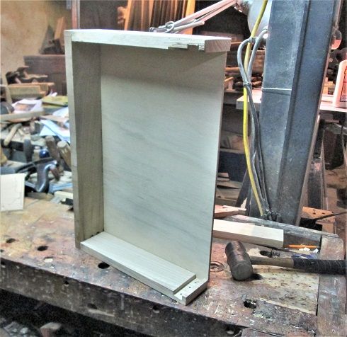

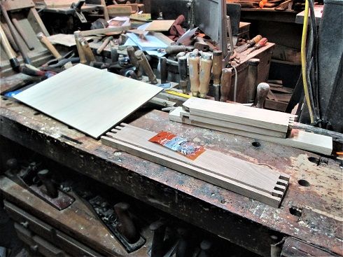

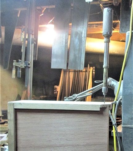

I even opened the shop..on.. a.. Monday?   Was feeling lucky, I guess.   Plywood cut to size.  Screws at the ready....drawer back was a 1/16" too long..:BangingHead:..trimmed that back...laid out all the parts..:ChinScratch:
Package of screws?   I didn't NEED a huge box of gold plated screws, when less than a dozen will do..:WonderScratch:

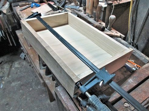

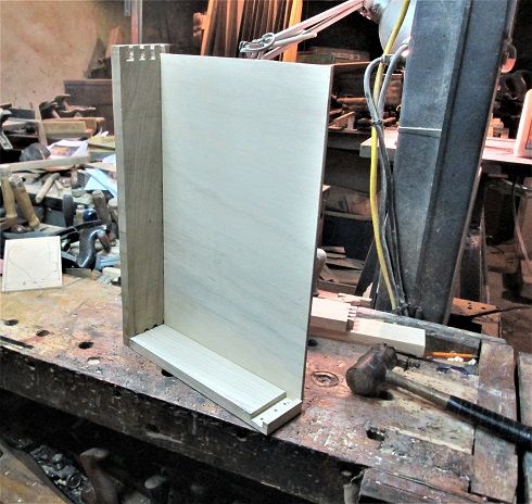

Chased down the bottle of glue, and a mallet...first side..
Plywood helps to keep things square..then the other side..
Glue in the dados..slide the back in place...needed pilot holes drilled...
Then install a few screws..
Then, check the drawer for square...I don't mind a little "toe-in", trying to avoid the "toe-out"...then a couple clamps, as these need clamped up..
So..
2 seemed to be enough...tried the drawer out, to see IF it will slide in..

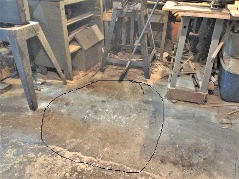

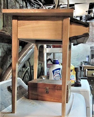

Works for me...needed to work on the top of the table...needed to be ON the floor, NOT on top of the dryer...but, where?
Hmm, clear this out a bit...don't need too much room..

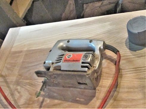

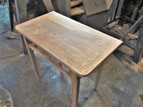

This will work...Need to cut a radius on each corner of the top...sharp corners and kneecaps don't like each other...got out the High Tech Radius Jig...
Lay out a few lines..then a Vintage saw..
To cut the lines...had to place my knee on the table top, to keep the table from walking away..front two done..cleaned up with the beltsander..
Then rotate around, and do the back two corners...then up onto the bench, and a round-over bit was run around...then sanded it all to 100 grit...

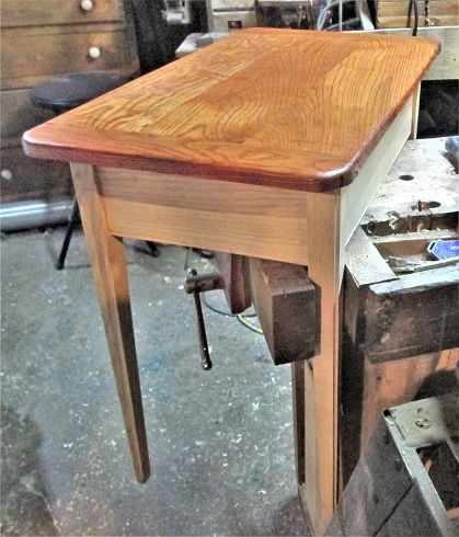

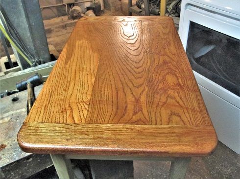

Gave just the top a coat of stain..
312104710_Leftoverstopstainedbeforethewipedown.JPG.764c56f898979e6ba078c3839cbae6ec.JPG

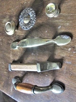

Let this sit a bit, before I wipe it down...looked at handle choices...more like the 3 Bears...
Too fat, too small, and one....maybe
too long?   back to the top, gave it a good wipe down..

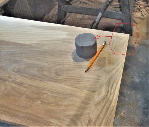

Tried to match up the grain...sap wood at the back..then heart wood the rest of the way...like a single fancy slab...
Worki holding?

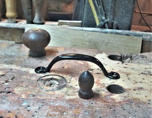

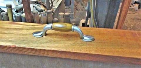

Spares Box...had a few more handle choices to go over...:JawDrop:
Leaning more towards the bottom one in this picture....:ChinScratch:

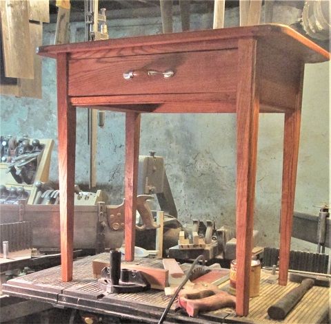

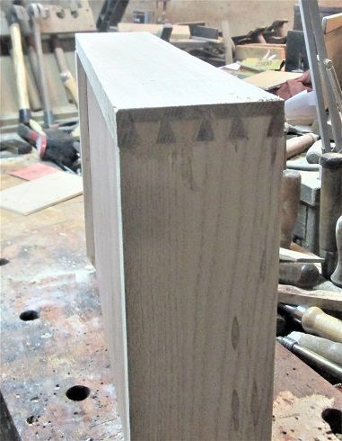

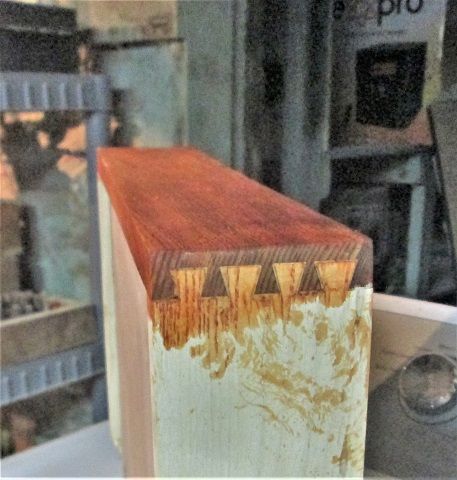

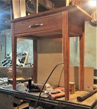

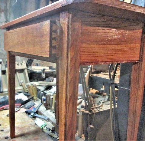

Well...drawer front was stained, after the dovetails had been cleaned up...
I rarely ever stain the sides of a drawer...too good of a chance the finish will cause it to stick...drawer was test fitted..

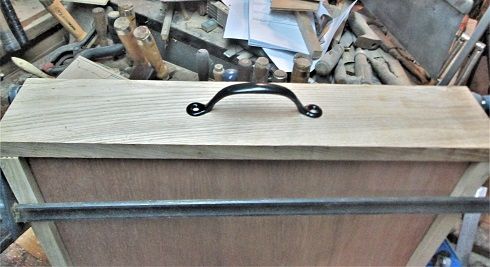

And a handle selected..
Brass plating was starting to flake off, wire wheel cleaned things up.
41838952_Leftovershandleinstalledtablestained.JPG.79abc657a53e46b283b1d056ba2f2e2c.JPG
Handle installed, table has a wiped down coat of stain..
Front, before the handle..and...
Now waiting on the stain to dry, before the varnish goes on...guess this is a "PIP"?

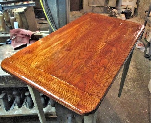

back is still too sore to walk much,  let alone go up and down stairs to the shop.....Spinal Stenosis Lumbar..first 5 discs...right side...might be a couple days, before I can top coat the table....:OldManSmiley:
Still have a few "leftovers"....we'll see what happens to them...:ChinScratch:
One coat of Amber Shellac applied....waiting on that, before the next coat.....stairs and my back are NOT on speaking terms, right now.....Film @2300 hrs...
