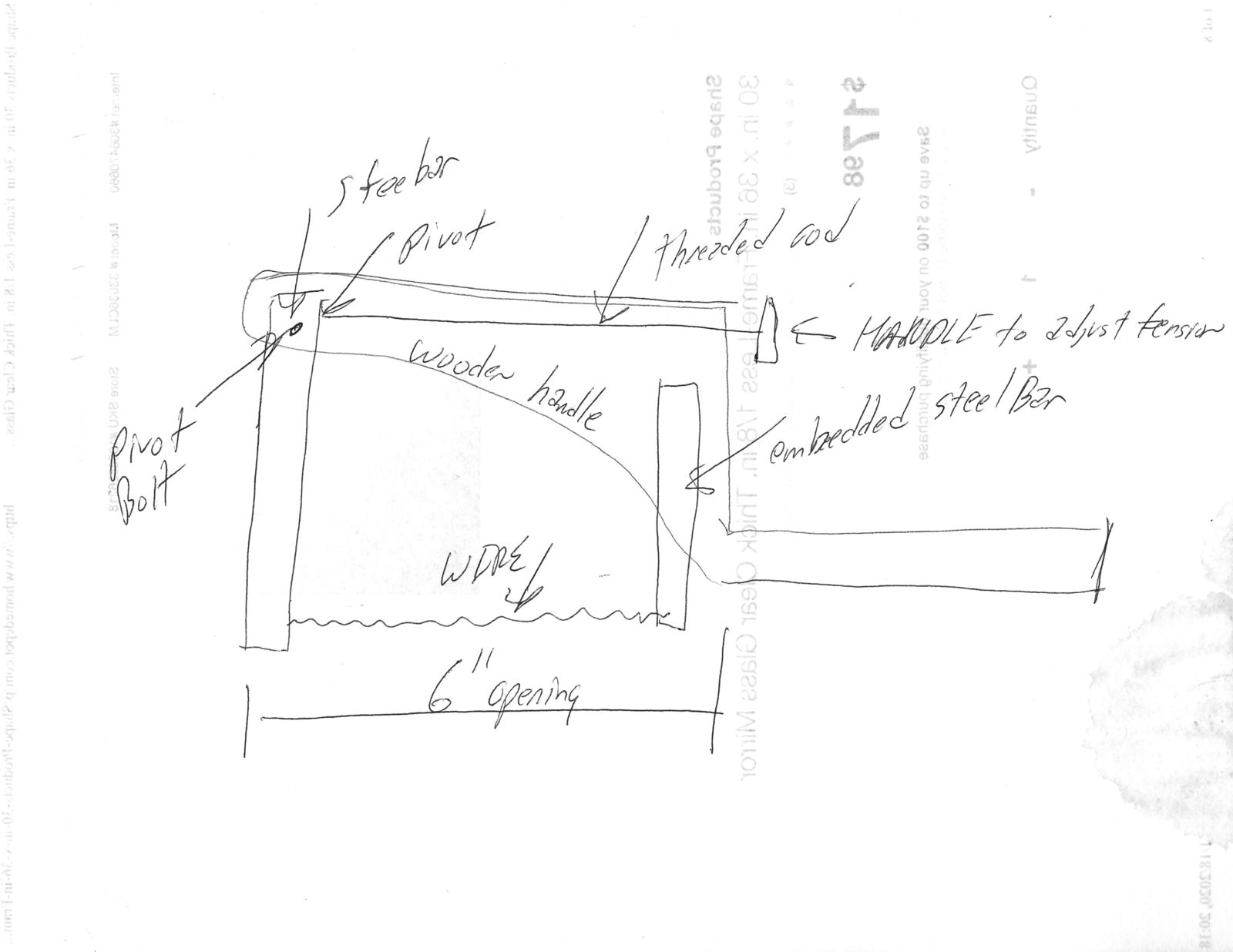

This is the rough drawing I using to make parts.  Don't have anything much to take a picture of yet.  Open to suggestions.
Edited by Woodbutcherbynight
I cannot see the tension getting there with what you have. If you have watched The Woodwrights Shop Roy has a buck bow saw with a rope for tension.image.png.ab80206d778b8823f8d7620c639a9f16.png
This could be done on a small scale and use a long bolt for the tension mechanism.
I am thinking the threaded rod will pull on the metal bar with the pivot when the hand crank is turned in.  The drawing is crude, sorry about that I never was much for mechanical drawings.:D  Give me a few days and I will have a mock up.

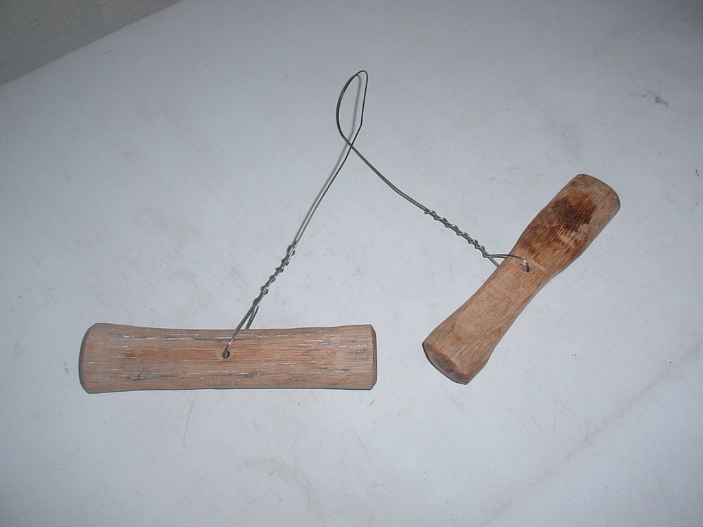

Here is what I made and use
Yes that thread is what inspired me to try to make one along those lines.
The night before I could not sleep thinking about using
and old hack saw or coping saw for just that same thing.
But I decided to try the easy way first being that I had
no experience with this and I'm glad I did. It seems that
the wire needs to wrap around the wood to get it hot
enough to burn. I now don't think a wire in a saw will
work very good. Even with a lot of slack in the wire
I don't think you would get enough warp around the
part to burn.

I used a piece of 2 x 4 with an arch in the center and a piece of wire run between the bottoms to make these.  Got plenty hot.  Just pushed the makeshift tool into the groove until smoke came out.  Took a few tries to figure out how long to hold.  The method worked but the tool was without a handle and the wire could not be tightened easily.

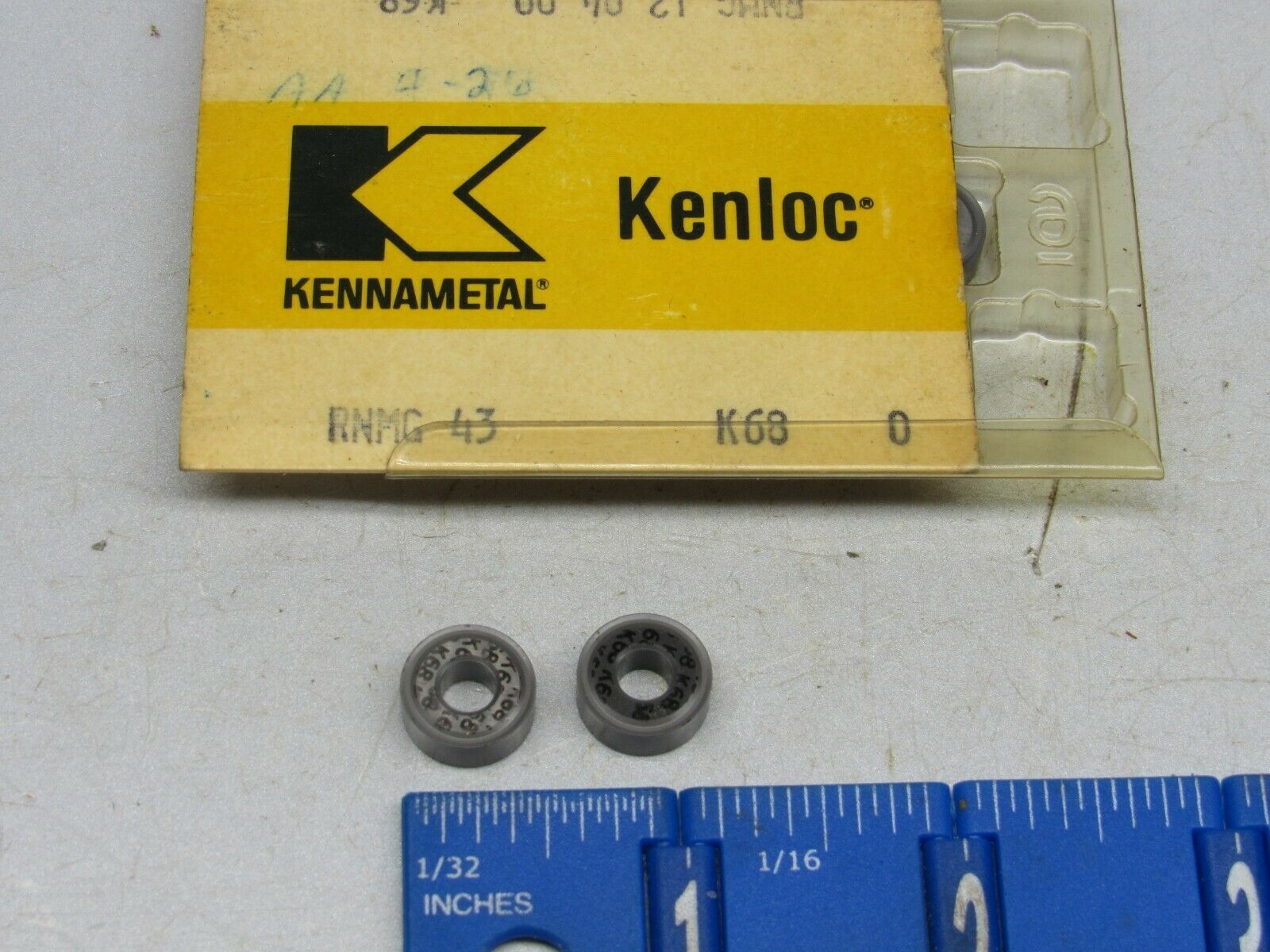

I finally got my inserts so I could finish my tools.
Now all I have to do is to try them out...

I made a holder also for my metal lathe for these new round carbide inserts. Tomorrow I will try again. The inserts has no - or+ rake
and I forgot to add some rake to my holder. I added some rake after I found my mistake and tried to fix it. I had to put a washer under the insert to raise it up to center again. I'm just going to trash it and start over again even though it did work. I don't like putting washers under things.
Edited by Kevin Beitz
Old one and the new one with added rake...
One thing I found using round cutters they sure make HOT chips.
