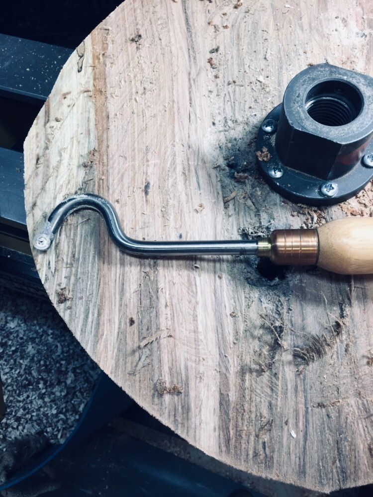

    I think I'm done for a while. I still want to make a hollowing hook  tool. I'm still waiting for my round carbide tip to come before I  drill and tap the hole on the second one.

    While I was waiting for my round carbides to be shipped to me I made another one to hold square bits.

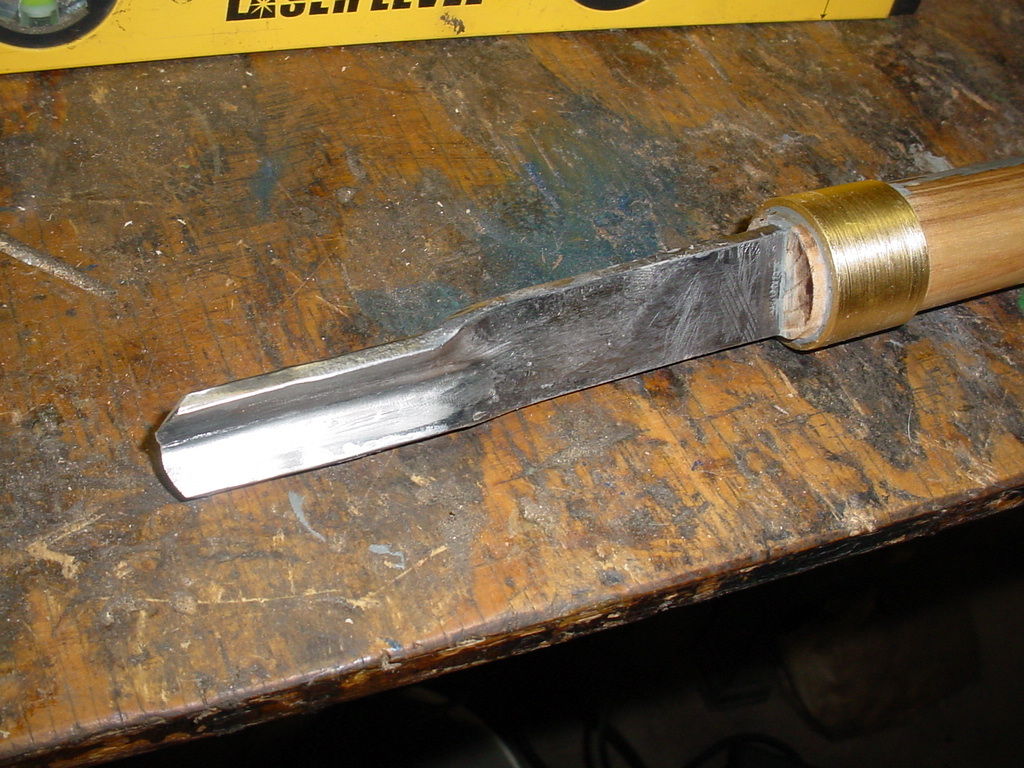

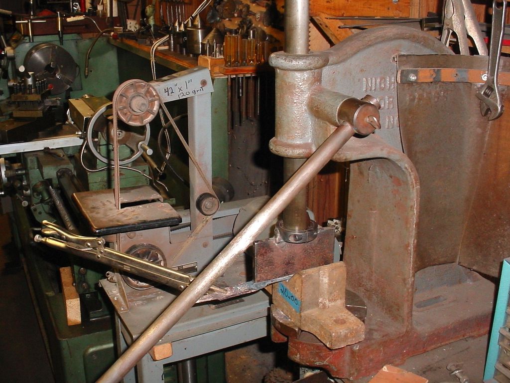

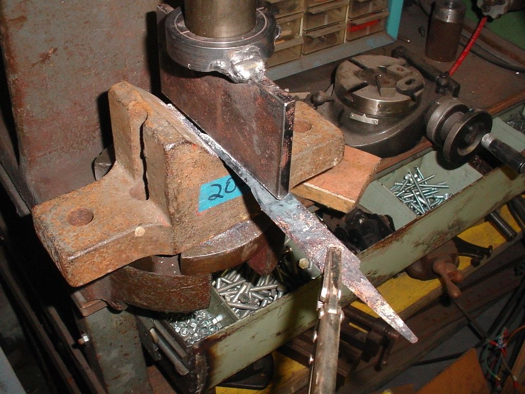

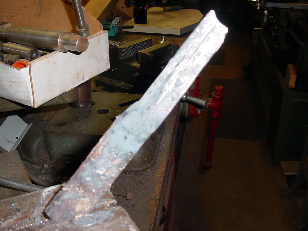

    I busted the first one. I have a forge outside but the temp is only 22f and I'm staying in. I used my wood stove for the heating. Forging tool steel is not easy. Now I need to make the handl
This lathe bowel Gouge made from an old file is turning out
to be the hardest one to make so far. It took 45 min just to
sand the file smooth. Then I took around an hour to get it red
hot in my wood stove. Then it took some serious pressure to
bend in the grove. That's as far as I am right now.
Kevin let me warn you that the metal in files is brittle and will break easily and not a good idea for anything more than a scraper and then it has to be properly heat treated, because even in a scraper there is danger of a catastrophic break.
Edited by Gerald

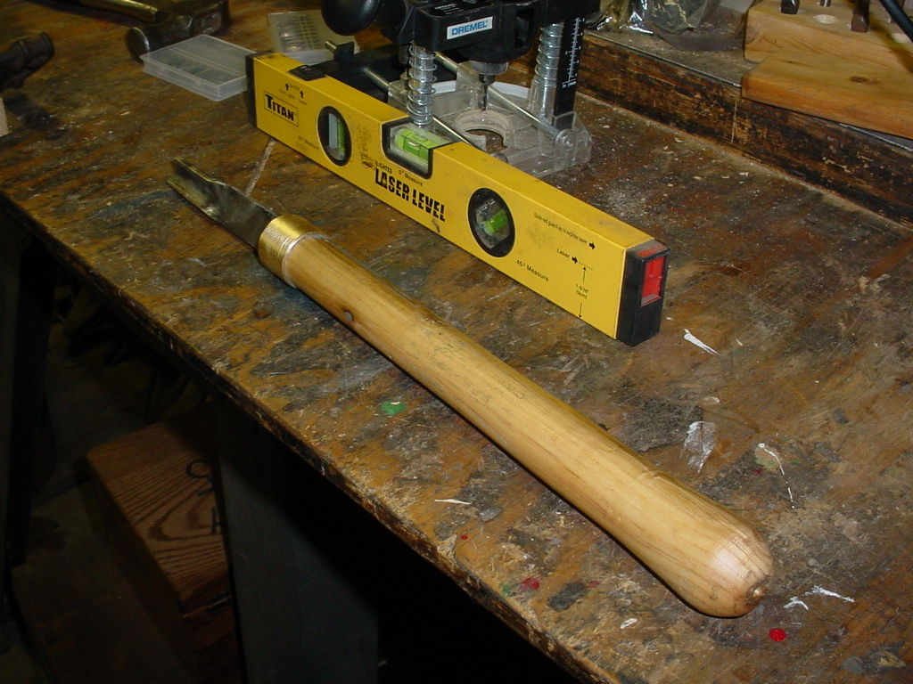

This is the one I made. Oh by the way I misspoke it is HSS.
This one one was made by a couple guys on the gulf coast, no longer in business.DBFB0217-0884-4677-AB13-DB1ECF4F6D92.jpeg.f650b788567e133726e77fa764ed0631.jpeg
Do you like the one you made?

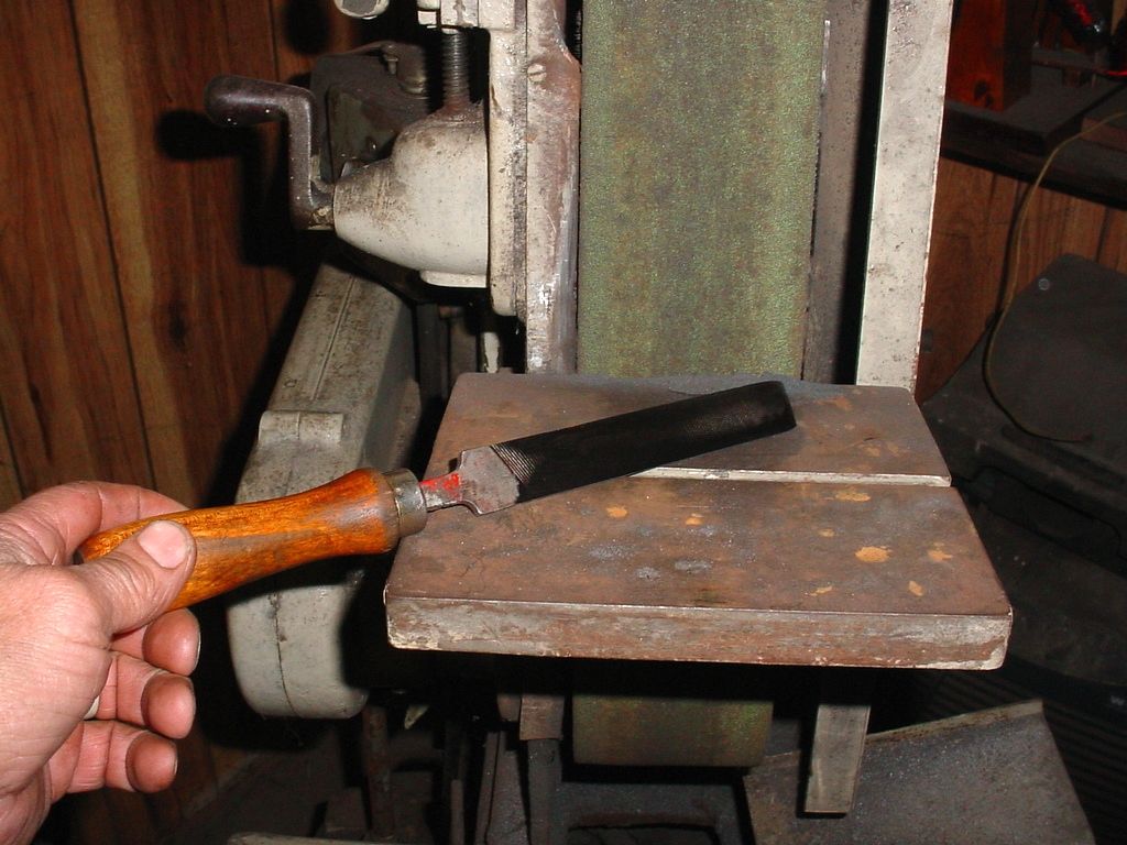

This tool was made from a old Nicholson file and it should be
1095 steel. I annealed is so it should not be so brittle. I then
Then heated the tip up bright cherry red and dip it in oil. to
temper the cutting tip. Newer files today is made from a
cheaper metal and then case hardened. I have a metal oven
for hardening metals. I use it for doing case hardening stuff.
I'm hoping I annealed it enough so it does not snap during use.

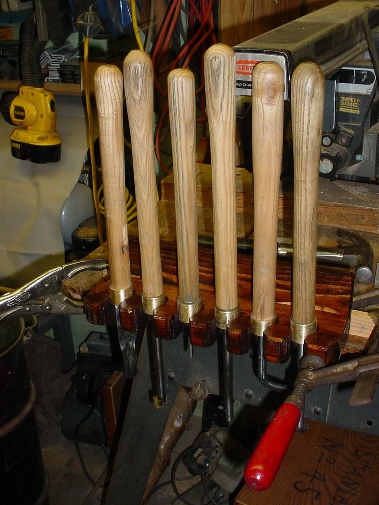

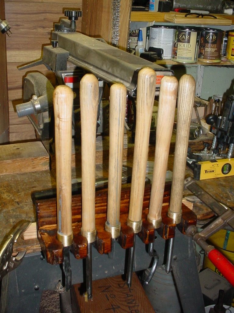

I finished up the one made from a file. Then I made a wall holder
for them all. It's going to be while before I post on how they work.
I don't have heat in my wood work shop.
Look good ,  but kinda short on the gouge you made. If you ever try a Thompson, D-Way, or other good brand gouge you will see there is a big difference between that and home made. Not putting down what you have accomplished it is just that you will have limited capabilities with short tools and repeatability of sharpening will be difficult unless you also invented a jig for that.
     Your swan neck looks like it will do a fine job.

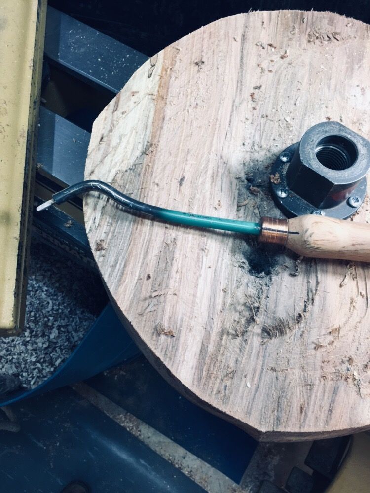

I got bored and made a wire burner for my lathe today...
I used spring or Music wire.
What does the wire burner look like?
Just a chunk of wire between two wood handles...
Wrap around your spinning part and pull until it burns.
I have issues at times doing that.  (pins in wrist and arm)  Was thinking of something like a hacksaw that holds wire instead of saw blade.
