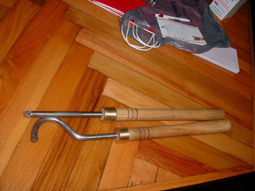

Carbide Wood Lathe Tools
All this talk about Carbide Wood Lathe Tools I thought I needed

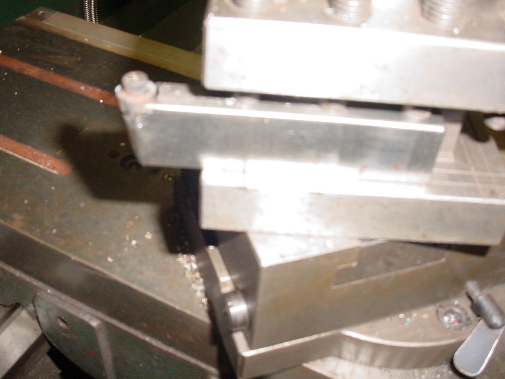

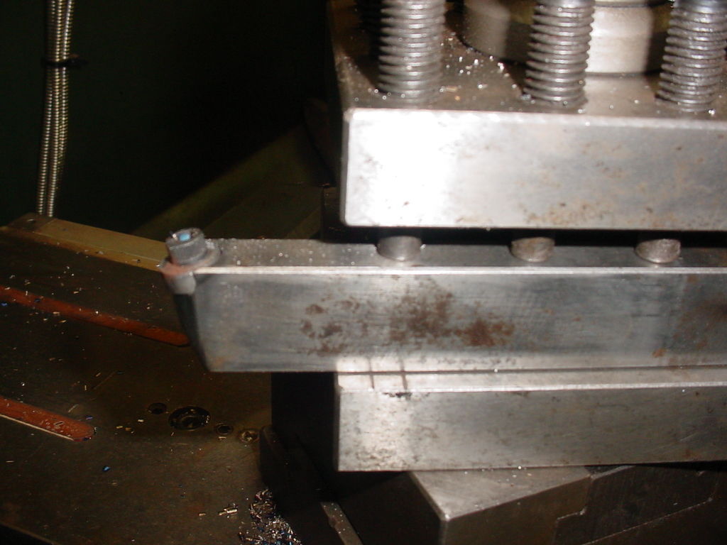

to try one. Prices are high so i made my own. I used 4140 tool
steel for the shaft. I almost messed up when milling the flat.
The steel started to work hard from the heat of the mill. The
mill made the cut but drilling and taping was tough. Ash handle
with brass ferrule. I have 100's of different carbide tips to try.

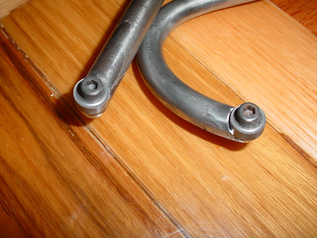

I snapped the first tip when I tightened the screw. I then put
a brass washer under the screw and that seemed to fix that
problem. It's not been tested yet. I'll keep you up to date.

    I think I'm done for a while. I still want to make a hollowing hook  tool. I'm still waiting for my round carbide tip to come before I  drill and tap the hole on the second one.

    While I was waiting for my round carbides to be shipped to me I made another one to hold square bits.

    I busted the first one. I have a forge outside but the temp is only 22f and I'm staying in. I used my wood stove for the heating. Forging tool steel is not easy. Now I need to make the handl
What is overall length of your tool?
The picture shows 20"...
I want to make one for the round bits next....
Where did you get the brass for ferrells? How did they work?
For hollowing the bend should leave the cutter even with the handle. That is a straight line thru the handle should end up at the cutter. Just in case you needed to know.
Thanks... I did not know that...
The ferrells was made from heavy wall 1" brass pipe.
Pressed fit also smeared with JB-weld.
The cutter rods was also pressed in the wood handle
and smeared with JB-weld.
