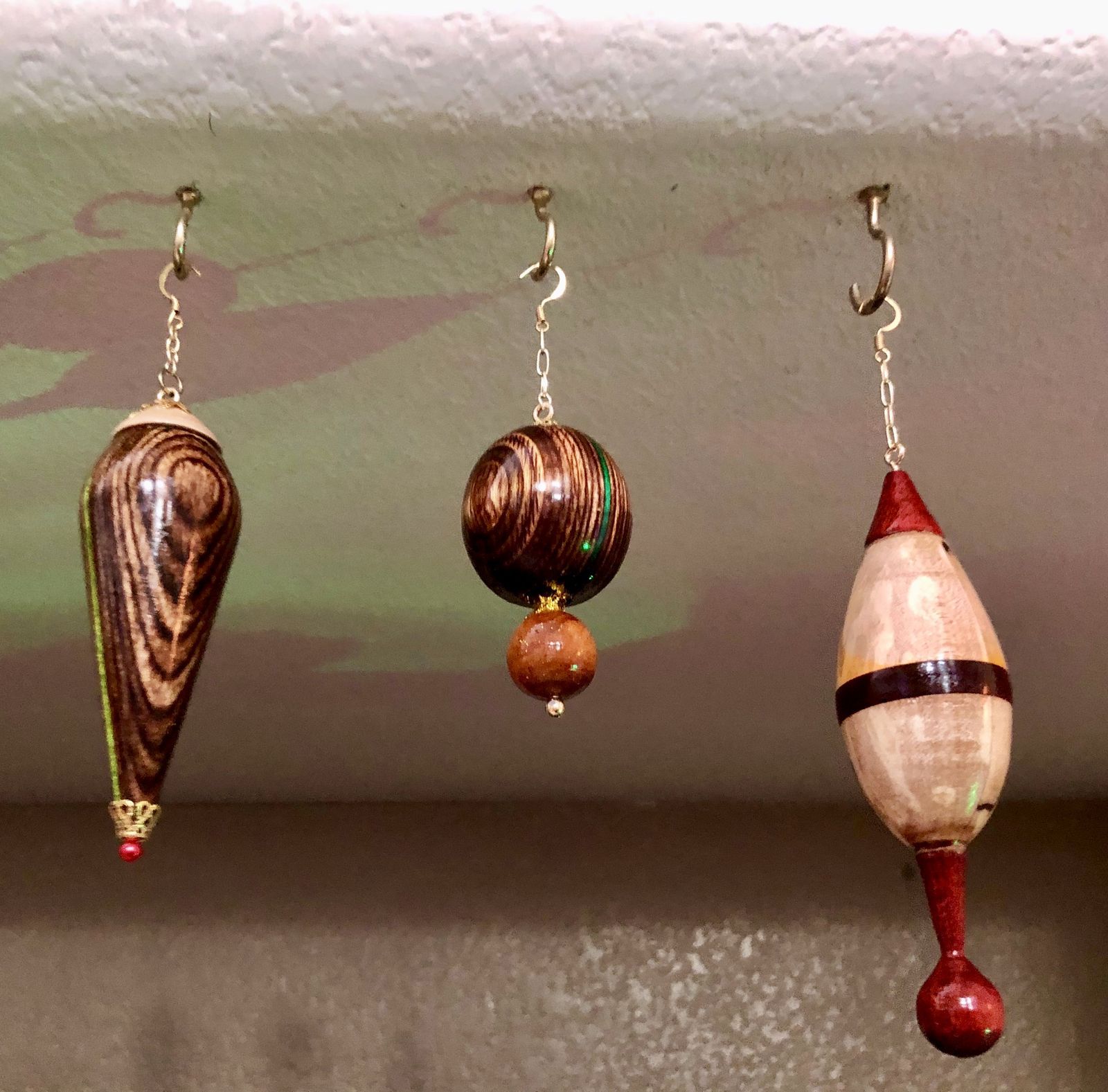

@Ron Altier has been working on ornaments. He posted three of his latests creations-
fullsizeoutput_ff4.jpeg.5ac546316f0946cc0a59bb071e7289c8.jpeg.fc767fd0821e3dfd714416b3ff81b944.jpeg
Ron's post has more details on how these were made-

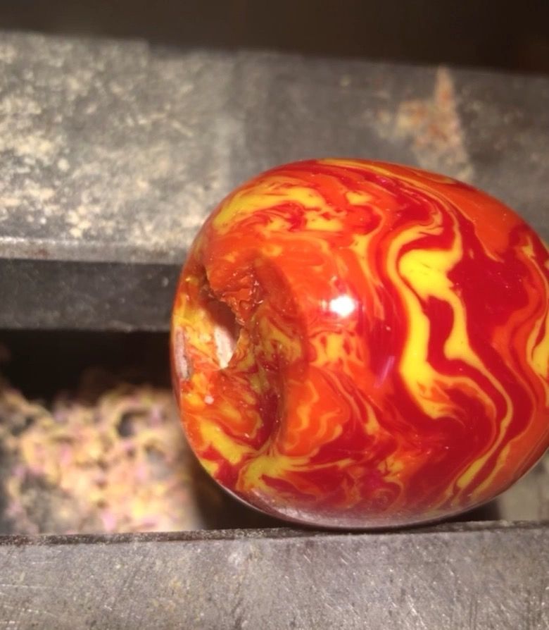

Unfortunately for Ron, not all the attempts turned out as he expected. One of his acrylic pieces didn't hold up-
fullsizeoutput_1020.jpeg.556b02d6b6e9b7169285f94f869bcd1e.jpeg.fb78c275680c7bdb78dd594956b0cfca.jpeg
He received some interesting comments and suggestions to his post about this failure-

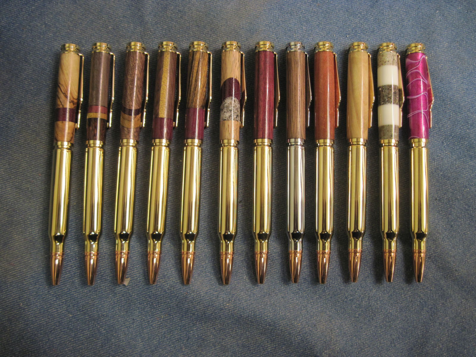

One of the comments was from @Woodbutcherbynight who suggested he might try Corian materials and posted some of his fantastic pens that use that material-

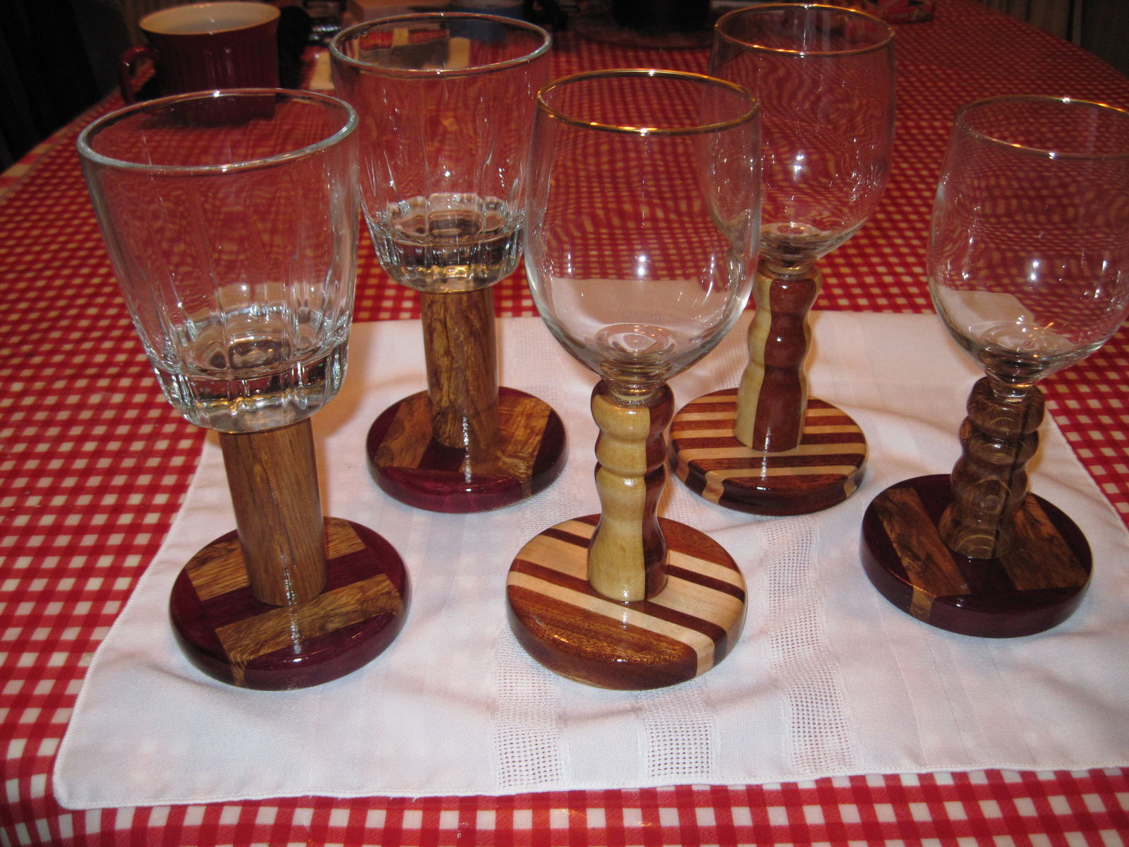

Gunny is the big winner this week with the most posts! He turned beautiful segmented bases for wine and champagne glasses.
IMG_0501.JPG.7d41ff74a0e6a99d2d8d43c1db34eff5.JPG.a9dd2eb0f22ef2f3f0620585dbd20a4f.JPG
You can see how he did the glue-ups and turning in his posts-

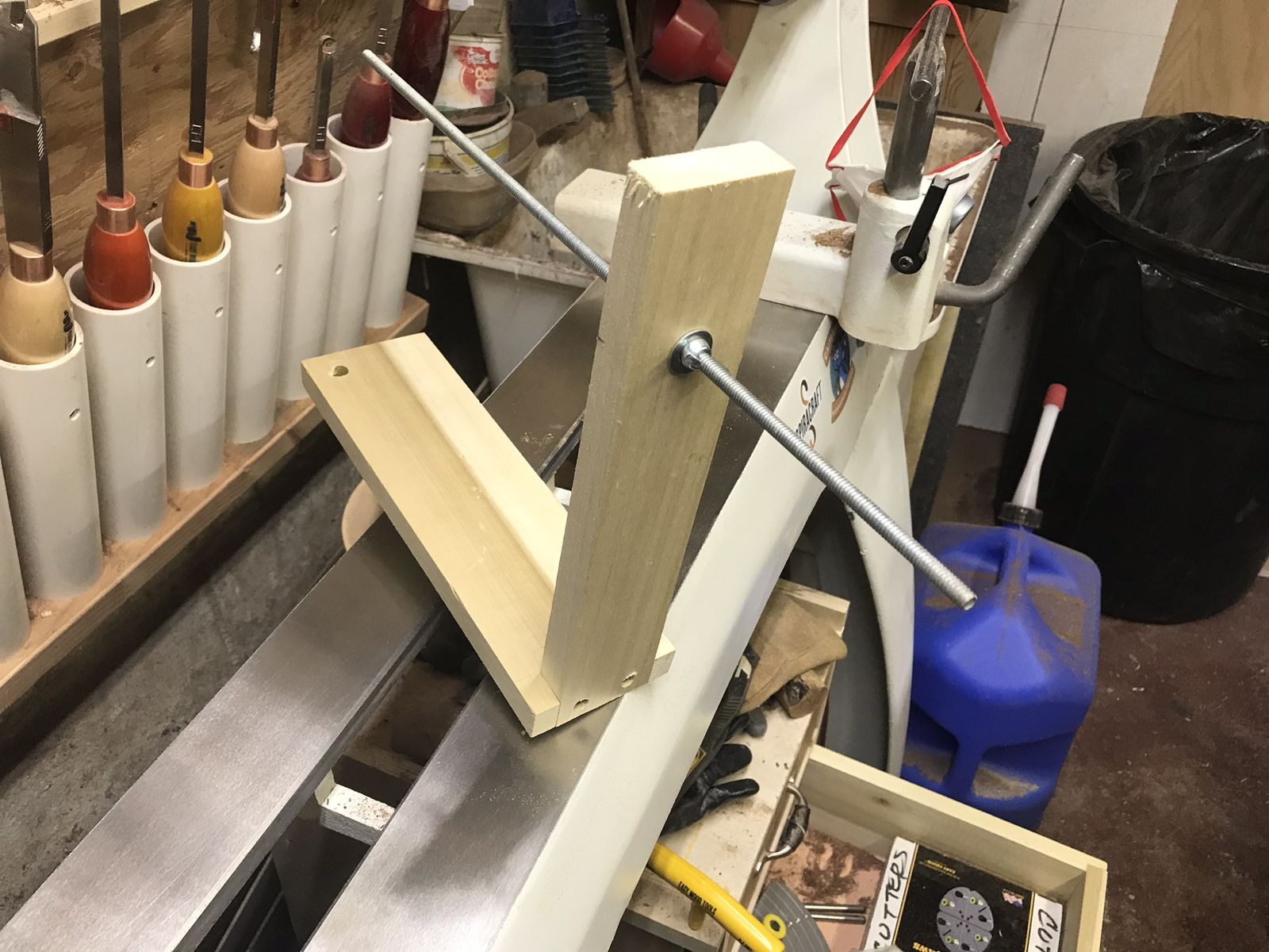

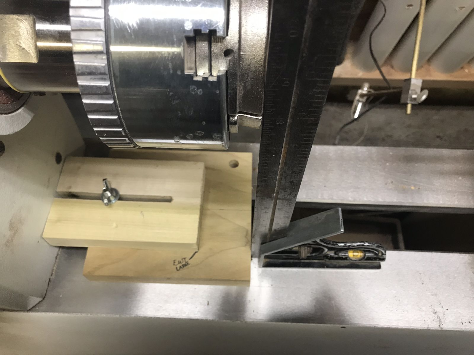

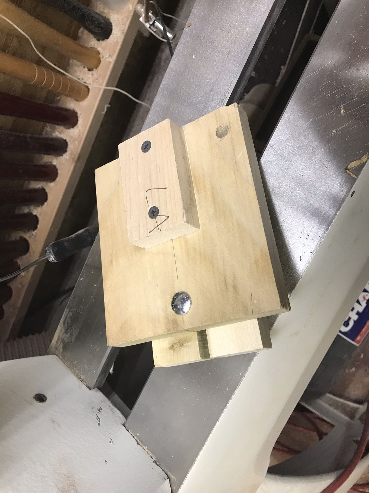

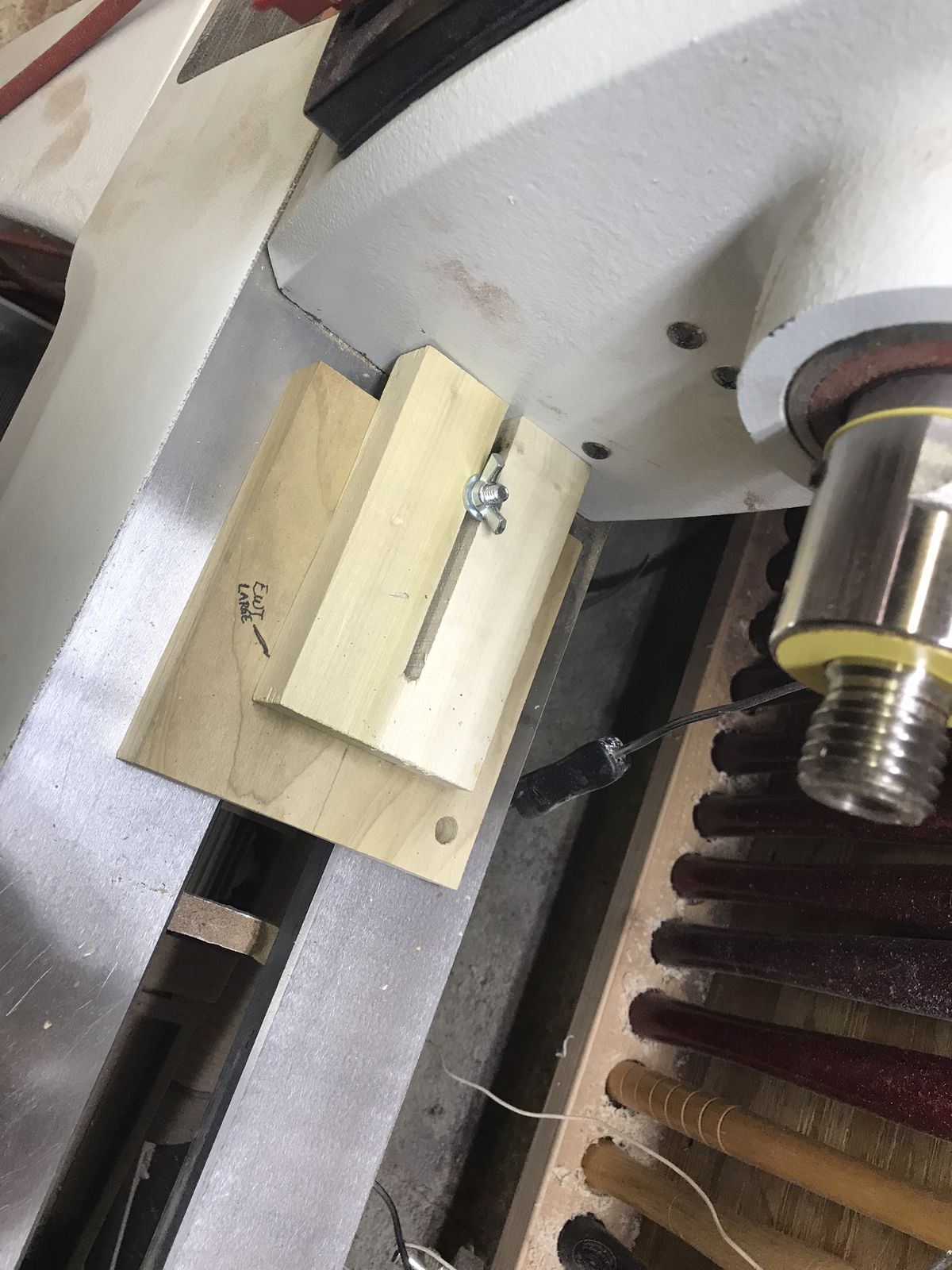

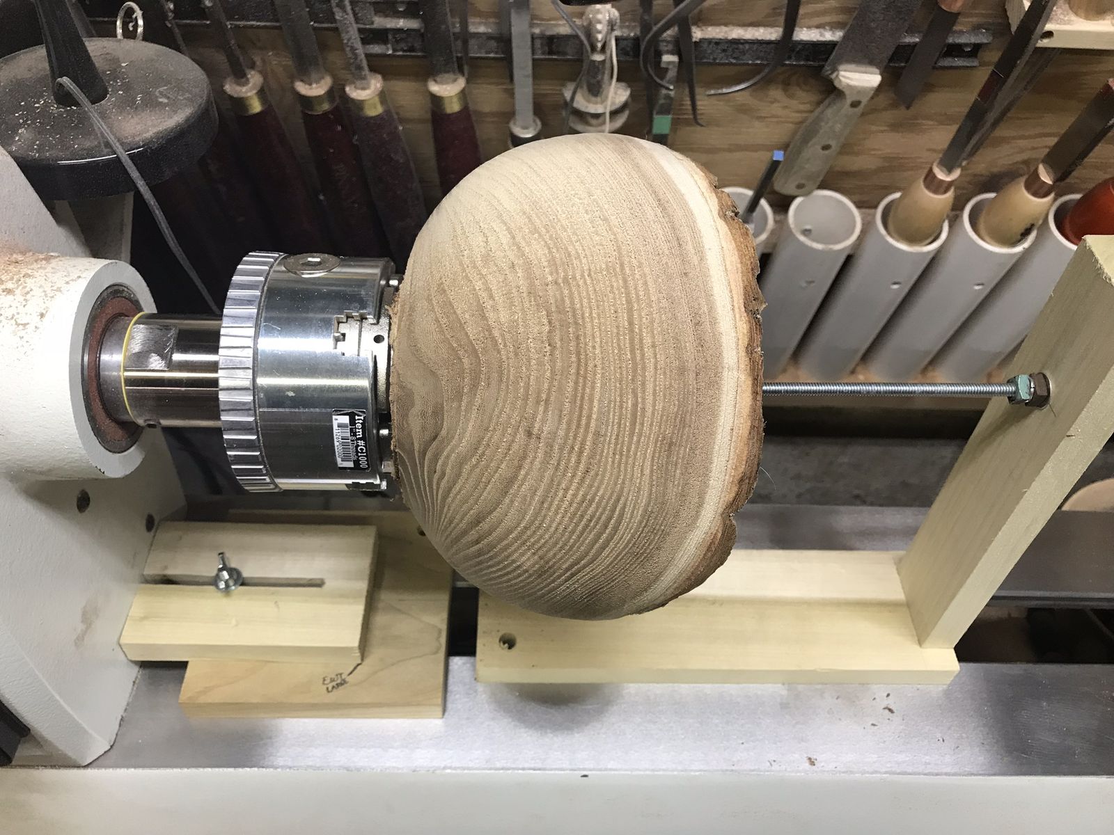

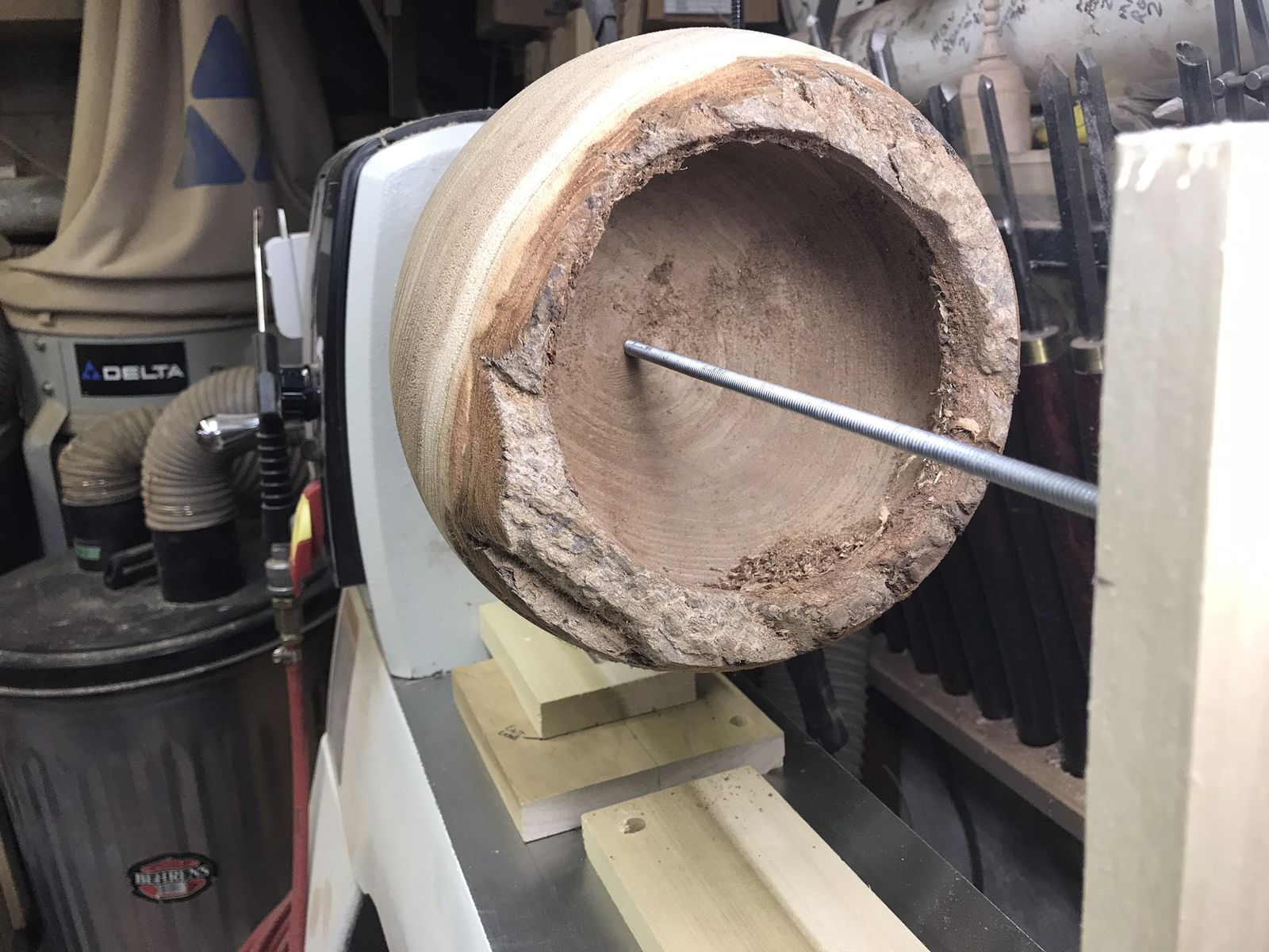

When I turn a utilitarian bowl, I usually use a recess for the jaws- just the way I learned and I find the bottom foot is a little larger. However, the recess makes it more difficult to judge the thickness of the bottom. While looking at Sam Angelo's wall thickness gauges, I found a video he posted on a nice, shop made jig that accurately measures the bottom thickness on recess and tenon methods.
My version mimics his with only minor additions-

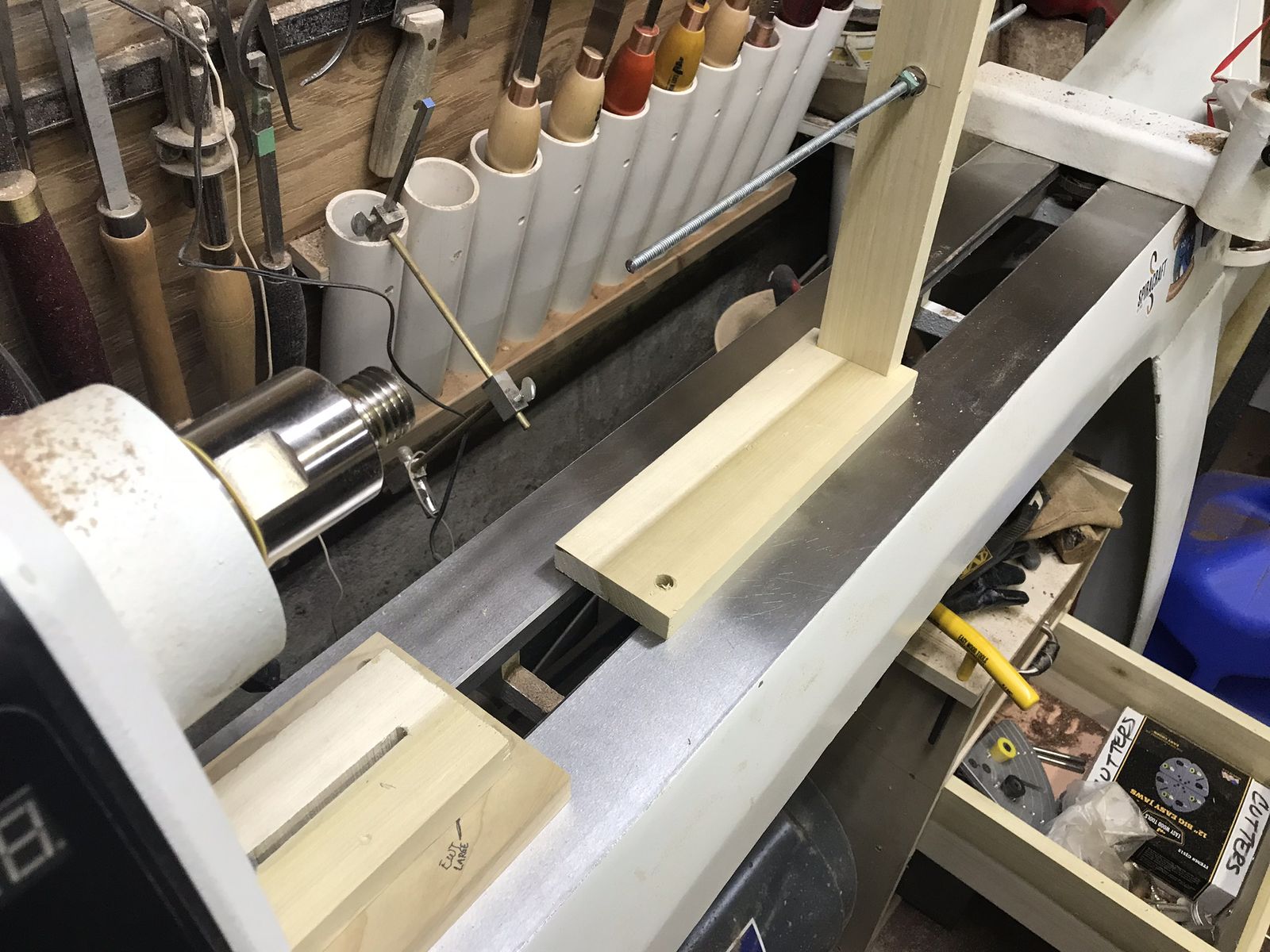

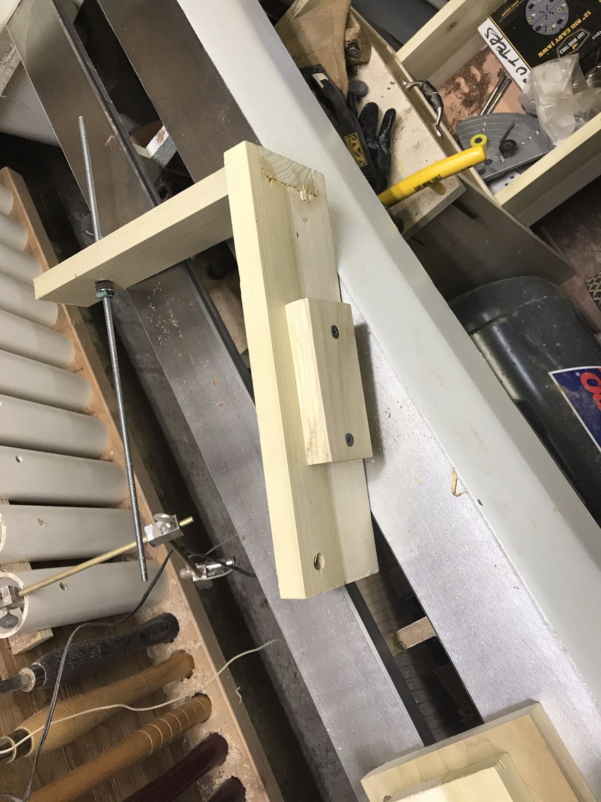

The fixed headstock spacer-

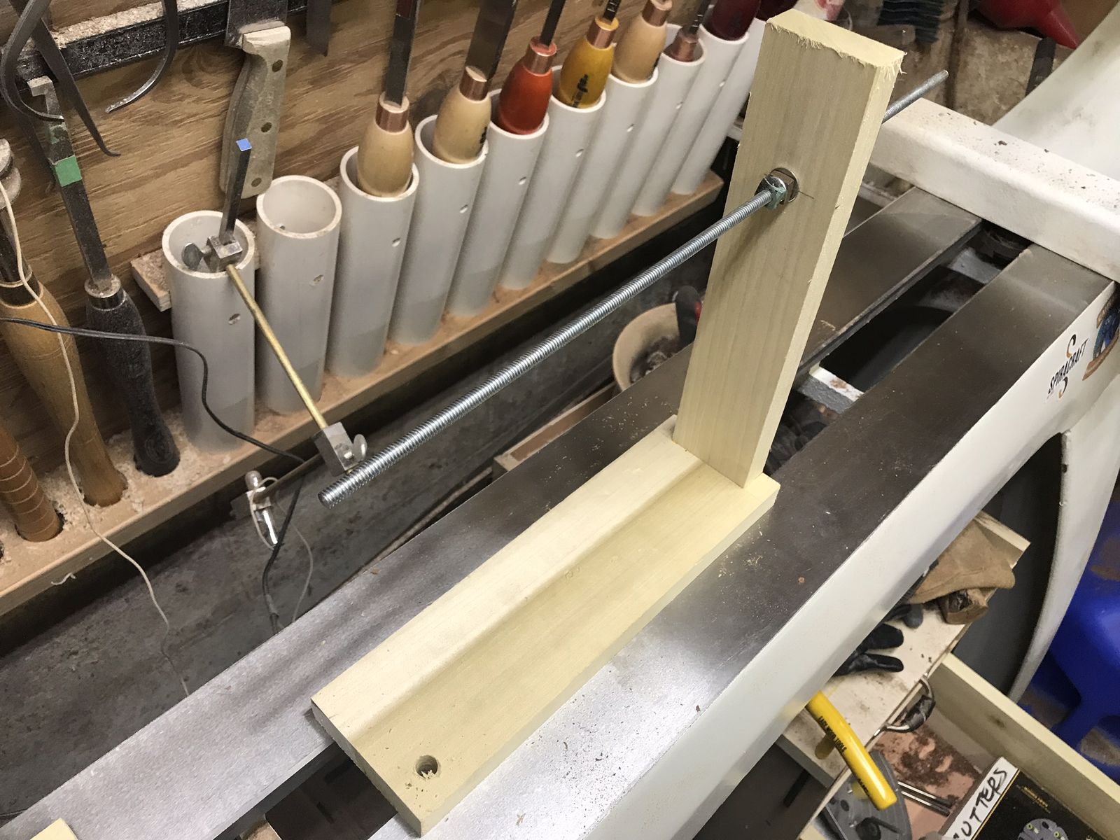

The movable depth indicator-

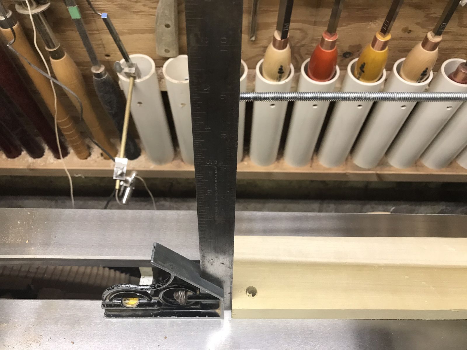

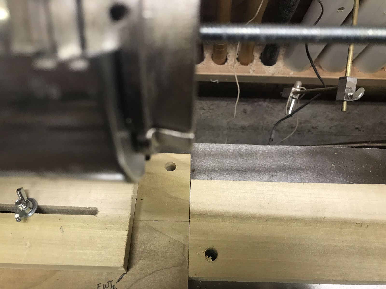

Calibrating the fixed spacer-
The end of the spacer is set to be on the same plane as the end of the chuck/jaws being used
Calibrating the movable depth indicator-
The threaded rod is adjusted to be on the same plane as the base of the movable portion-
When correctly calibrated, the depth rod will touch the jaw surface when the bottom sliding part touches the fixed part.
To use, position the threaded rod against the bottom of the turning. Observe the space between the fix and sliding parts of the jig. The distance is the thickness of the bottom of the turning.

A interesting jig.  Have not tried my hand at bowls yet but ya never know.:)
Lew that was a loong post . And many good ideas. I have the same depth jig but the point for bottom is wood . Think I like the allthread better. It does work very well and is easy to set up. Oh by the way the only chucks I use are SN2 so all the same depth, but as you showed you do need a different head stock measure on each lathe and that is a cool idea for adjustable. Keep up the good work
