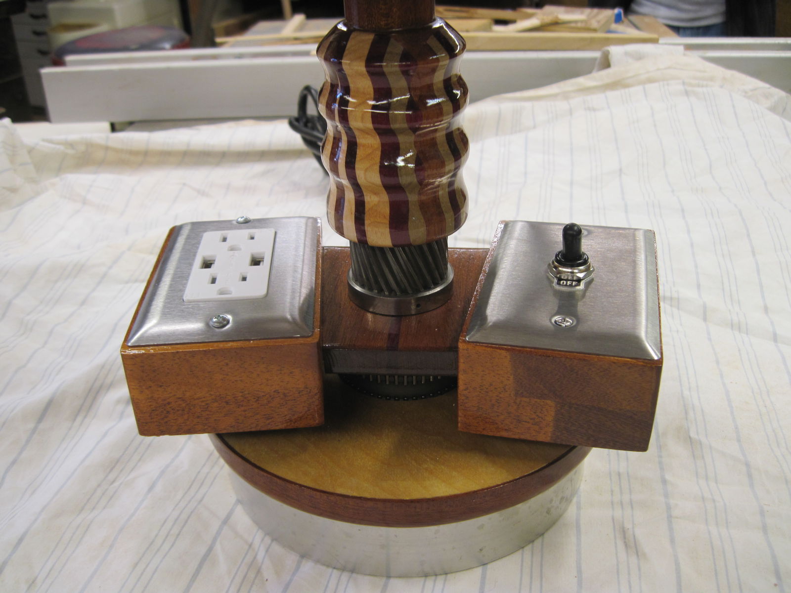

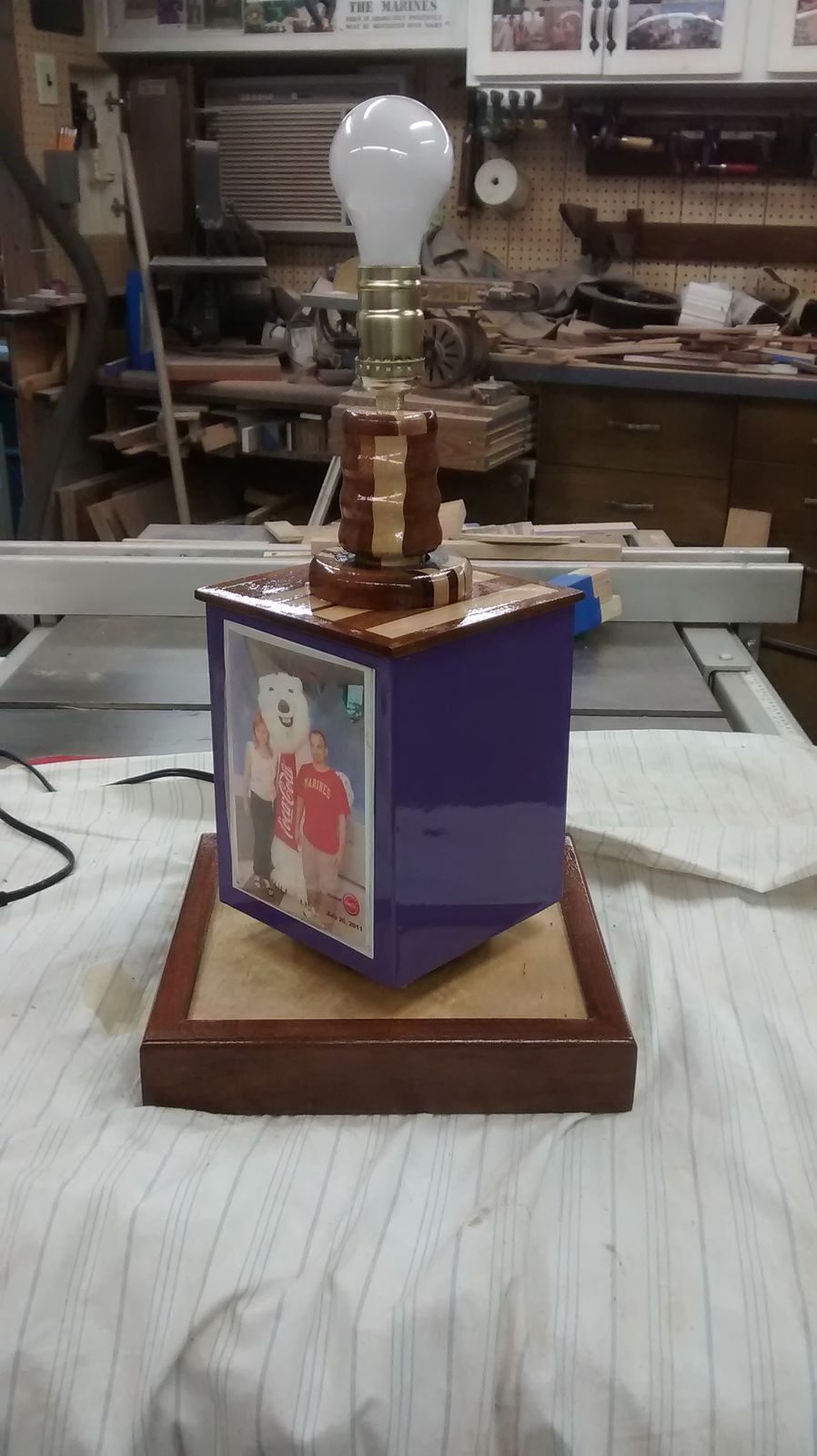

If I know I am using polyurethane as my final finish, say for a lamp, I don't use anything other than sandpaper to 220 grit and call it a day.  1st coat raises the grain slightly, you sand lightly then apply next coat till you are happy with finish.
