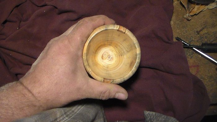

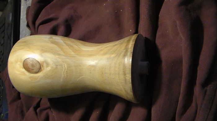

    Well I drilled out my third vase/cup form today with the stationary tail stock drill chuck I set up.  That works out beautifully, smooth and easy, I was originally a bit concerned and my first try was
Homemade carbide tools with commercial carbides should be easy with your skills. At some point you will want regular gouges. Even then you can make scrapers easily but depending on the steel you use may need heat treat to reduce brittleness and help edge last longer.
Well I drilled out my third vase/cup form today with the stationary tail stock drill chuck I set up.  That works out beautifully, smooth and easy, I was originally a bit concerned and my first try was definitely a bit more spooky as the piece was not completely centered when I drilled.  This piece was perfectly centered and balanced and man it drilled out like a dream.  I am using a 1 1/2 inch spade bit to drill with.
I then gouged out the remainder of the inside with my "tire tool" lathe tool as it gave me the best control and easiest cutting inside the vase/cup form.  I tried the bowl gouge but with that small of an inside diameter it seems to to catch and gouge without a lot of positive control.  I was happy with my end result though...
On the next thing I do I will watch to avoid knots in the upper lip of the cup/vase as they tend to work loose eventually.  I had one that was moving around just a bit while I was working the edge.
The outside is a simple form, sanded a bit and polished a bit with some old saddle leather.
I wish I had a better camera and I could show the tigers eye effect of this grain, it quite cool looking.  I quite like this wood for turning.  I have been calling this Western White Pine, but it turns out "this" wood is actually Scots Pine.

Bowl gouges are not good for hollowing a piece that small . You can use a carbide tool followed by a scraper or use a spindle gouge which for box hollowing is used much like a scraper. The carbide is excellent for that end grain in the bottom also.

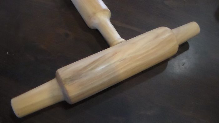

Out of curiosity, what size pieces do you use for making pens and whatnot?  I ask because when I make the rolling pins I may be able to size the cutoff pieces appropriately...

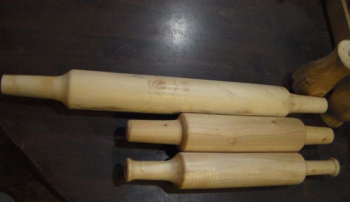

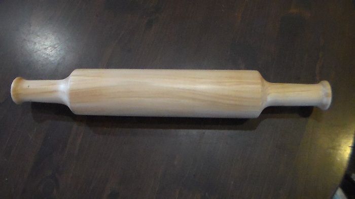

I made a practice rolling pin this morning using some dry poplar.  I wanted to know just how tricky it was to make one and whatnot so I figured make a test run or two or three out of low quality wood before attempting to anything with the higher quality wood.  I think it turned out alright.  It is certainly some work to get a flat smooth surface on the rolling pin face, I was thinking that might be a bit of a challenge and it was...  I got it shaped up and sanded and then I ran some paraffin wax against it and polished it up with a rag.
That pin looks mighty fine, Ed. I'm no turner but, I suspicion that elm will be a tad more ornery than the poplar.

I just made another poplar rolling pin, slightly different style, it went a bit easier and faster than the first.  I learned some tricks sanding this one, if I move the paper back and forth fairly quickly I don't tend to get the sand paper grit grooves as badly.  This makes it much easier to smooth with the next step of sandpaper.  I also found that those cheap little dollar store foam sanding blocks are quite good for holding your sand paper under.  It gives a bit when you push down and the grit helps hold your sandpaper firmly.  I again sanded and finished this one with paraffin wax and polished it up with a rag as well.

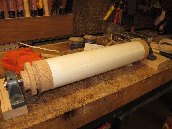

When I sand my rolling pins (usually do a dozen at a time) I use my random orbital sander while they are turning on the lathe at low speed. Sand them all with one grit, then move to the next higher grit and do them all again, repeat, repeat. I usually stop at 180. If they are too slick, the flour doesn't stick to them.

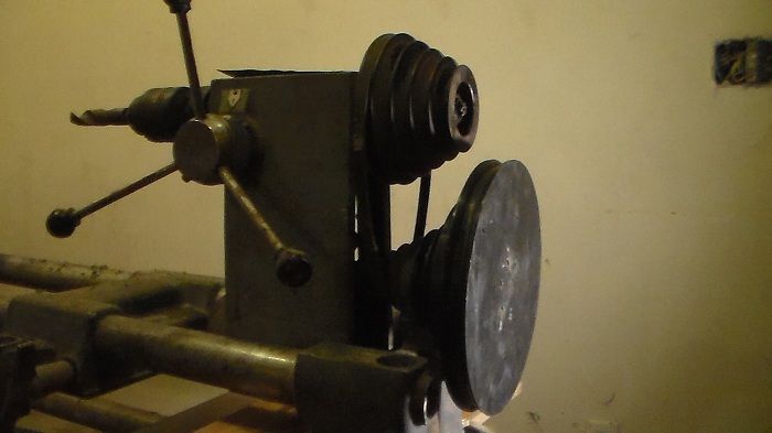

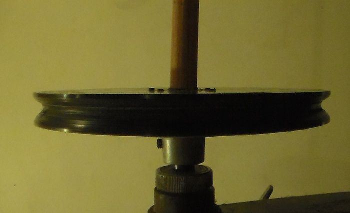

I got out to the shop for a bit yesterday and took the head off of my old floor bench press and set it at the end of my lathe, just kind of curious as to how much it would take to make that my new tailstock.  I can leave the original Shopsmith one and simply pull it off or stick it back on when I want but as I have watched a lot of these videos it is becoming clear to me how handy it would be to have a better tailstock setup.  I wanted to do more yesterday but alas my jaw has been infected the last few days and I am going to take it easy for a few days until I get that cleared up a bit as it is trying to spread up the side of my head and has already moved into my neck, when I don't take it seriously it can take me out for the better part of a month and require some doctors trips. So I am going to slow down for a few days.  I needed to be in cooking for Thanksgiving anyways.
