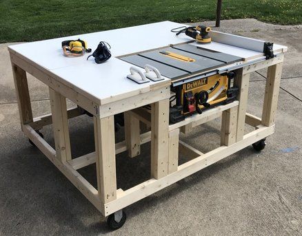

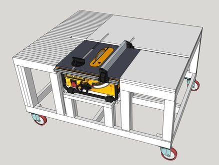

@p_toad that is a great idea for resources. My saw already has angle iron on the front and back. I'm trying to figure out how to support the back side of the out feed table.
More angle iron - with locking brackets (like for card tables, etc.) to hold them in place when needed.
Is this similiar to what your building...off another forum...

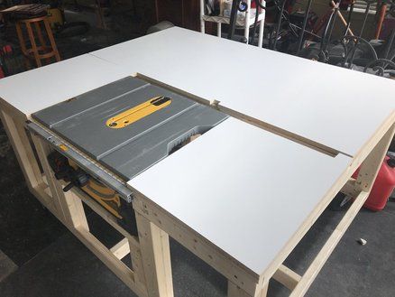

Here is the work in progress. It is so heavy now that my wife cannot help me move it around again.
The installed drawers is the front of the unit and will be directly below the table saw. The there is a dust shelf between the two drawers. The upper one just rides on the dust shelf and fits the opening just snug. It will be used to capture the saw dust out of the bottom of the saw. The bottom drawer is on full extension ball bearing slides. It will the odd-n-ins for the table saw.
I will post more later as it comes along. I am off for the holidays so I hope to get it done.
Don't know if anyone mentioned it but a really good sturdy outfeed table (hinged to the saw) is a absolute must in my book.
Coming along nicely.  :TwoThumbsUp:
