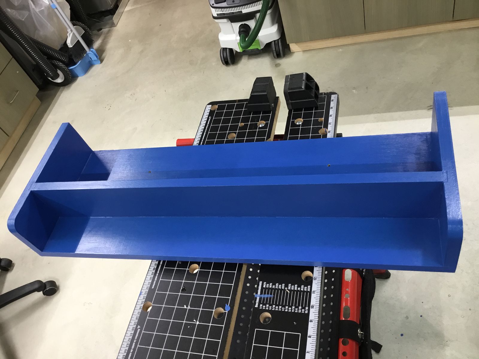

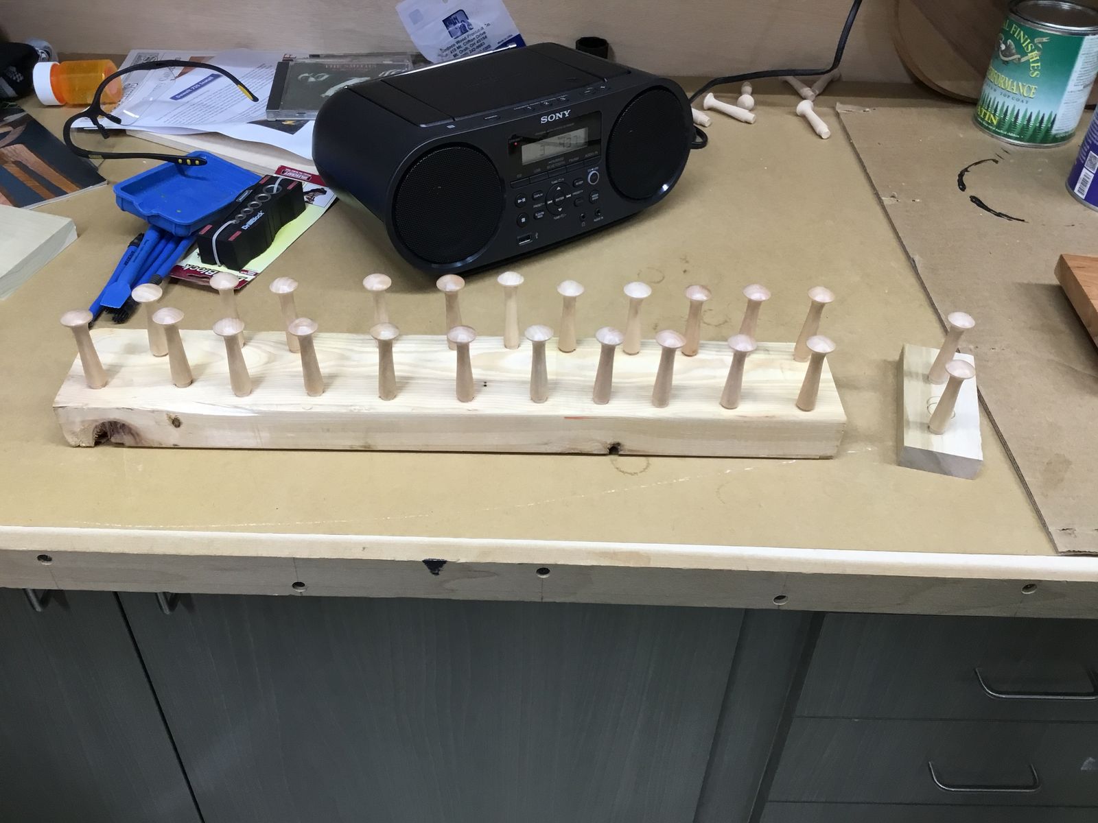

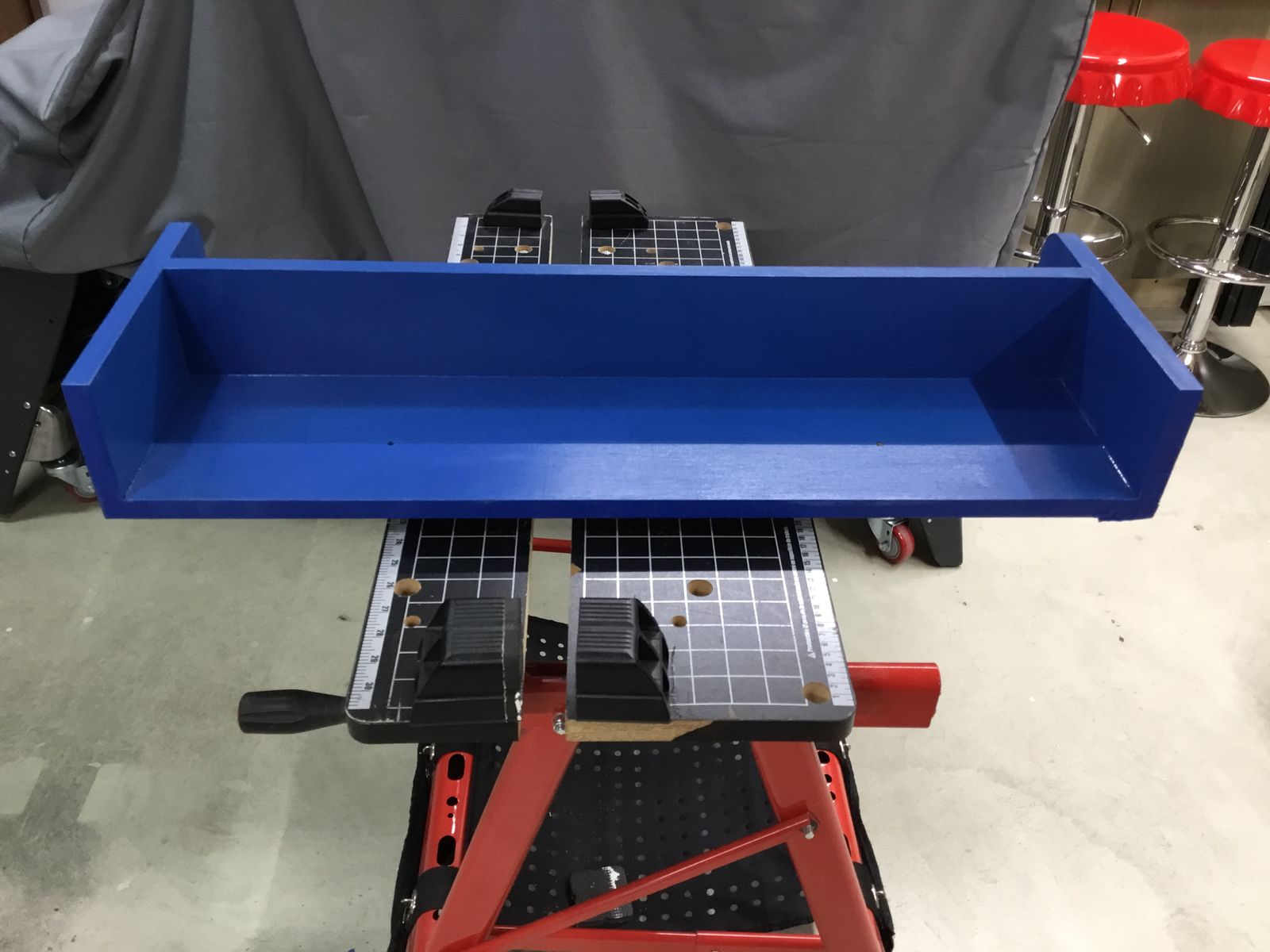

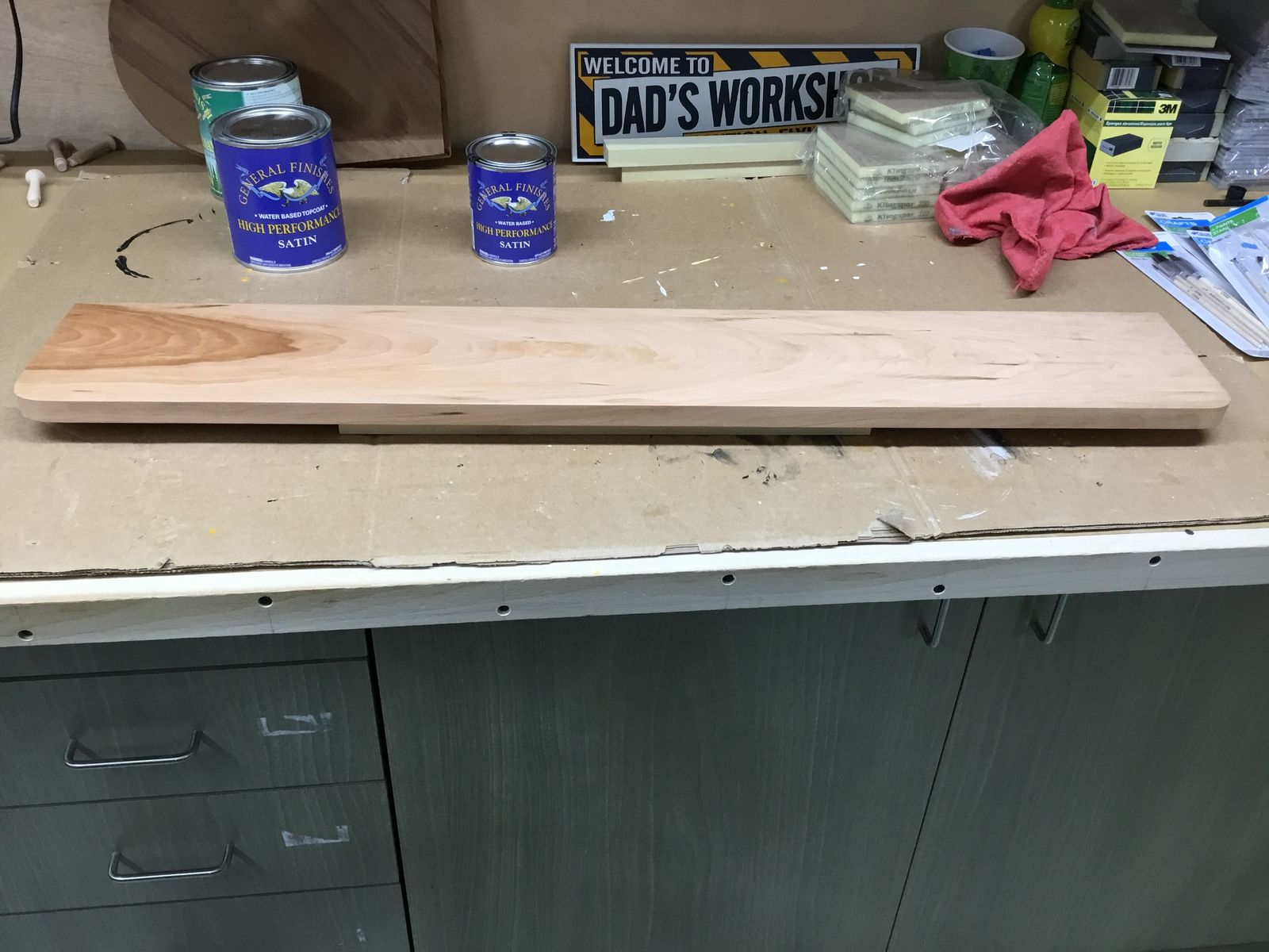

Okay, top shelf i’s done with finish coats, other than the bottom. I will do that after I glue it to the shelf. Pegs are done with their 3’rd coat. Shelf has it’s second topcoat, will apply 3’rd coat in the morning.
Looks pretty good Artie!!!!!
It's looking good Artie.  I can't wait to see what it looks like when it is complete.   Danl

Coming along nicely!

That is looking real good Artie!  Was the blue sprayed or brushed on?
I used the foam brushes. The plan is to get the holes for the pegs drilled out tonight, the pegs glued in, and the top shelf dowel holes (for line up purposes) drilled, and the top shelf glued/screwed on.
It's coming along very well, Artie. Like others, I'm anxious to see it all together.

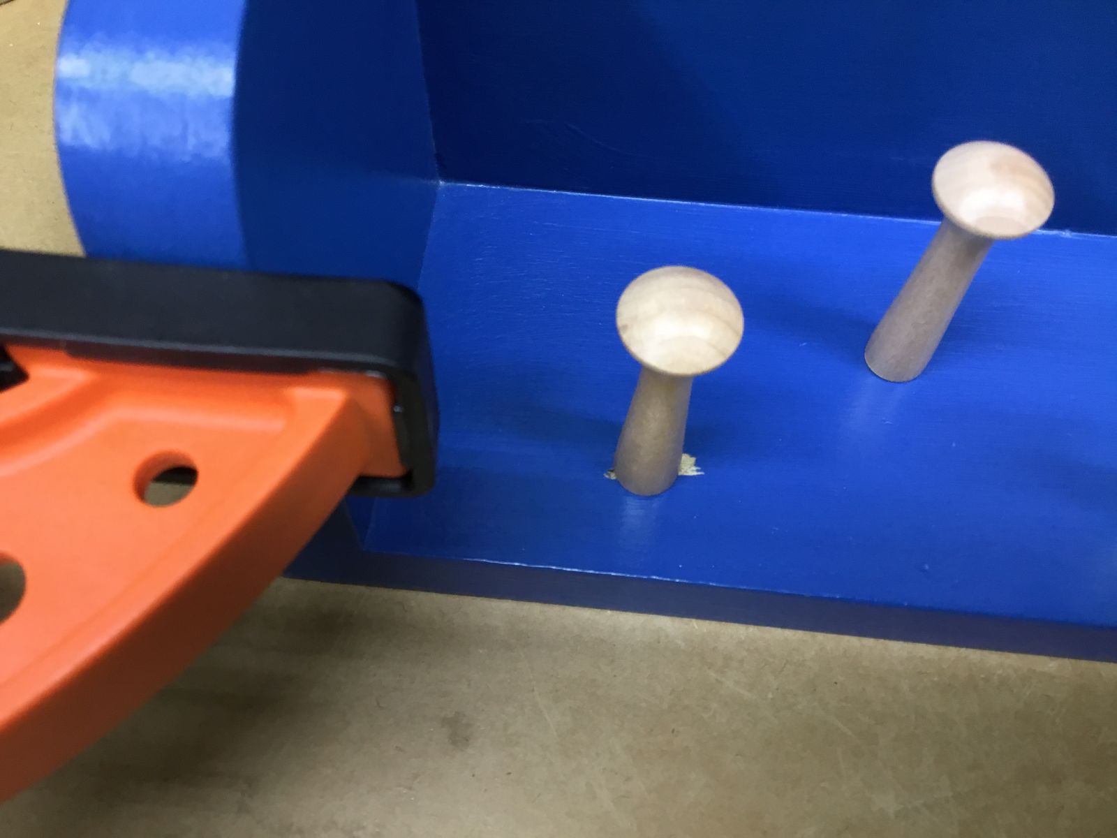

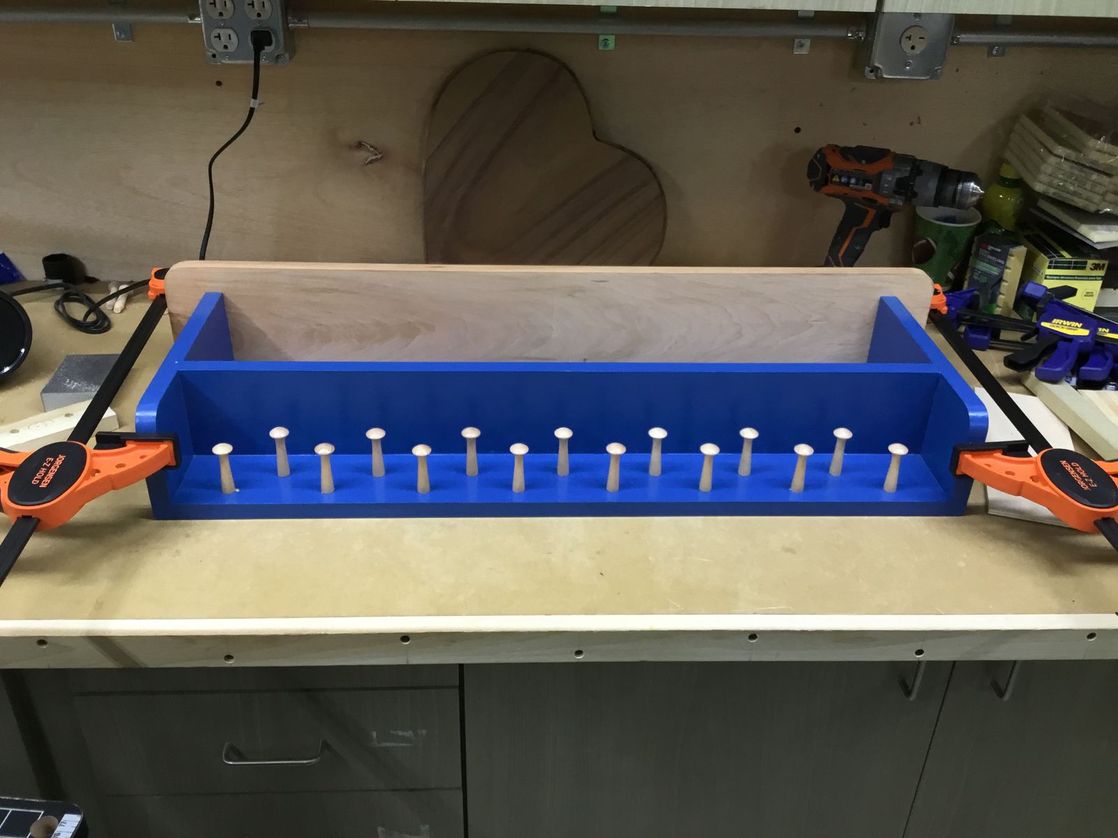

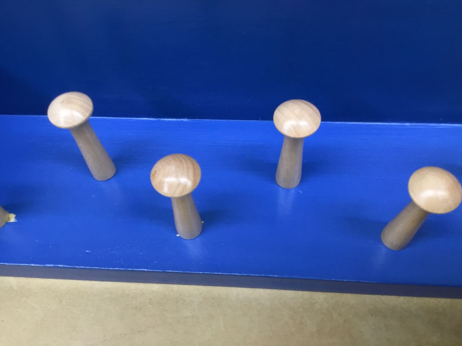

I was SOOO close to having a project I was happy with and proud of...... alas :(. When I bought the pegs I thought the tenons were 1/4, turned out that was for the pegs in the picture above in the catalog. I bought a Kreg shelf pin jig, so I could get the pegs installed accurately. I drilled the holes with the Kreg jig, 1/4 inch. Then I figgered I would drill the 1/4 holes out to 3/8 using a drill bit guide (I dunno what you call it, piece of metal with the different sized holes in it, about 3/4 inch thick). Apparently this doesn’t work out as well in practice as theory. I gouged out one hole, and two others will just need a delicate hand and brush to fix. I’m trying to figger out if I need to put a dash of Famowood in, let dry, sand, paint, topcoat, or just try to dab some paint in, and dab some topcoat on, afterwards. The top shelf is just less than 36 inches by6 inches.
Tough one but recoverable.  Question, did you drill the holes before painting?  I generally dry fit everything before any finish is applied because I seem to always miss some small detail that is important.
As small as that is I would dab it with some sheet rock quick dry spackle.  Light sanding and touch up with paint.
I was going to suggest using a plumbers putty, but after seeing woodbutcher's suggestion, I like his idea more. Should bond easily and dry fast on such a small repair. Use a fine sandpaper to prevent scratches in your paint.

I figured that if I drilled the holes first, when I painted and topcoated I would get some in the holes, making  the diameter too small for the pegs and also the glue would have less contact with wood, to hold. Apparently I need to rethink that process, though using the Kreg jig, the 1/4 holes came out perfectly.

To address this problem you undersize a dowel and wrap with some sticky backed sandpaper.  You can turn by hand or chuck up the dowel in your drill and go very slow.  Don't want to oversize them just clean them out.  If you have a Dremel you can use that but to me that spins way too fast.
