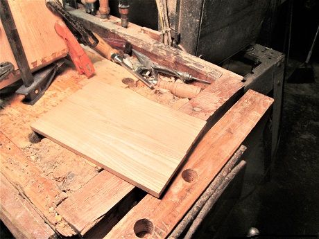

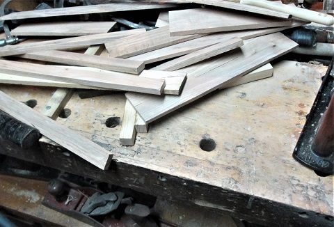

Ash scraps into a box

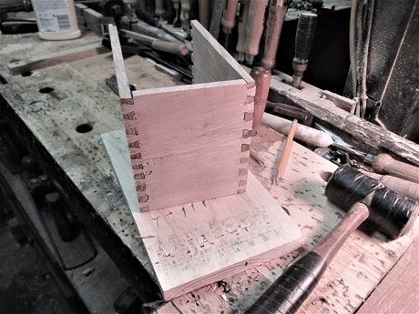

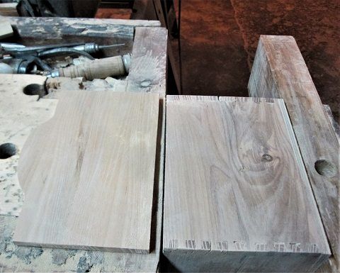

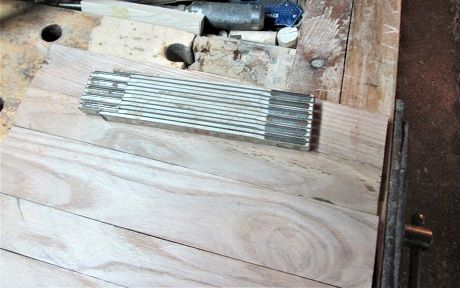

well...ramble tambled down to the shop....Seems the one end of Box #2 had split along the glue line :ArguingSmileys: Glued that up, after I was done chopping on  the other corner..
End closest to the camera...from here, it right into the clamps, as I had one more corner to do

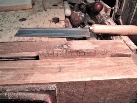

Yep...that corner....Easy part was the dovetail saw work...had to "fire" the big backsaw, for being hard to start..:BangingHead:
Boards a re 5/16" thick...as long as I keep the saw waxed, it works....hand does not like that handle...got to cramping up...:BangingHead:

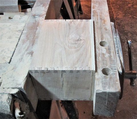

Got these pins chopped out, used them to mark out the tails...bandsaw to cut on the waste side of the line....BANG.:BugEyeSmiley:..second cut, blade breaks:ArguingSmileys:
Walk back upstairs, get out a "new" 3/16" blade.....bandsaw doesn't like it....made all kinds of racket:WonderScratch: Good thing I was almost done...almost..:ph34r:

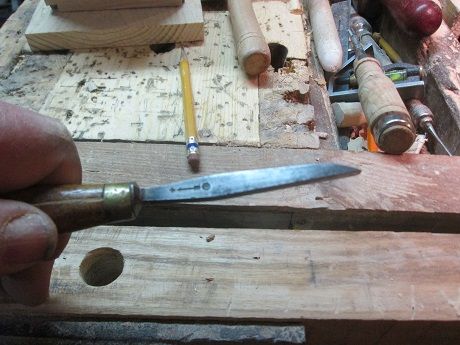

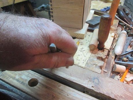

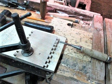

Last tails to be chopped...New chisel?   Not exactly....just been a regrind of an old H-F chisel...1/4" into a triangle profile..
So I can get into those nooks & crannies...and was using a slightly older chisel, as well..
1/8"  sash chisel, with an "Arrow" logo....anyway...last dry fit..:TwoThumbsUp:
Seemed to fit..figures, the last set fits the best...just when I get the hang of doing these..:rolleyes:

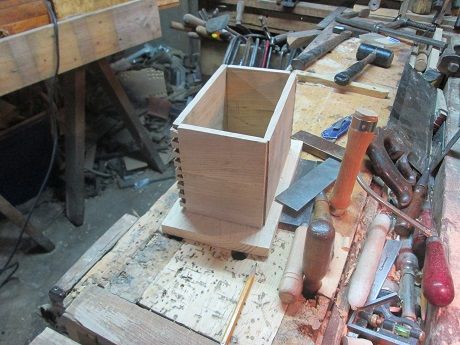

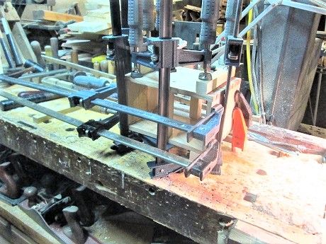

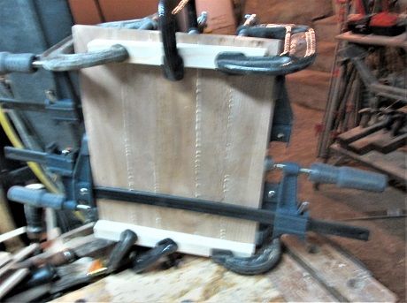

Once I got the split end out of the clamps, I could use those clamps....that 1 x 1?:WonderScratch:

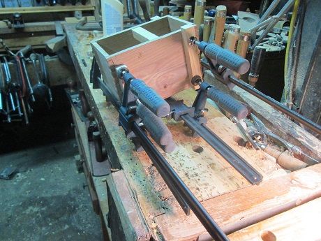

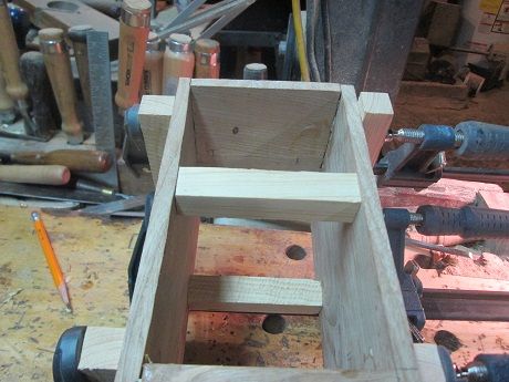

Noticed the sides wanted to bow in, in the middle.....cut a couple 1 x 1s to the eact length of the non-bowed ends...and tapped them into place, no glue ( I hope):ph34r:
Old saying, can never have enough clamps...sooooo, we add more clamps..:rolleyes:
There now, that should be enough?:ChinScratch: let this mess sit a day...may try to get the lid ready..

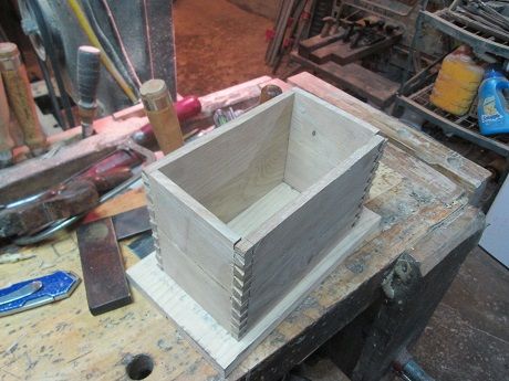

9 clamps is what it took...Cleaned the box up...a few high spots to level down, a few spots needed corrected for square...top and bottom edges  all match:JawDrop:whew

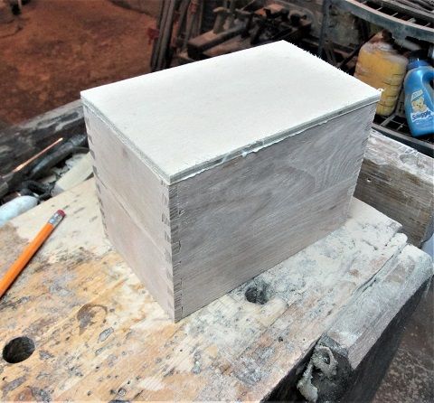

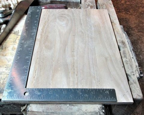

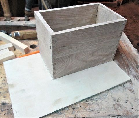

Got out a plywood panel..set the box on it...traced around the edges..:ChinScratch:
Then cut just outside the lines...add a bead of glue to the bottom edge of the box, moosh the plywood in place:ChinScratch:
Found an easy way to clamp this up, until the glue dries..:ph34r:
I can even fine tune the edges a bit....and also size the lid blank to the box...with a little extra..:rolleyes:

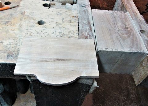

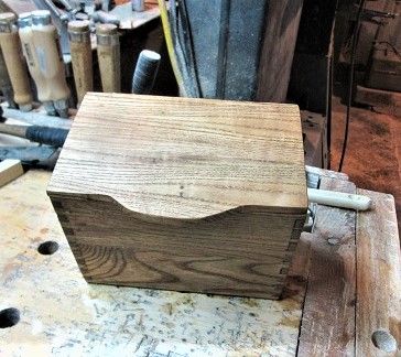

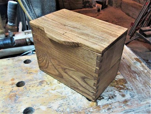

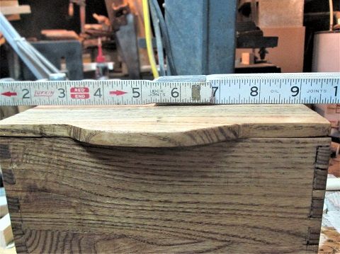

Even got the lid flat!:JawDrop:The finger grip part?:ChinScratch:

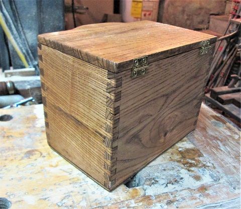

Hmmm, a little too big....later, I cut it back a bit....After Supper, went back to the shop, kept the box in the vise, while I sanded things down...then added a couple hinges....bright brass ones, this time....Lid and box were then fine tuned for a fit....dusted off...time for that stain, again...and a PIP?B)
Remodeled finger grip..:ChinScratch:

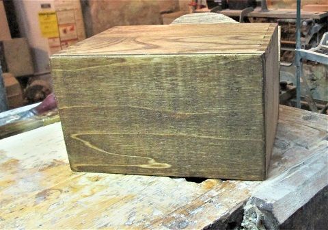

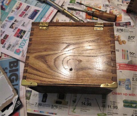

Hinge  and corner view.....didn't feel like having that knot hole out front..:rolleyes:
better view of the front...:TwoThumbsUp:
Good thing this IS the bottom of the box...:CoveringEyes:

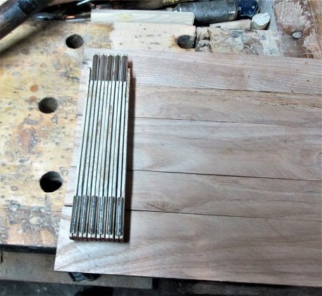

These boxes aren't all that big....ruler says it is 7"~ across the top...

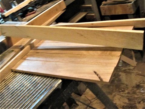

Got enough to make a bottom for a tray/tote..

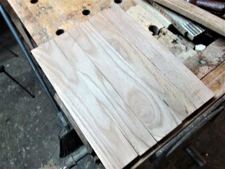

5 pieces.   Not all that wide..
Or long..

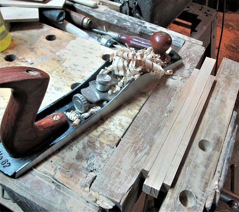

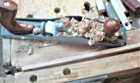

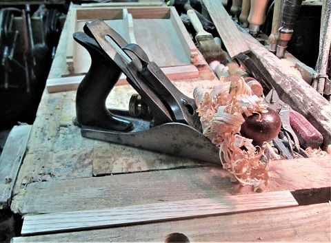

Needed to joint the edges to do a glue up...
Set them all on the saw as I went along....even had a few pieces for the sides and ends..B)
Even found a wider one, to make a carry handle out of..:TwoThumbsUp:

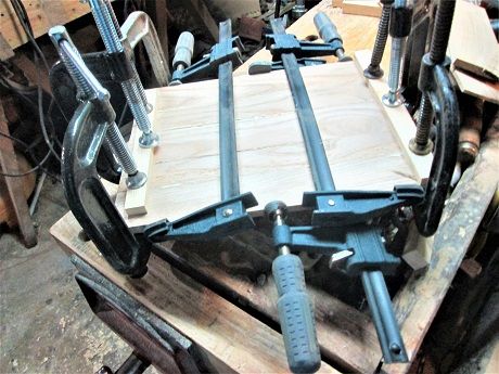

Edges looked good...run a bead of glue, then moosh a strip into the glue a bit, repeat as needed...then a few clamps, and cauls..:JawDrop:
Cauls are 2 pieces of pine..."top" and..
Bottom...to keep things flat....letting this and the varnished boxes sit a while, until things dry.B)

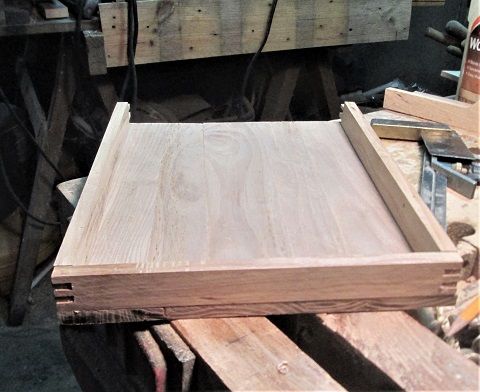

Tote corners will be dovetailed together...tote handle will be as well...then nail the bottom panel to the frame...no glue.  need to drill and shape a hand hold in the handle...:ChinScratch:

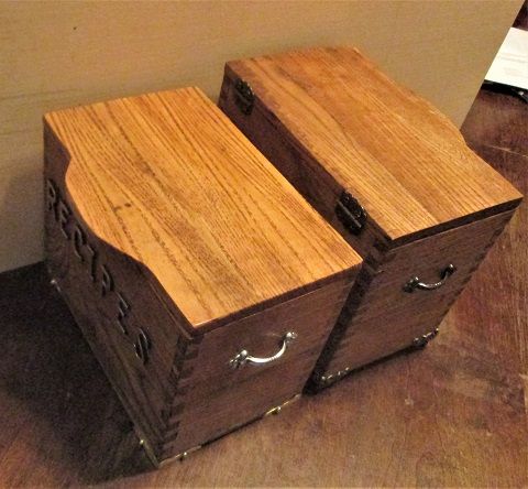

Roh-Kay, Raggy....Varnish is dry...:rolleyes:

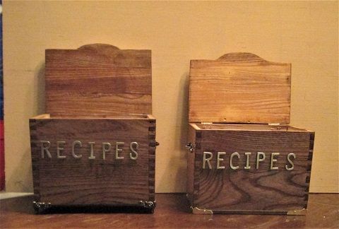

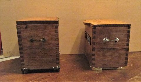

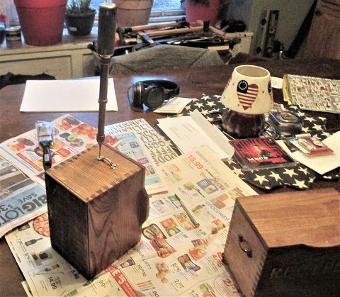

Means I can get the rest of the stuff on #2 Box...Needed pilot holes drilled...B)
Feet installed..
Lettering applied on both boxes...:TwoThumbsUp:

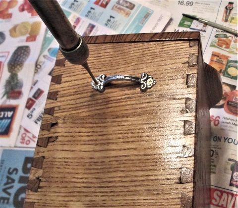

Handles are all in place..:ChinScratch:
Lids came out decently..:ChinScratch:
Boss gets her pick of the two....the other will go to either my Daughter's place, or a friend of the Boss's place. :TwoThumbsUp:

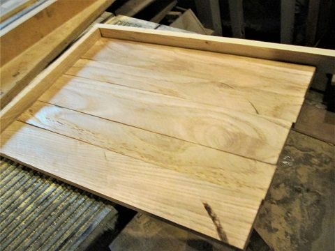

Ok...still have a pile of scraps...
Tray blank is out of the clamps.   had an issue with squareness...:ArguingSmileys:
One long edge was straight, the other had a slight curve to it...made it rough to square the ends...:DevilLaughing:

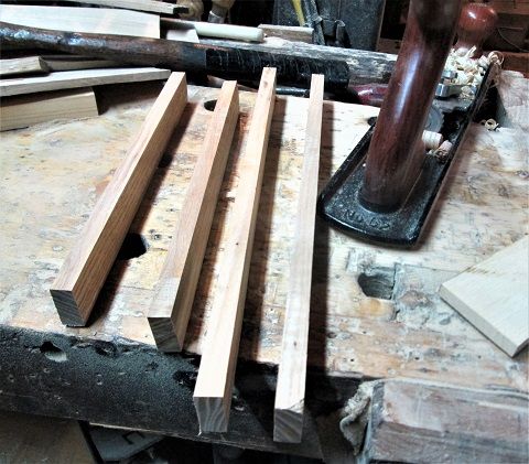

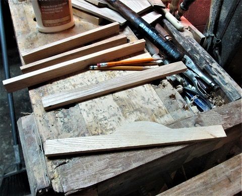

Then had issues with the four side pieces...
had to joint the four, flip two end for end, and joint again..
Couple of them needed face-planed, too...Then start on that finger thing, again..

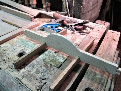

Two done...I also got a blank for a handle shaped...
Not sure if I'll use grooves for a grip, or just finger holes....

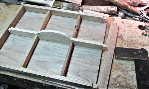

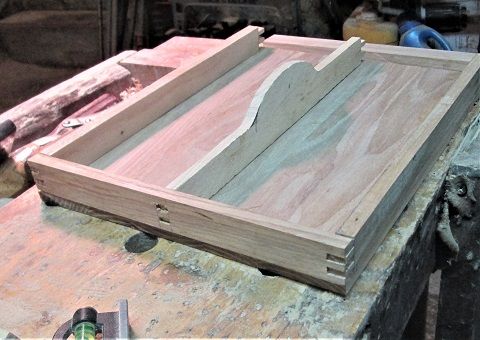

A little late-night fun, last night...after a nap from the Honey-do list....:OldManSmiley:

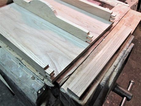

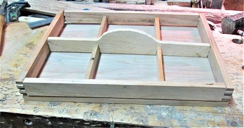

Both dividers were way to thick..:BangingHead:.we have ways of thinning things down.:DevilLaughing:.marked the handle blank for two notches...halflaps:ChinScratch:
Then marked the dividers, and notched them to fit..B)

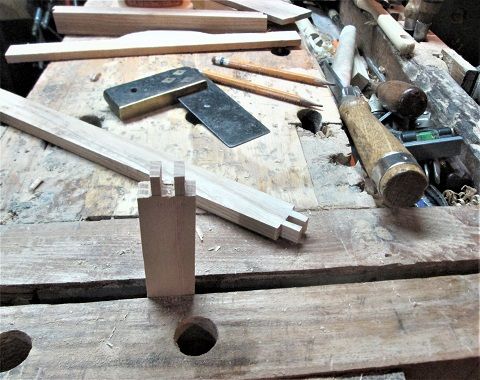

Then stood this mess up, onto the end piece, and marked for the finger joints....ends were easy to saw out..B)1869300836_AshTotemortisesetup.JPG.aba43349b3337c9f4ef69edcfe19e01a.JPG

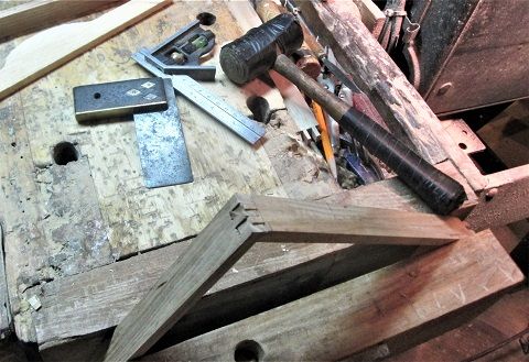

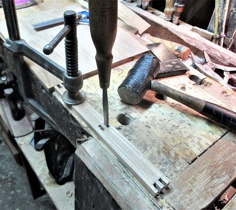

But the handle's mortises were chopped.   Chisel has an arrow for a logo...Butcher Sash chisel..
the a dry fit, to see how much work needs to be done...:ph34r:
eeehhhhh,  might need a wee bit more work..:ChinScratch:
