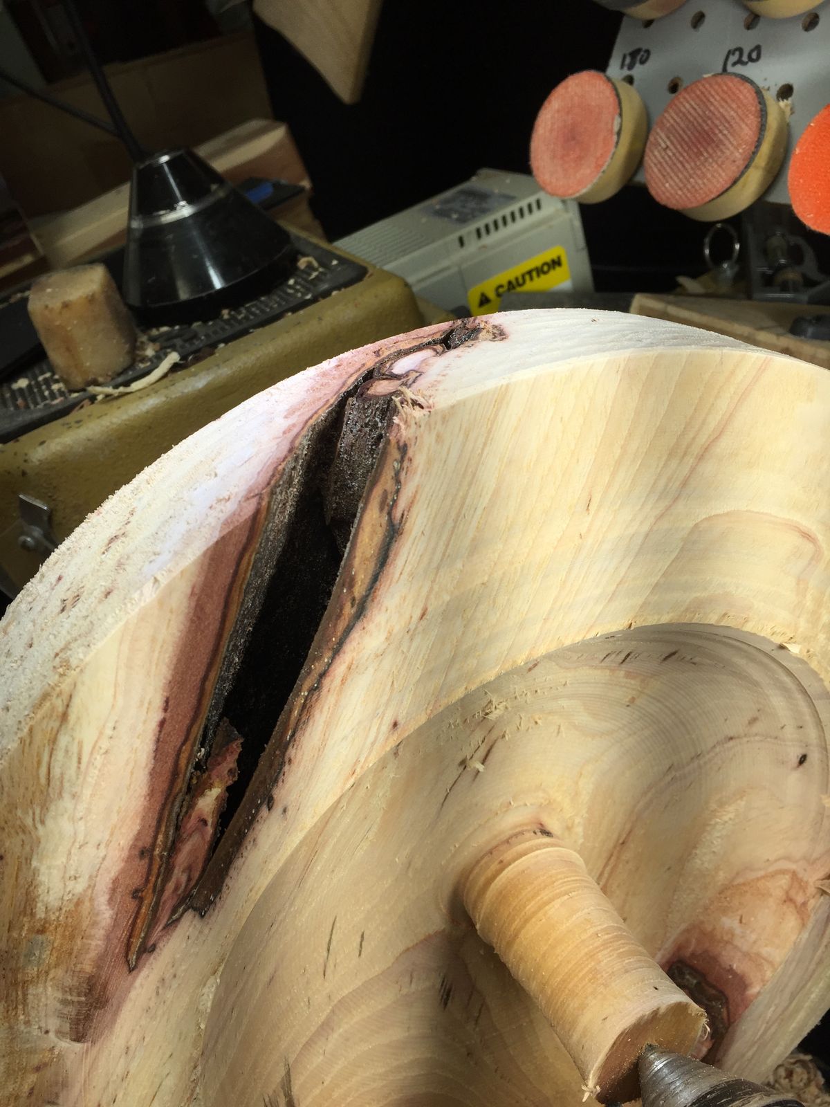

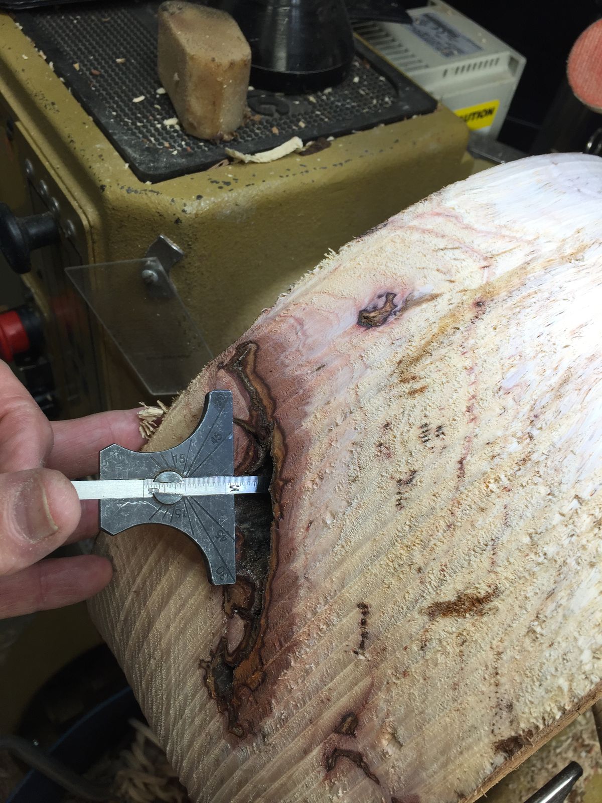

Rough turned two blanks today and found something that makes turning pecan interesting and probably the reason it is not used for lumber. This one had a void 5 inches deep. Once this gets dry will fill with epoxy and then return. 5D756B65-196E-41A1-82D0-C75984C67158.jpeg.356223766a407a3dc27f700eab60311a.jpegD4D9E70F-C2EC-4C5E-B2C0-10F232DFF44F.jpeg.6435a9971e0e4bf3bd2ed13208a60e7b.jpeg
Likely several reasons that pecan has never been a real commercially available lumber.
That is a pretty cool looking measuring device Gerald.  Can you show us the whole tool and tell us something about it?  It looks like and oldie but goodie:)
Amazing it goes that deep without coming out the other side of your plate.
Actually from a Harbor Freight caliber set, but is handy to have.https://www.harborfreight.com/6-piece-technical-measuring-set-94447.html?_br_psugg_q=caliper+set
I have a set from Harbor Freight that I've used for several years now.  It works well.  Just the micrometer is not accurate, but it will hold whatever measurement while I transfer it.

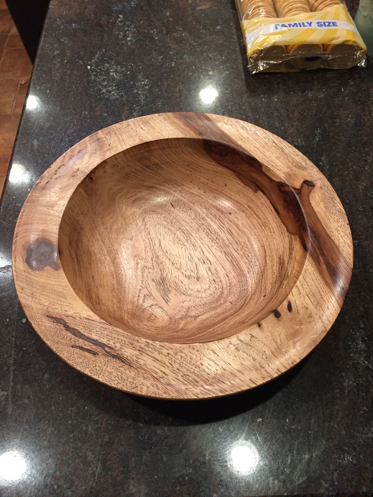

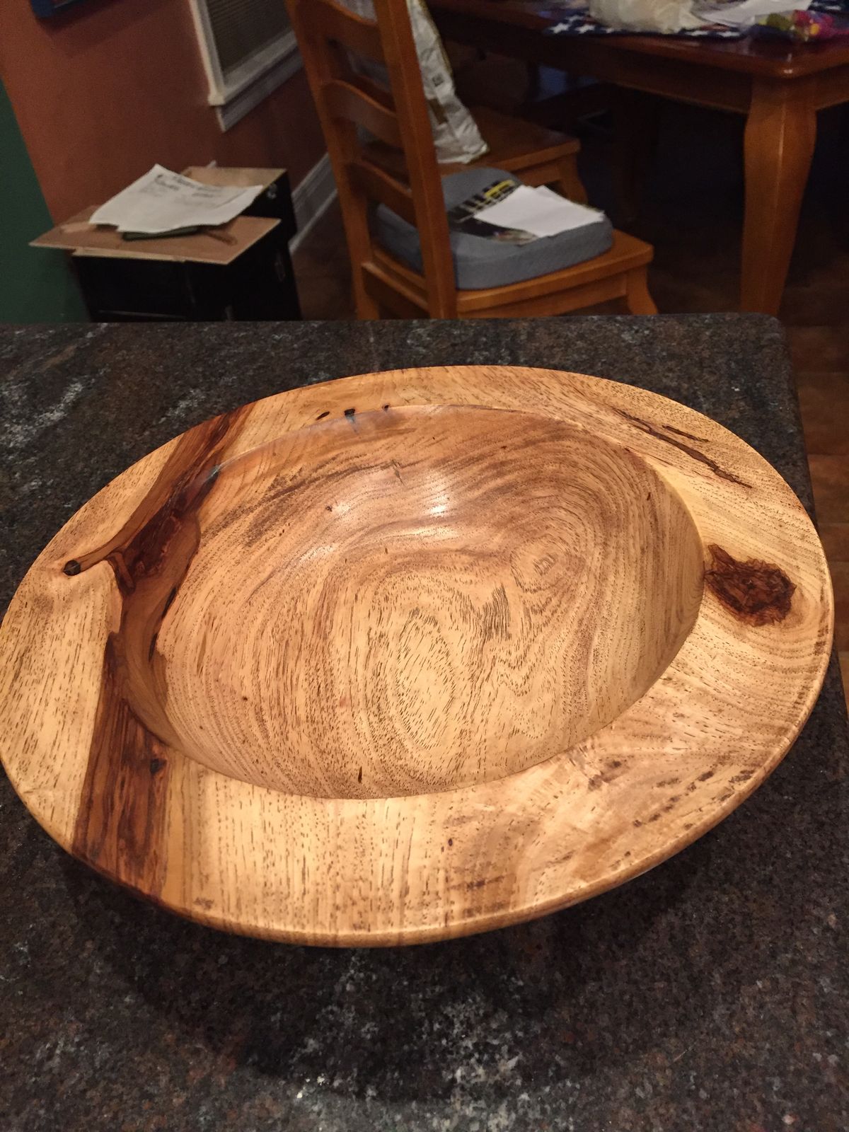

Finally this is the final prototype and was accepted. Still half an inch small to be fixed with larger logs in process. Finish is oil stain, shellac, and then Renaissance wax. Hoping to talk them into buying some wax to keep at the church. DB73B7BA-99D6-495B-A5D9-97AD01FD3D20.jpeg.785574ea6d04ad0c79f165deaddbfad0.jpegE16D1C14-5330-43A4-A1DF-B1D039D33E2E.jpeg.8807ffec56d32fa482e1c3d9bcd39abc.jpeg
They should be happy.  That is beautiful.
Very beautiful, you sure that’s only a prototype? Seems like it should be in the major leagues.
Beautiful.
Thanks guys. Artie it is prototype because just not big enough. But yes they really liked it too and the Pastor asked me if someone was getting this one. Told him maybe later. The prototypes will be Christmas presents. . Counted today curentle have finished or started 22 and still need 5 more the right size to finish up the order. Hurts to have all these and they are just a little small on the rims.
