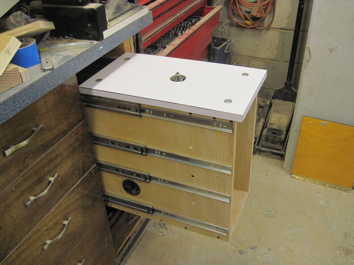

To make the router lift I am using a small Lab Scissor lift.  About 4 inch square with more than enough lift for this task.  Put in drawer slides to guide the router assembly smoothly up and down.  Had to run a 1/4 threaded rod through the front to lock the sled in place after setting the height with the lower adjustment wheel.  So far the drawer is made, sits level and has 4 sets of 150lb drawer slides to support it.  The sled is made, all the kinks worked out and it now awaits a wheel to attach to the lift and a switch, box and some wiring.  While I know 4 inch DC ports and systems are all the rage my shop has 2 1/2 and it works, not going to go through a major refrb at this time.  So the port will be for a DC hose but inverted as the side of the drawer has 1/2 clearance so nothing can stick out.
Only issue I have not got a working design for is the mechanical locks to keep the drawer from sliding back in while in use.  Have two ideas about it that some mock ups will be in order to see how they work.

  • Top installed and center hole cut.  Checked for operation, router runs well, not overly loud.  Track runs smooth and adjust well.  Did a test cut and checked to see if it was straight and the cut line

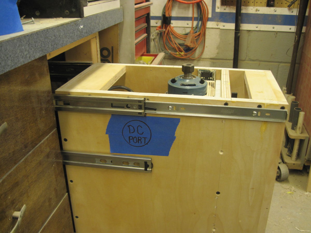

DC port installed and working on a set up for baffles inside.  Getting kinda cramped in this box now.  Managed to get the top cut and edge banded then Formica put on.  Will bevel the edges tomorrow and drill 4 holes to mount from the top.  While I hate to have 4 little recesses to collect dust and debris I have to think about getting inside and having to do maintenance one day.  Best way is from the top.  Also glued up a 5 inch chunk of various woods for the handwheel crank.  Couldn't let it go with a piece of plywood.
I'd have to put a note on the table or some kind of switched alarm telling me to remove the DC hose before closing the drawer.:WonderScratch:
YUP.  Course first you have to release the mechanical lock.  Which in theory should remind me to pull the hose.  Mechanical lock design so far is like Fairy Dust, very elusive. :Laughing: Have two more designs to try tomorrow in testing.

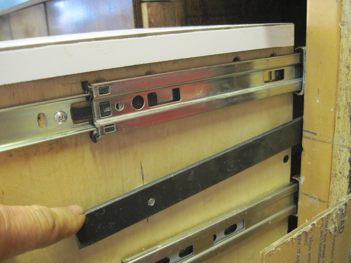

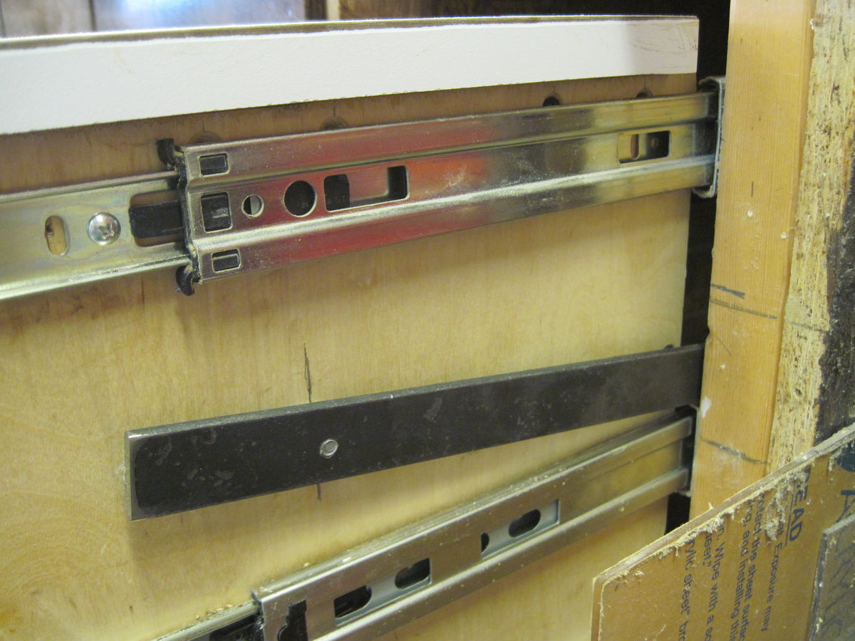

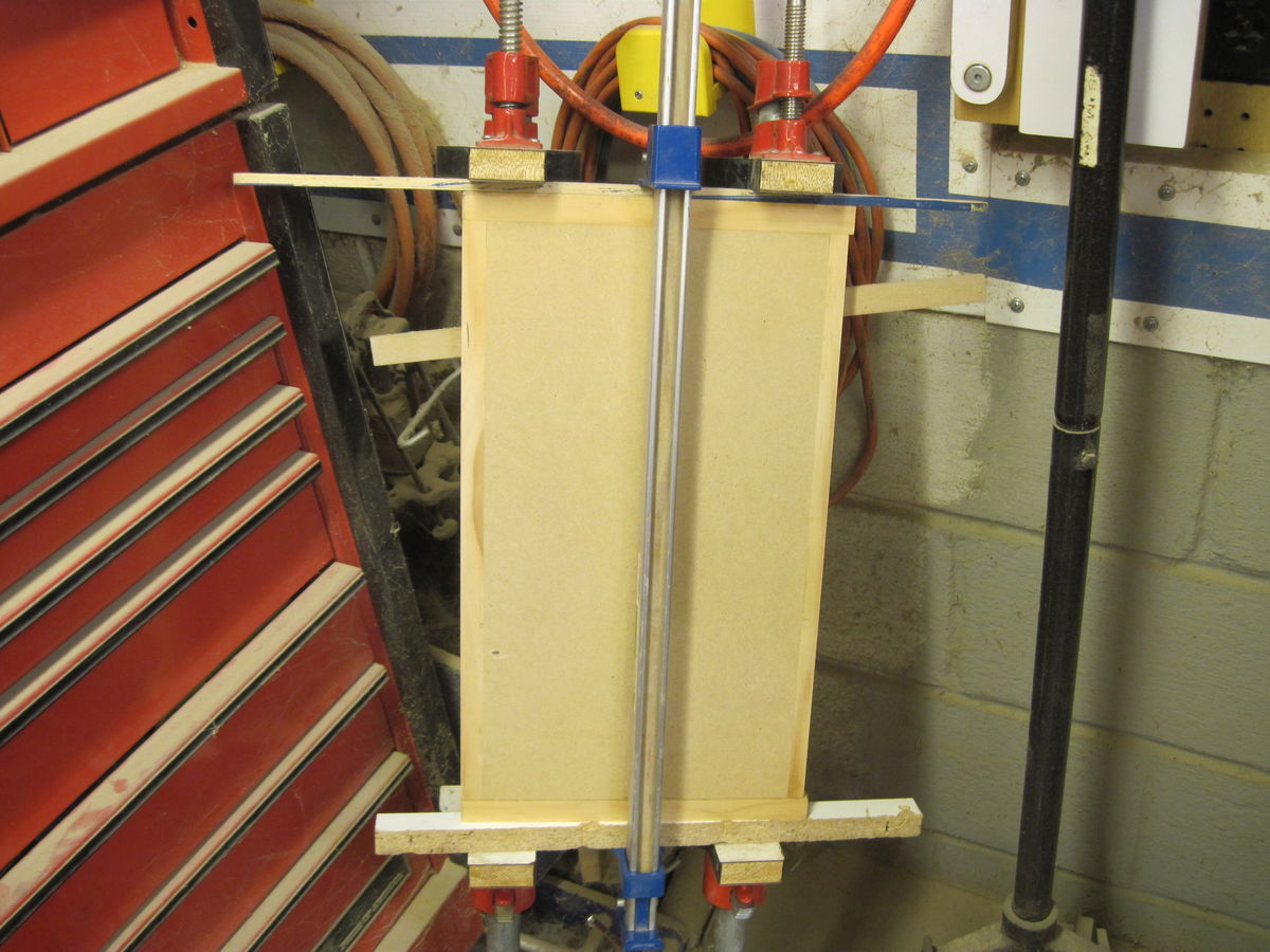

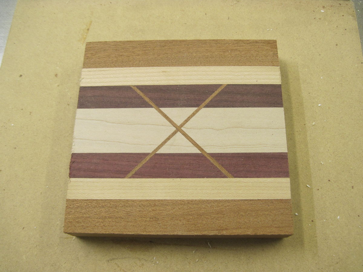

Two things almost done.  First is the glued up blank for the hand crank to raise and lower the router.  Second is I may have the kinks worked out for the lock mechanism that goes on the back and jams against the sides of the cabinet.  Thinking about using this 1/4 inch steel bar I had.
Should be strong enough?:ChinScratch:
IMG_0708.JPG.c2fdfb4ddf29155f37f0c17fccfd4d01.JPGIMG_0709.JPG.d8d6c8d06523bd4a5d469d24e821d7aa.JPGIMG_0710.JPG.f379aa2de0d0145eaed3fb7336c9e3c1.JPGIMG_0711.JPG.a608a5097011644d491dc59bfe794274.JPG

Crank wheel turned to size.  Next a suicide handle for the wheel.

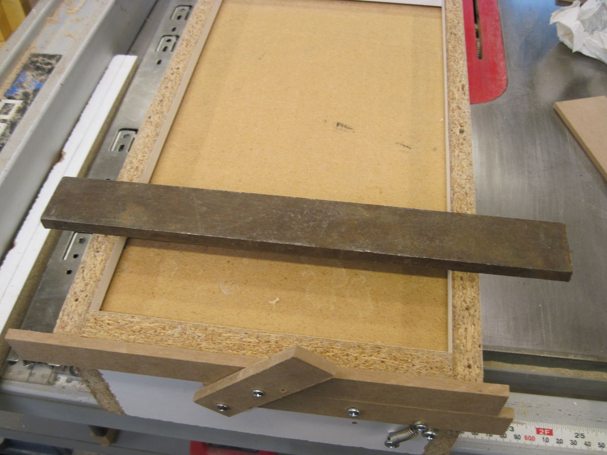

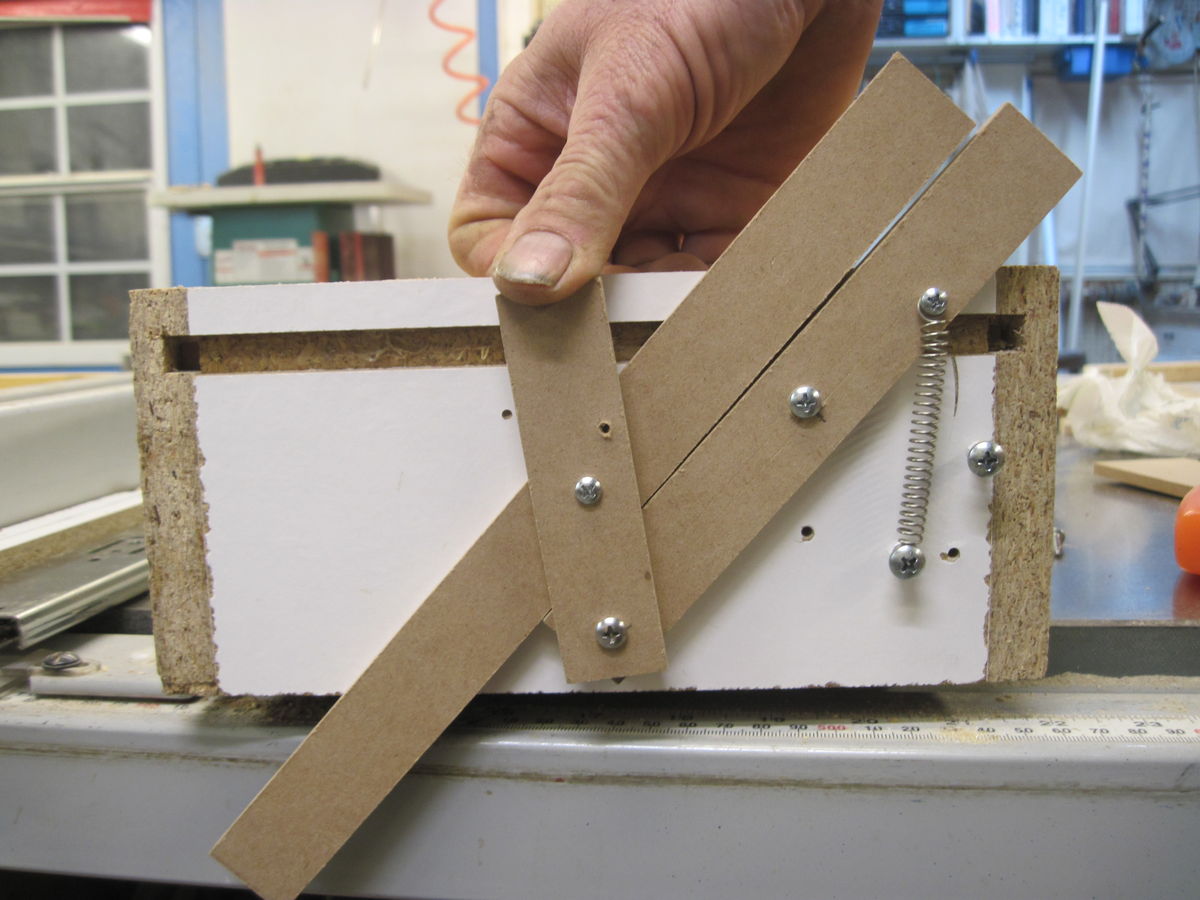

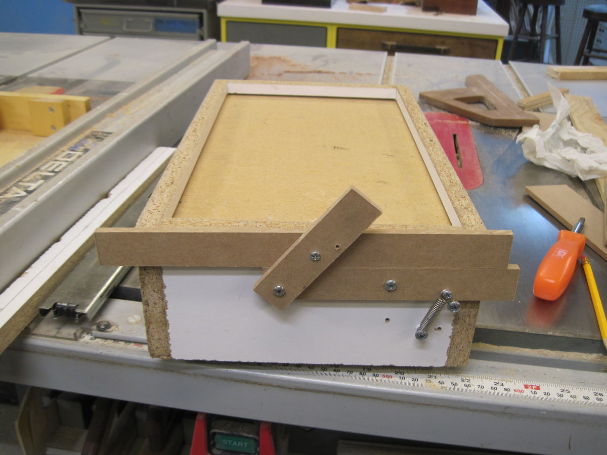

After several test on a mock up drawer I came up with this simple solution for locking the drawer in place both forward and back.  Two 3/16thick steel bars on each side that drop into place against a block of Corian on the inside of the cabinet.  Gravity does the work.  To release push down on both sides and using hip lean into drawer then let go.  Slides back over the locks and in with the drawer.
IMG_0716.JPG.f81f01b8ffd1588ffcb87ab41062e270.JPGIMG_0717.JPG.b16747e63ef41de8158ed967a5b93dbe.JPGIMG_0718.JPG.40b1d472545d13a6211f758a48dd485a.JPGIMG_0719.JPG.a826759597194f9a721f3a1c9cb1ad59.JPGIMG_0720.JPG.983d76e305dd9a14ca491a54d04f5a3d.JPG

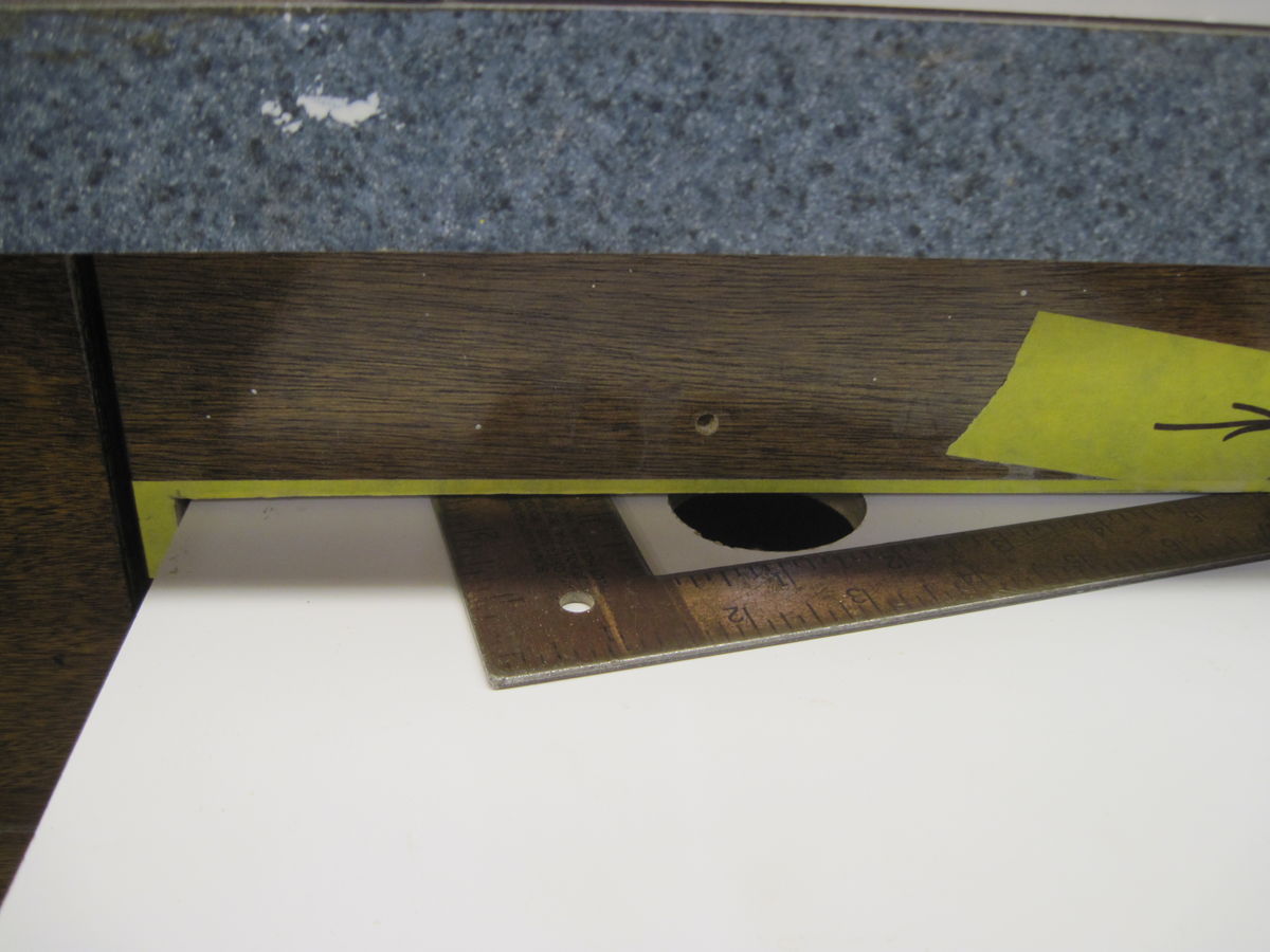

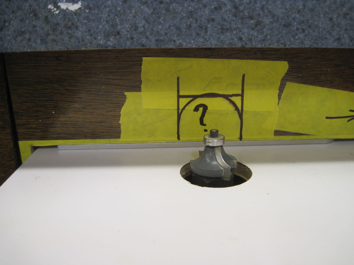

IMG_0722.JPG.3dc0d400ea244bbe22ca22191429a25e.JPGMoving on today I have managed to reinstall two drawers under the router table/drawer.  Used the old drawer fronts as they were finished and fit.  The false front door is on 1/2 piano hinge and opens far enough to allow drawer to open and not be in way.  Also has enough clearance to get to lock, this was important.
My overall goal was to not make it obvious the router existed behind the drawer.  Wanted it to look just like a row of drawers.  Just me seeing how detailed I can get.  Not a gotta have or it won't work moment.  My only real hold up is whether or not to cut out a hole for the router bit on the upper cabinet drawer front.
Took a few pictures to show better than write about it.  Clearance between top of table and bottom of cabinet is a shade under 1 1/2 inches.
IMG_0721.JPG.d0395460830a7f75281c8dc170b4036e.JPGIMG_0723.JPG.4d80fdf6b47f02f89cfec551d3745f22.JPGIMG_0722.JPG.3dc0d400ea244bbe22ca22191429a25e.JPG
IMG_0724.JPG.63c50f4e725b8e941b5f64c7850868ae.JPGIMG_0725.JPG.4cb5e67e75305ef5c0d36825a9f3c7a3.JPGIMG_0726.JPG.3fae9381af1f0edcbabbed0981355411.JPG
