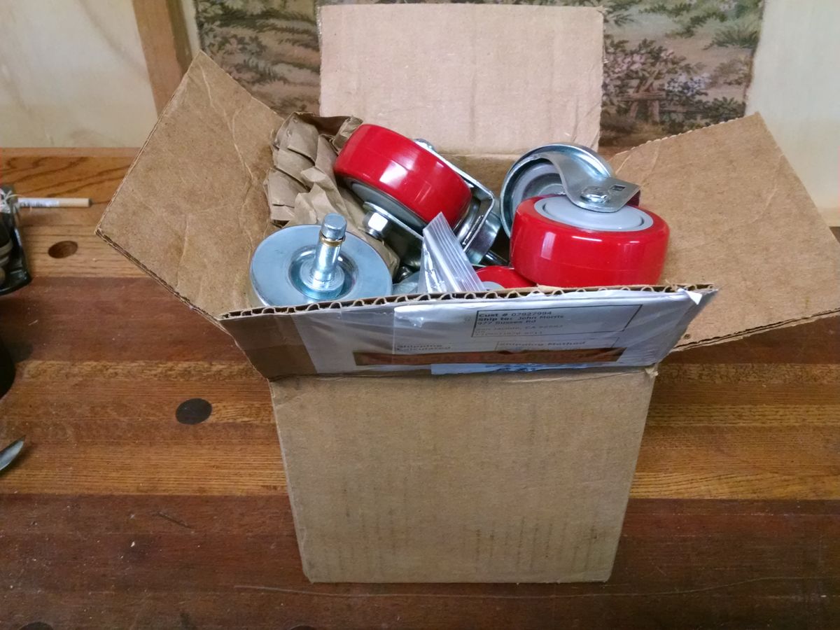

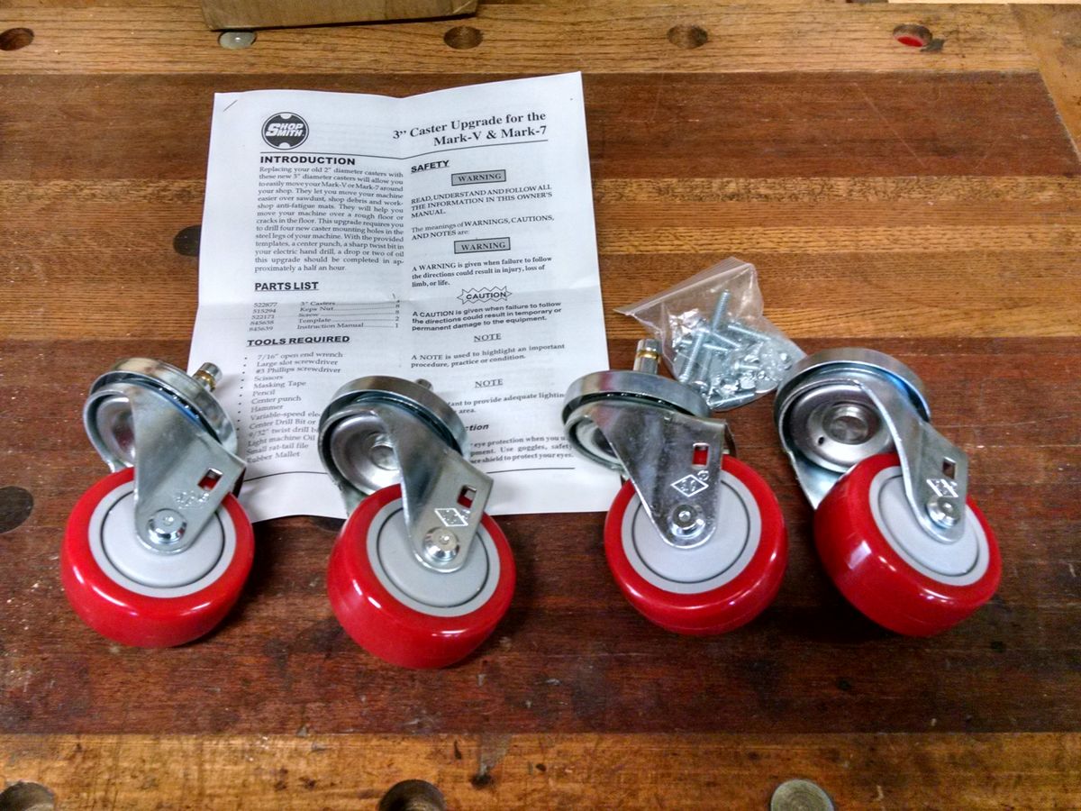

John Morris Posted February 16, 2019 Author Report Posted February 16, 2019 They came today!!!! Cal, Grandpadave52, Artie and 1 other 4 Quote
John Morris Posted February 16, 2019 Author Report Posted February 16, 2019 Well that excitement didn't last long, they didn't send me the paper template to drill the new holes. Back in the box they go! Till I get a template. Grandpadave52, Cal, HARO50 and 1 other 4 Quote

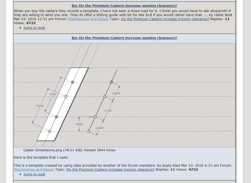

Grandpadave52 Posted February 16, 2019 Report Posted February 16, 2019 36 minutes ago, John Morris said: Well that excitement didn't last long, they didn't send me the paper template to drill the new holes. Back in the box they go! Till I get a template. Any chance you can download it from their site? Artie and Cal 2 Quote
John Morris Posted February 16, 2019 Author Report Posted February 16, 2019 21 minutes ago, Grandpadave52 said: Any chance you can download it from their site? I looked all over their site and nothing there Gramps, seems it should be though. I also googled it to see if it was floating around out there. Nothing. Arrrgh! Artie, HARO50, Grandpadave52 and 1 other 1 3 Quote
Grandpadave52 Posted February 16, 2019 Report Posted February 16, 2019 I'm sure you looked but wasn't squirreled away with the packing/shipping list per chance? Cal 1 Quote
John Morris Posted February 17, 2019 Author Report Posted February 17, 2019 43 minutes ago, Grandpadave52 said: I'm sure you looked but wasn't squirreled away with the packing/shipping list per chance? Boy you sure had my hopes up Gramps. I didn't look there, but on your prompt I just did, nope. Nothing. Thanks for the catch though! HARO50, Cal and Grandpadave52 1 2 Quote
Grandpadave52 Posted February 17, 2019 Report Posted February 17, 2019 You would think the templates would be printed pages of the owners guide... Anyways, in case you haven't, you might want to read through this thread. http://www.shopsmith.com/ss_forum/maintenance-and-repair-f10/premium-casters-revision-d”-t21327.html You might be able to make your own from this video & information. https://www.youtube.com/watch?v=8oe60U27lzA Found this too on their (SS) forum...seems like there are several threads and issues with template revisions. Cal 1 Quote
