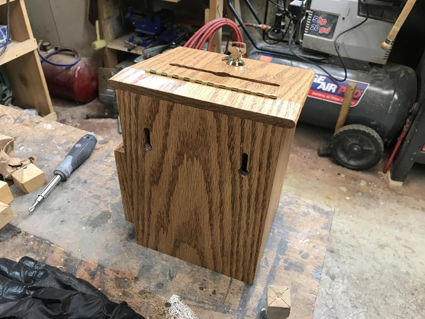

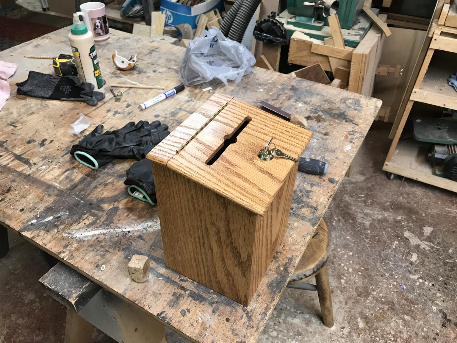

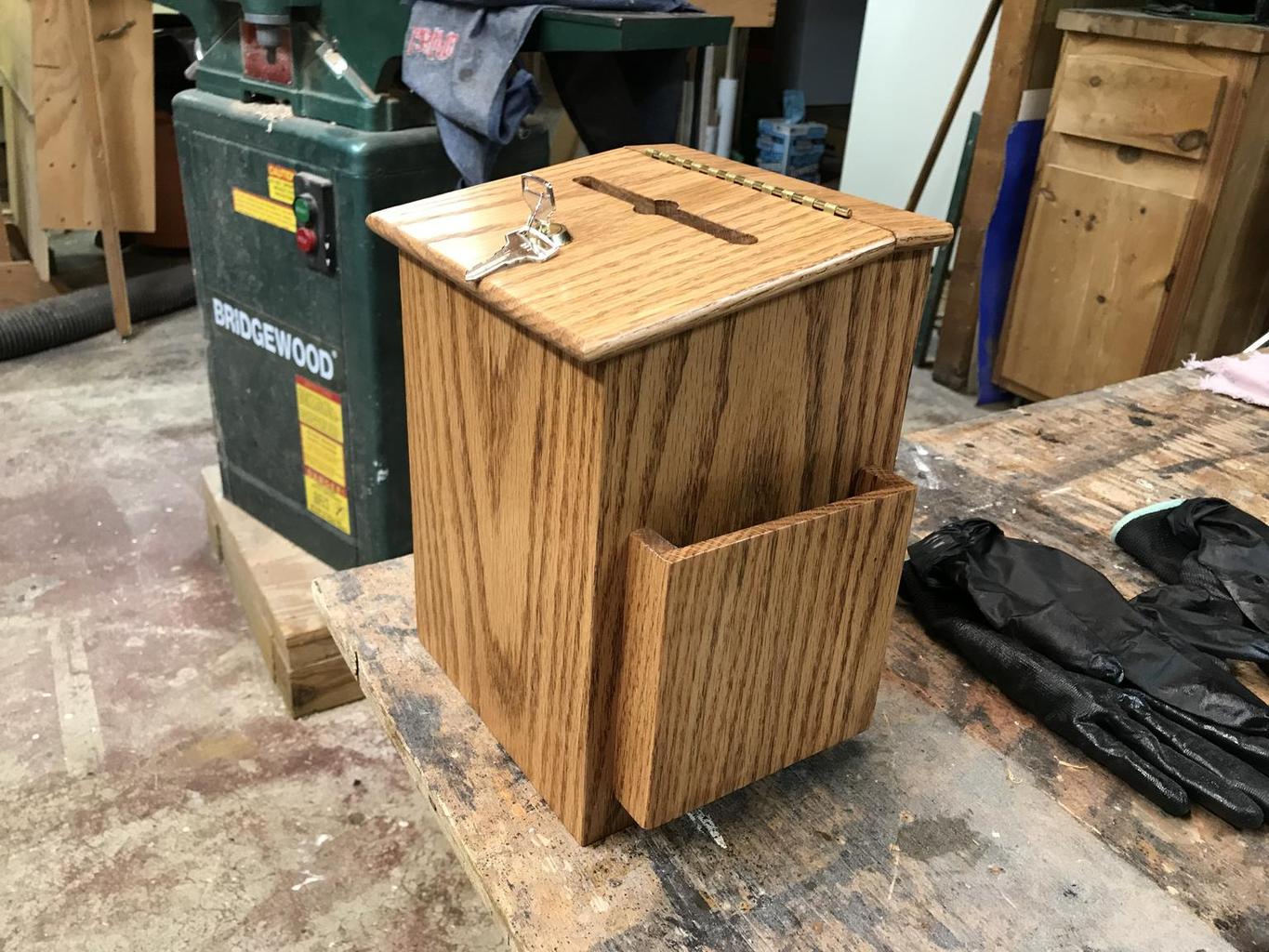

November 27, 20188 yr Popular Post comment_167757 Finished up my sister and brother-in-law's request. Wall mounted box. 3/8" red oak. Over measurements approximately 7.5" wide x 6.5" deep x 10" tall. Piano hinge and key lock. Golden oak stain and satin wipe on poly. Sometimes these little boxes are more difficult than the larger ones. Report

November 28, 20188 yr comment_167792 Wonderful job Lew, as Bob said, those "little" things do take time, the miters are superb, you have your tools tuned so well! I had to do a double take on the first image, the prayer box looked as big as your Bridgwood planer! I thought at first, wow, they got a lot of prayers to offer!!! Thanks for sharing Lew, excellent work. Report
November 28, 20188 yr Author Popular Post comment_167810 @John Morris Thank You! The miters were a story in themselves. My old saw (contractor style) has worn trunnions. I had to make a special jig to pull the blade parallel to the miter slot when doing anything over about 15°. @DuckSoup Thank you! Sad part about this is that they could have purchased one for $33. The hinge and lock cost that much when the shipping was added. Report

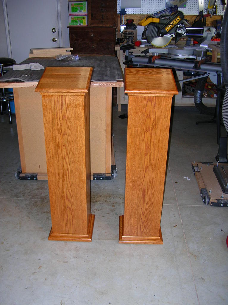

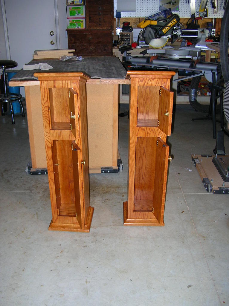

November 29, 20188 yr Popular Post comment_167937 Very nice job on that box! A number of years ago I made 2 offering boxes for the back of the church for donations and for prayer cards of requests. They have held up well. I also made a wall box similar to yours for the church office for the different ministry leaders to drop off payments for events or attendance cards and such. The tall boxes have 2 compartments with the top one with a lock for the donations and the bottom section for supplies of cards and other items. Edited November 29, 20188 yr by Allen Worsham Report
November 29, 20188 yr Author Popular Post comment_167942 @Allen Worsham Thank You! Those pieces are beautiful and I especially like the slanted tops. Several years ago my brother-in-law had me make something similar for their collection bag storage. Wish mine were designed as nicely as yours. Report
