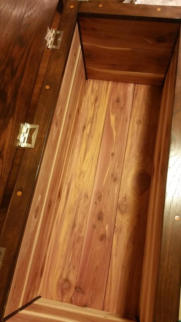

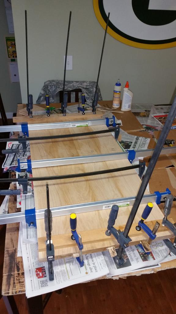

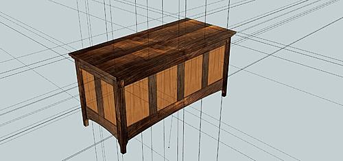

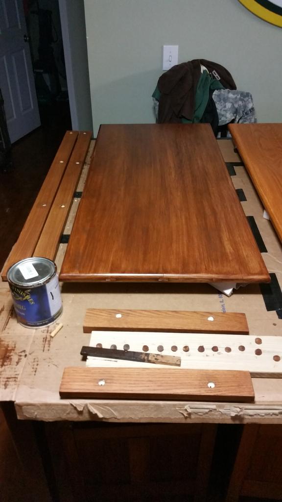

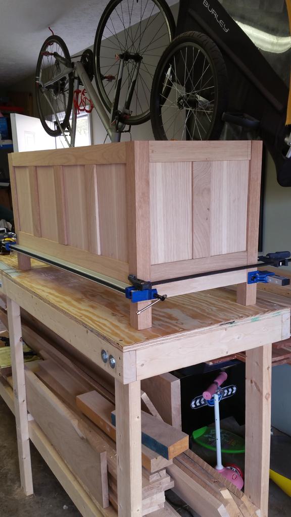

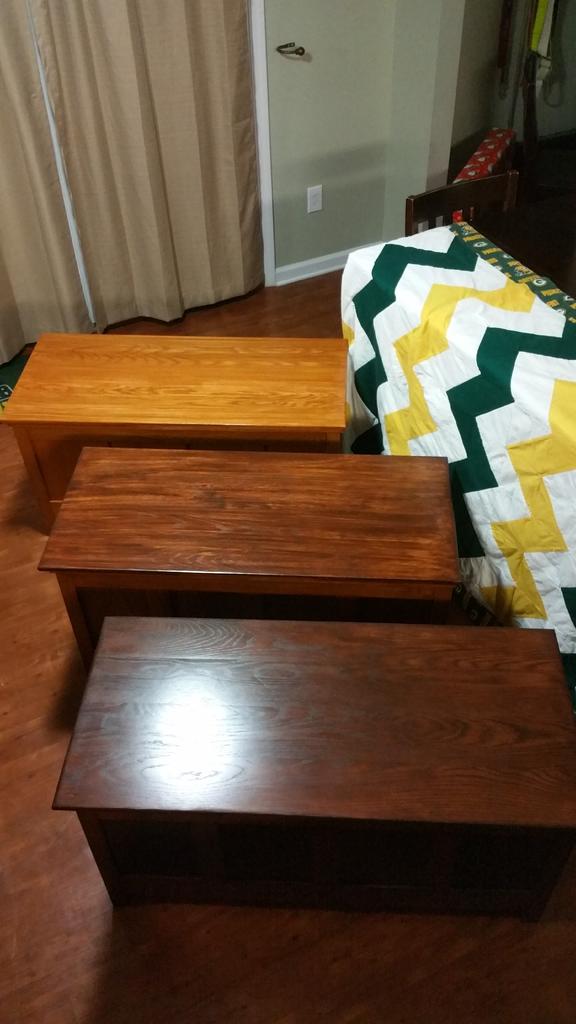

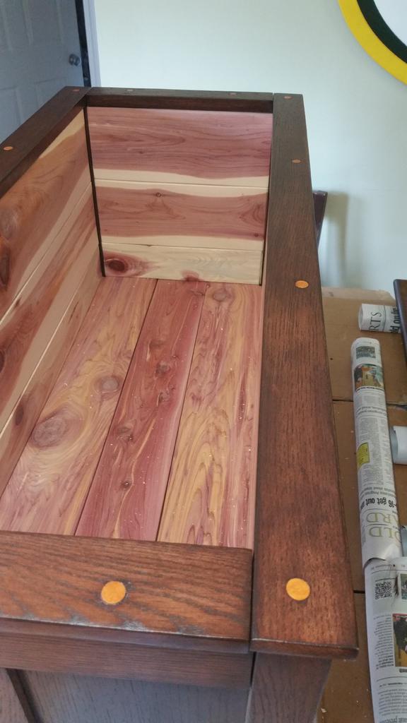

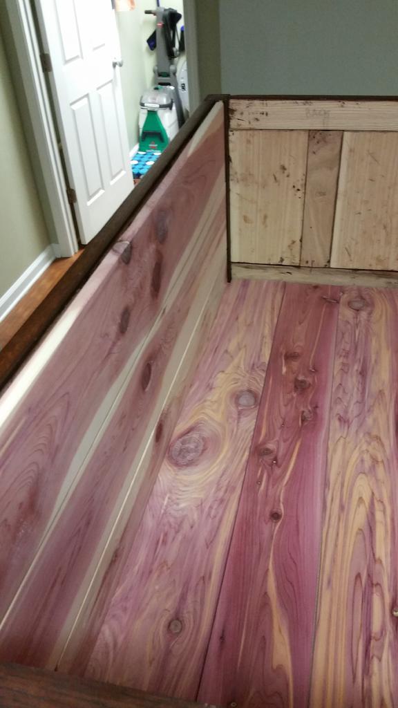

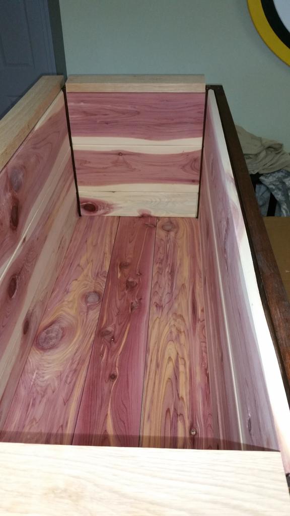

The 3d image is the conception I used to create this blanket chest and made it my own. In that design, a red cedar inside was not present that was of my own design. A ton of tongue and groove including the lid. The lid was a little different than a standard tongue and groove as the panels were all grooves and I used separate pieces as the tongues. I apparently did not take a very good picture of it during assembly. During my planning of this project I read for heavier panels that move like a lid, this is a stronger joint. I did use 3/4" thick white oak veneered MDF for the panel inserts along the side that were donated by Hood distribution in Louisville to me after I reached out to them on what I was doing as a Wounded Warrior while stationed at Fort Knox. Along with Hood Distribution Whiteside router bits and two local lumber mills helped me with this project. I learned a lot from this project and was my first from concept to completion and I look forward to completing more.

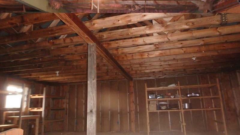

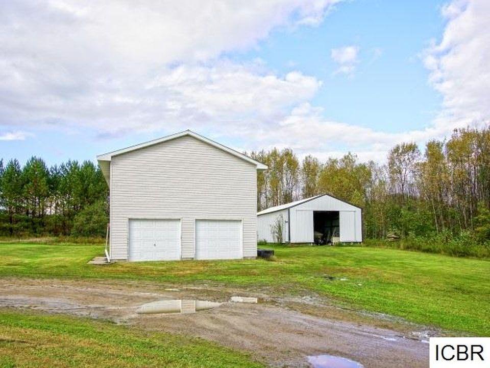

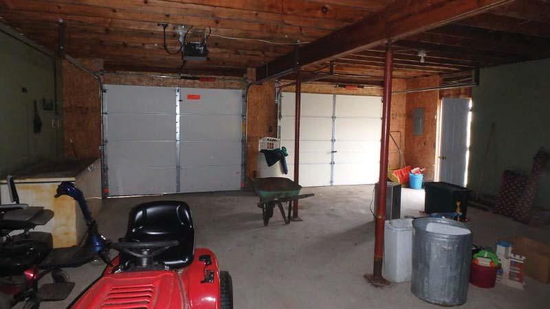

The house has an attached two car and below is a picture of the outside shop. It is a detached shop building 26x40' building. there is a one car garage in the back on the right side which is why I estimated around 26x28' feet of space. I will have a better estimate of space at the end of the month when we see it for the first time at the end of the month. Ever buy a house sight unseen across the country?
The shop is not currently insulated but it is on my list of things to do over the spring/summer giving me the ability to work in it during the winter months. There is an older wood burner that will likely need to be upgraded within the next couple of years. The man of the house passed away recently so I would image he never had a chance to finish it building the shop.
There are no wall coverings as of yet any recommendations other than drywall?
Electrical is one sarea of concern because I will not mess with electrical I will hire an electrician. I know the 30x60 pole barn has electrical ran to it as well. Hopefully, they had thought of expanding it into a shop... requiring 220v. Three pieces of equipment will require 220v the table saw, jointer and dust collector all required 220v to start with.
I know I want to stay away from fluorescents because of the poor performance in colder temperatures.
The upstairs is currently three rooms and easily navigable but just stud walls no coverings. The plan is to enclose the stairs to prevent dust and change it to just two rooms. I would imagine all of us here enjoy building things and mine started with Legos. I got my daughters into Legos and I have an entire city with trains that will take up 1/3 of the upstairs, the other 2/3rds will be a home theater room. But, all in due time shop first.  An air compressor is something else I am looking at as well I keep seeing videos on the benefit of having one.
