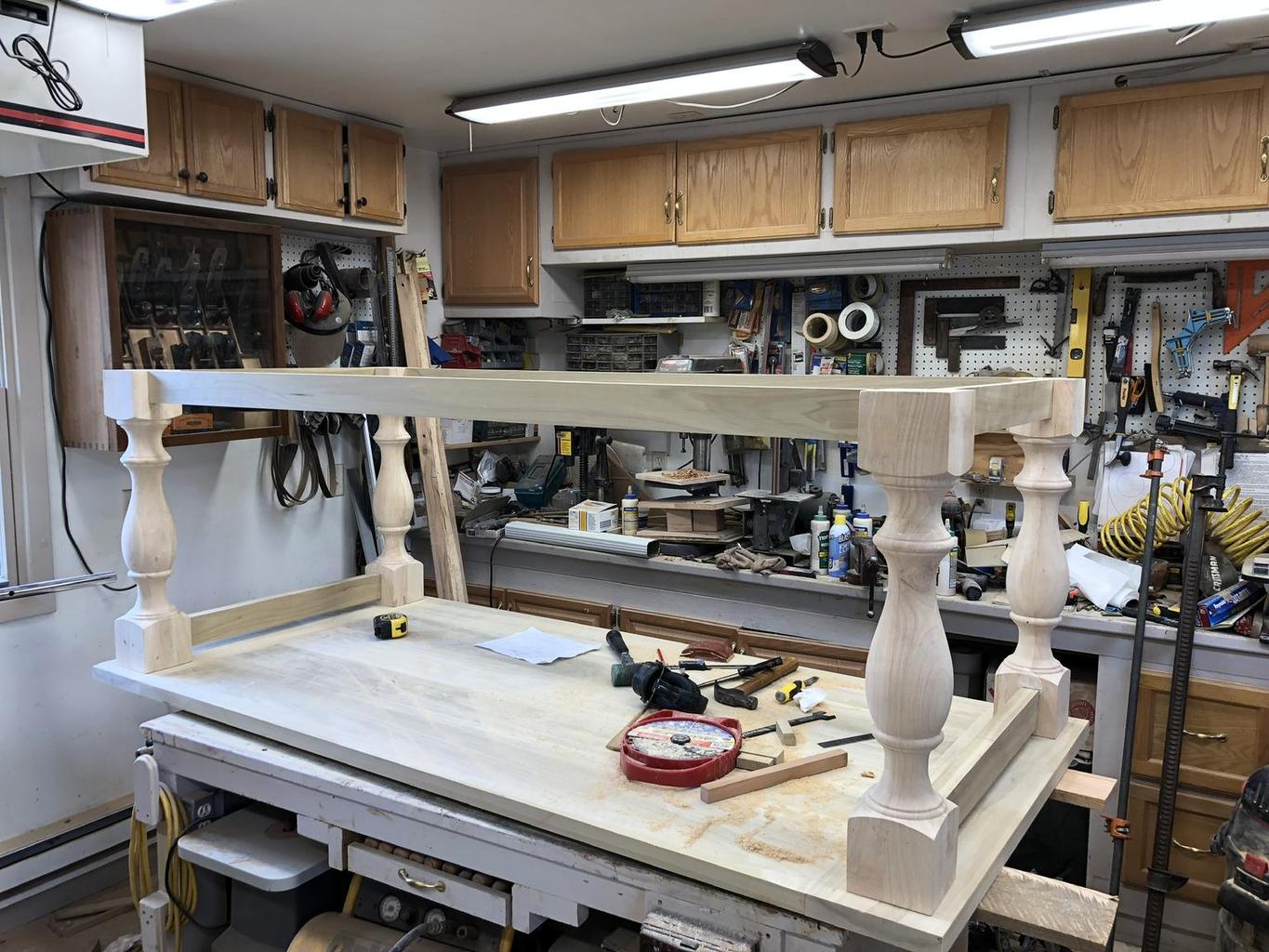

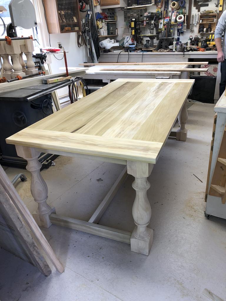

Monday, I posted that I’m building a farmhouse table.  Gene Howe requested that I keep y’all posted on the progress so here it is.  The top is flat on both sides and I have made the skirt and stretchers.  BTW, the stretchers are done but on in this picture.  Everything is mortised and tenoned and I had to increase my mortising skills.  The legs are 5” square and my mortifying machine only raises to 4 1/2” so I cut the mortises with a plunge router and chilled the ends.  Speaking of legs, they were purchased and on leg was an 1/8” out of square So the mortise and tenon was “interesting”.   0FDBD636-DE5A-45EE-99C9-6DEB19127A51.jpegA883B4F1-31DF-4F18-86C6-99368081B01B.jpeg

    The table has left the building.  Today, we loaded the top and base to take it to its new home.  We threw the top on long enough to see what it looks like.  Not too bad.  Tomorrow the bench goes home

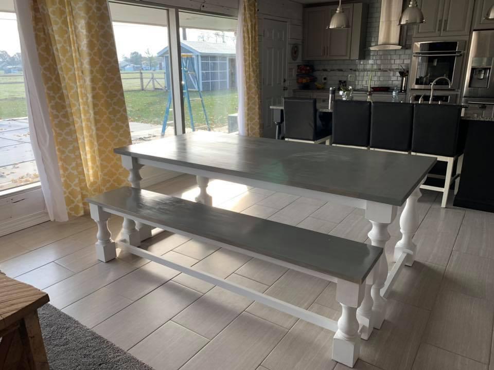

    I promised to post a picture of the finished farmhouse table so here it is.

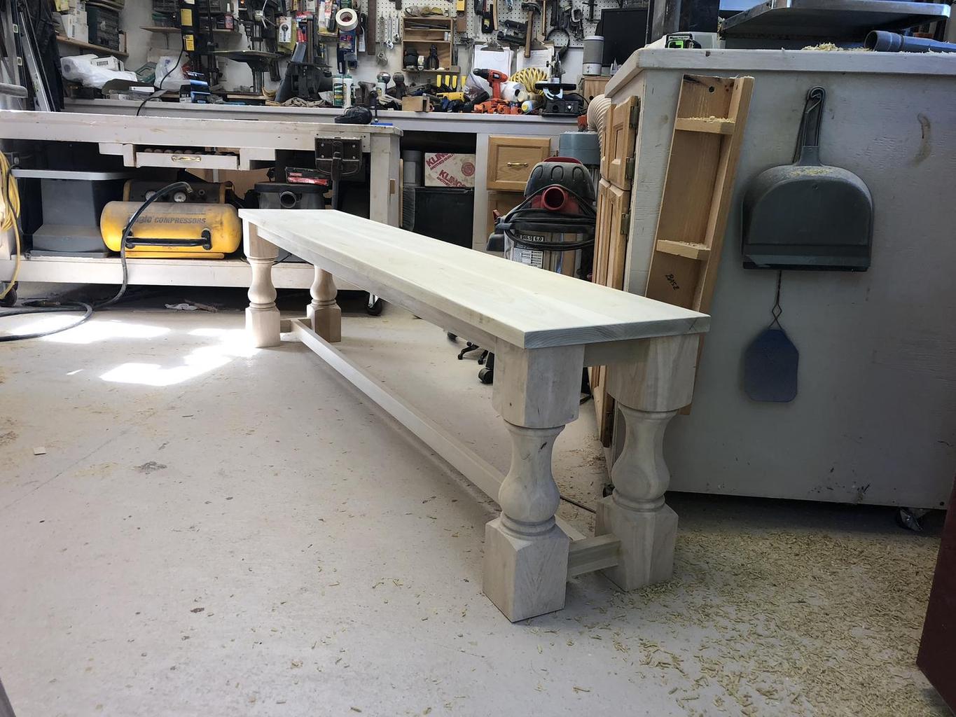

    That bench is finished.  The customer is going to buy 3 unfinished chairs to go with it
Thanks, Ron. You're coming right along. It's going to be one handsome piece.
Very nice Ron. That is one beast of a table. I hope you have someone close to help you maneuver it?
Looking good from where I sit.  Danl

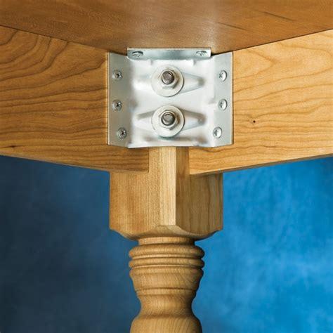

mere mortals won't be able to pick that table up so when it gets moved it will be shove/pushed/drug around which will be tough on the apron/leg joints so here's something you might want to consider...
th?id=OIP._rpzpMPOk7BOTcalft_L2wHaHa%26pid=15.1&f=1  2914946_f520.jpg.f0d867e48c3b351b8c181fe549f23a9d.jpg
I have seen brackets like the top picture but not the bottom picture. Are the wood brackets bought or homemade?
home made...
Both styles of bracing (brackets) have been around for a long time and either will work just fine on this.
the homemade version should have a key cut into it to receive the corner of the leg...
your dado blade set over to 45° is just the ticket for this and the key way helps w/ fastening the bracket to the leg...
not only do those brackets help the corner junction strength immensely they work hard at keeping the leg from getting ''laid over''when the table is slid around...

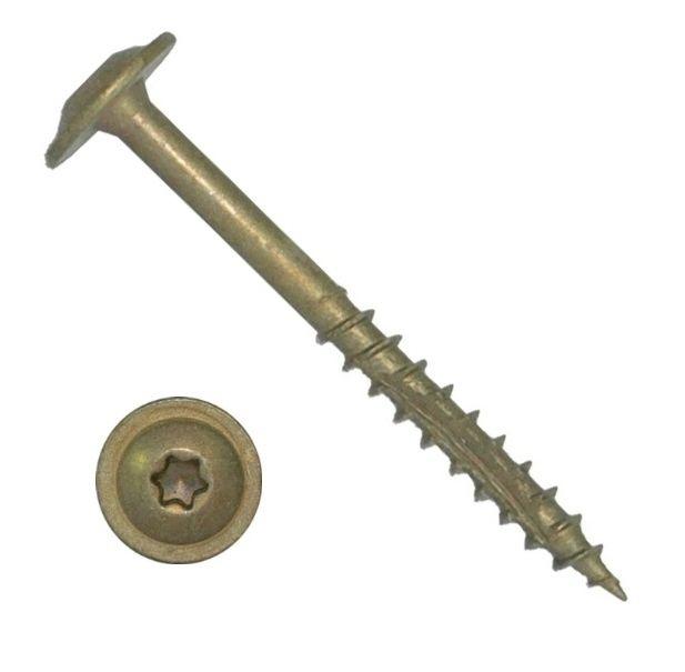

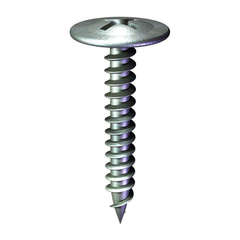

note...

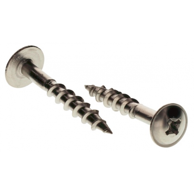

use modified truss headed (see pic) or pan head screws w/washers to screw the brace in...
if you use a full threaded screw, drill a clearance hole for it in the bracket...
FH screws tend to split the wood when put under duress... think splitting wedge...

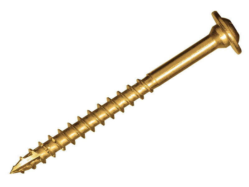

instead of lagging the leg I use GRK or RSS structural screws... (4th picture)...  you get strength w/o the risk of splitting the leg...
k-screw-big.png s-l1000.jpg&f=1grabber-wood-screws-23355-64_1000.jpg&f=1$_32.JPG
